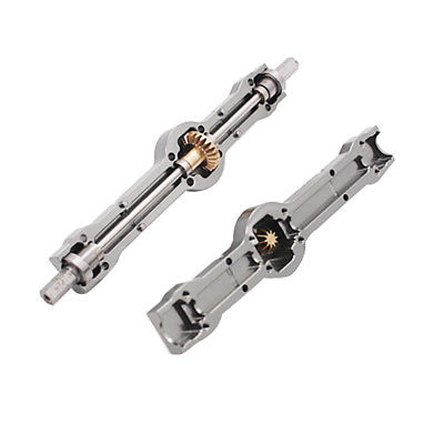

Hi.
Here you go hopefully a pic of an axle opened up.
Enjoy
Sub
Enjoy
Sub

The JJRC trucks have an actual differential. When you turn one wheel the other turns in the oposite direction. I've heard that can be problematic, as when one wheel leaves the ground all power gets transferred to that wheel and the one on the ground does nothing. I hear some grease or thick oil helps a lot with that, but I haven't tried it yet. As yet I only have one JJRC truck, but I do have a spare axle so maybe I'll open it up on video.
Re: HL Truck Mods
Hi
Yes unfortunately thats the same with real vehicle diffs and why cars etc get stuck in snow.
Race cars and some high performance vehs etc have whats called a limited slip differential...it allows the inner wheel on a corner to slow down slightly then automatically locks the diff to give power to both rear wheels to allow the power to be transmitted to both the road wheels an essential mod on any rally car.
Some people have even locked the JJRC diffs with Gorilla glue as it is an issue with this model if you go off road with it.
Regards
Sub.
Regards
Sub.
- Roboticus_Prime
- Corporal
- Posts: 382
- Joined: Mon Sep 14, 2015 7:05 pm
Re: HL Truck Mods
Yes, limited slip is the name of the game for general off-roading trucks. At least for the rear axle. The front axle should have lockers, or just bee locked. I've seen people use the thick grease trick for Tamiya king hauler axles. It should work the same for the JJRC. I don't want the JJRC ones because they don't offer a metal version. Yet...
