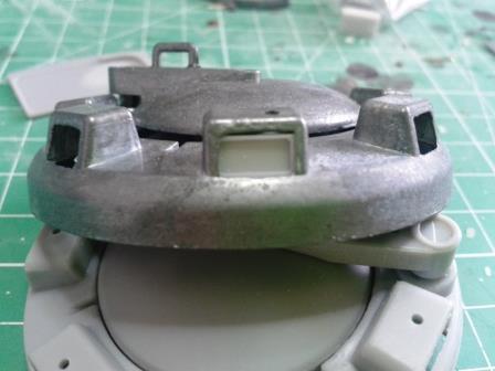

do fit, but only just. It then dawned on me that this was because the Taigen casting, good though it is, is just not quite right. The apertures for the periscopes are too narrow, too tall and too thick.
- They do fit into the Taigen metal cupola - but only just.jpg (25.2 KiB) Viewed 5889 times

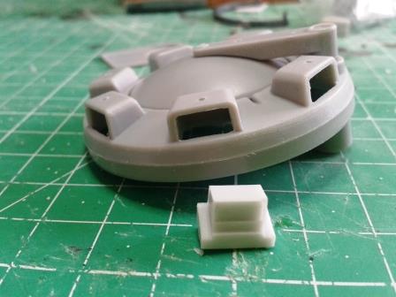

- The Schumo periscope set include seven identical resin castings for the cupola.jpg (28.75 KiB) Viewed 5889 times

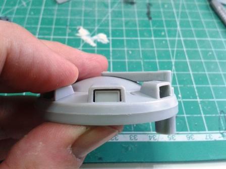

- The Schumo periscopes fit perfectly.jpg (26.53 KiB) Viewed 5889 times

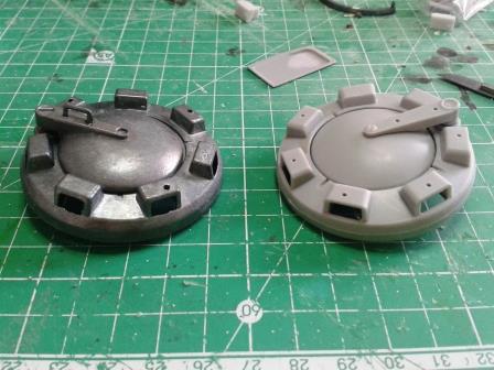

- Taigen cupola on the left, Hachette on the right - note different size of periscope apertures.jpg (36.31 KiB) Viewed 5889 times
- Here you can see how the Hachette periscope apertures are (correctly) both lower and wider.jpg (30.8 KiB) Viewed 5889 times
So the Hachette cupola is just better all-round than the Taigen equivalent. I especially like the fact that the hatch cover is noticeably separate from the pivot and bracket - this is how it should look (and I have read somewhere that the hatch cover could actually rotate).
It's far from perfect, however. First of all it's all plastic, so although it's sprung like the metal one I remain a little nervous about how much handling it will take. The anti-aircraft rail around the top is also very unconvincing, being far too thick (it looks a little better on the Taigen metal version). The real thing was actually

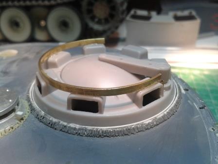

First off I have replaced the AA ring with a better looking rail made from bent brass strip. This I carefully bent around a suitably sized item - actually the handle of my drilling tool - making sure that the circle was regular without kinks. I actually bent it to a slightly smaller circumference so that I would take out some of the 'spring' before opening it out to the correct width. It was then glued it in place with strong five minute epoxy glue. I will have to add small weld beads.
- The Hachette cupola is very slightly smaller than the Taigen version.jpg (28.1 KiB) Viewed 5889 times
- The anti-aircraft rail replaced by bent brass strip.jpg (24.76 KiB) Viewed 5889 times
