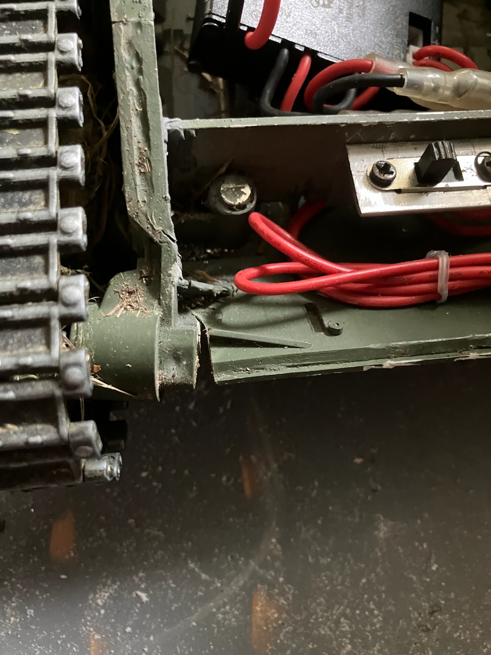

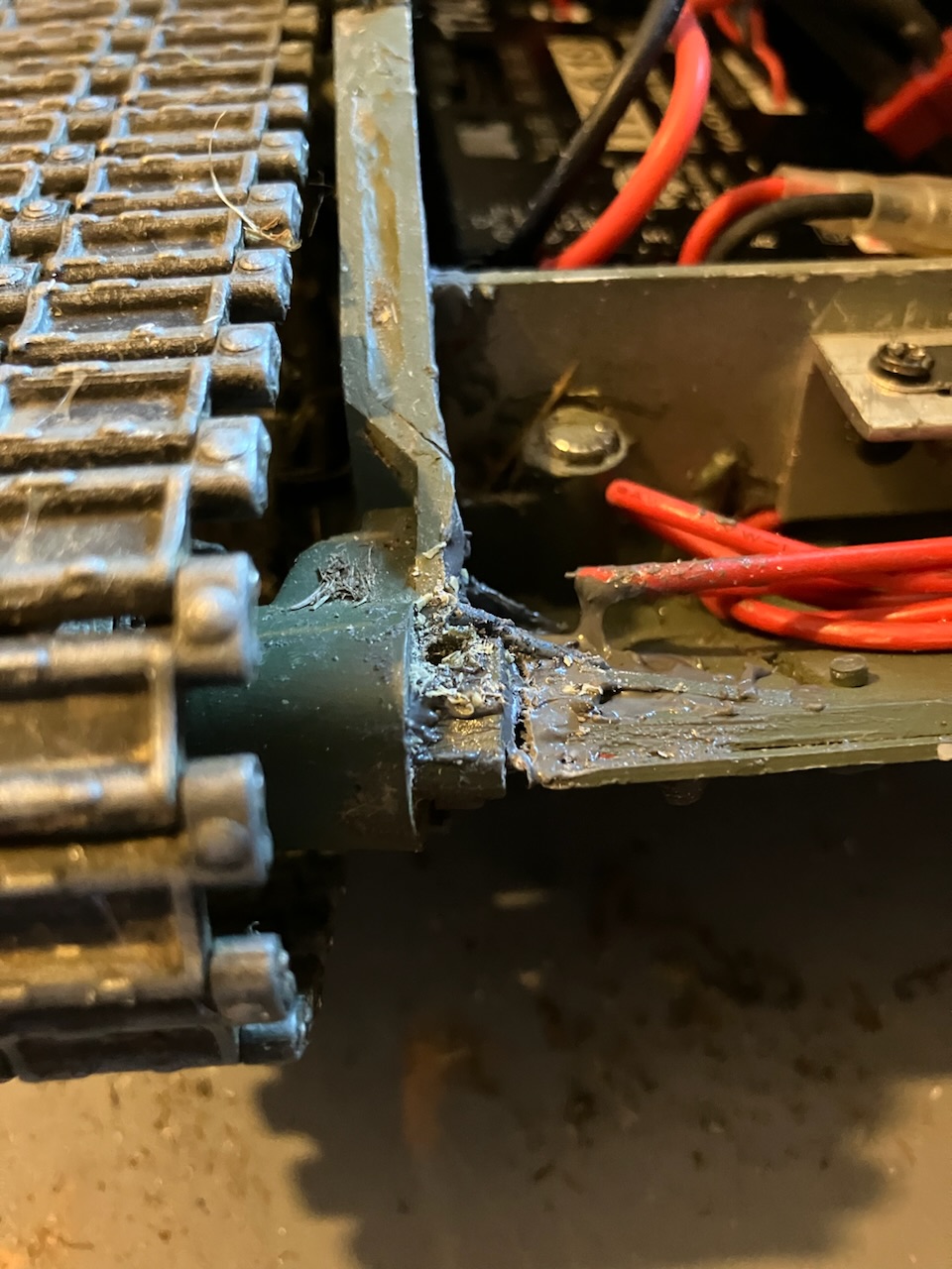

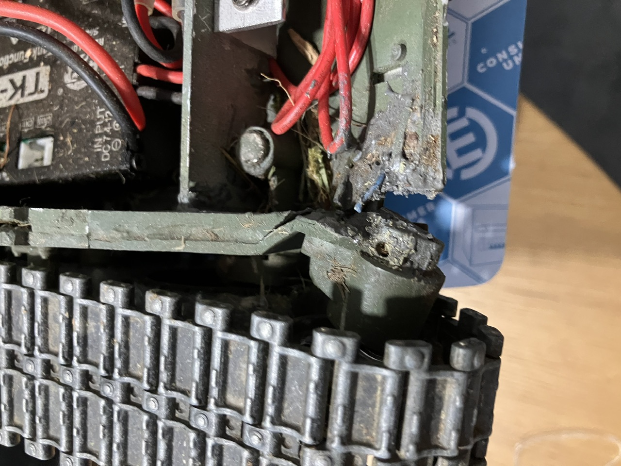

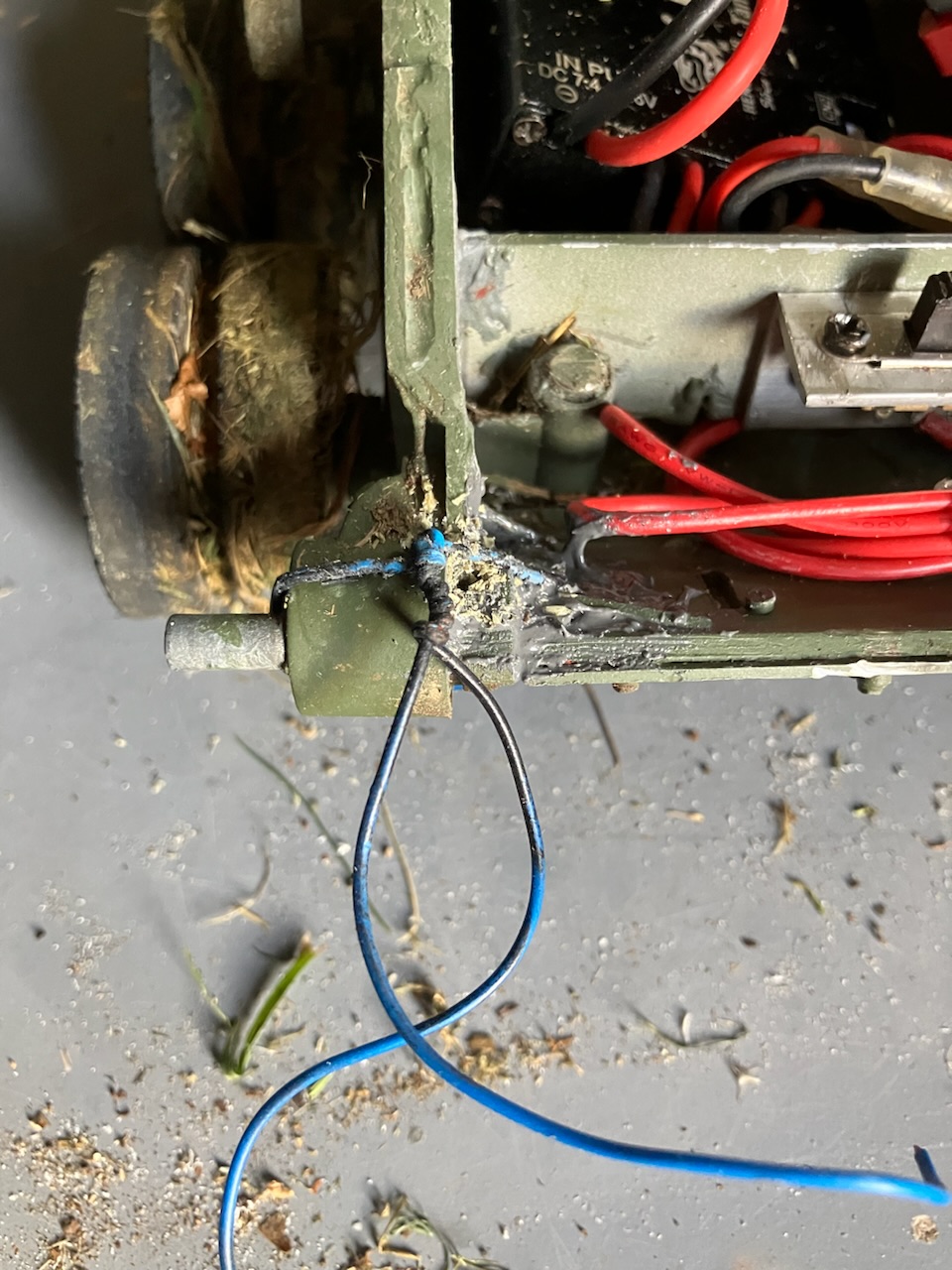

During my snow adventures, the well known hull fault of the area around the front idler splitting..
So I took it into work, and spoke with my resident friend, to work out how to repair it. My friend may not be able to remember what he had for dinner 10 minutes ago, but given an opportunity, he comes alive when given a task like this. He suggested pulling the parts to get her with some wire. And filling the area with epoxy.
We gave it 24 hours to dry for a successful repair.

What is the diameter of the axle that the idler rides on? I wonder if a brass rod of the same diameter could be installed across the tank and be drilled and tapped to receive the mounting screws. Alternatively a brass tube filled with solder could make machining easier (obviously making the solder tube version before installing in the plastic hubs).

I am definitely going to have to rethink the repair from earlier. I have an idea, if I can find the required parts.

A repair has been performed on the T72. Just in time for some anticipated snow. This should be a long term repair, and remove the issue of the front hull splitting.
