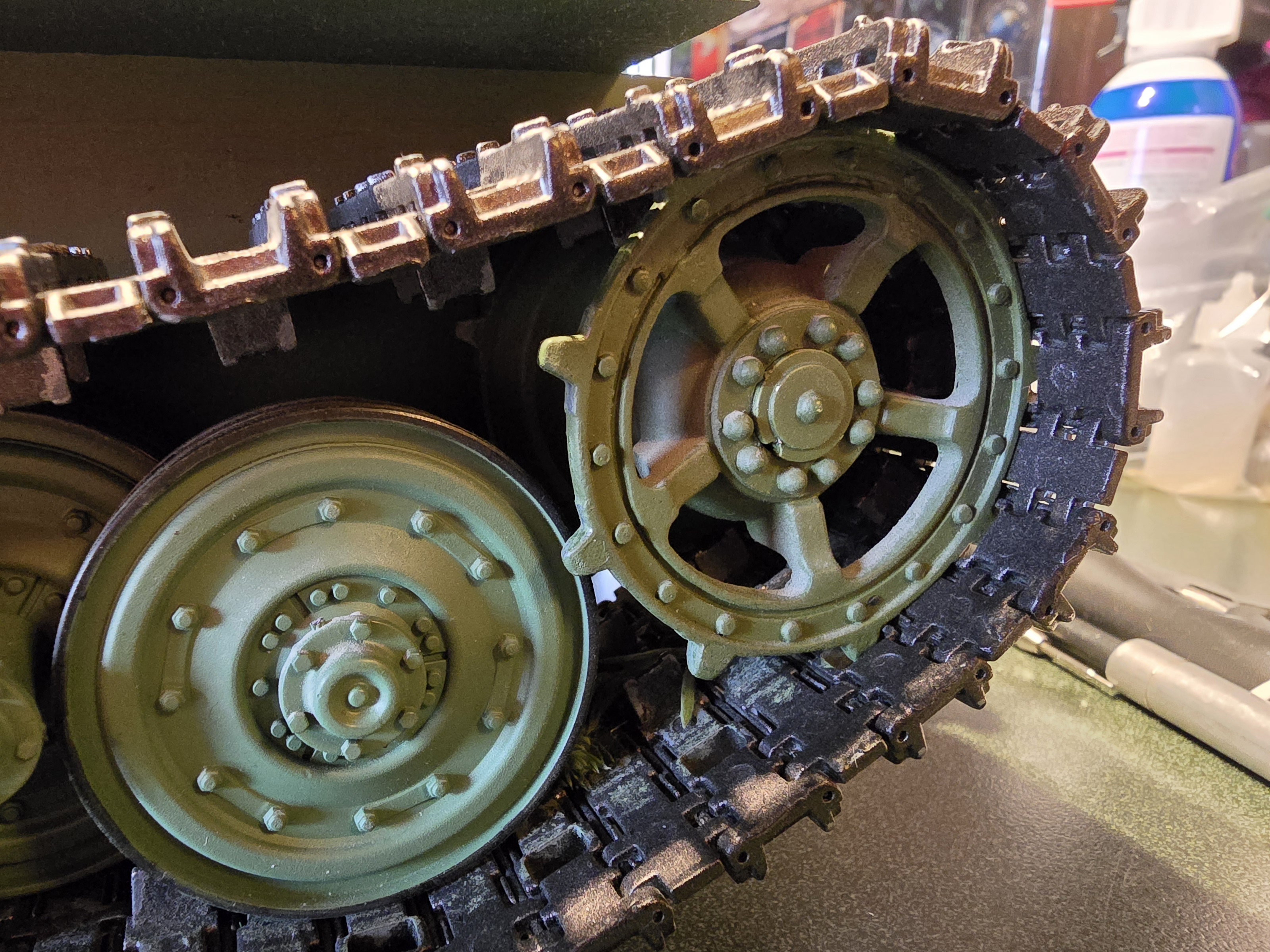

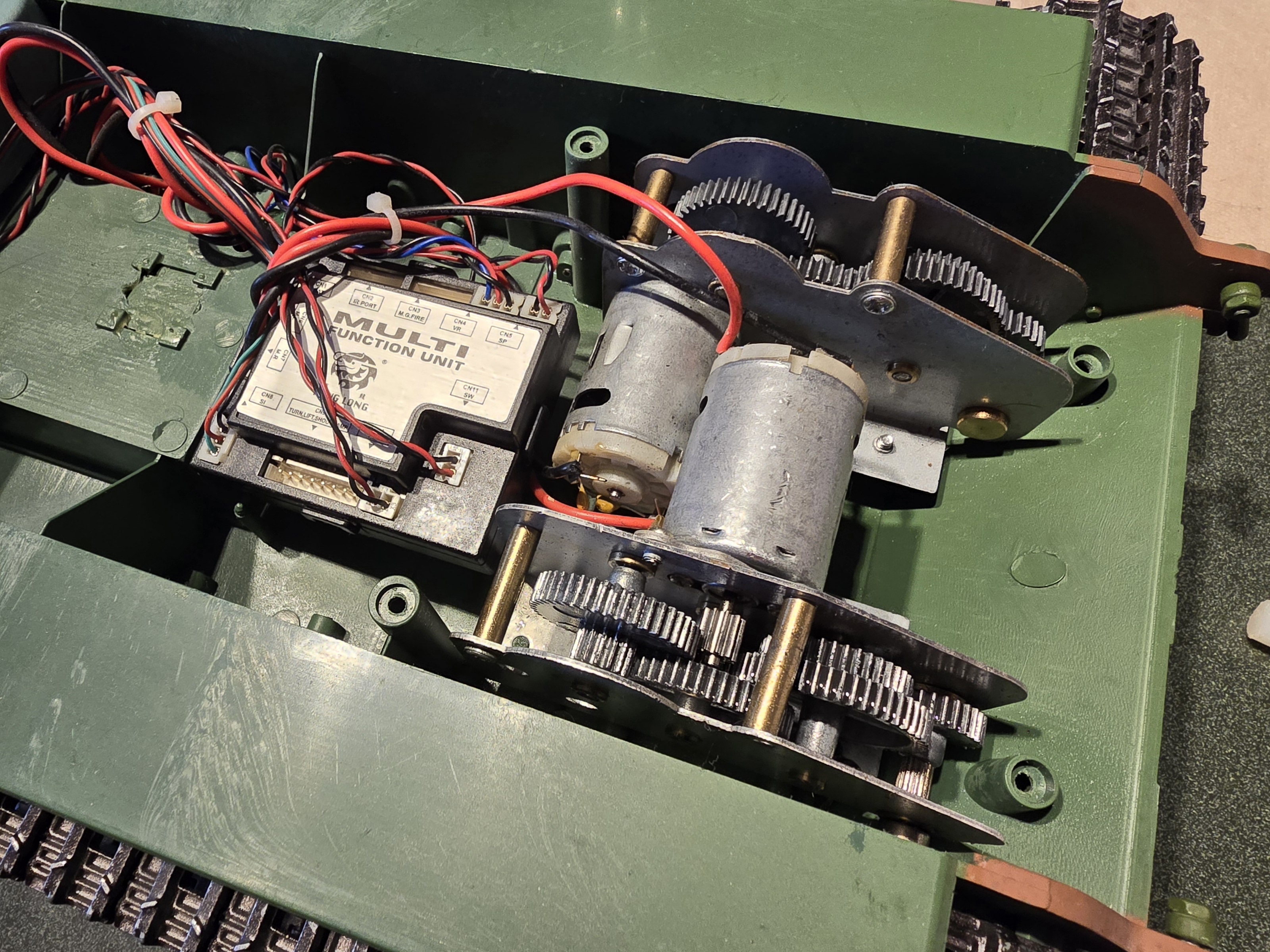

Good Evening all,

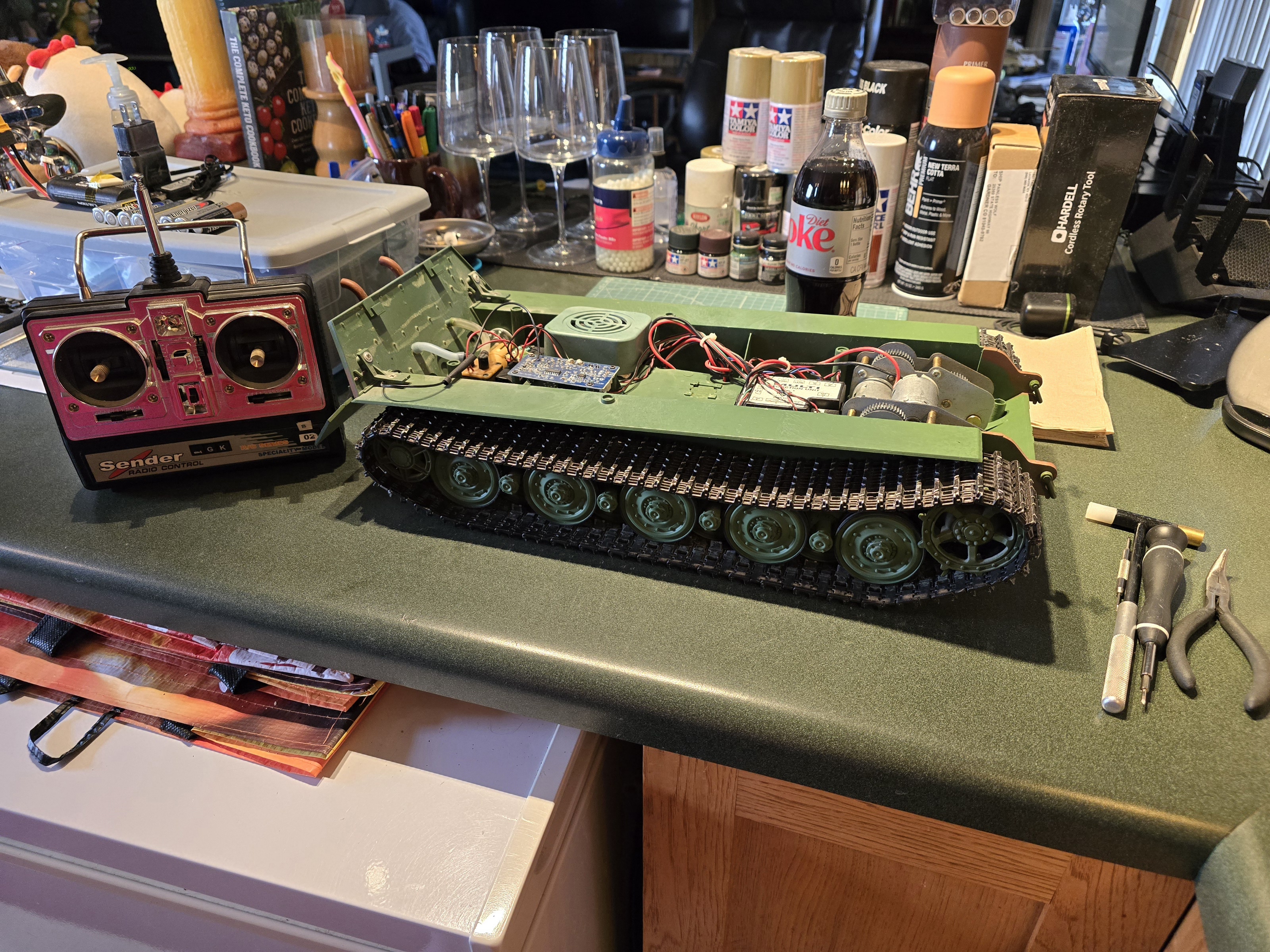

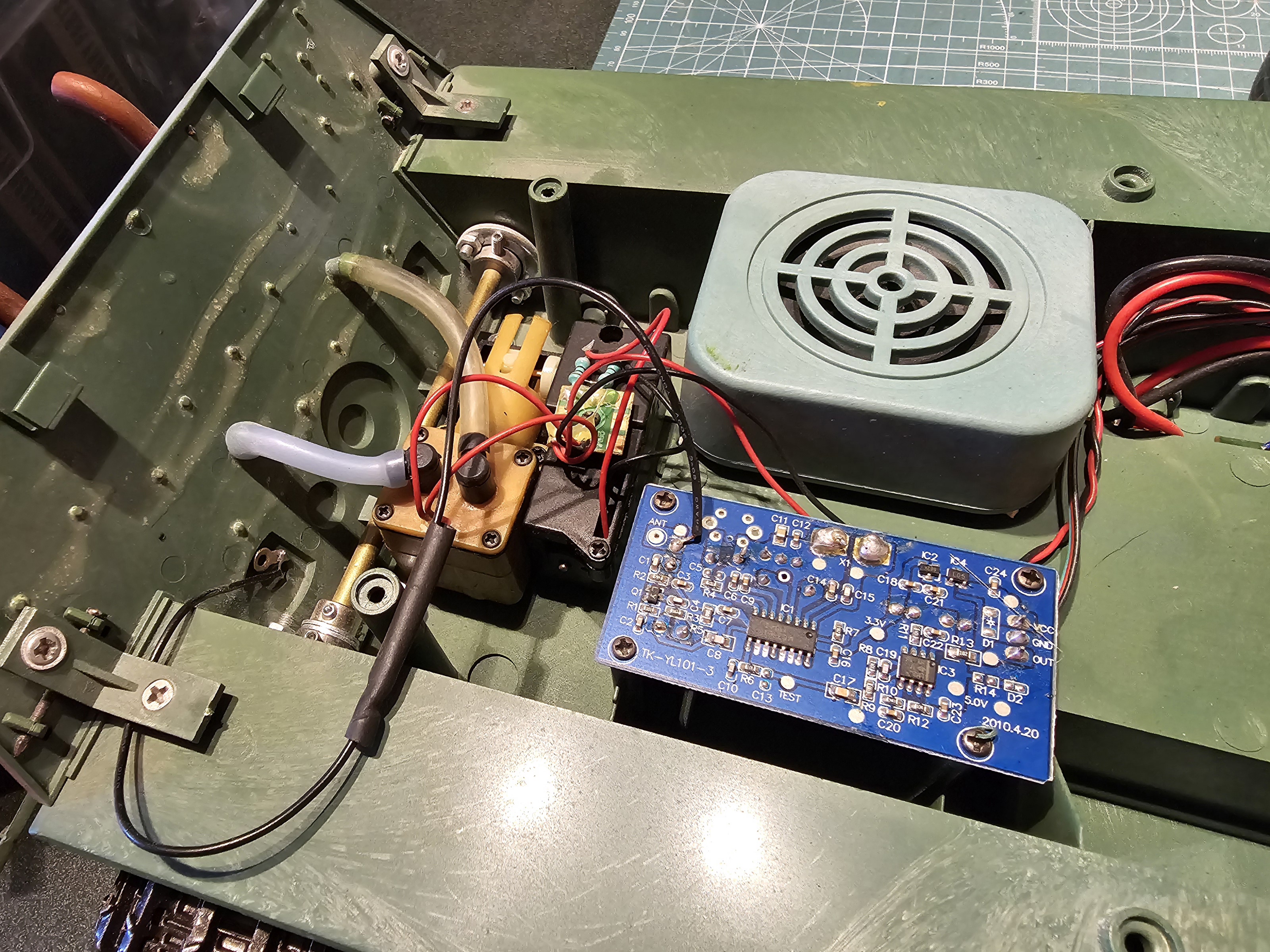

I took the Old Porsche Turret King Tiger apart last night and was pleasantly surprised. The receiver is a Crystal unit, yes but the MFU is more modern than I thought. Still an old unit but not the open board with everything hardwired to it that I had thought. Today, I repaired most of the running gear issues ( broken pin and misaligned track and idlers ) The Lower had detweaked itself just by being off the block and having it's weight sitting on the tracks again after years on a pedestal. I lubricated the white metal gears and put a little good quality smoke fluid in the Smoker to test and took the Lower outside to run it for a bit. I ended up reseating a couple more pins and cussing a bit when I had put the track back on in the wrong groove on one of the rear idlers once. The last run was Gold with this Beast chewing up rocks and weeds and doing one track skid turns in rough terrain with ease. I believe that a set of metal wheels to match the tracks, sprockets and idlers along with some sprocket bushings for the lower hull and new metal suspension arms by Heng Long ( not Asiatam as is currently installed) will see the running gear finished. The old HL smoker is toast. Pumps good but the heating element is dead. They make much better smokers today so not a hard item to replace. Still on the fence about a set of steel gears. The white metal ones still look new. Noisy as Hel tho' I had forgotten that ;o) More to come,

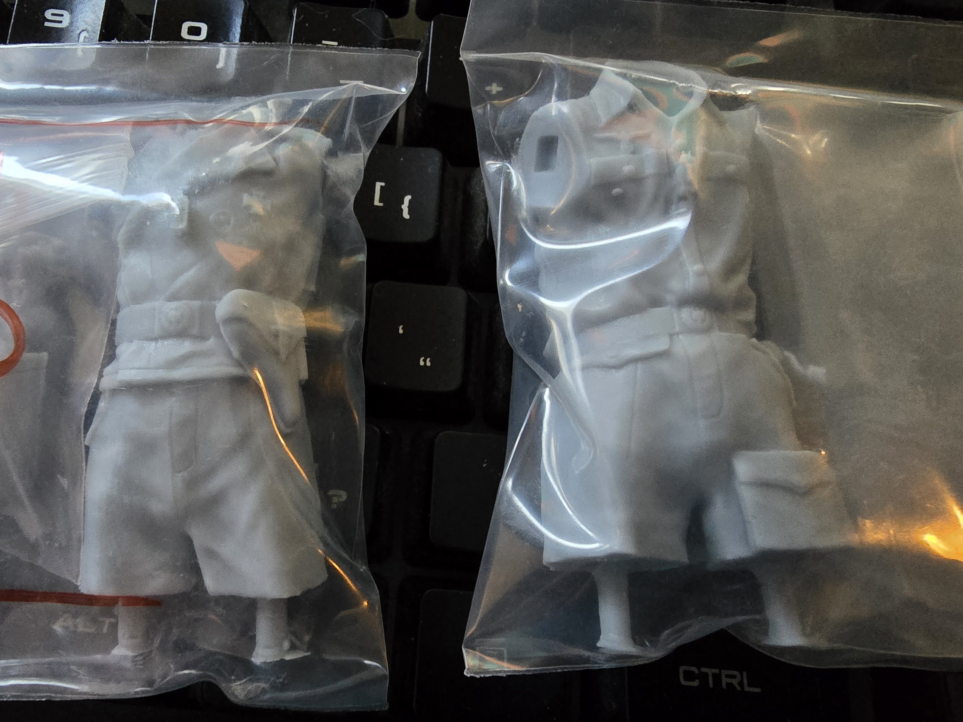

Not much going on Build-wise. I have been carefully removing the tools and cables and fittings from the tank. Today I did get in the 'w\Commander' part of the Build. A Big resin improvement over the original Figure from back in the day.

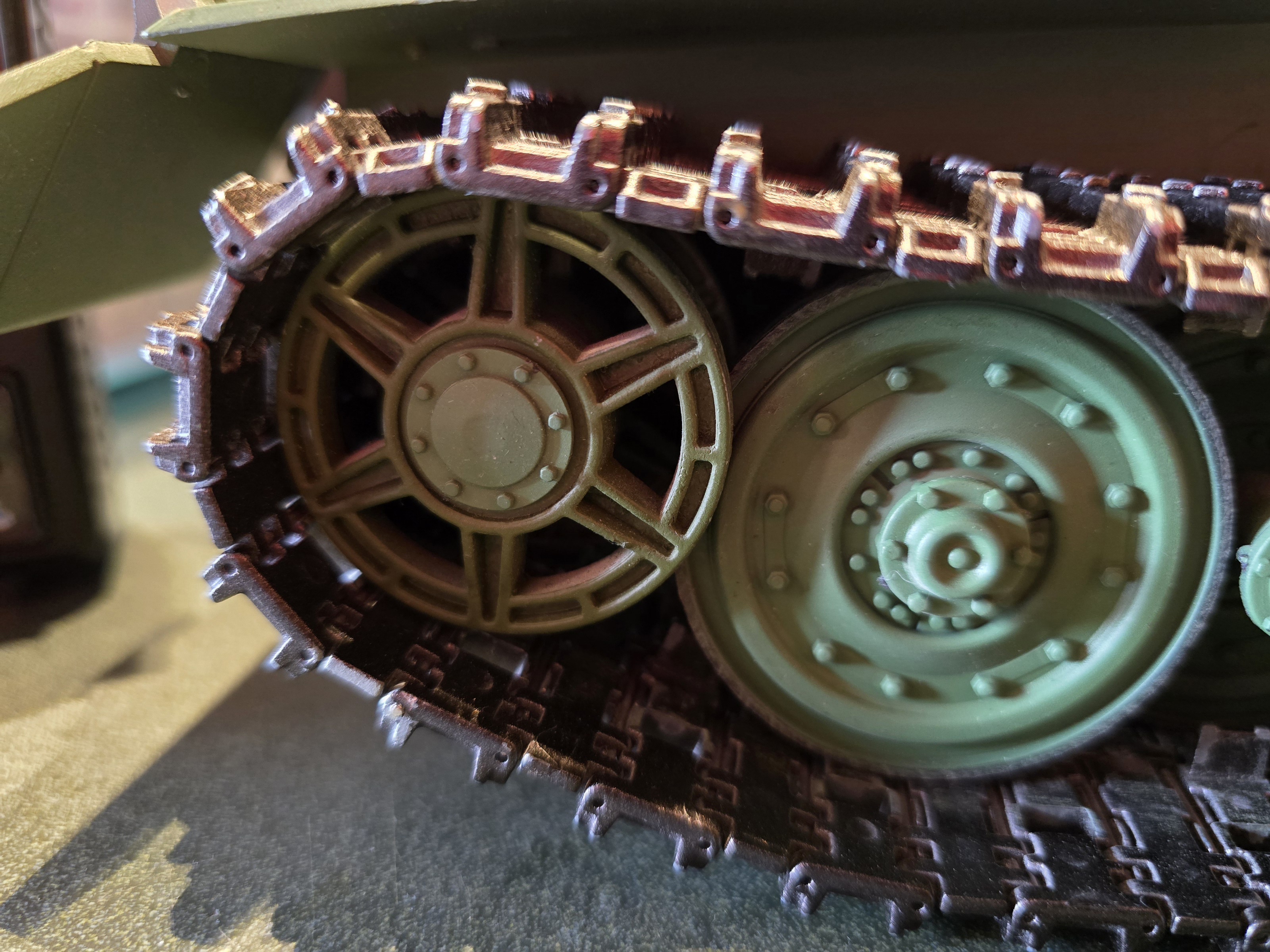

Good Morning, my Friend,
Luke and Luna have grown into themselves quite well. Luna knows that she is the 3yr old Princess of the Household, entitled to a little bit of whatever her Papas are having ( as long as it's not bad for her Doggy Constitution ) Luke is 1 yr old and still curious about everything, (except loud Panzers) He is huge and has grown into Jacks pawprints so well. A Giant in every way. Now, to the Tiger IIs, The new King Tiger runs and sounds so Good! using the 7.0 board that it will definitely keep using that Set Up for now. If I feel the need for a receiver and use on the Flysky Controller, I can do so. It will receive a detail job and paint to match the one planned for the old Pre Production turrreted King Tiger. No Zimmerit on it, Too late in the War for this Beast for that. Look for lots of Dunkelgelb and Rottbraun. The Porsche KT will get the Zimmerit treatment and a set of metal road wheels and suspension arms. The ones fitted currently ( Asiatam metal arms ) are a tiny bit too long and the effect is cumulative, causing binding in some spots when the suspension is flexed. The same sort of Detail and Paint Job for it as well. The electronics work great for the year that it was built. On the fence about using them as is. I will replace the non functioning Smoker and already have a better speaker in stock to use if I decide to employ a newer one. Jarndice, everything works, movement-wise, so I feel odd about picking it apart electronically as it is a picture window into early Heng Long. ( Even the BB Cannon works as it should ) You and your Wife have certainly had your share of Medical Misadventure. The part about her back heartens my mood since that is one of my major worries,(winding up in a chair the rest of my days) Keep an eye out for any niggles because at our age, it could be almost anything. As for getting better, I am moving at the pace that the Insurance Company and the Neurosurgeon have set. Before the Surgery, it will be a series of Shots to kill the massive infection that I have somehow managed to get around my Lumbar Spinal area. Sounds like 'Fun'. Take care and thank you for looking in on this late Build. ( and Me! )
