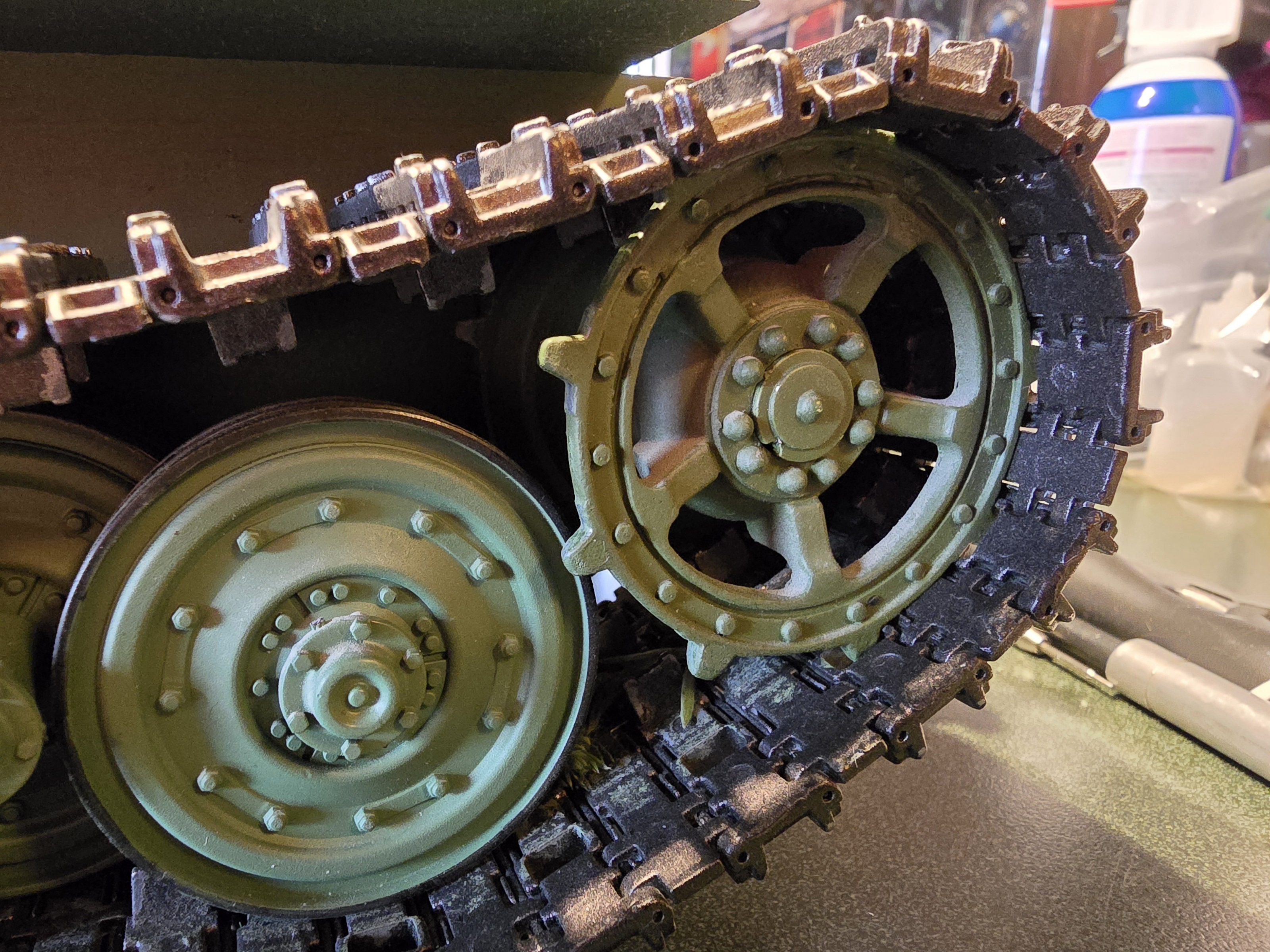

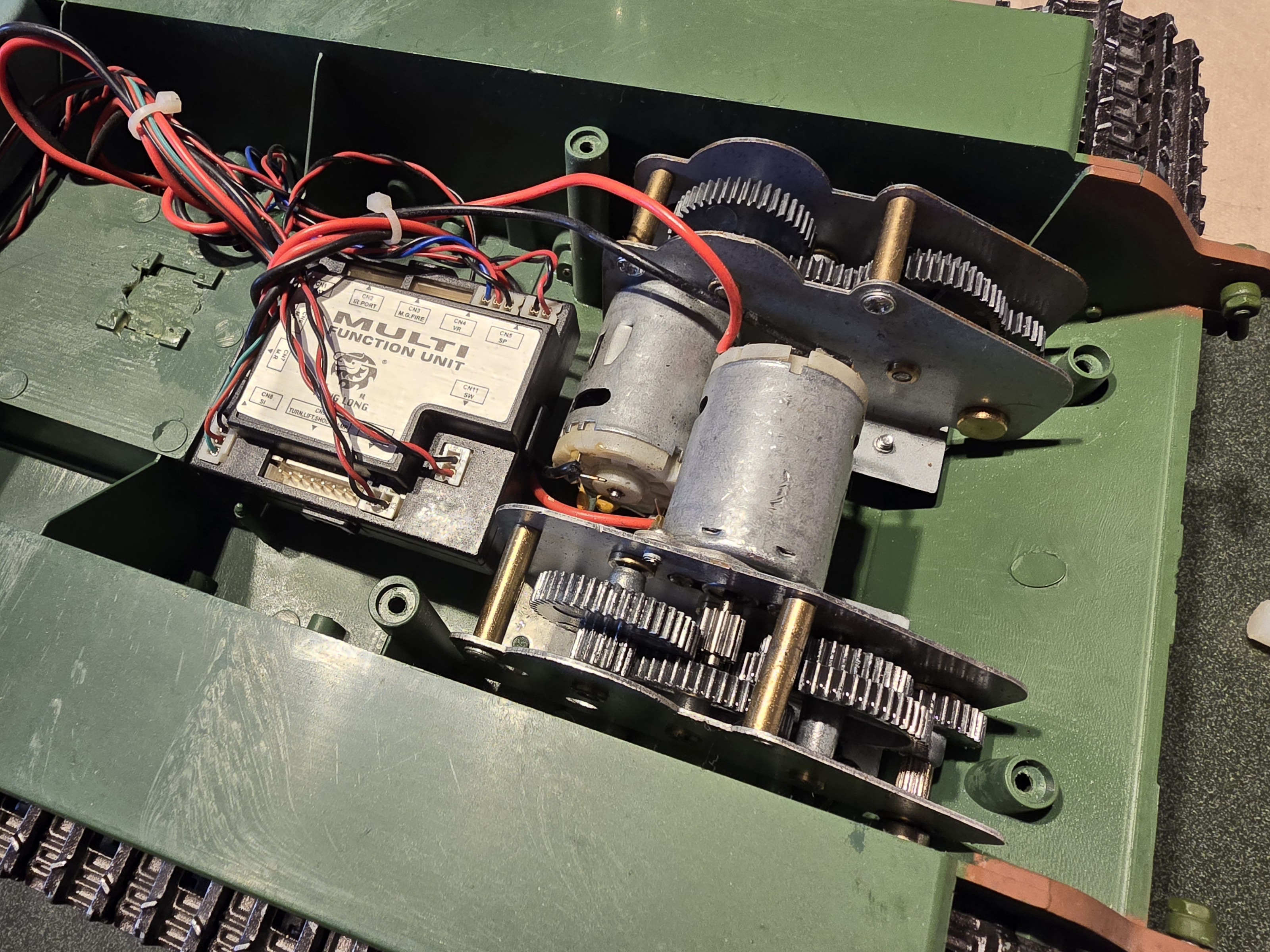

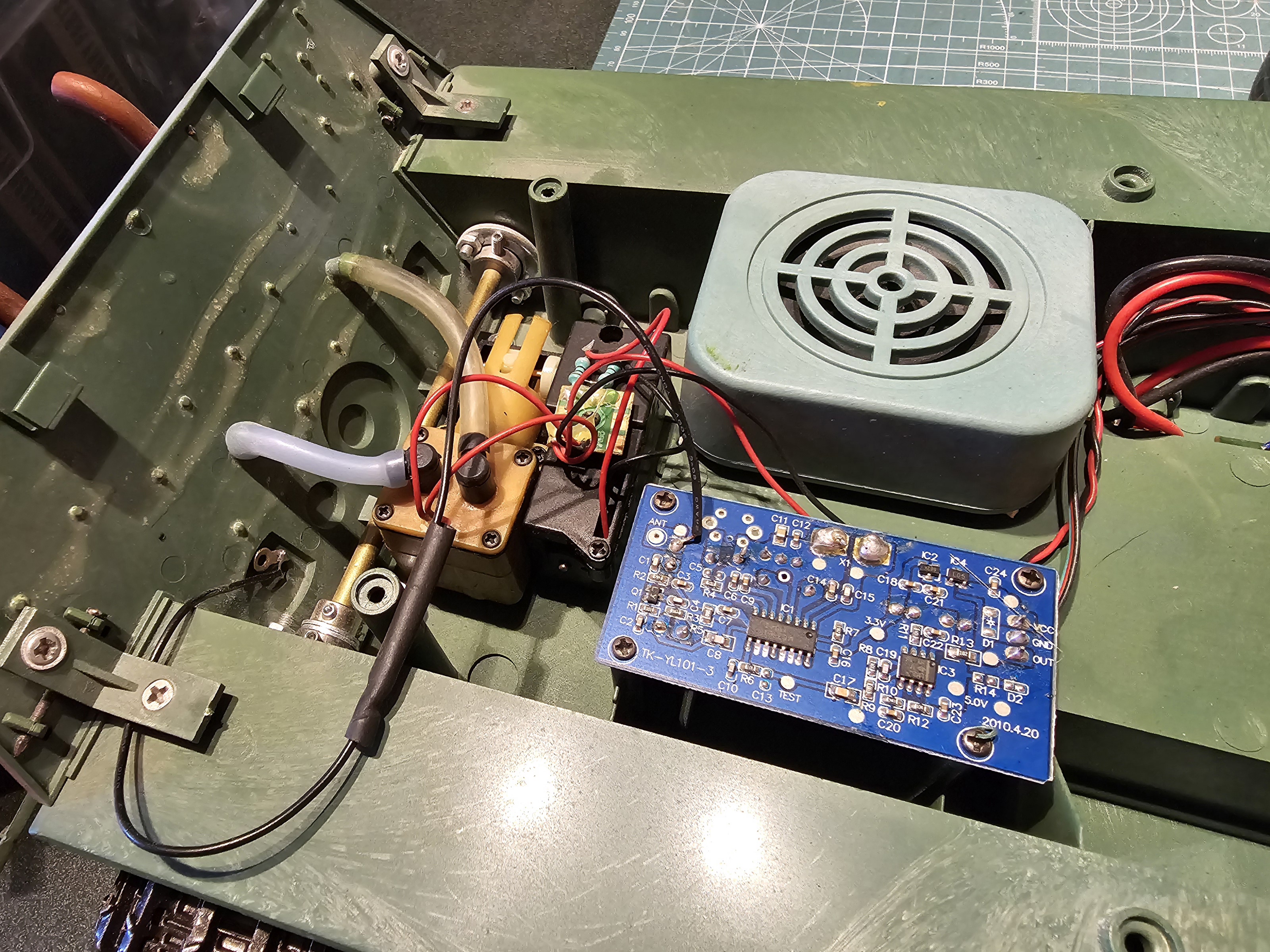

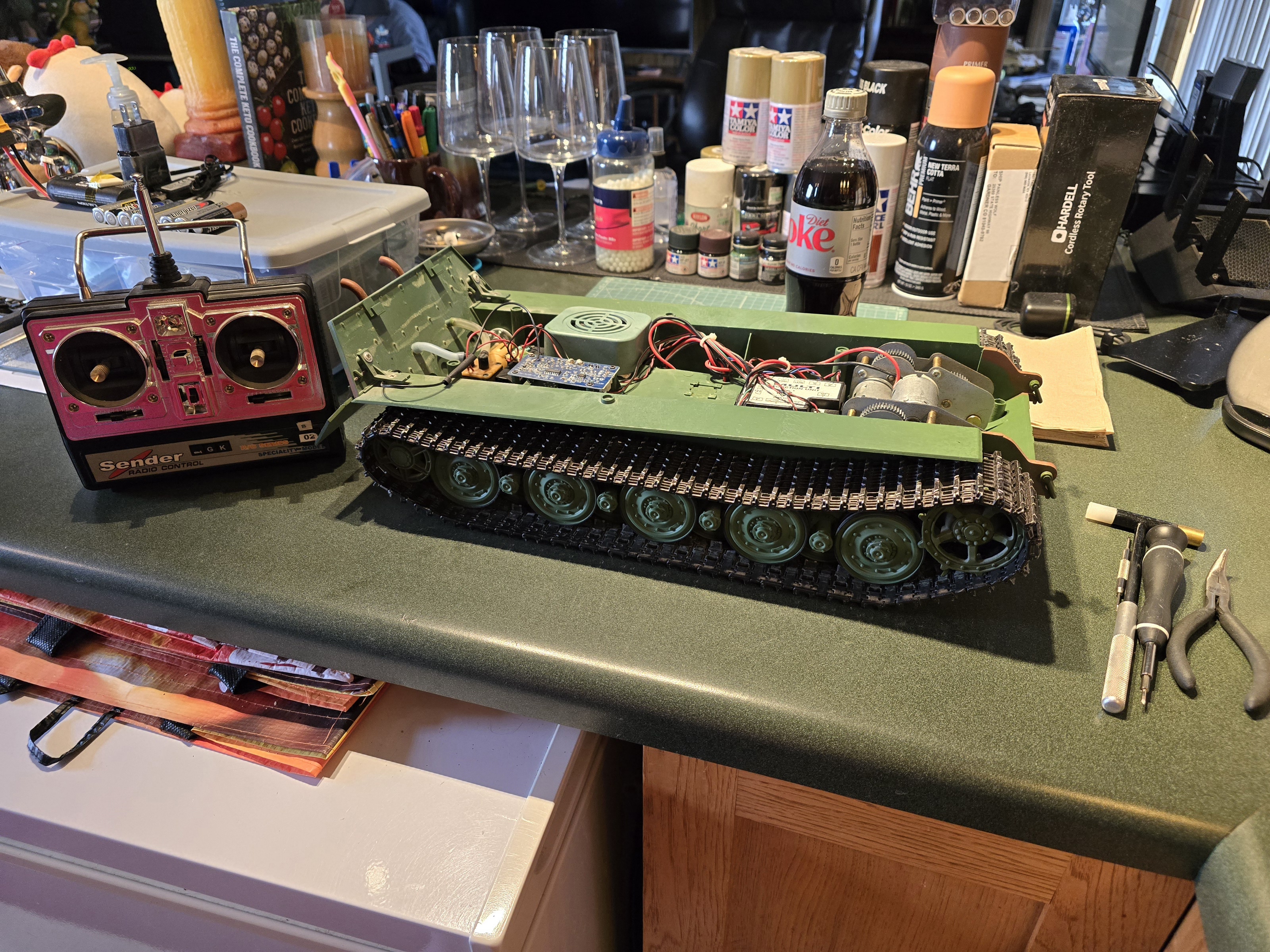

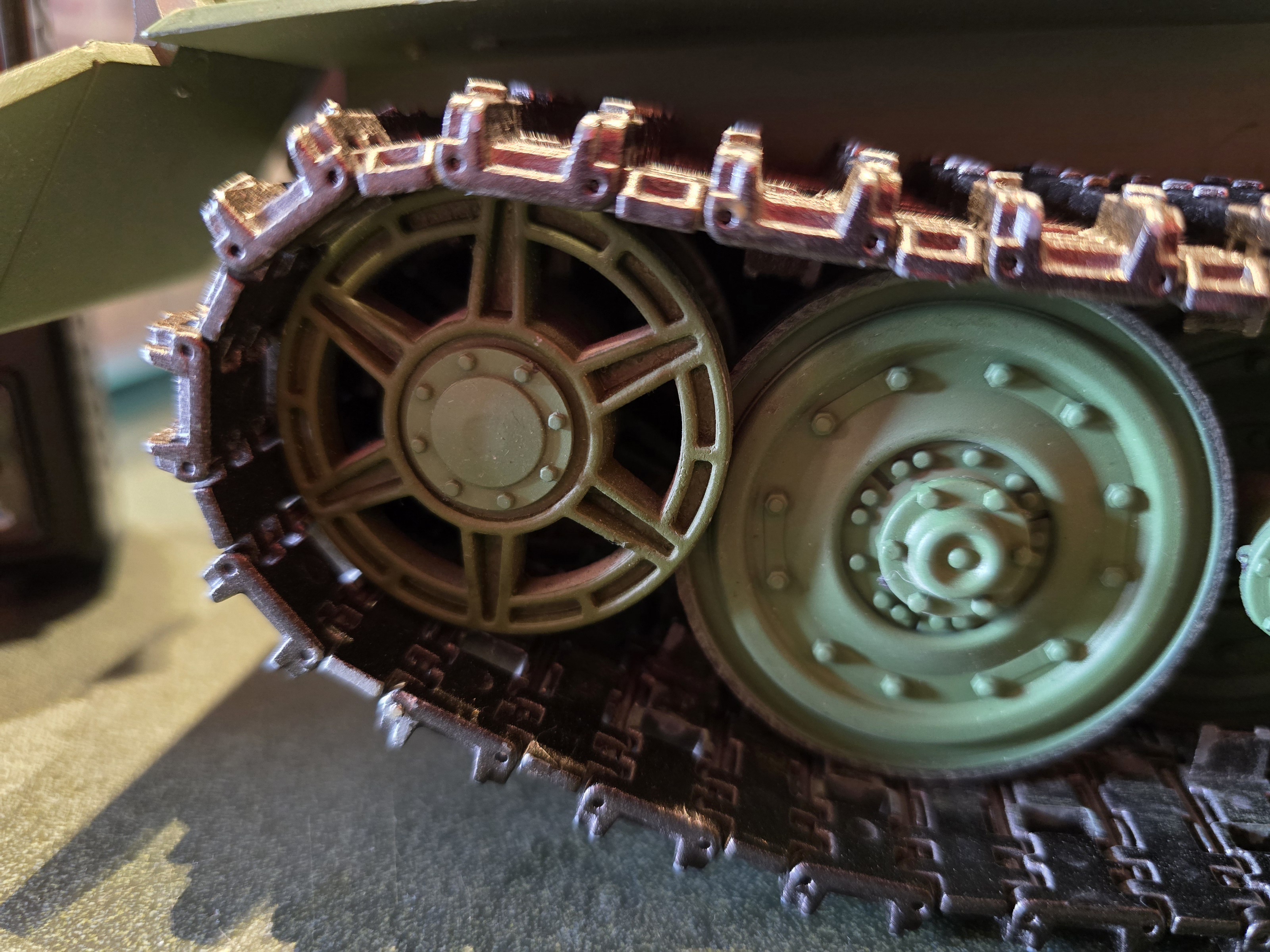

I took the Old Porsche Turret King Tiger apart last night and was pleasantly surprised. The receiver is a Crystal unit, yes but the MFU is more modern than I thought. Still an old unit but not the open board with everything hardwired to it that I had thought. Today, I repaired most of the running gear issues ( broken pin and misaligned track and idlers ) The Lower had detweaked itself just by being off the block and having it's weight sitting on the tracks again after years on a pedestal. I lubricated the white metal gears and put a little good quality smoke fluid in the Smoker to test and took the Lower outside to run it for a bit. I ended up reseating a couple more pins and cussing a bit when I had put the track back on in the wrong groove on one of the rear idlers once. The last run was Gold with this Beast chewing up rocks and weeds and doing one track skid turns in rough terrain with ease. I believe that a set of metal wheels to match the tracks, sprockets and idlers along with some sprocket bushings for the lower hull and new metal suspension arms by Heng Long ( not Asiatam as is currently installed) will see the running gear finished. The old HL smoker is toast. Pumps good but the heating element is dead. They make much better smokers today so not a hard item to replace. Still on the fence about a set of steel gears. The white metal ones still look new. Noisy as Hel tho' I had forgotten that ;o) More to come,

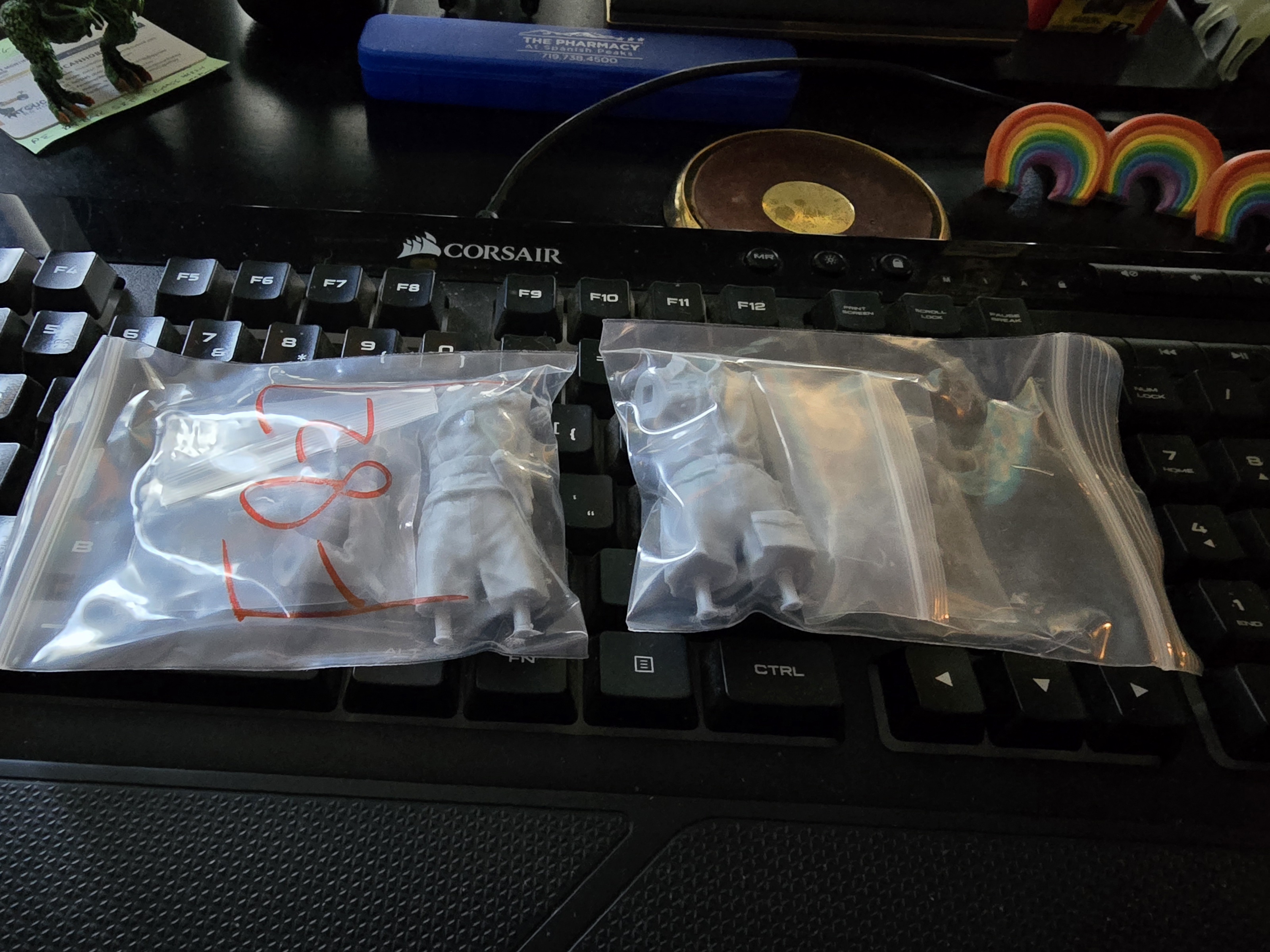

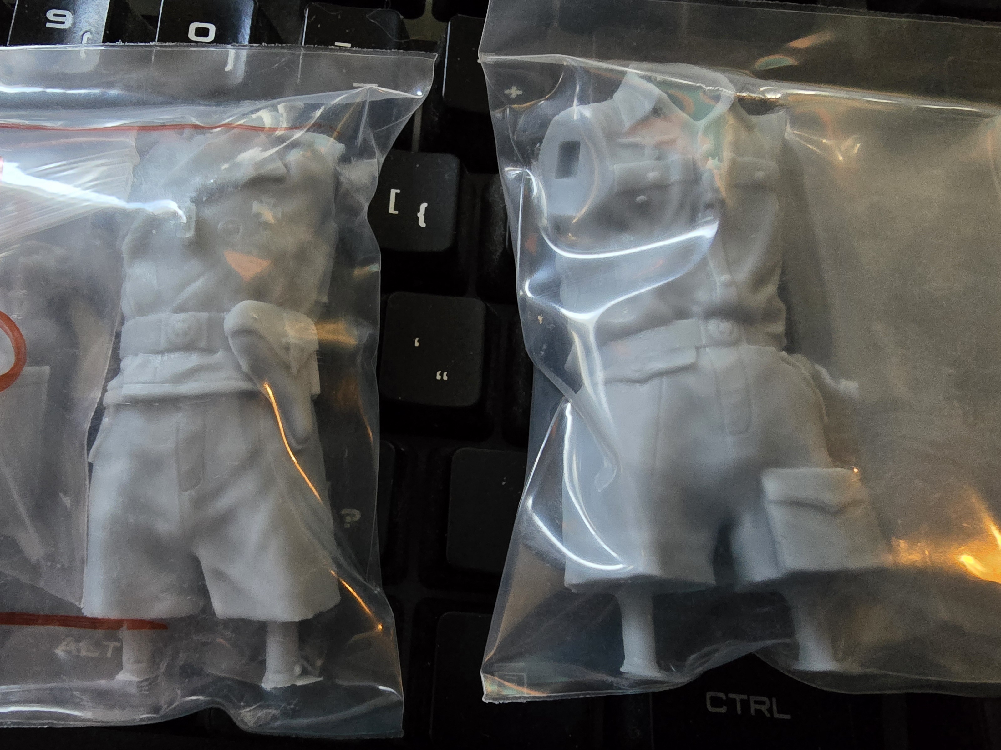

Not much going on Build-wise. I have been carefully removing the tools and cables and fittings from the tank. Today I did get in the 'w\Commander' part of the Build. A Big resin improvement over the original Figure from back in the day.
