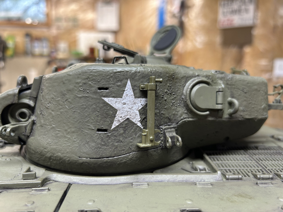

This T26E3 turret is ready for aftermarket spare tracks from East Coast Armory and/or some packs or tarps. Note that the tone of the Olive Drab on the jack is different from the OD on the turret. I used three brands of FS34087, Tamiya, Vallejo, and Model Master, for the real tanks carried attachments made by different manufacturers. Despite the Federal Standard, the paint would not have matched perfectly.
T26 RTrrt.jpg (196.01 KiB) Viewed 3255 times
Here's a spot where I left the holes unfilled, as I knew I wanted to use some stowage. I hope to use a jerry can WCP sent me just recently, but I want to confirm first that the reinforcing X on the can was painted in white to indicate that it carried water, not fuel. The "Lift Here" markings left from shipping show up on one of the few photos of at T26E3 at Remagen. There's one at each corner of the tank, because it was considered important to only lift the tank by the special attachments.

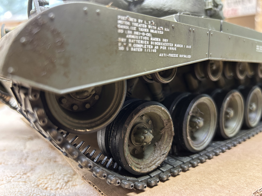

At least one of the T26E3s at Remagen was still in shipping markings. Here's an example of details of lubricants, coolants, etc.
T26 LFQtr.jpg (208.8 KiB) Viewed 3252 times
