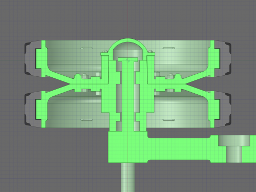

Not so much progress on the wheel printing yet, unfortunately. Herman's Taigen wheel arrived this week and it's significantly different to the Heng Long wheels I'd based my designs on both in terms of dimensions and structure. I'll rework my drawings to suit the Taigen axles, bearings and tyres which might take another few days since it's not as straightforward as I imagined it would be.

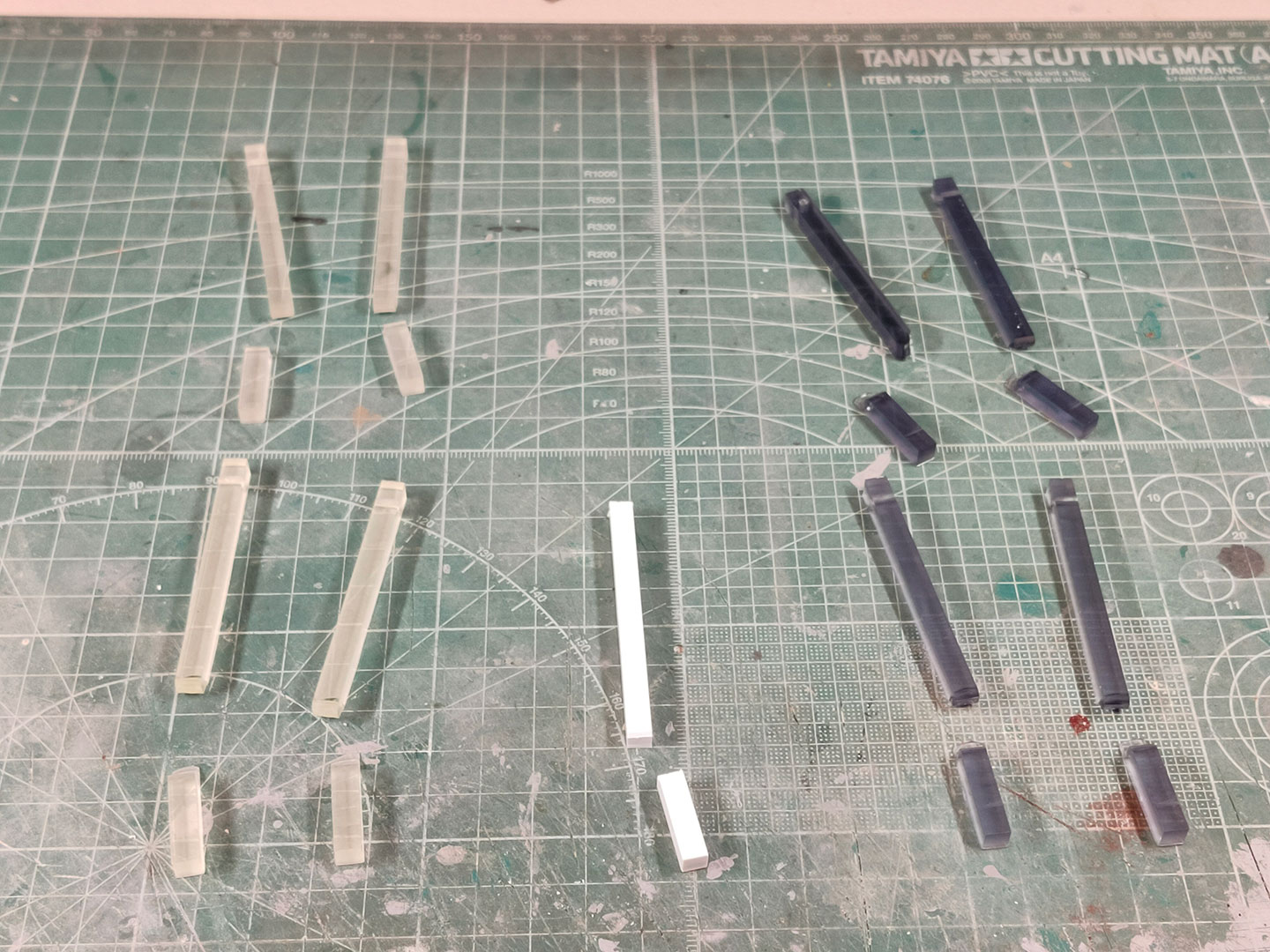

In the meantime I've been doing a little bit of science. To be completely honest with you guys, I've already spent all of the proceeds from selling the SU-85 on various bottles of resin; mostly strong engineering stuff. Some of these are about AU$100 for a one kilo bottle! I whipped up a test shape 5 x 5 x 80 mm with an inbuilt breakpoint. I then measured (in duplicate) the amount of force that they could take at a 45° angle before failing. I also made a comparison test piece out of 5 x 5 mm styrene bar. The results were interesting, but probably don't tell the whole picture:
Build is certainly more rigid than Blu but that may come at the cost of being more brittle, especially with fine details. From what I've read, Blu + Tenacious is the go-to when it comes to strong resin for functional parts, and it has a generous amount of flex which would likely save it from most failures but I doubt that road wheels are going to be subject to the kind of impact forces that would crack them. Once I figure out a Taigen-friendly design for the wheels I might print off a few in each type of resin and see if there are any differences.
Code: Select all
Blu 2098 g
Blu + Tenacious (2:1) 1982 g
Build 2961 g
Build + Tenacious (2:1) 2836 g
Styrene control 1884 g- Raminator

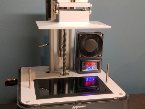

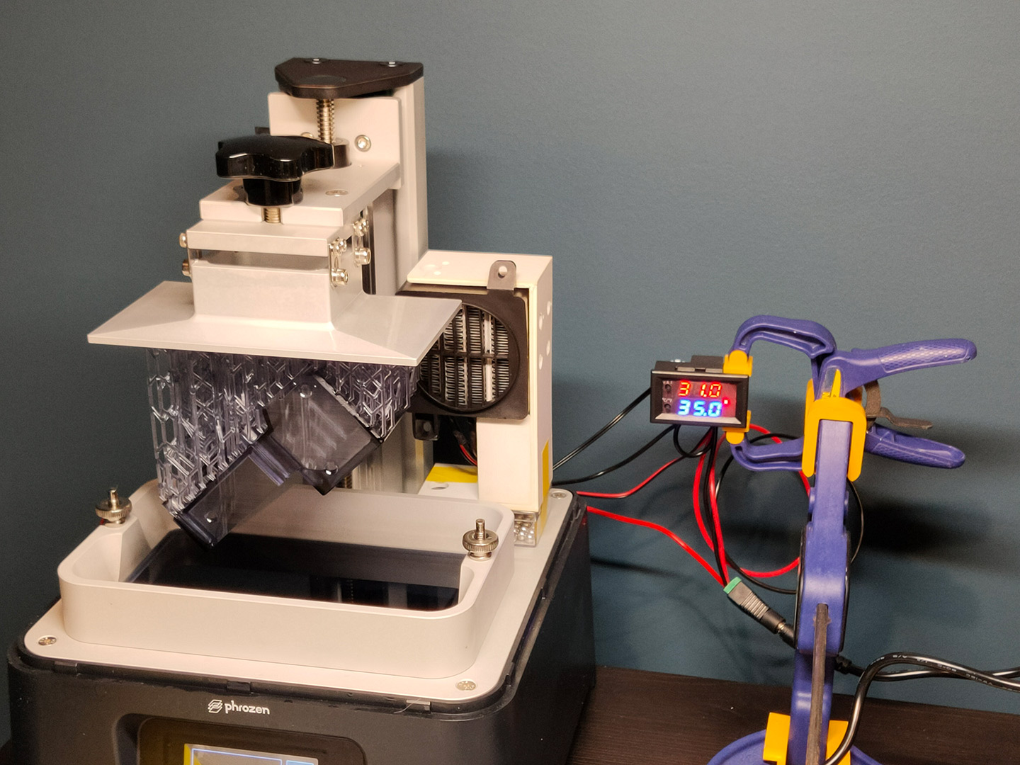

Also spent some time this week fixing up the heater. The original setup wasn't exactly high-tech or long-term:
Safety first! The reason I bought the Build resin in the first place was its temperature resistance, it will work well in an enclosure for the heater and its electronics.

The opposite, actually! They're a better design than the Heng Long ones I'd based mine off.HERMAN BIX wrote:Sorry the Taigen set up is less than ideal![]()
I've redone the hubs to match the Taigen design. I figured if I replicate their setup as closely as I can, then it should be possible to pair one of my outer wheels with a Taigen inner. It's not as good as a full metal set, but it might do!
