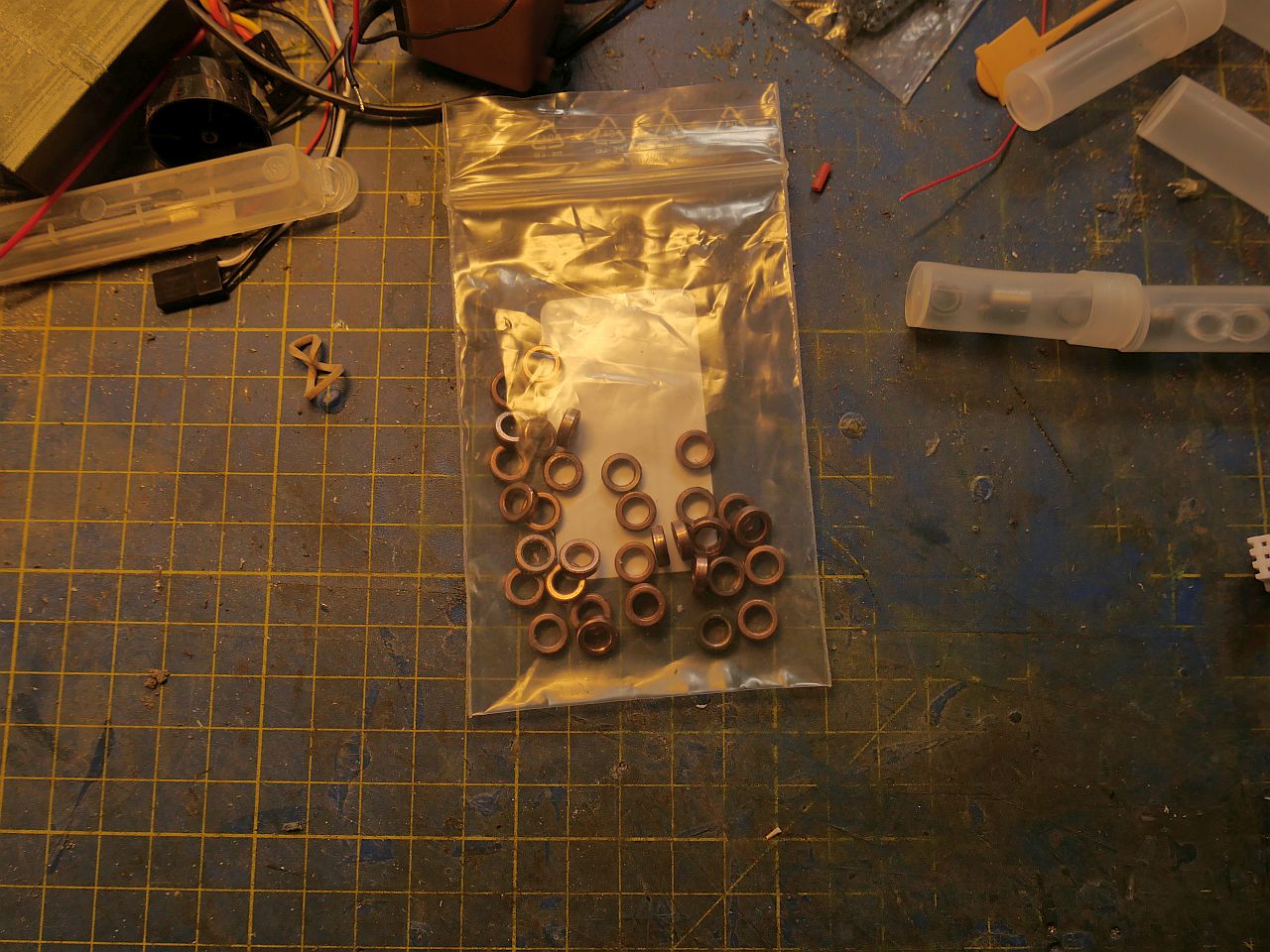

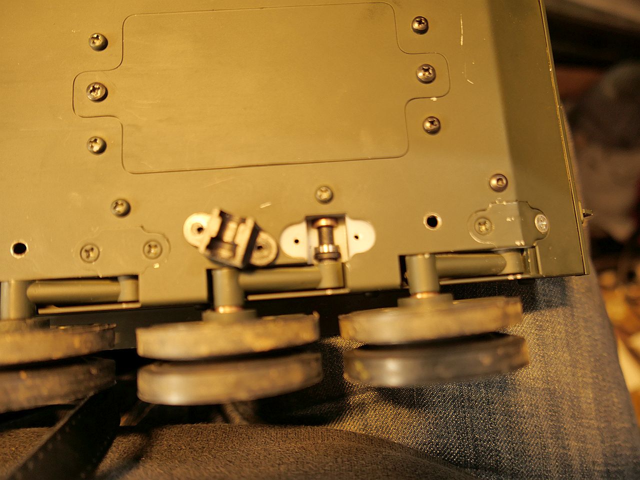

today i took a look at the suspension,
without serious modifications there is not much that can be improved.
The swing arm bearing brings a surprise:
1x sintered metal bearing and 1x ball bearing not sealed:
I replaced these completely with sealed ball bearings
also on the rollers and idlers:
Now the Cromwell drives very slowly, nice and soft.

Model Builder 4 wrote:Good to see that they can be upgraded, what size bearings are needed and how many total? :thumbup:
Cheers,Lee.
The Ball bearings are MR85-2RS
outer diameter 8mm
inner diameter 5mm
2,5mm wide
you need:
2 on every swingarm = 20
2 on every roler = 20
2 on both idlers = 4
in total = 44
