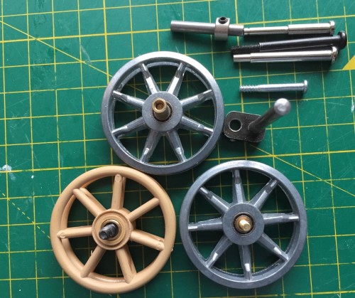

So...it's back to the idler issue. Yes, the idlers are not an easy fit either. I have no kind of axle (whether from HL or Taigen) that will pass through the metal idler bearing and the suspension arm of the Henntec unit. I have a brass screw that's a good fit for the bearing in the metal idler, but is almost 2mm too small in diameter to fit in the Henntec unit. Then there's the cheapo plastic idler with it's incorporated self-tapping screw. It almost Fits in the Henntec. With a bit of filing, and judicious use of the Henntec arm's grub screw, it could be made to fit. But... I really wanted to use the metal idlers, with their superior built-in bearings (The plastic Pz 111 unit only has a bronze bush...). :problem:
Comet build-drivetrain-idler options
This is the plastic option. The screw almost passes thought the Henntec suspension arm. With filing, it would.
Comet idler- metal option 1
here the brass screw that fits the metal idler's bearing perfectly has been threaded into a tapped brass bush. Unfortunately, the bush is over 4mm in diameter, and the hole in the Henntec arm some 3.6mm.
With a lathe I could reduce the bush in size; but I haven't got one. Alternatively, I could drill the Henntec arm so that the bush would fit- but I really don't want to do that.
The third option is where I retain the metal idlers with brass screws, but make a sleeve out of brass tubing to make fit in the Henntec unit a tight one, when the grub screw is tightened. The brass collar could be sawn along its length to allow it to compress (a) around the brass screw; and (b) to slide tight inside the Henntec arm. The grub screw would prevent it from coming adrift. Well, that's the theory. The best laid plans o' mice and men, eh?
Here's the screw passing through the Henntec arm. Given that the Henntec's grub screw can take up play on one side, it might not even be necessary to have an insert sleeve that goes all the way around the screw.
Don't imagine for one moment, future builders, that progress will be smooth with builds like these. There are more hurdles here than in the Grand National. :problem: :lolno:

Well, I looked at the idler options (..and no, I don't mean the Life of Leisure ones :lolno: ). The plastic one was just about workable; but the assembly is wobbly and wonky. Then again, the plastic idlers for the Pz 111
are fairly cheap.
The option to make shims out of 5mm brass tubing had promise; but didn't deliver. It looked, and felt, messy.
Thus- it was down to the milling of the tapped brass sleeve option. These brass tubes are left over from a Tiger 1 suspension upgrade idea. They were originally fitted to a bar that stiffened the hull sides, whilst providing

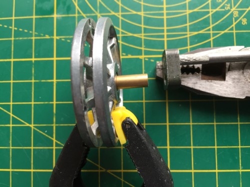

Anyway, by a stroke of good luck, I had some brass screws that were a perfect fit for these threaded studs/standoffs
Out came the trusty Dremel, as I don't have a lathe or hobby milling machine in my ever-burgeoning collection of specialist tools. As it happens, there's scarcely any room for additional hardware these days... :problem:
Comet build-axle sleeve for idler
Sorry about the grainy quality of the image. It was taken in low light conditions.
Then I used a captive metal file as the cutting edge of the improvised 'lathe'.
Milling idler sleeve to fit Henntec suspension arm
Idler sleeves for Henntec stub axles.

It's looking good. I added some washers either side of the metal idlers in order to support the axle bearings. Then, took a provisional measurement from the centre line of idler halves (where the track horns pass through)
to the sidewall of the tank. The gap was just around the 18mm mark. This means that when the Pz 111 return roller mountings are fitted, the 18mm alignment target for the complete drivetrain looks doable.
Now that the idlers look ok, I should be able to fit the glacis plate as well as the front mudguards. :thumbup: (Barring any other unforeseen hitches :/ ...but, it seems, they can never be discounted.)
