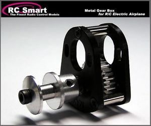

There is this,if possible to adapt accirding to place ?
https://www.axels-modellbau-shop.de/kat ... milie.html
Expensive but axis,diameter 2.3 m/m
In Ebay,China,
Axis,diameter 5 m/m
