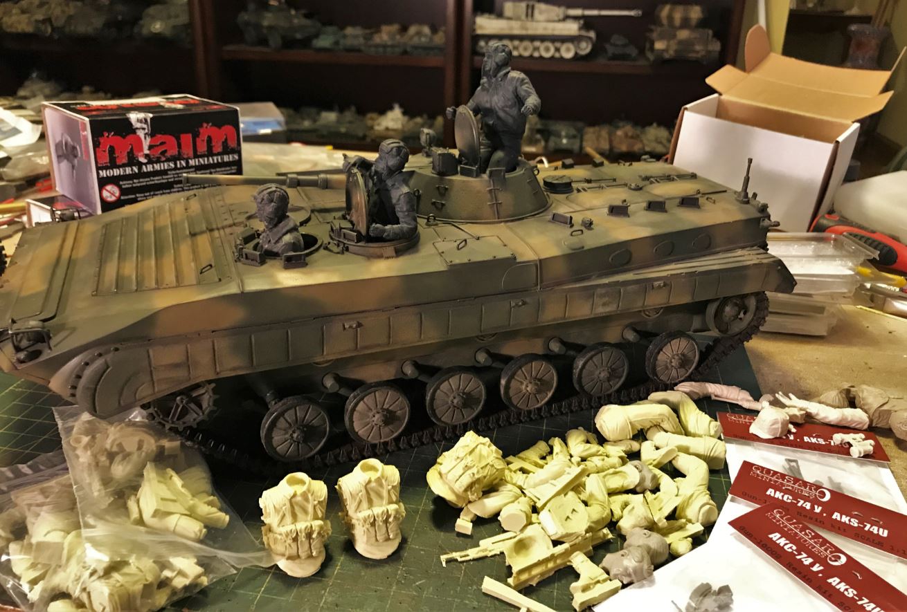

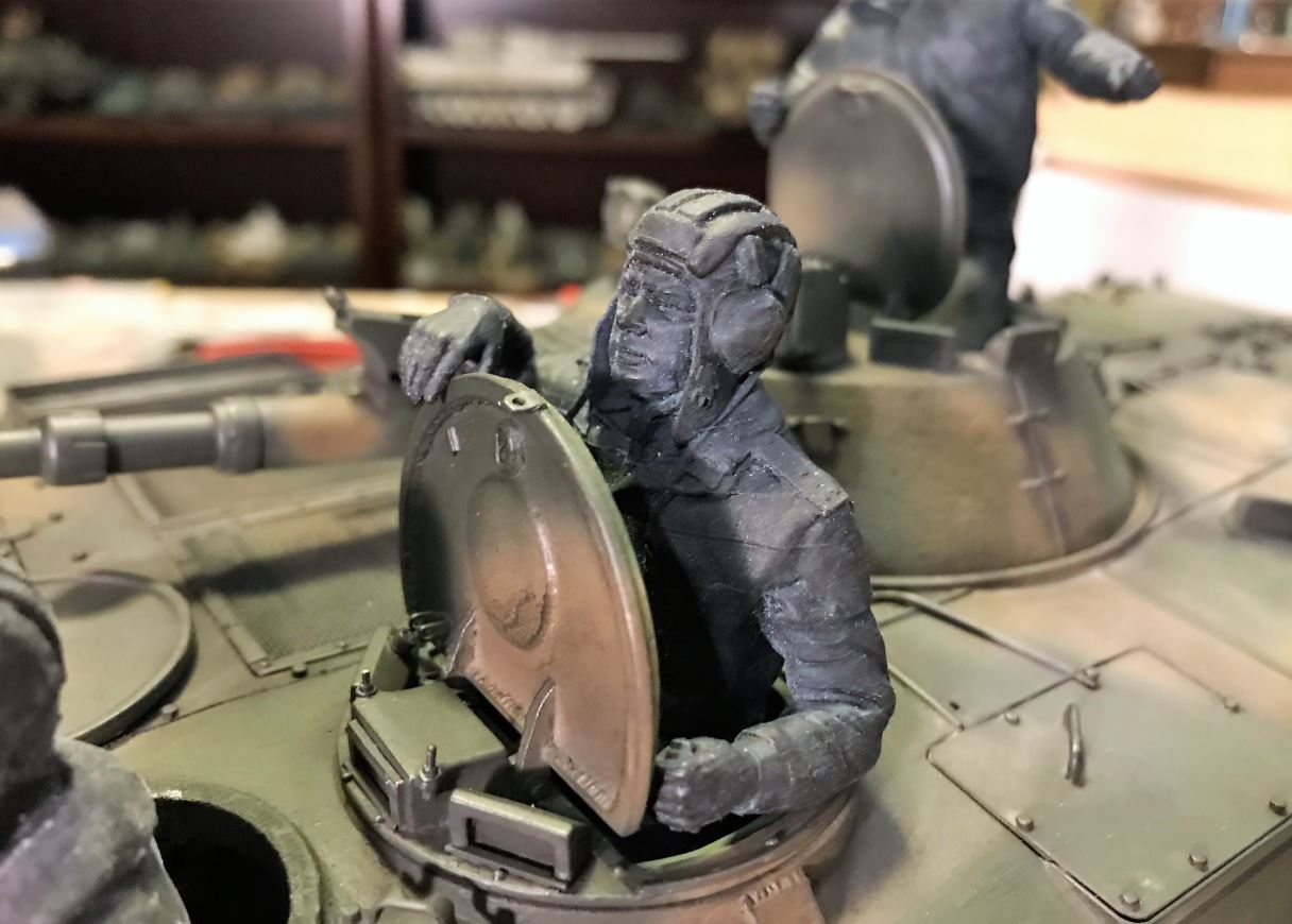

Hi, thank you everyone for your kind words and encouragements. This is certainly the most complicated model I have ever built. I must say again that everything about the BMP makes it a complicated AFV to replicate, builders beware. I had to spread the build over 4 months with many breaks in order to keep my sanity, my longest and toughest build so far, and I have seen a lot...

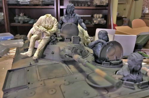

I am currently preparing for the crew and infantry rider buildup. This is the fun part.

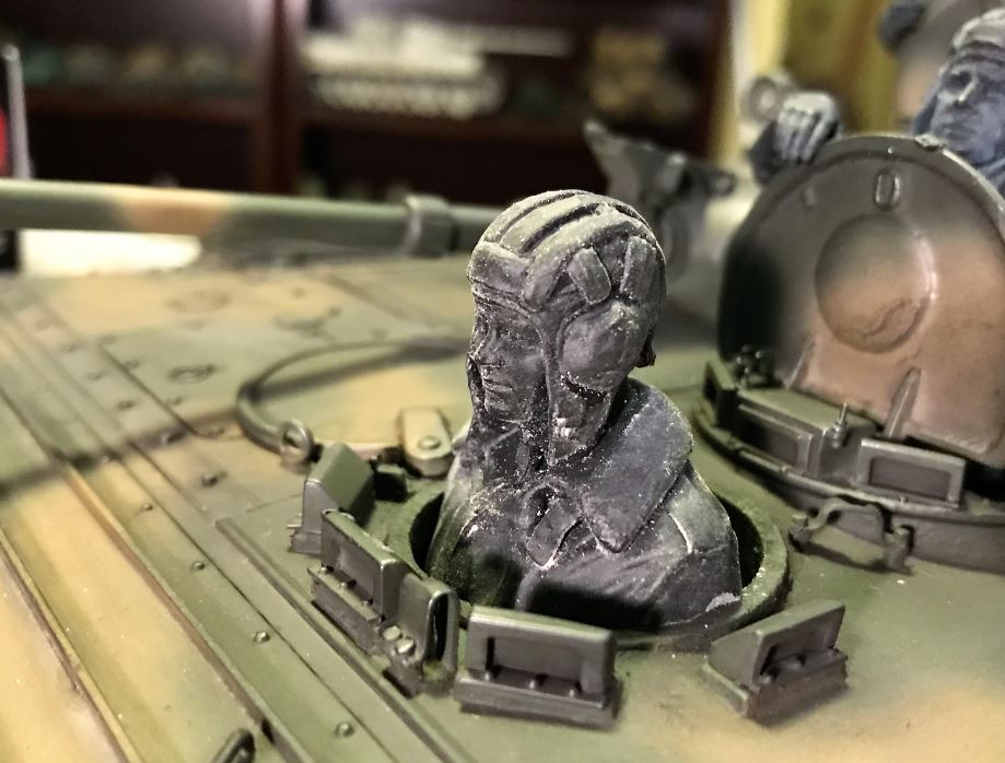

In the end, I have decided to purchase all 3 Soviet Maim T-72 crewmen for the BMP and i have assembled material for 5 Soviet Paratroopers and 2 Afghan embeded infantrymen.
Maim T-72 driver
Maim T-72 tank commander
Main T-72 gunner
Regards, Louis

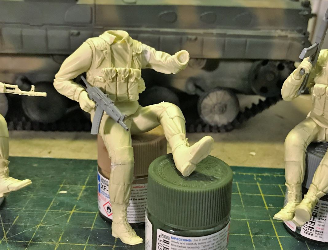

The base kit for the infantry is the Kirin kit "1/16 Soviet VDV in Afghanistan 1986". I purchased five on Ebay from the same seller. It is a figure of a running infantryman. With modification, it can be turned into a tank rider because the bent knees on both legs and split lower hips allow for easy manipulations and redesign.

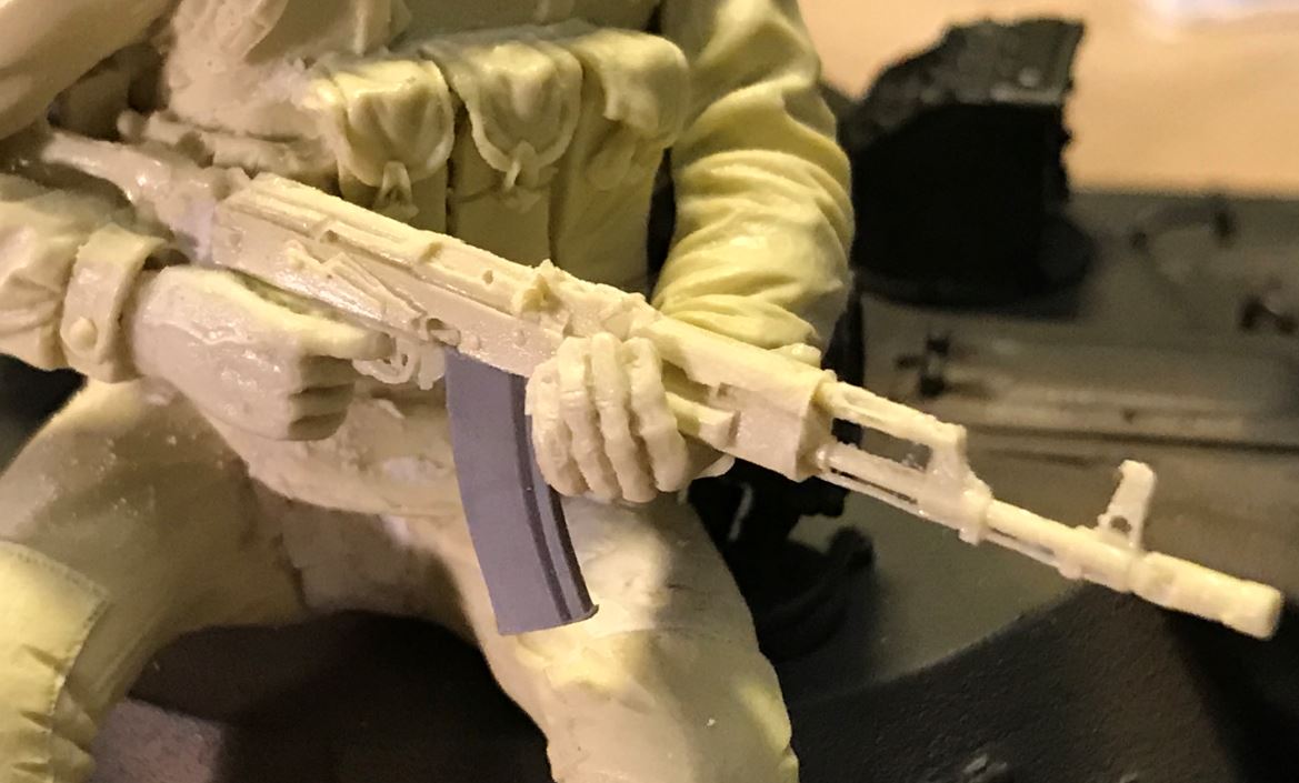

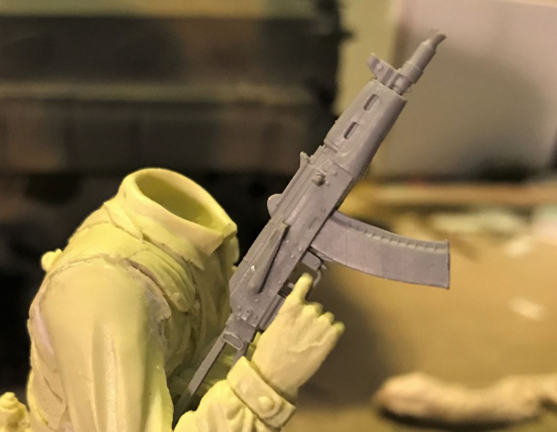

Lightly equipped like mechanized infantry should be, the figure comes with an AKS-74, 5.45mm automatic rifle. This is the weak point of the model. The rifle is made of 4 parts, with the pistol handle and trigger molded with the hands, and buttstock molded with the arm. It does not allow for much modifications. I decided on only use it on one figure.

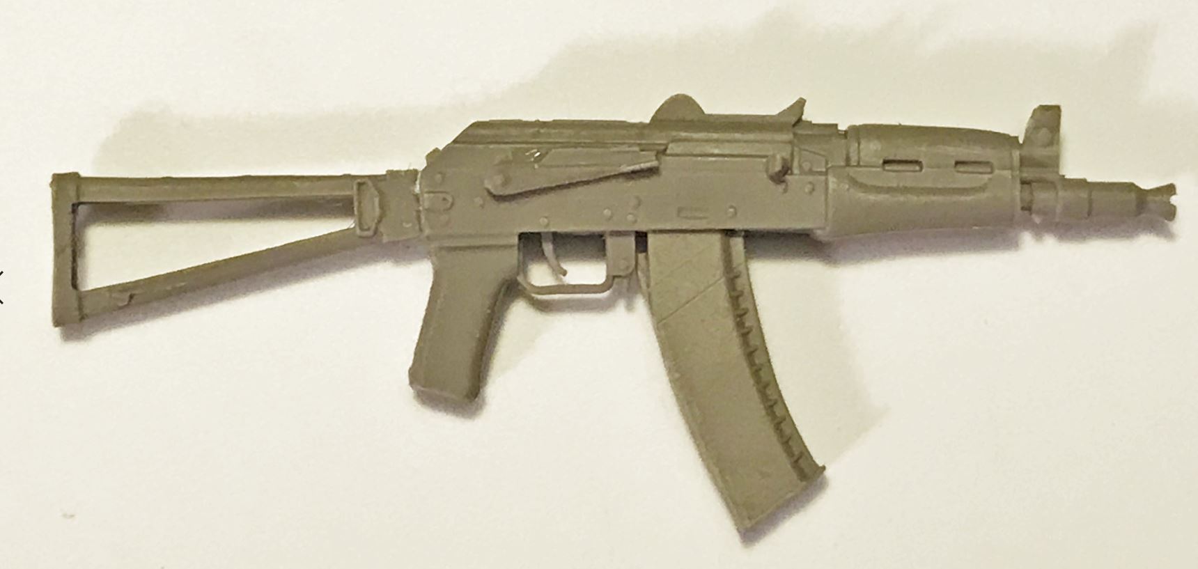

Three of the figures are armed with the Quasar AKS-74U, the commando version of the AK-74. It is expensive but of superb quality.

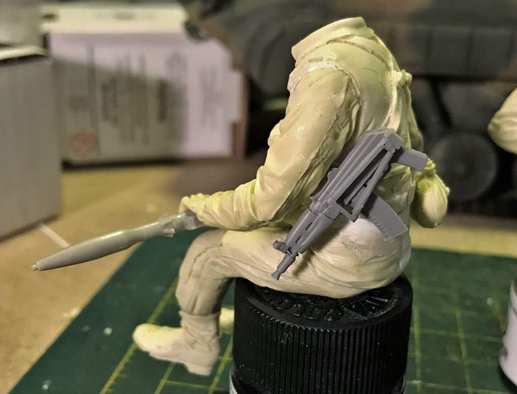

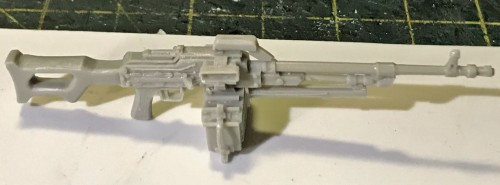

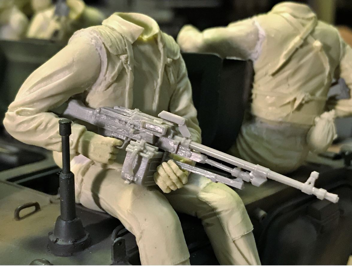

One figure is armed with the Reedees Miniature PKM machine gun.

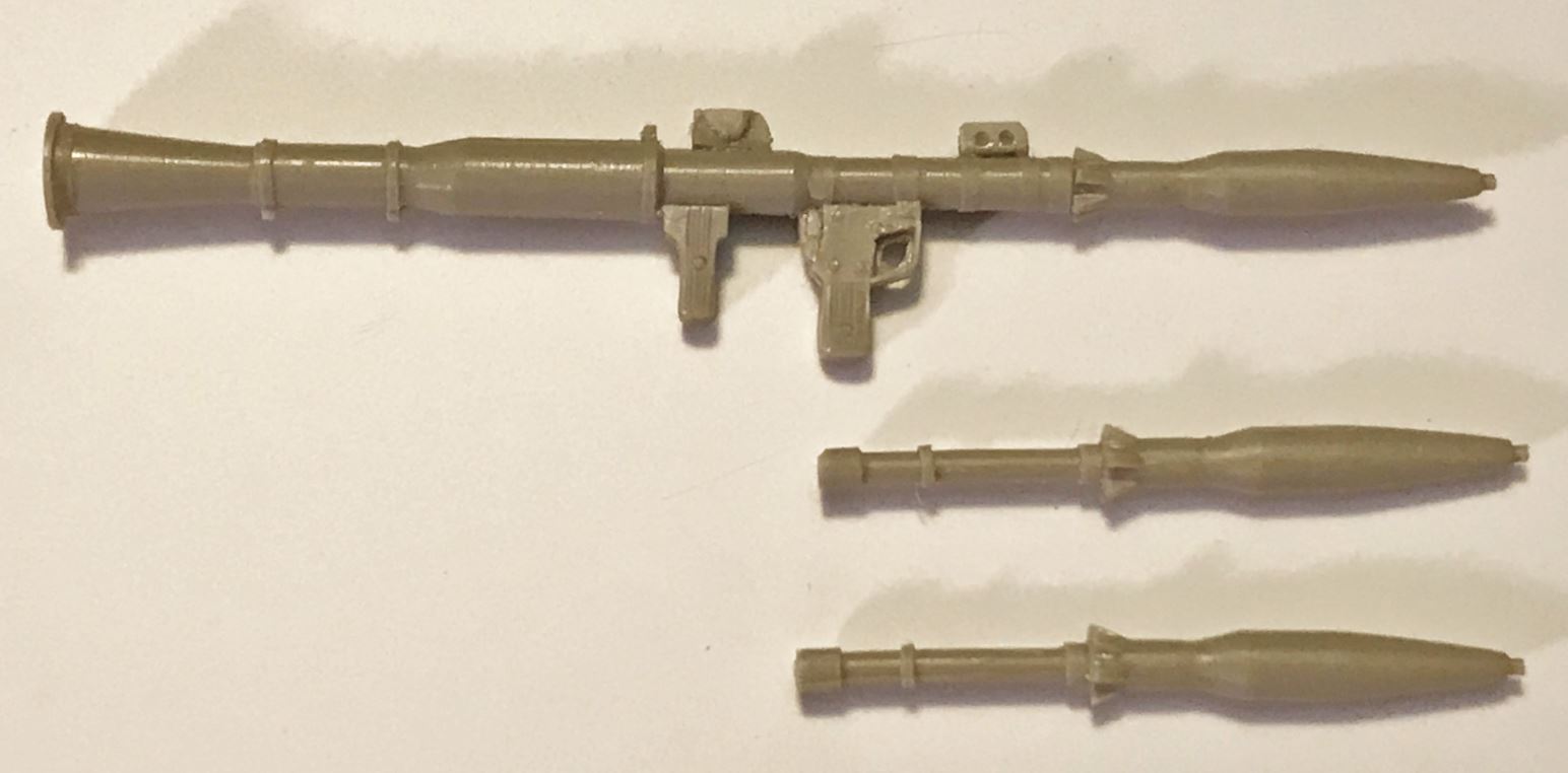

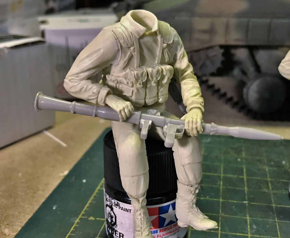

A Reedees Miniature RPG-7 is provided to one of the infantry. I would have liked to find a more recent version of the RPG but i did not see any available.

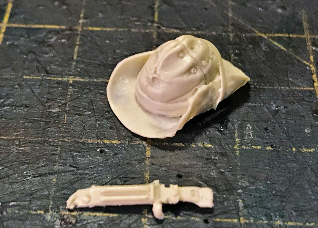

Each infantry is provided with a bush hat, an AK bayonet and also a water canteen

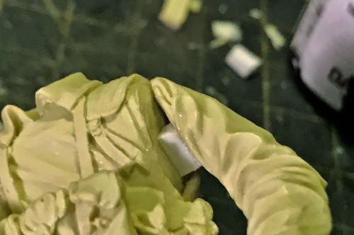

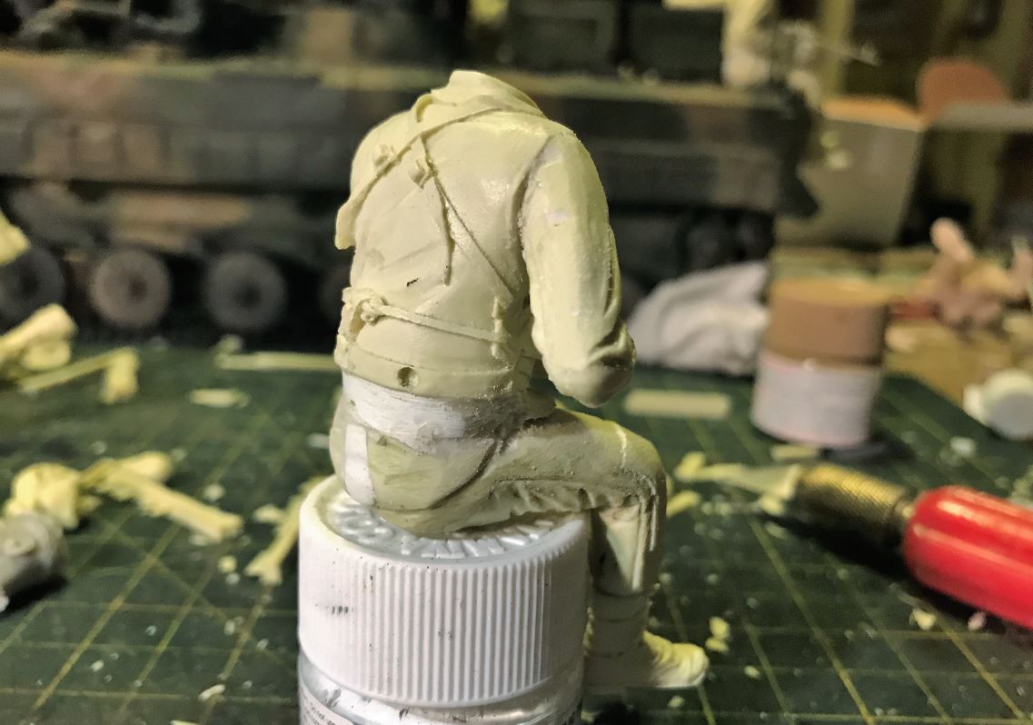

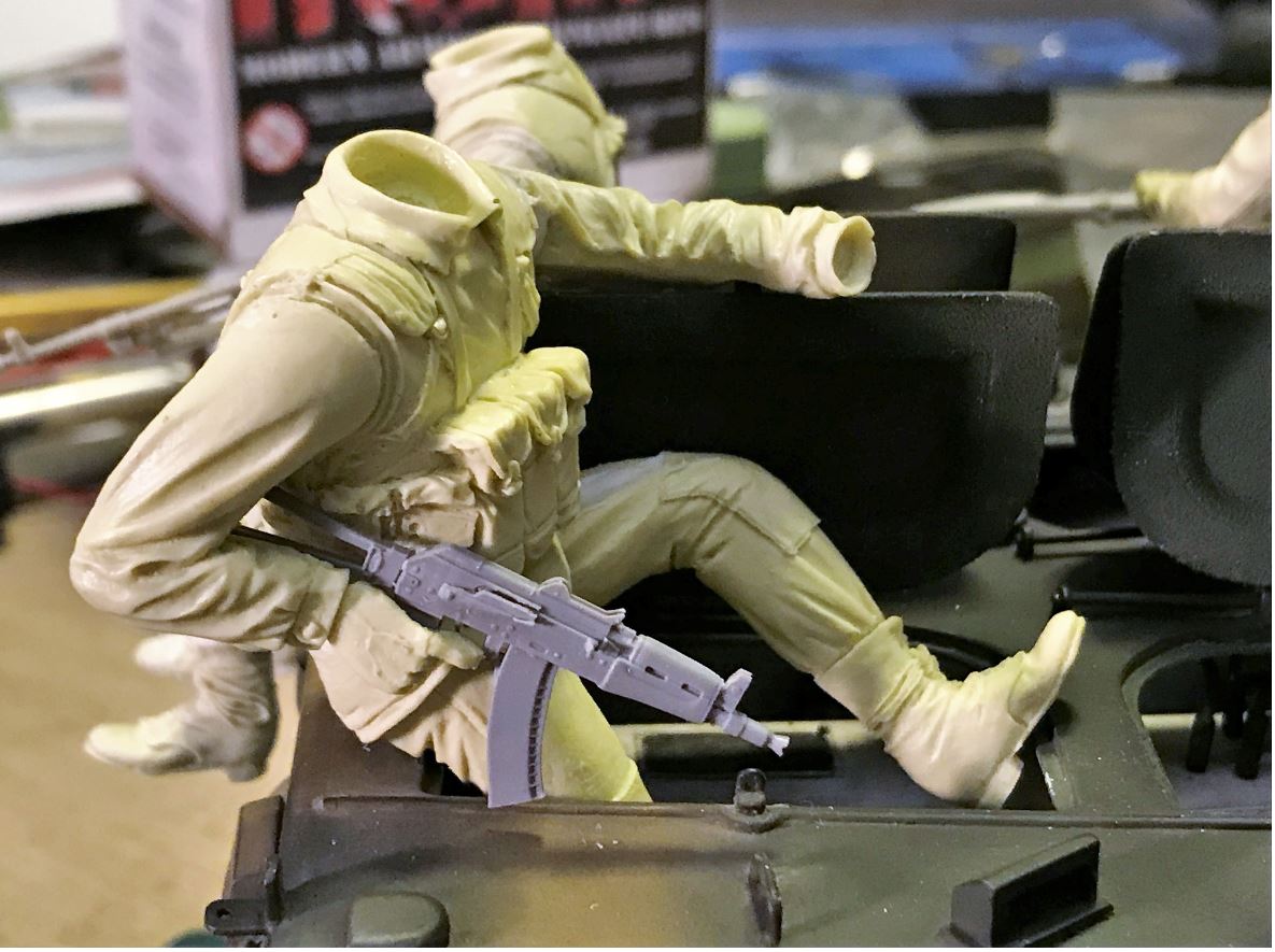

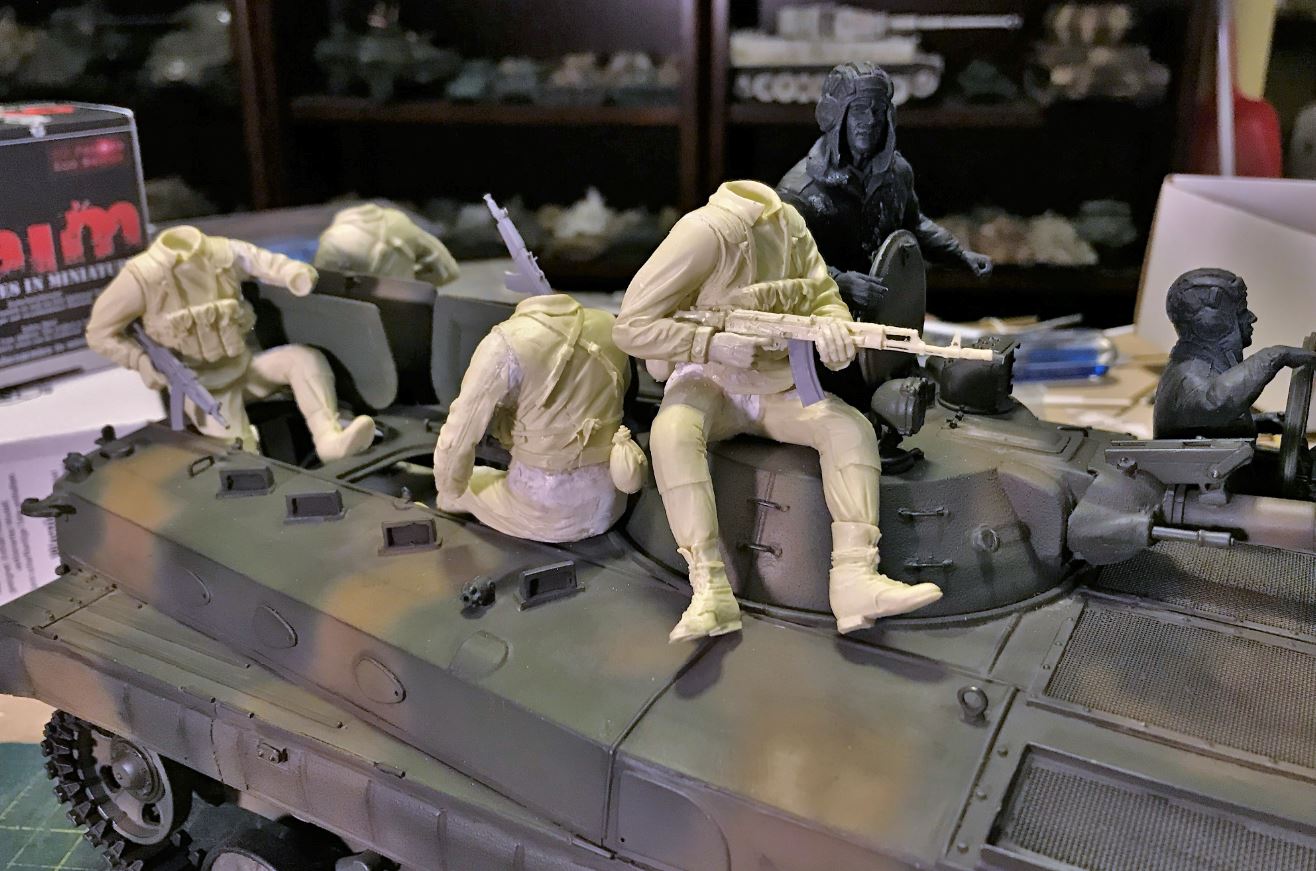

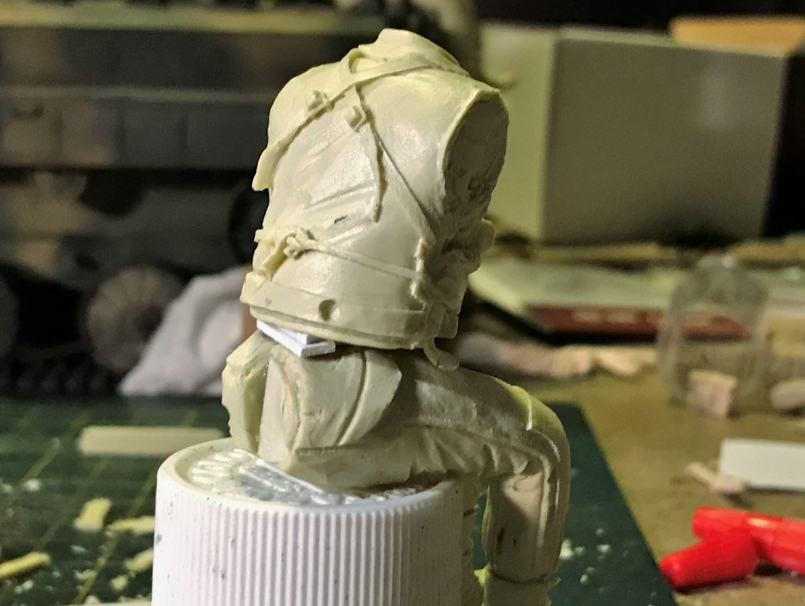

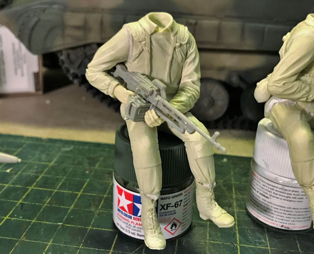

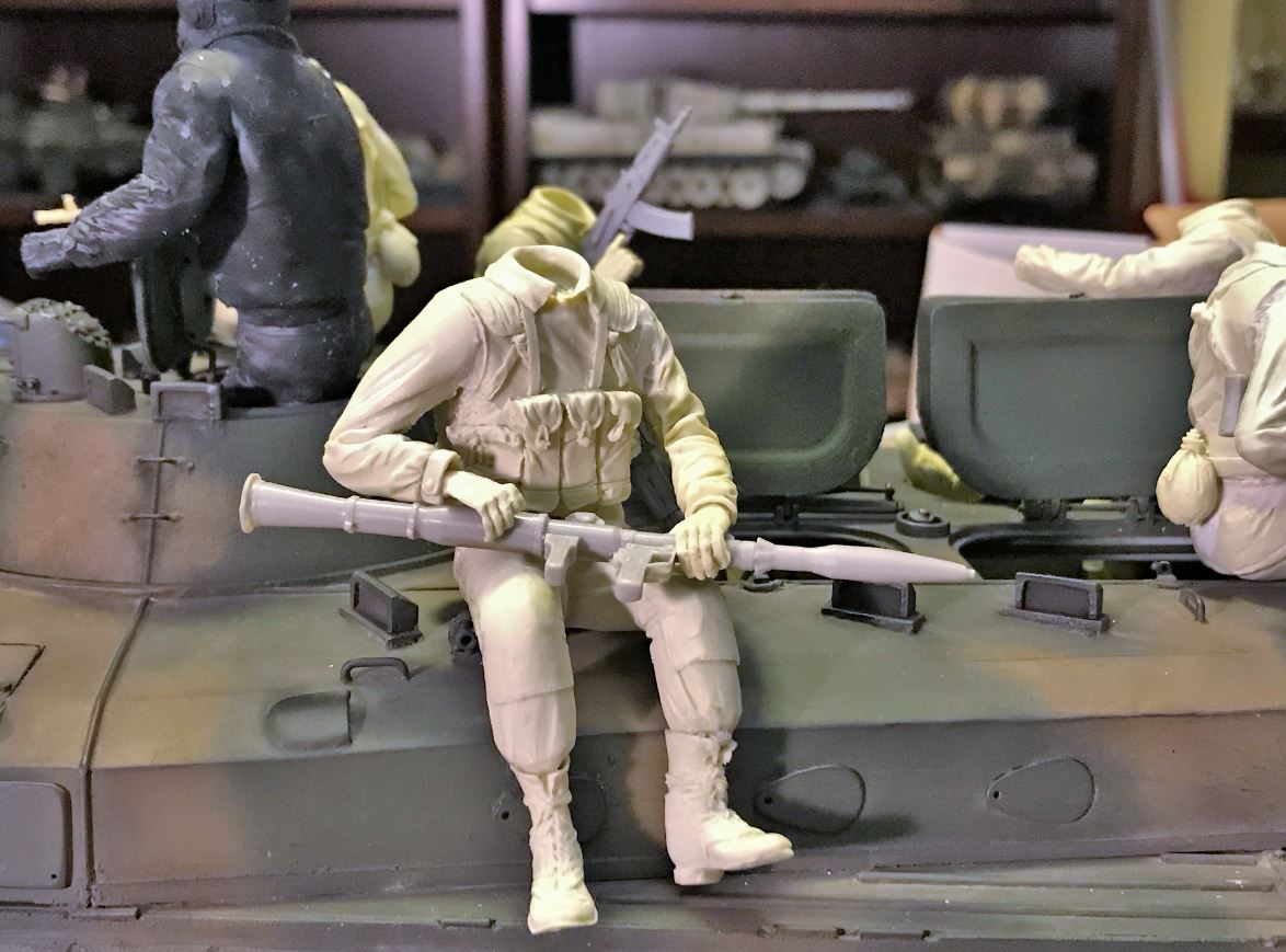

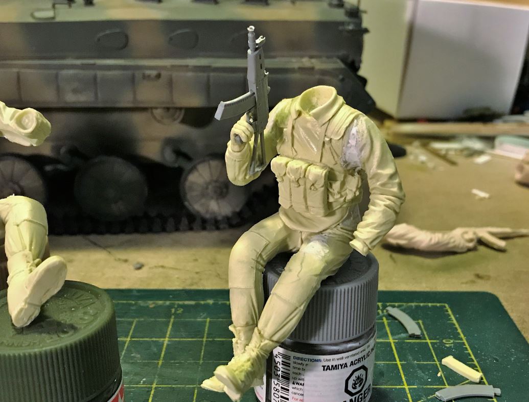

The buildup is starting. Need to first have a vision as to the overall positioning of the figures. Each pose is made unique, a small project by itself, and quite fun. It is important to dry fit many times everything, make adjustments, with the available space on the BMP, general layout and the weapons as tri-dimensional base to position the legs, torso and arms. Putting resin parts one to two minutes in the microwave allows for nice reshaping of parts, such as for adjusting the angle of bending on the legs, and for the fit of the lower part of the flak vest against the legs.
The lower body is assembled as required for the pose, and made solid with plasticard reinforcements.
Then the body is recarved, reshaped and the joints are redone.
Arms can be easily repositioned, with gaps filled with plasticard and as few putty as possible.

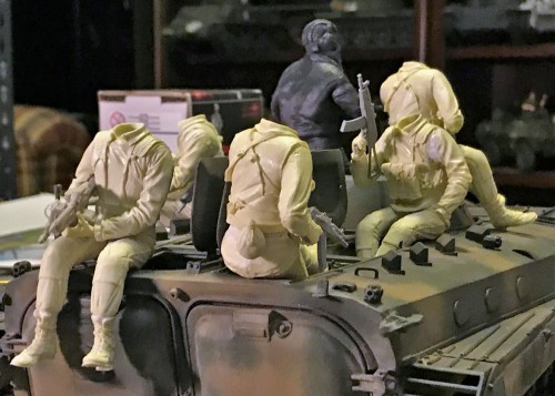

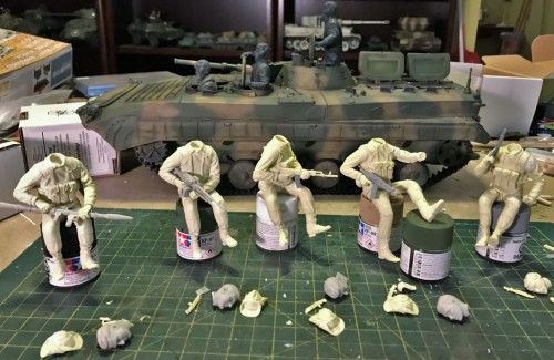

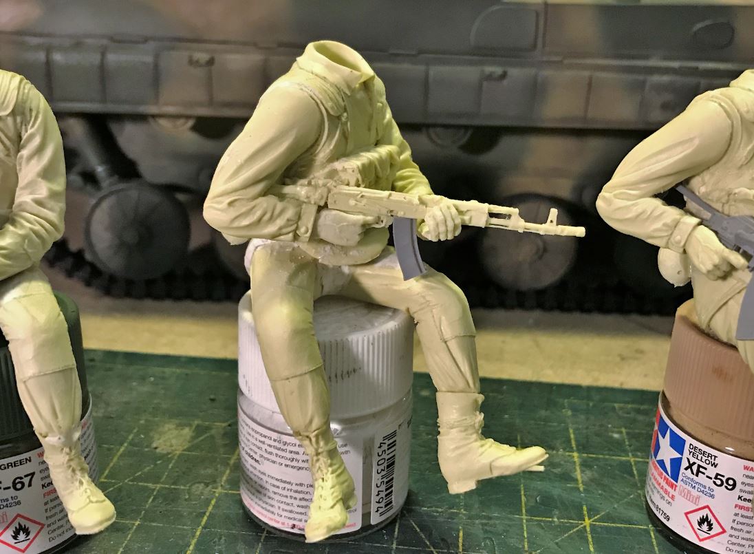

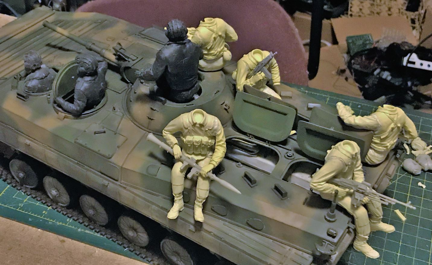

Here are the 5 Soviet 1980s infantry figures ready for painting. The heads, hats, weapons and most hands will be painted separately and assembled later.
Overview of the figures, all coming from the same Kirin kit

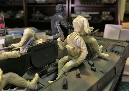

And here are the figures mounted on the BMP-1. Next step, painting.
