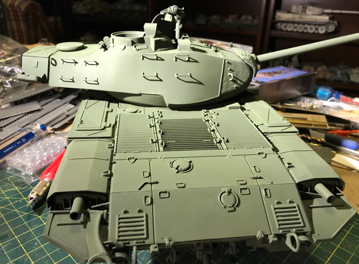

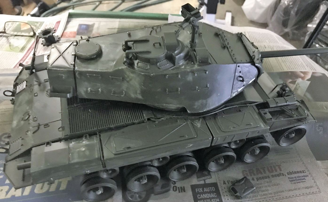

In this post, I am showing the vehicle after 3 coats of OD enamel primer.

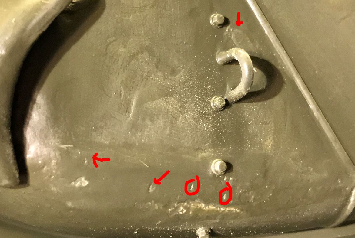

After the good wash and a first coat of primer, I spend 1 hour looking for issues to correct, such as gaps, scratches, glue residue and imperfections that could not be seen when the parts were white. This is the proper time to do it, it does not take long and it really helps with the final look. Then those areas a reworked, re-polished and made ready for the second coat.
Priming of M41 Walker Bulldog

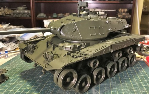

Overall view of the model after the 3rd coat of primer. It's getting better, and no more white stuff.

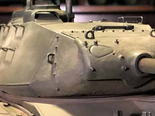

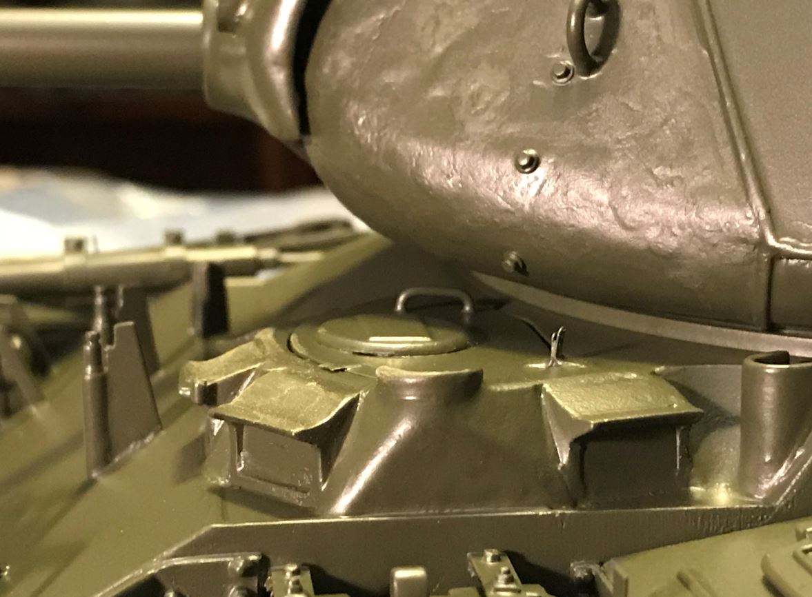

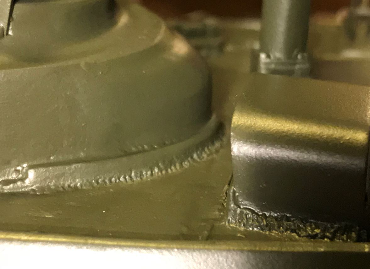

The nose of the production M41 turret is cast, while the rest of the armor are rolled steel plates. It is important to show the demarcation and the different feel on both sides of the weld connecting the two. The light cast effect on the nose was done with superglue applied directly on the part, then sanded a bit. Also noticed that I have sealed the joint with putty between the top and bottom parts. Yes, if something goes wrong with the electronics inside, I will have to crack open the turret and redo the painting there. But this is nothing compared to seeing the turret split in half for the next decades, in case something happens.

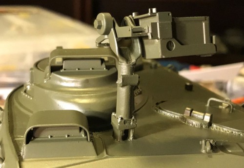

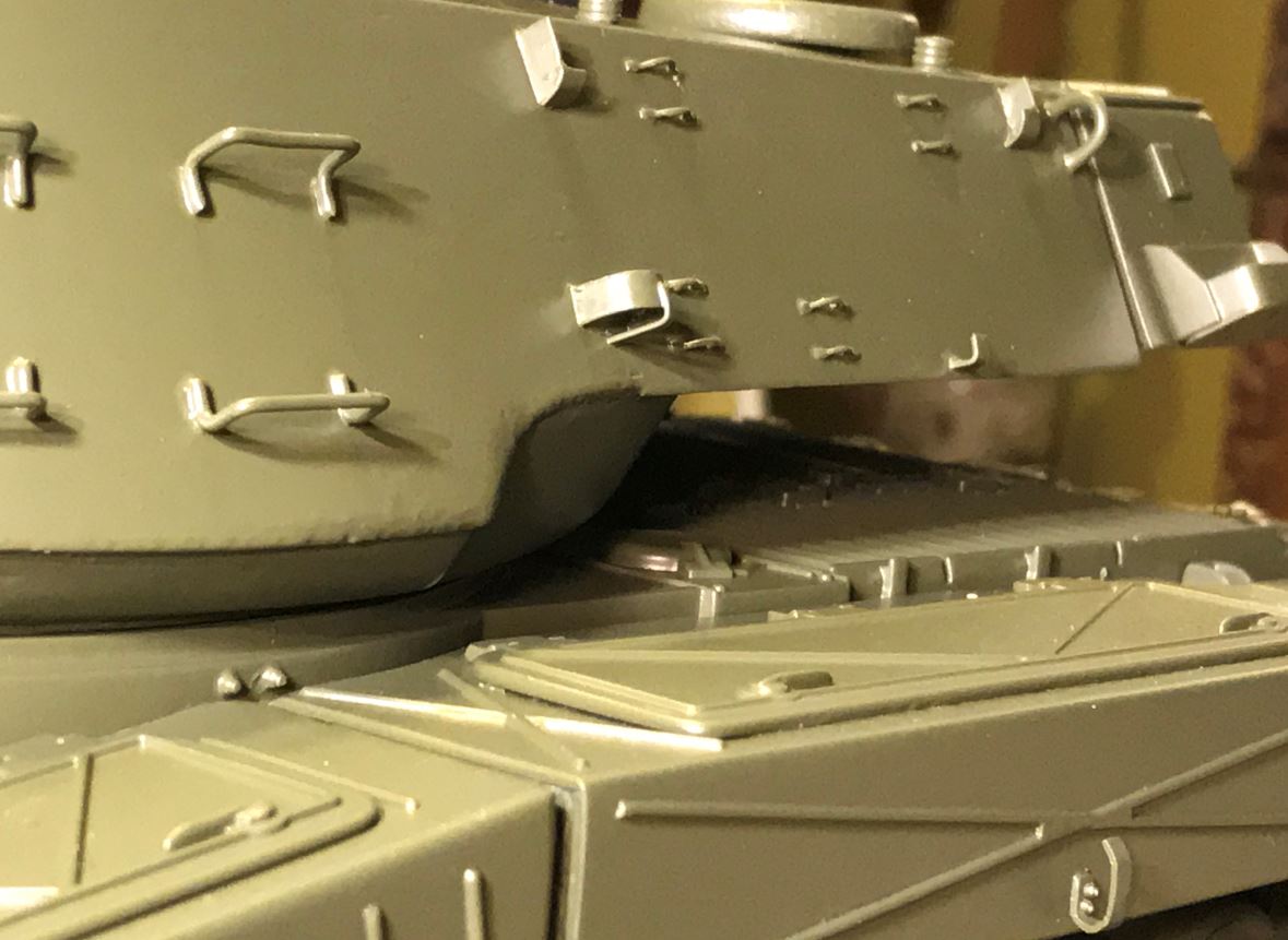

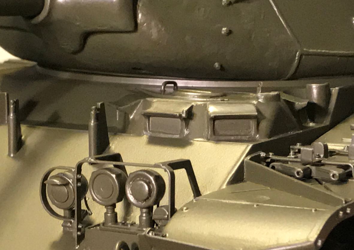

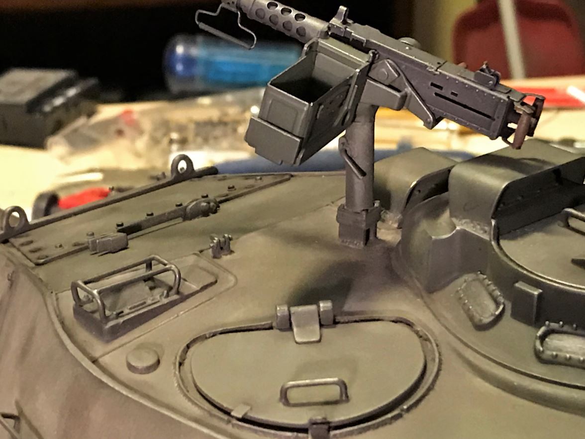

I am happy with the driver's periscope and hatch.
It was important to ensure it does not show that the turret was previously cut in half. It looks pretty seamless. the new loader's hatch looks good.

Side armor look good and flat on both sides. But they need to remain imperfect like the real thing, with cuts and welding. This is no Ferrari.

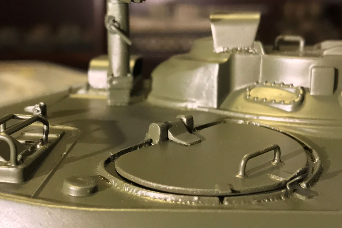

The cupola extension looks good and round.

With this step behind me, the model is ready for the acrylic coats. It will be in a dark olive green. After that, there will be a long weathering phase as I await more parts of the crew and infantry.

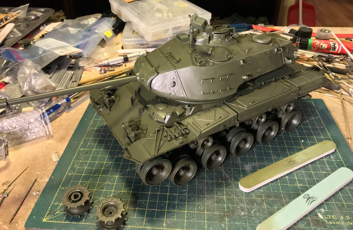

The Tamiya spray-can enamel primer coats are important as they seal the model and give a solid uniform base for the acrylic coat. Otherwise, the model will be very fragile. Touching the metal barrel will easily scratch it deeply. The oil in the putty will start to filter through the acrylics after a few months and ruin the paint job.
Heng Long M41A3 M-41A3 M-41 1/16 RC Walker Bulldog fixing

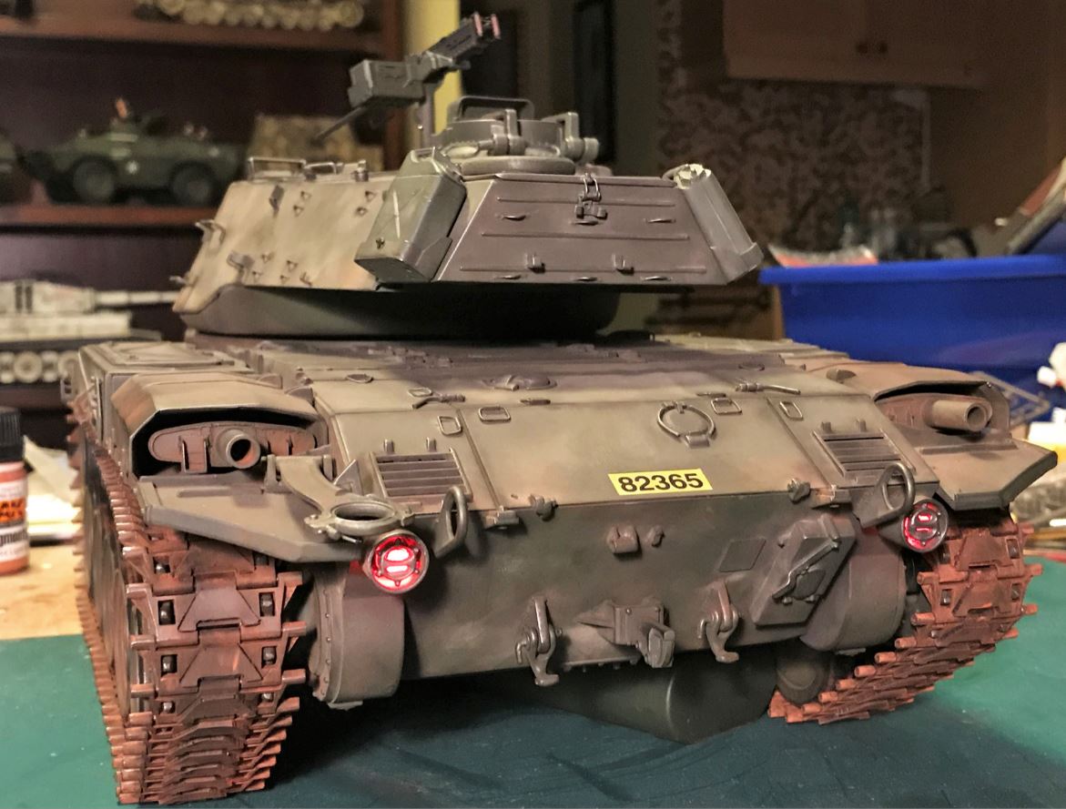

Here, the model is given an overall coat of Tamiya Olive Green acrylics on top of the oil primer. This creates a rugged surface to which pigments will adhere and blend easily.

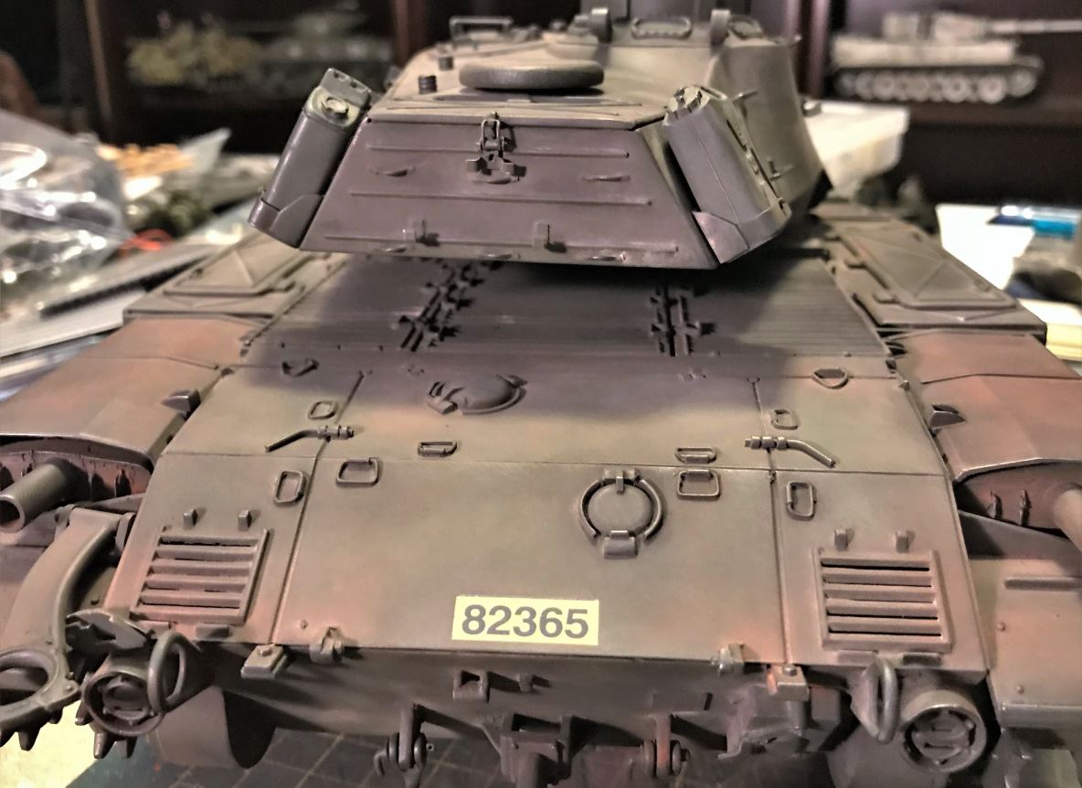

As explained by Barry, Vietnam war vehicles need some red dust to be realistic. However, my idea is not to go heavily into it because it will just be plain ugly. I did not spend 2 months detailing this tank to make it covered in mud. I want the lower bottom hull and tracks to have a lot of dry season red dust, yes dust, not mud, and there should be less and less with elevation.
M48 Vietnam
M48 Vietnam

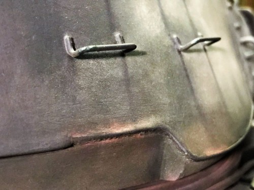

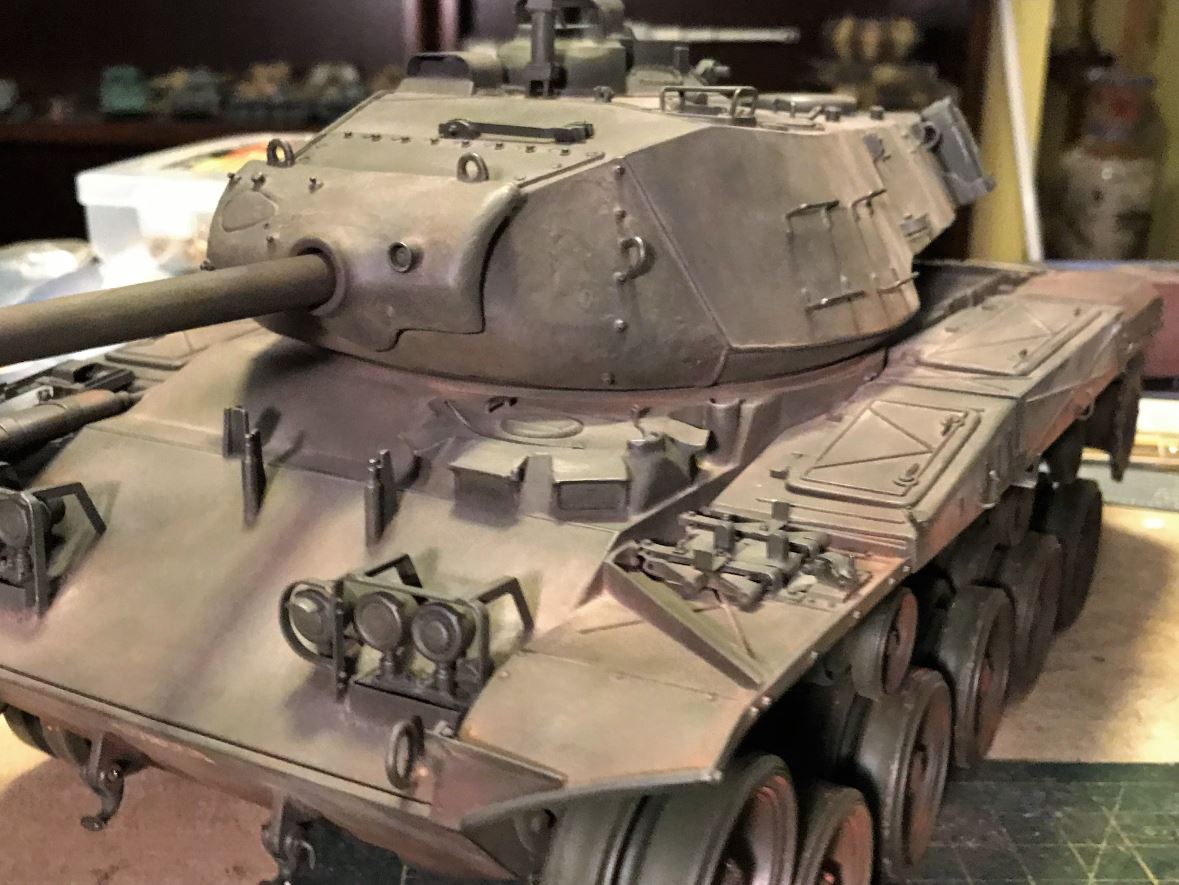

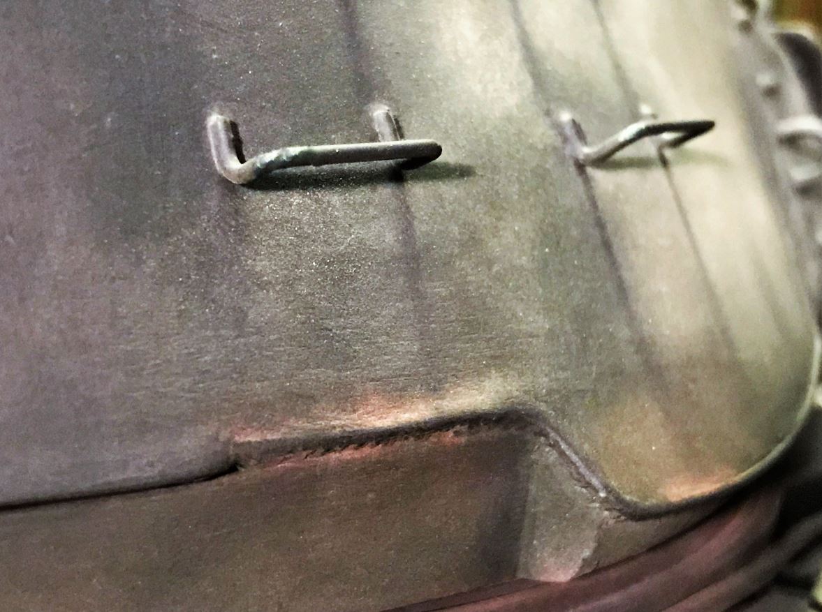

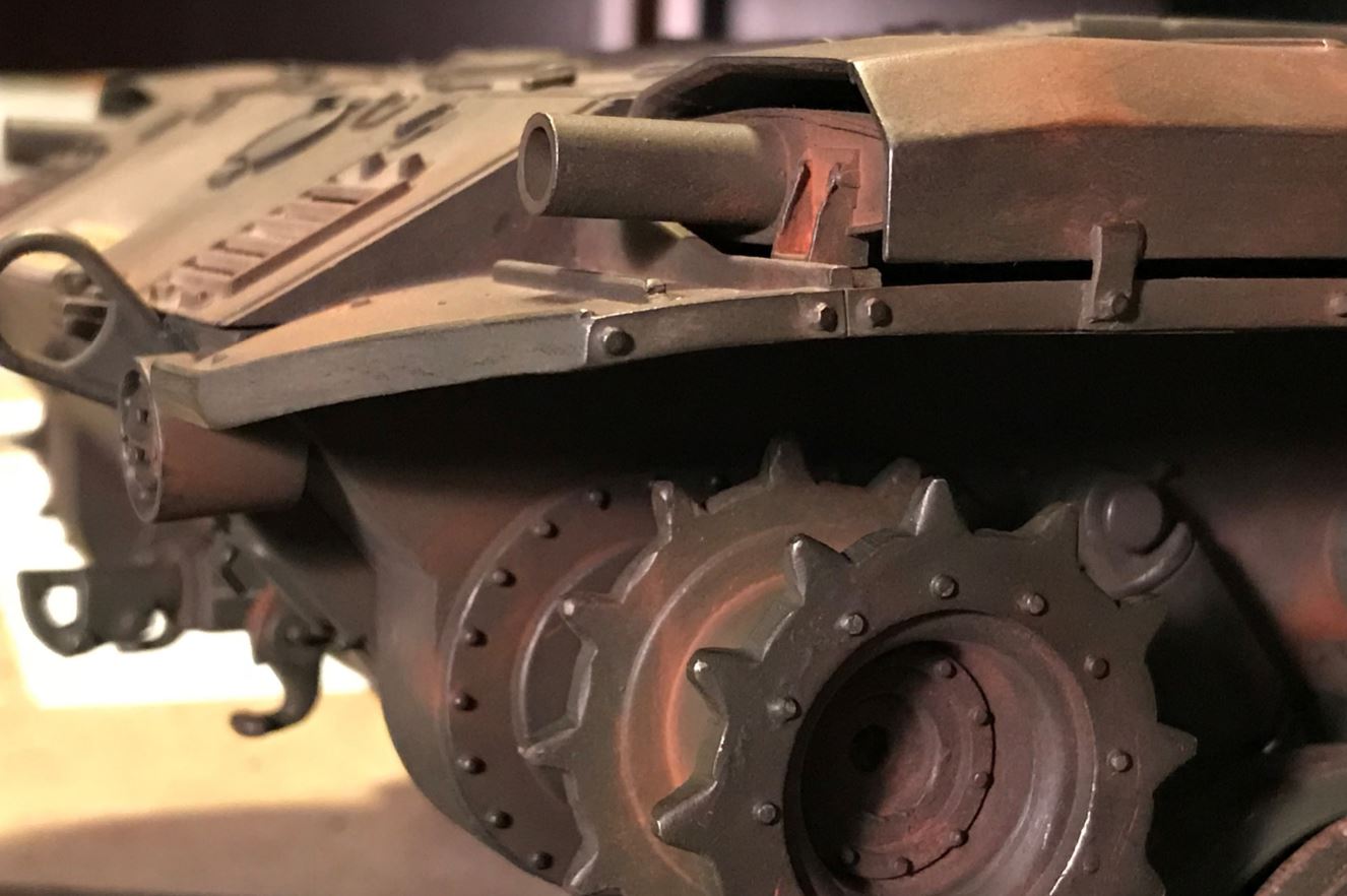

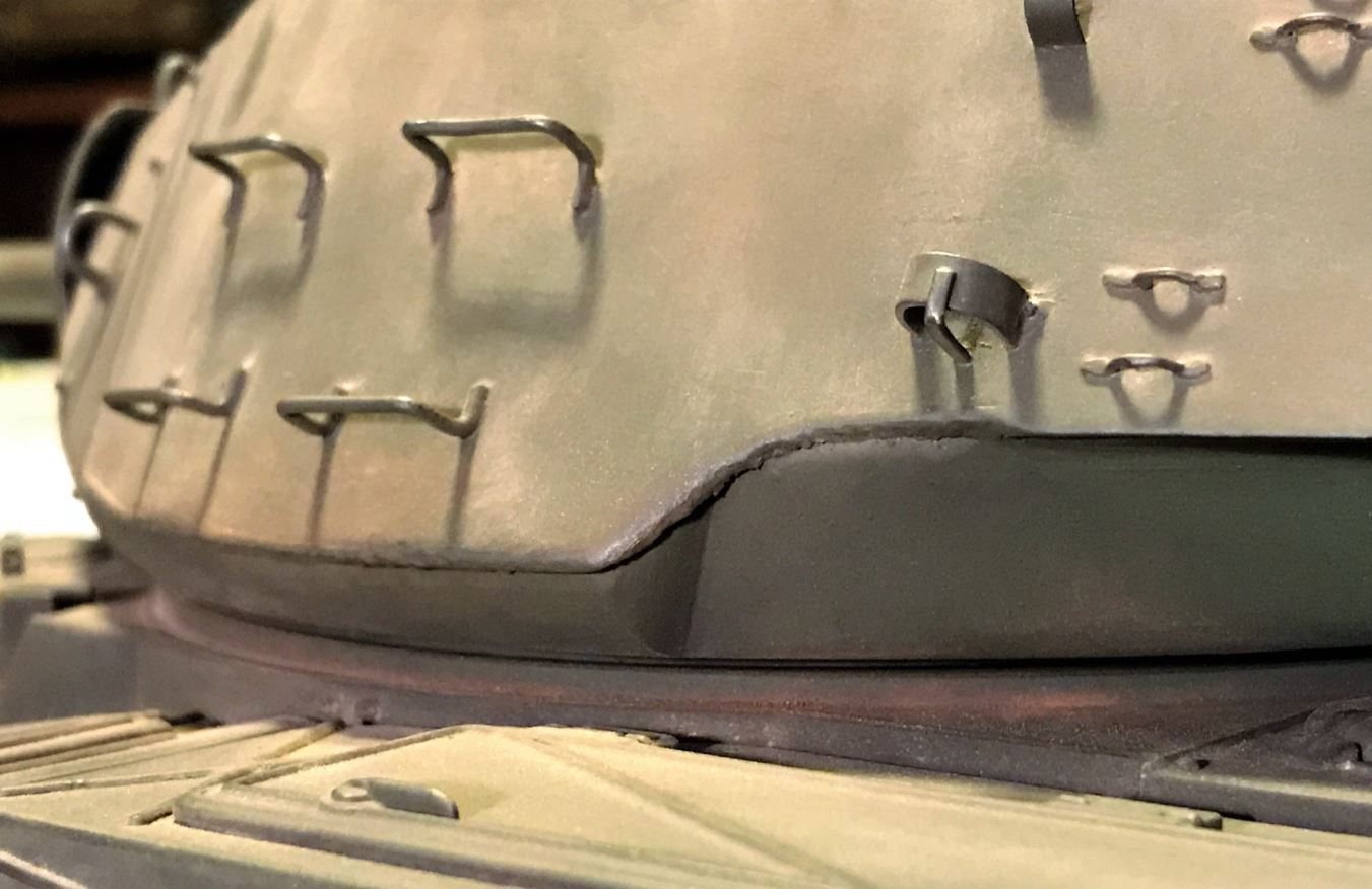

As per my technique that I use on all my models, the tank is applied with AK Interactive (MIG) dry pigments (applicated dry) of various colors using different brushes. Black pigments in deep areas and corners with small hard brush, Dark Steel pigments dry brushing on raised components with medium soft wide brush, Medium Rust pigments for the red dust on lower hull, tracks with some touches on upper hull with soft brush, then European dust applied all over the upper hull and turret with soft brush. Then the tank is sprayed overall with a thick layer of MIG pigment fixer directly on the tank, which fixes the pigments in place and give a satin flat surface that I like. Repeated as needed until the desired effect is reached.
Following pictures show the current state of the model. It is work in progress and there is still a lot to do but it gives a good idea of where this is going.
The serial number markings are from the Glencoe M41 microscale decal sheet that was excellent. The only other markings provided on the sheet for the ARVN are signs on the turret for 2 tanks shown in a Army parade in Saigon in the early 70s, not what I need.

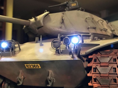

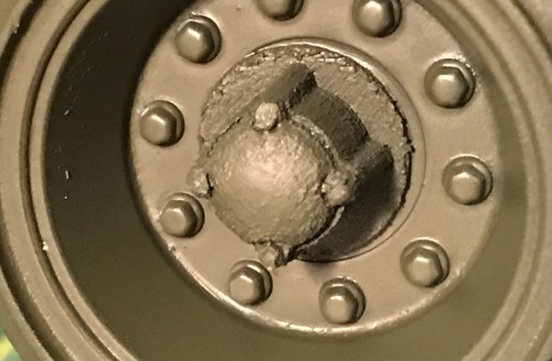

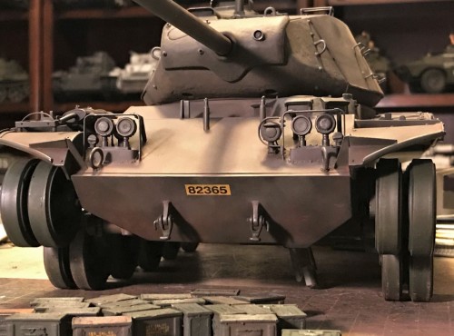

I have to say that this build has been a very interesting one. It had been a long time since I wanted to do it. The availability of the MLRS tracks was surely the trigger. I am so far very satisfied with the results of the whole transformation and integration of all the components.
The Heng Long model is after all a pretty good base for a good looking M-41. If Heng Long had only chosen to create new road wheels for it, and forget about installing the smoker, it would be a totally different model on the market today. I can see that it is only because they wanted to install a smoker that they selected a high gearbox so that the smoker can fit in between the two gearbox, which then required them to distort the model to fit the high gearbox. Too bad, I can't care less about the smoker...

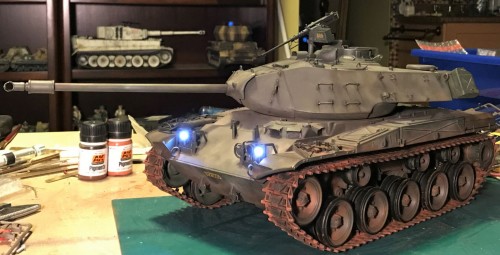

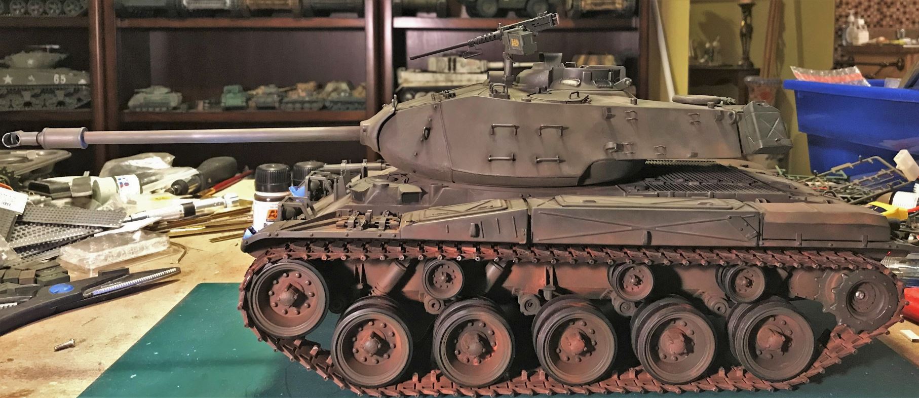

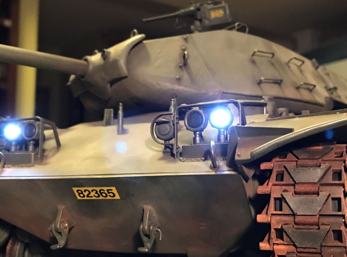

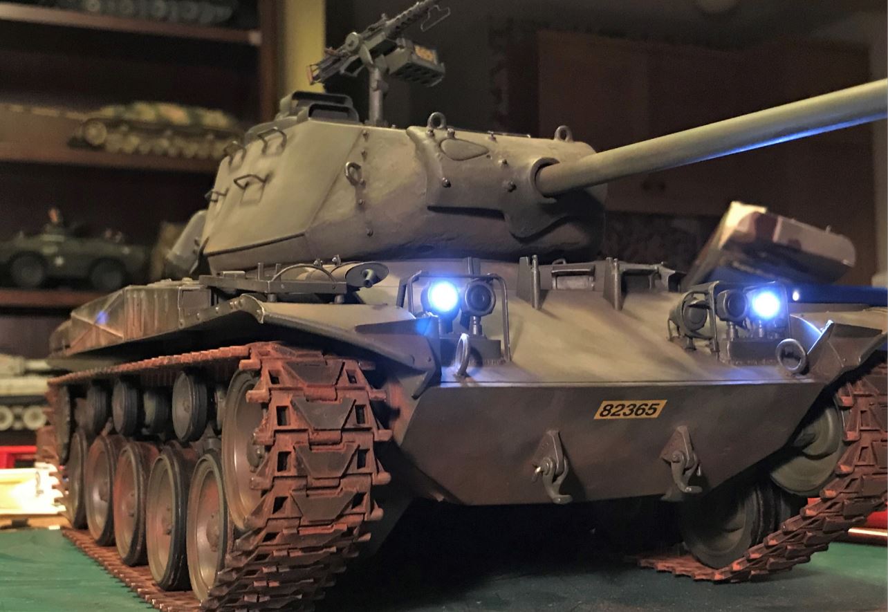

In this post, I have painted and installed the tracks, and did a bit more work on the paint job yesterday night and tonight. The weathering on the tank itself is mostly finished, I just need to do the inside of the road wheels. I ran out of pigment fixer... Next step is to install the accessories and do a running trial with the tracks having their rubber pads. I need the rubber to look "used" instead of brand new.
Here are some pictures of the model as it is today, and a Youtube video of the turret in action at the end of the post.

If I could offer a couple of suggestions...the headlights should be warm white (yellowish) given their era and the rear end needs stiffer springs. It might be the angle, but it looks like the rear end is squatting, which is normal for this tank when it has steel gearboxes.
