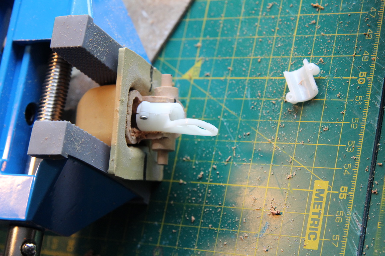

Thanks, Dan. There's room enough to secure the unit in place; It's a pity that the design has not been streamlined, or made less bulky. The real problem is finding sufficient room for the recoil mechanism to move unhindered.

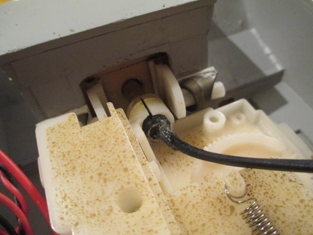

The first thing to do, is to shorten the clamp that holds the barrel in place. The longer the clamp, the further in needs to intrude into breech space.
StuG IV - barrel clamp recoil lever.
Here I've already removed a centimetre from the clamp. If you look at the same fitment in Painless' Pz 111 installation, he's paired the clamp down the bare minimum, and bonded the barrel to it with glue. Normally, two screws tighten the sides of the clamp to grip the barrel. I may have to do the same later... :think:

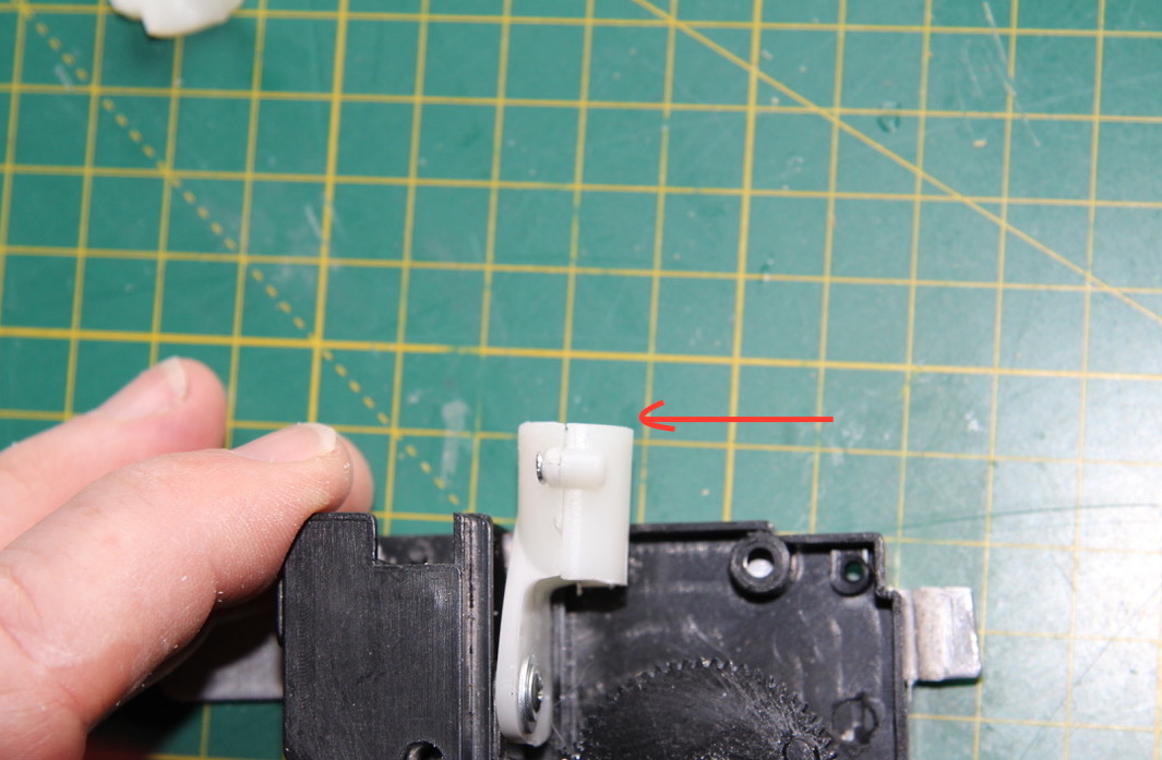

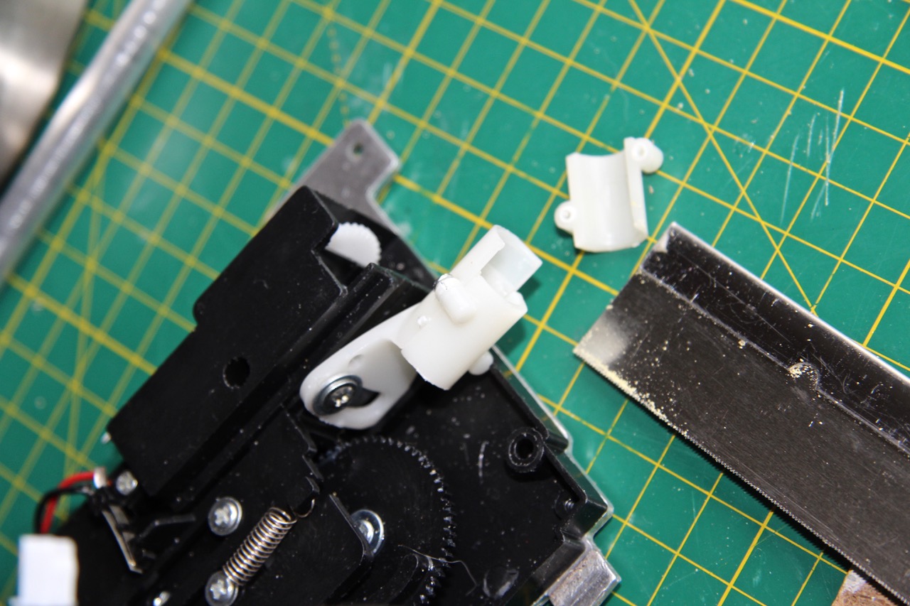

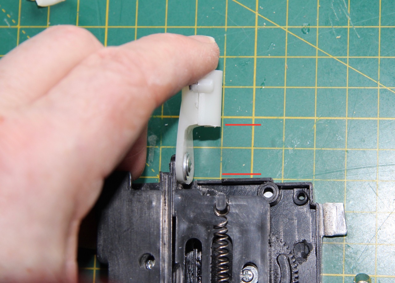

Next it's necessary to calculate the maximum travel of the recoil arm, in order to determine how much more of the breech will have to be cut away to accommodate it..
Recoil clamp starting point- maximum retraction
The red line indicates the maximum retraction point the arm reaches.
Recoil clamp end point- maximum extension
The distance travelled is roughly 19mm. This means I shall need at least 19mm gap between the end of the breech and the end of the white clamp. Failing that, I shall have to ream the breech out further to allow the clamp to enter it, and move the breech/trunnion (gun pivots) assembly outside the casemate to maximise the operating arm space. :problem:

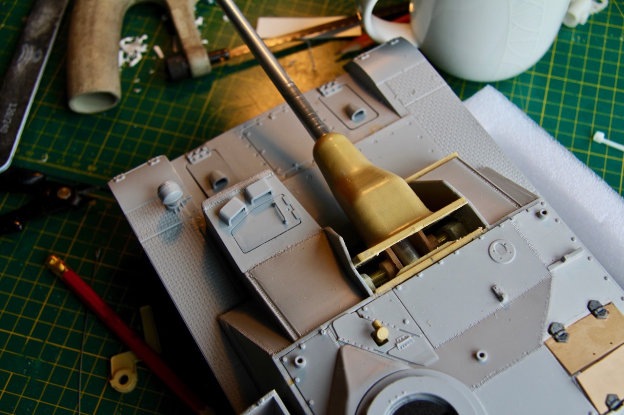

Re: Asiatam StuG IV conversion kit...

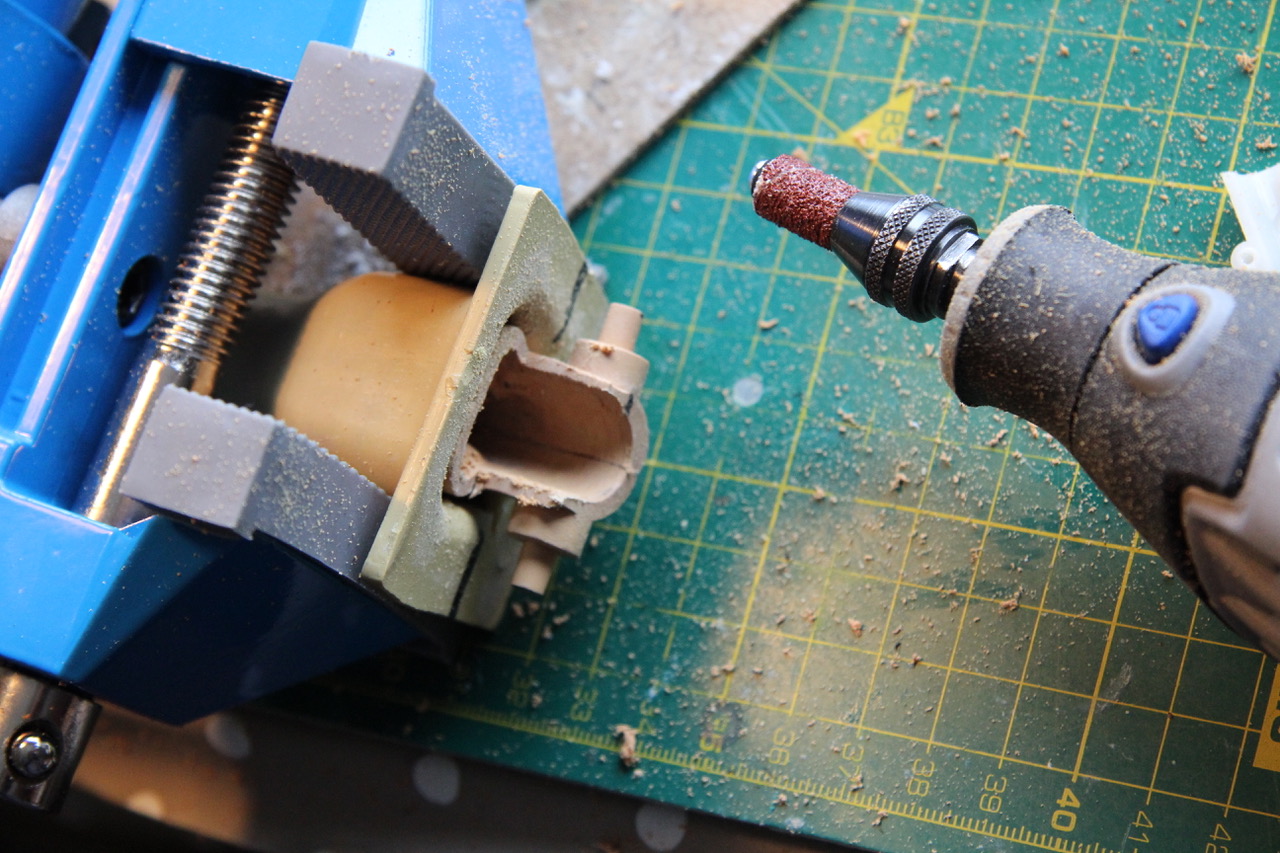

After looking at the results, I've decided to open the breech out more. The should allow the clamp to move forward (with the barrel) without hindrance, or limit.
Time for the Dread Dremel....
Barrel clamp access limited by tight breech...
Clearly, there's not enough room for the gun clamp to move smoothly. More reaming necessary..no jests about tight breeches please :lolno: :lolno:
Breech opened out with a Dremel to allow clamp to move

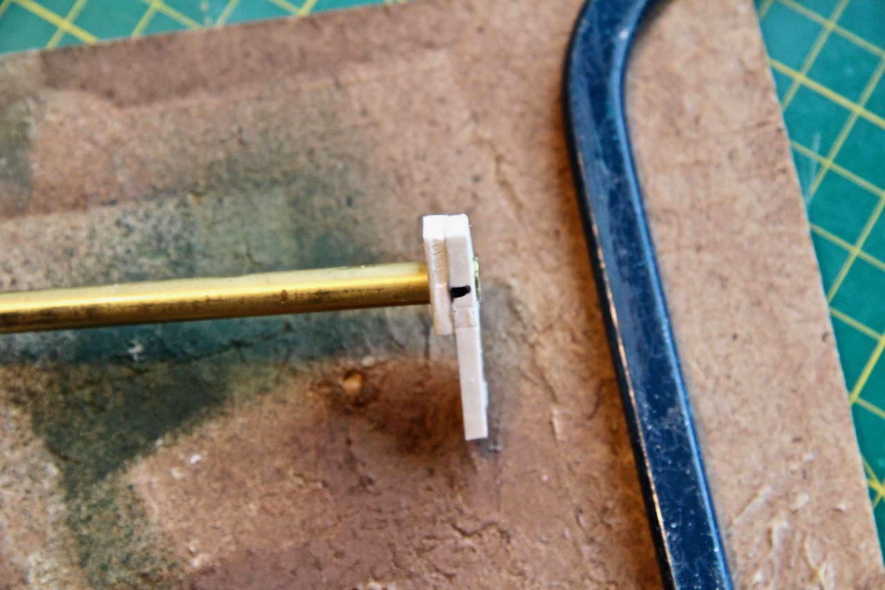

Still not enough room, after tests. The trunnion pivot arms that came with the Kit will be relegated to my burgeoning rc spares box. I'm going to mount the gun outside the casemate in the Saukopf section. :thumbup:

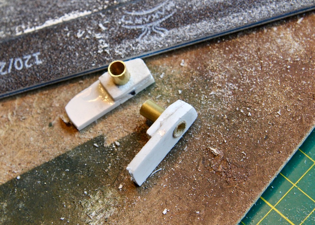

This will reuse fabricating some pivots/ trunnion housings with brass tubing and styrene.
Making a trunnion pivot housing Pic A
And the finished units:
Finished trunnion housings/ gun pivots

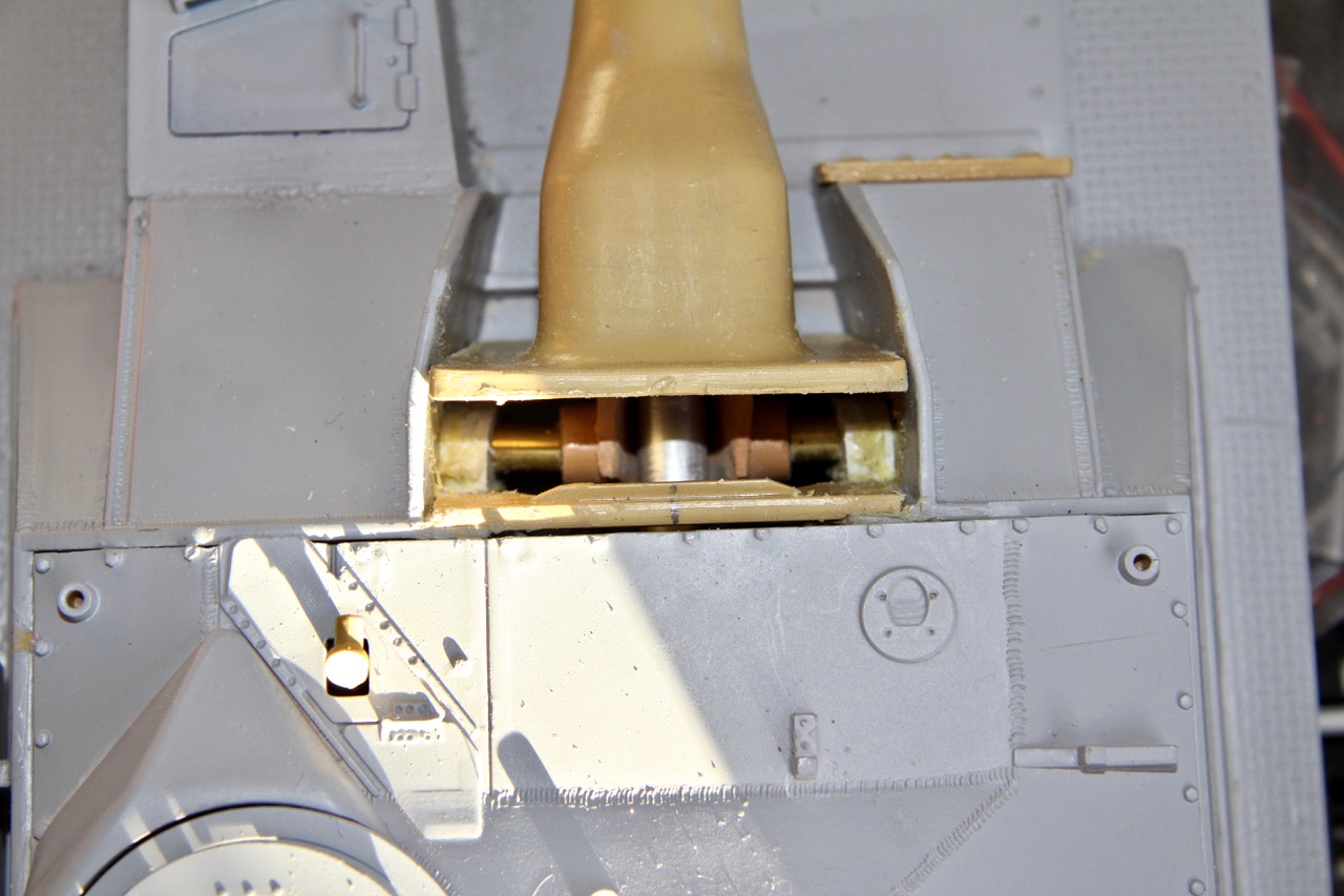

Here's what the assembly now looks like, with the revised trunnion pivots bonded in place with epoxy. Believe it, or not, quite a few measurements were taken and checks made, prior to fitting this unit in place.. :problem: B| :eh:
Gun assembly in place pic A
Gun assembly pivot points outwith the Casemate

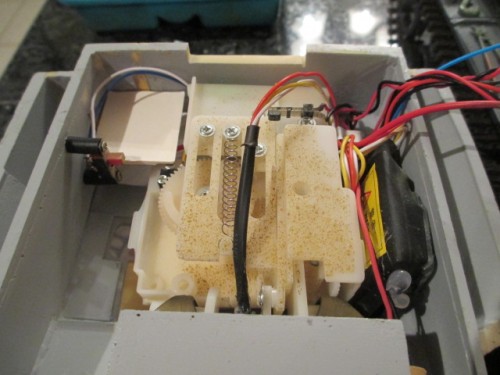

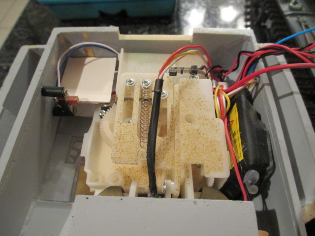

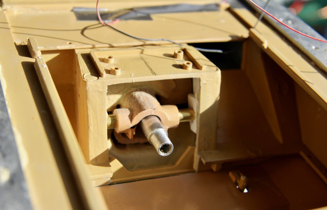

This is what the interior looks like now, after the move. There's more room now to fit the Recoil unit now. More to the point, there's more room for fingers to get in there to connect the barrel to the recoil arm, and then fit the elevation arm.
Interior view of gun breech assembly..
I'm going to bond the elevation arm to the breech housing...
