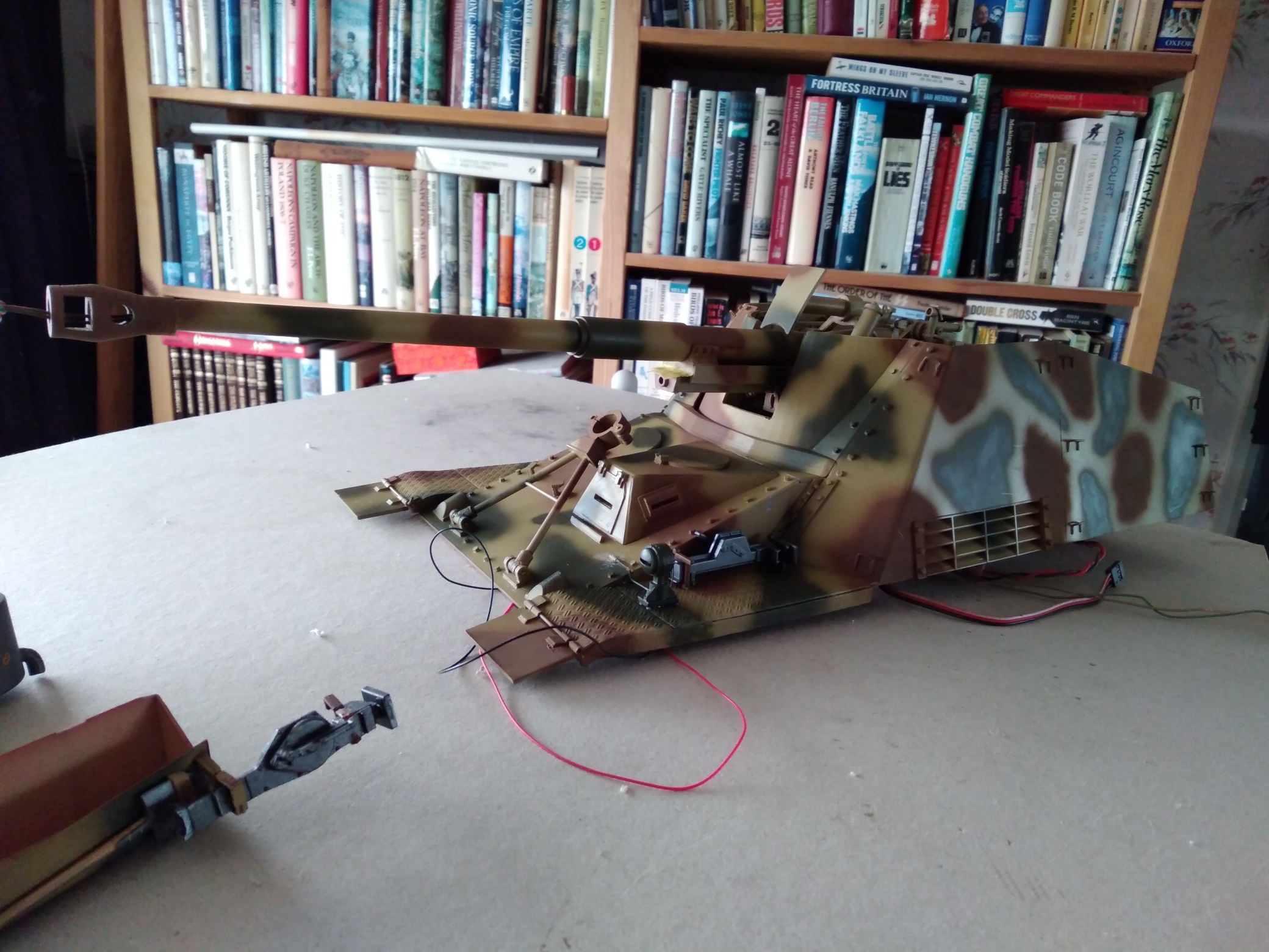

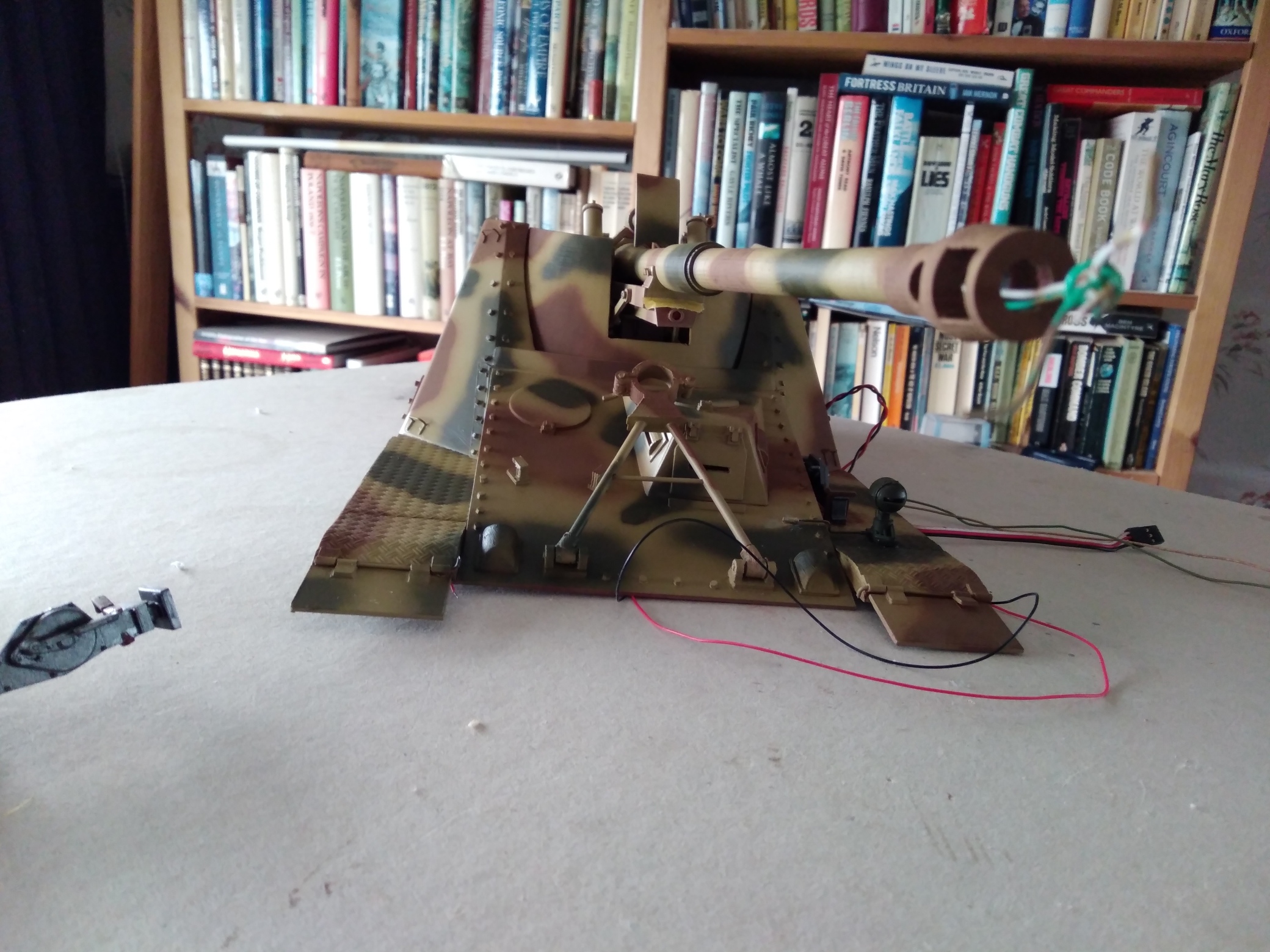

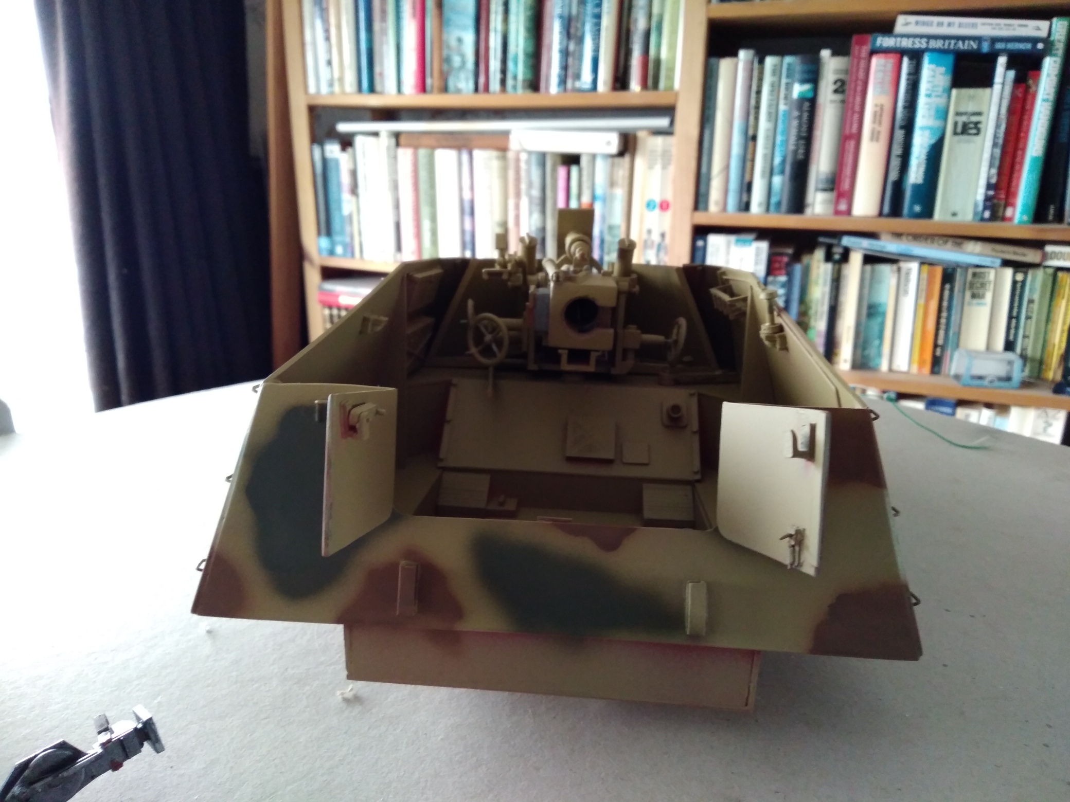

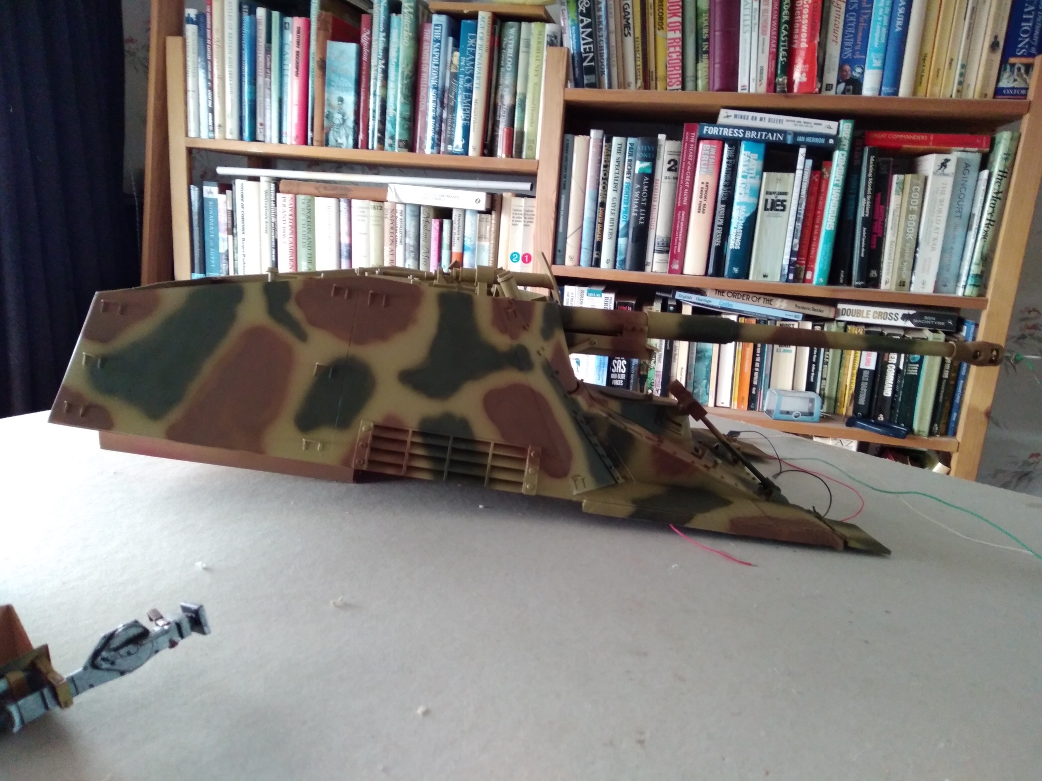

This represents an all round view of
the upper hull as it is at present.Richard

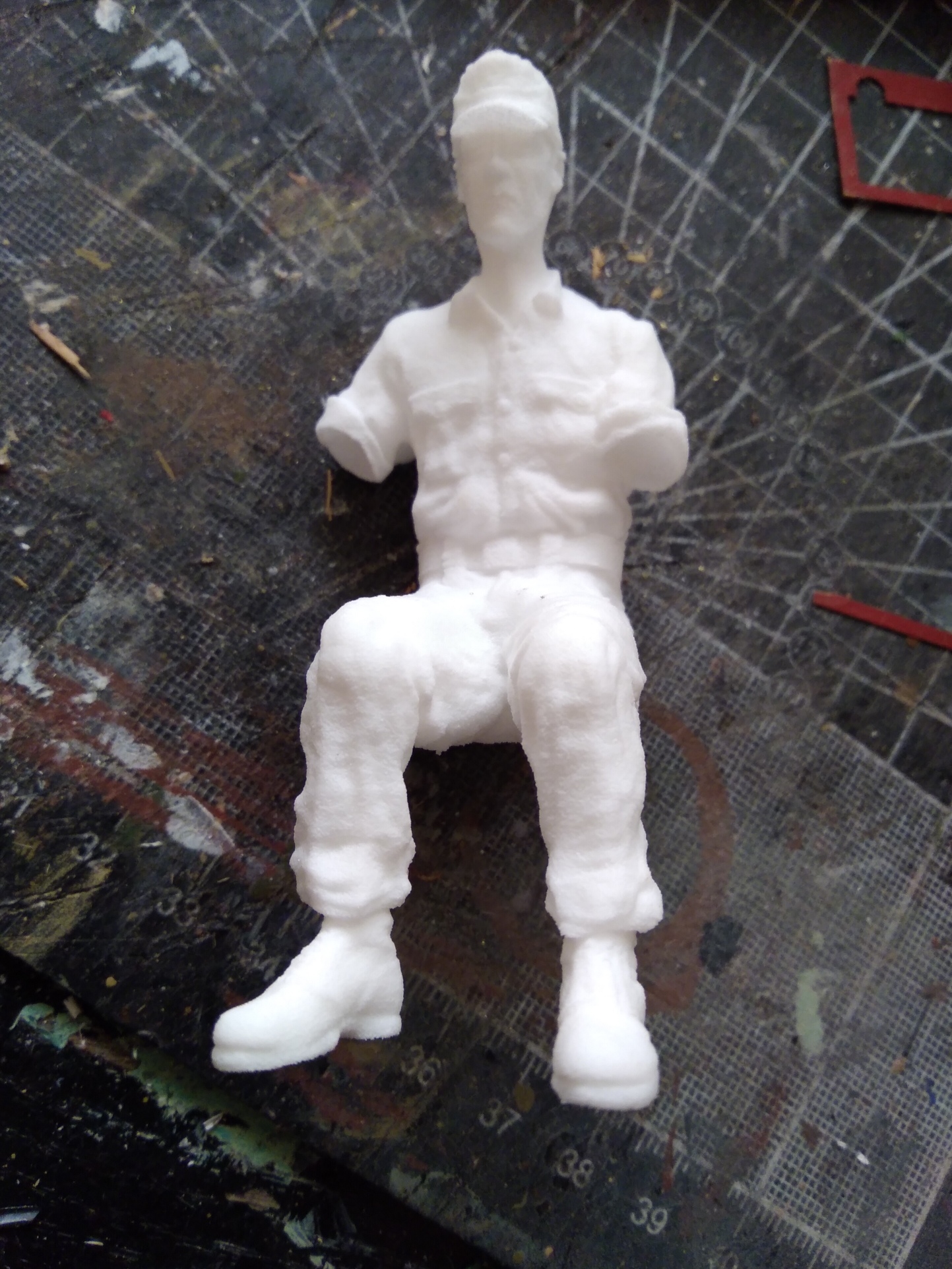

Here is the figure I am hoping to be able to modify to man the 88mm. He is resting quietly in pre-op prior to having both his legs amputated and re-aligned. I promise he won't feel a thing.

They are made of what is called "White strong and flexible" which probably is nylon. Glueing is an interesting subject. I asked the designer, who recommended what he called white carpenter's glue. I assume this to be PVA. I tried this and it did not appear to work. Ordinary superglue is no good as it gets absorbed, the material being very porous. I have reattached the legs, using Milliput to fill the gap. That stuck to one side, so I administered a dose of UHU to the other side, and it appears to be holding. I tried a selection of plastic cements and none of those worked at all. One suggestion on a forum was to use superglue in gel form, which stops the absorption.
For painting, you have the same porosity problem, so a good coat of primer is essential. It is advised to soak the parts in a solution of washing up liquid for several hours and give them a scrub with a toothbrush before priming. The finish on the figures is quite granular. Sanding them down is not really an option as you would remove all the detail. Similarly, trying to get a smooth surface using filler would, to my mind, have the same problems. What I did with one as an experiment was to use toothpaste and a toothbrush. There did seem to be some improvement. A second figure is being painted without the treatment so I can see the difference. The overall finish does not compare with resin figures or plastic kits, but you do have access to a range of figures. I have taken the view that they will generally be viewed from a distance, so the finish will not be so obvious. Pictures will appear when the figures are finished.
