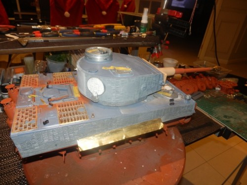

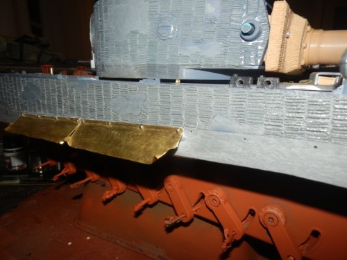

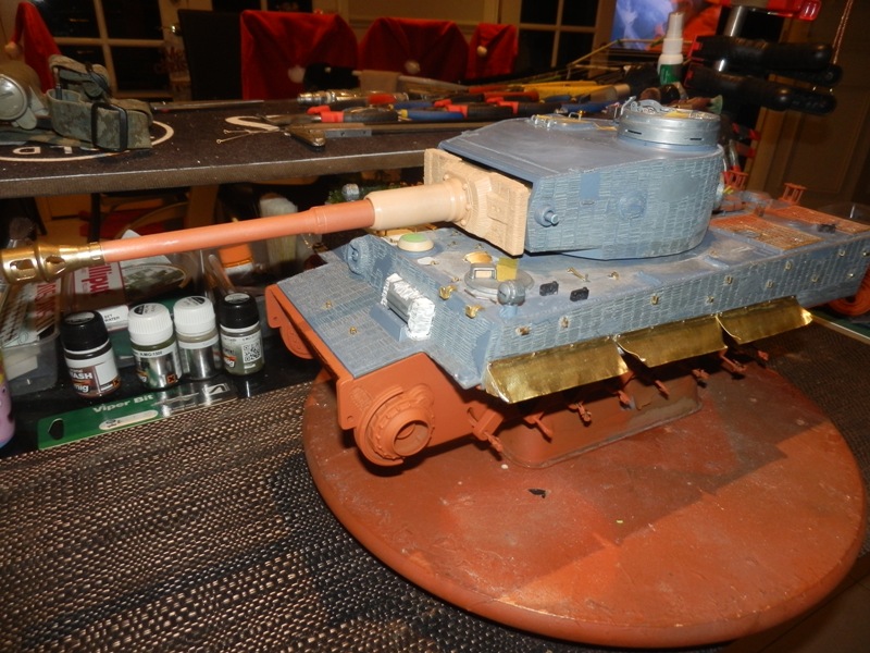

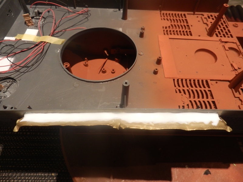

Getting both sides on and secured by layers of PVA & apparently "hi-Impact" resistant gel super glue.
The dress making pins are bent over after the super glue is set, and the PVA is then applied in heavy beads to add as much support as possible.

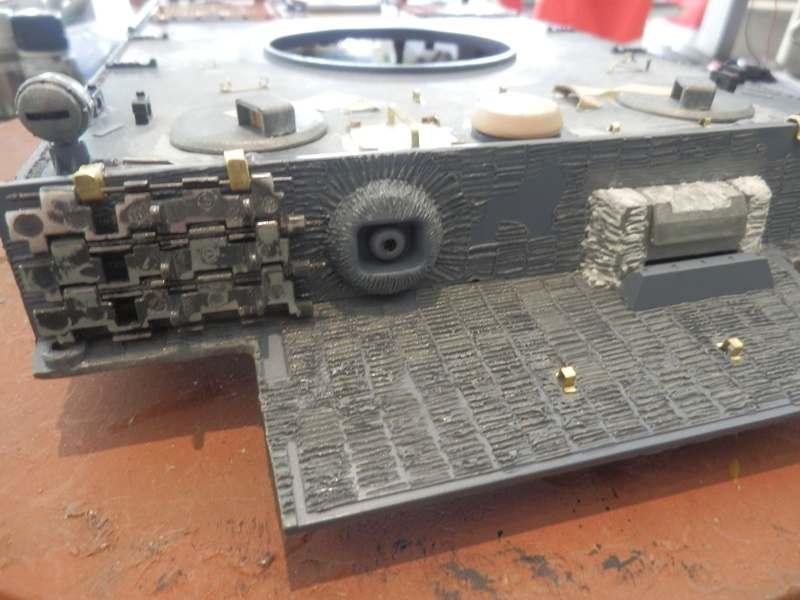

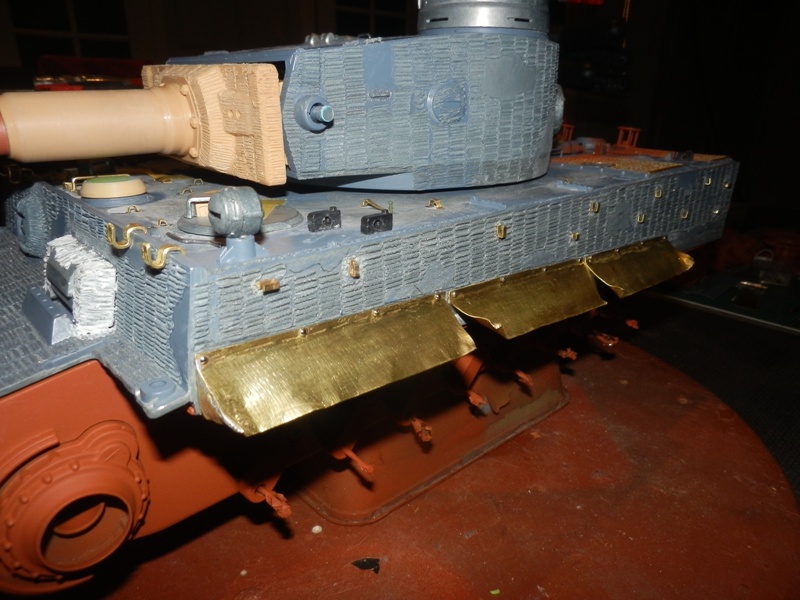

I took the tools to the left side and distressed the guards as much as I felt they could realistically cope with in scale-real life being exposed to the rigors of mobile combat for the time this AFV might have seen field service.
A tough decision to make with my indicators being a tank training school machine stripped of accessories then hurriedly pressed into service .............how much damage/neglect/training collisions/combat line-of-march travel to front line could F05 had endured ?? :think:
Soon I will get the Taigen recoil unit set into full forward battery and complete the roadwheel setup........then its on like Donkey Kong !! :shifty: :shh:

Ive made the drivers off-side worse than his on-side simply as his line of sight and positioning of his Tiger on the move through obstructions would be difficult to judge.

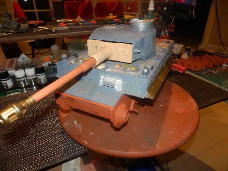

Im leaning towards a Dunkelgelb hull with a different pattern turret, we know these machines were made up of repaired hulls & turrets fitted with the late steel wheels & tracks to provide training vehicles so the likelihood of different hull/turret combinations is high.

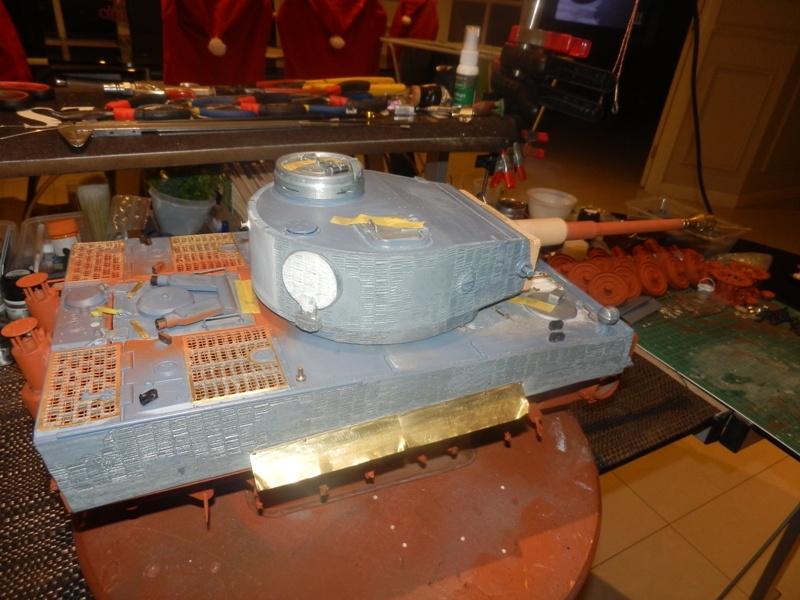

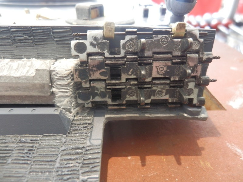

Got the spare/armour augmentation track link hangers on the front plate.
Bent up some brass flat and secured in place with the hi-impact gel super glue.
I used some Mato early track to set the positions for the hangers, so I hope the Taigen late tracks I get will still fit.
Seeing F02 and 13 with spare track links on the turrets I can take a leap of faith that even at a training school, they still needed to change the odd blown link.
As it is the roadwheels and tracks have been replaced from early to late, so the track link stowage would also be changed I expect.

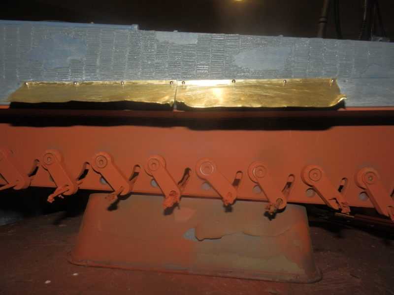

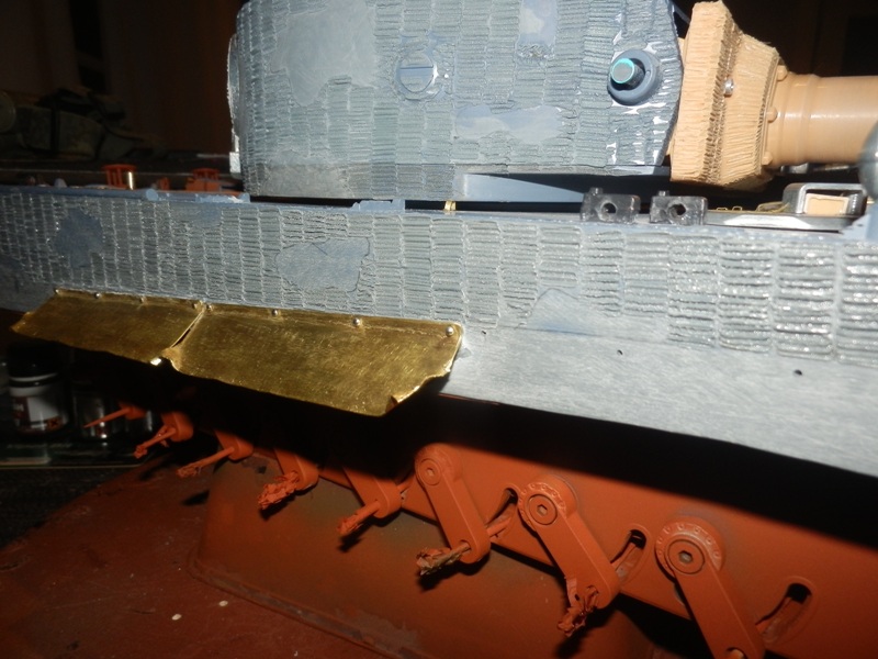

Its looking the part now. Distressed the drivers side mudguards after trawling through loads of various pictures.
The odd thing about them is they seem to take a huge amount of battering but stay attached to the vehicle.
Im wondering if they had sections missing due to the bolts holding them on coming loose ..........and the entire section dropping off.

My only concern with using the late links is the ice cleats. They'll push the track links about 1-mm further from the hull than the early tracks. Not sure if that will affect the spacing for the holders.
