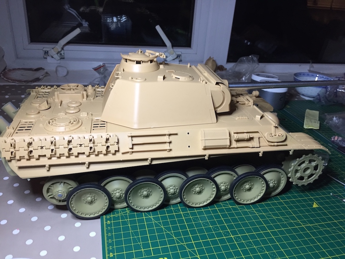

This is what it looks like now: Having topcoated the chassis in dunkelgelb at the same time as the Panzer IV (how's that for a production line?

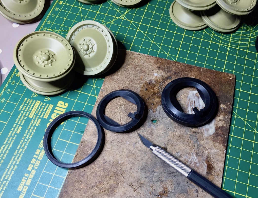

) it's time to fit the preprepared and painted road wheels. But first, though, it's necessary to go though the painstaking process of liberating the rubber tyres from their Tamiya sprues. A Craft knife is needed for this. However, I found that after a small incision along the sprue join, it was possible to tear the tyres out carefully. Any roughness (and there was nothing really noticeable)
evident on the ripped edges, was easy to conceal by fitting the clean (uncut) tyre edge on the outside of each wheel, where the gaze of rivet counter eyes is most likely to fall
Do keep a first aid kit close by though, as it's easy to nick a digit doing this.

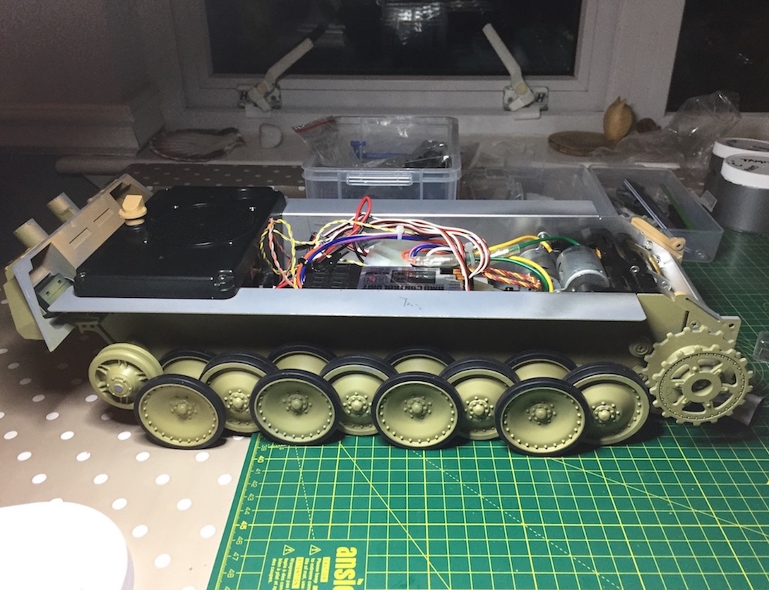

It'll be back to the unplanned Pz IV build before long, Folks, I'm just waiting for more bits to wing my way. In the meantime, in the intermission that is, this Panther G is almost complete now. The wheels are on, and shortly I'll be adding the tracks. One real pain is that every time you want to adjust the track tension, it's necessary to unscrew and remove the speaker unit first.
The track tensioner is really rather fiddly, and not very impressive too. It lets the overall build down where, for the most part, Tamiya's high standards are to be found throughout. As I've yet to get the track tension sorted, the speaker unit is loose, and so is the wiring- that's why it looks a little disorderly at the moment.

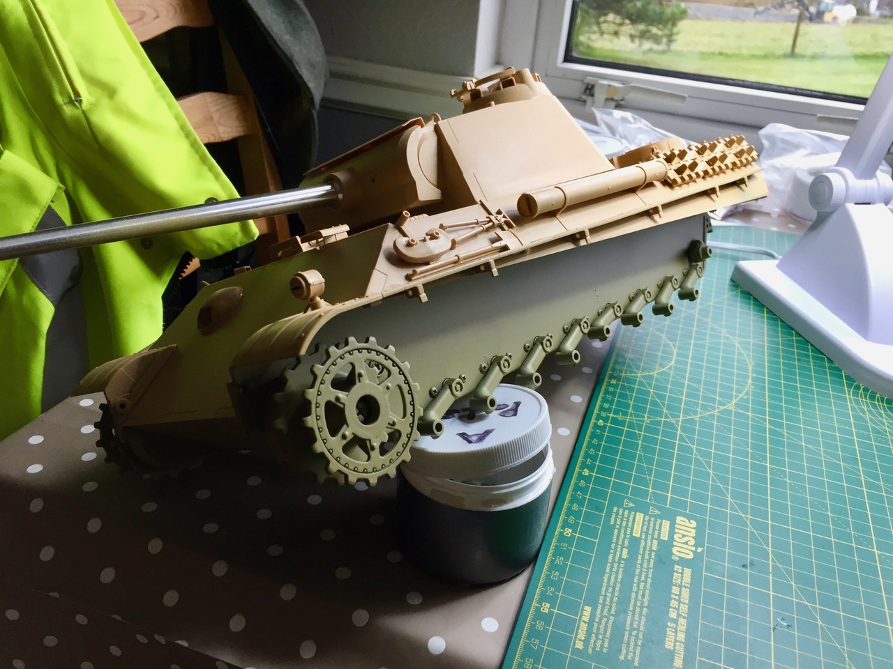

and how it looks with upper hull and wheels fitted. Tyres too.

Is there an aftermarket solution like the setup from Henntec for your beast to alleviate the track tensioner system being so fiddly?

With respect, I beg to differ. The track tensioner on the Panther is the same as on my Tiger. Once you have got the assemblies and the long bolts in with the lock nuts in place, you adjust the track tension from the outside underneath the vehicle. Turning the bolt (MD1) moves the nut attached to the idler assembly up or down, which in turn tightens or loosens the tracks. Try it - believe me it works. The only time I had to take the speaker out was after 12 months running when the idler actually came off.43rdRecceReg wrote:. One real pain is that every time you want to adjust the track tension, it's necessary to unscrew and remove the speaker unit first.The track tensioner is really rather fiddly, and not very impressive too.

There are nyloc lock nuts on the adjuster, beneath the speaker, Richard. After making any necessary adjustment you're supposed to tighten these, I'm afraid, in order to retain your settings..though you might get away with it, without locking them. I do know about the adjustment screws beneath the deck as, I did take the trouble to read the installation manualsilversurfer1947 wrote:With respect, I beg to differ. The track tensioner on the Panther is the same as on my Tiger. Once you have got the assemblies and the long bolts in with the lock nuts in place, you adjust the track tension from the outside underneath the vehicle. Turning the bolt (MD1) moves the nut attached to the idler assembly up or down, which in turn tightens or loosens the tracks. Try it - believe me it works. The only time I had to take the speaker out was after 12 months running when the idler actually came off.43rdRecceReg wrote:. One real pain is that every time you want to adjust the track tension, it's necessary to unscrew and remove the speaker unit first.The track tensioner is really rather fiddly, and not very impressive too.
