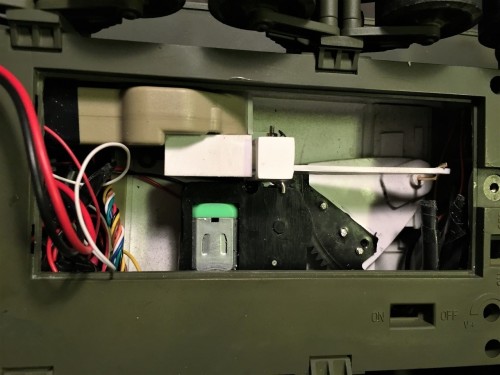

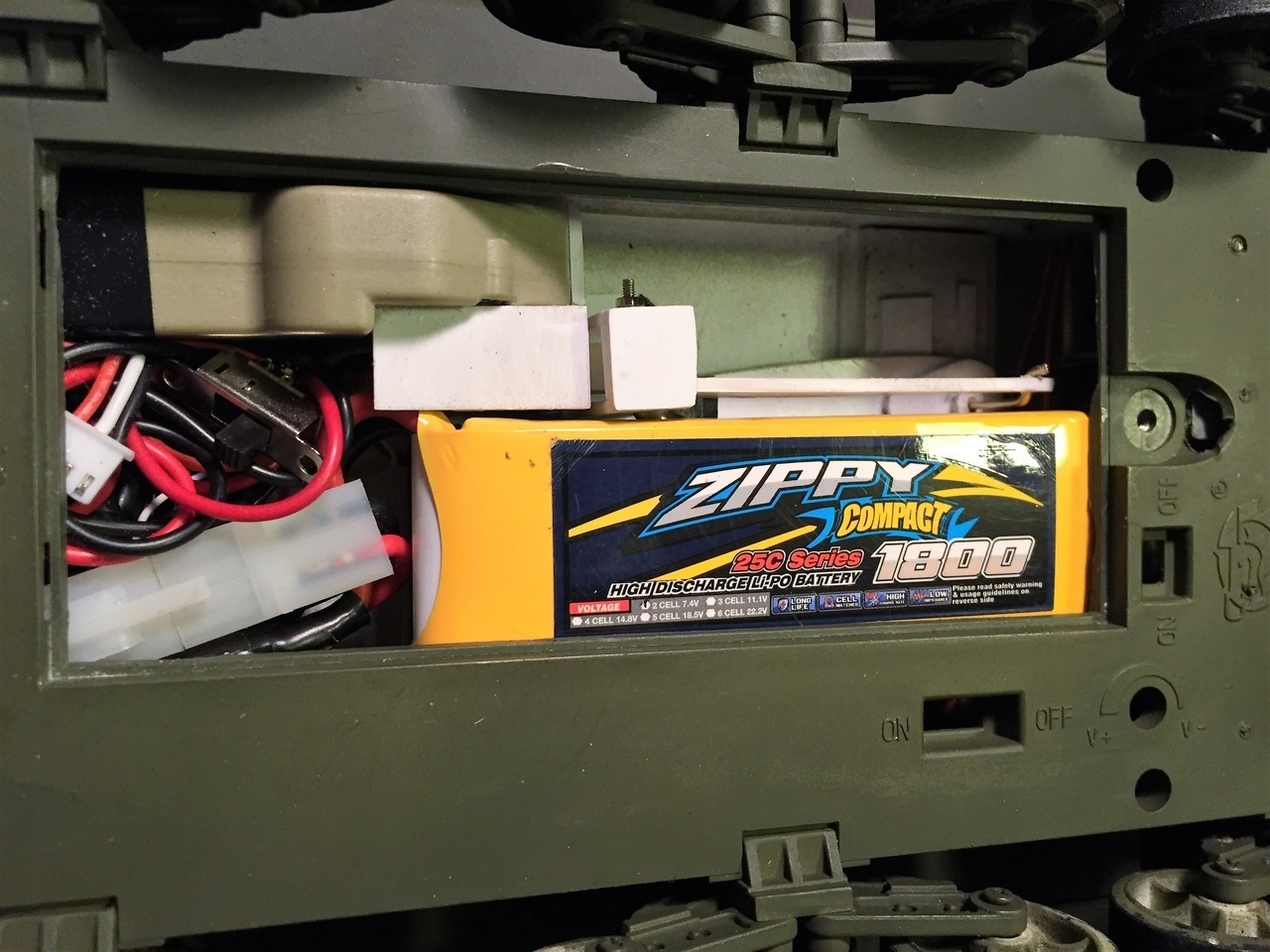

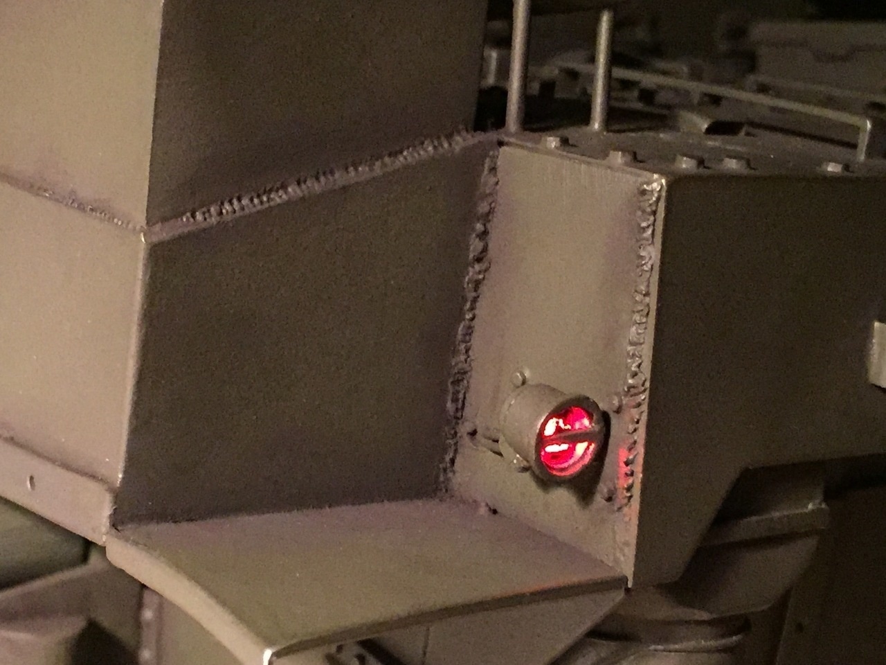

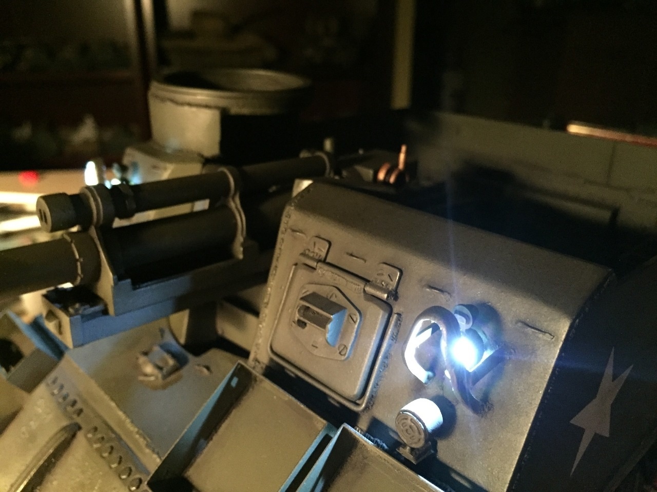

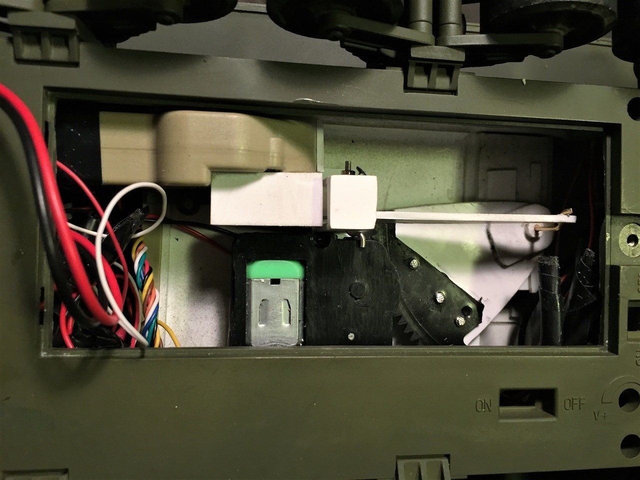

The rotation gear, home made elevation and the Heng Long electronics are installed. With such shape and limited space compared to a regular tank, the arrangement is nothing to be proud of, other than maybe having been able to fit it all, somehow. There is no smoke unit but the speaker and receiver are in the back, which required me to extend all the cabling. Ideally, another trap door can be made in the back. Let's say I did not make this vehicle to show off my electronics and gear skills...
Carl will recognize the battery he made me buy for the Nashorn, essential here too as nothing else would fit on top of the rotation unit. Thank you my friend.

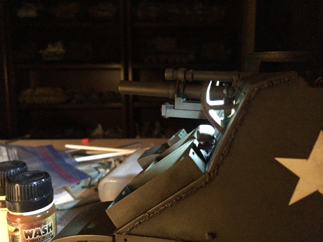

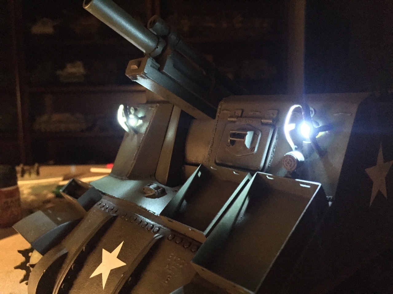

I think those Mato lights are amazing, quite powerful and realistic.
Elevation works ok, rotation could be improved, but it not like i will use these a lot. The shape of the vehicle makes everything complicated with no easy access to anything, it is obviously not as sturdy as a turreted tank. A wrong movement manipulating this tank and the gun, a fender, light, visor or spare track bin, etc can easily break. But it does look good and needs a lot of care.

Lovely bit of work to finally see it "alive" Louis. It's amazing that you could fit as much as you did in there to make the gun rotate and elevate
Great little battery for sure. The lights look spectacular and really look the part.

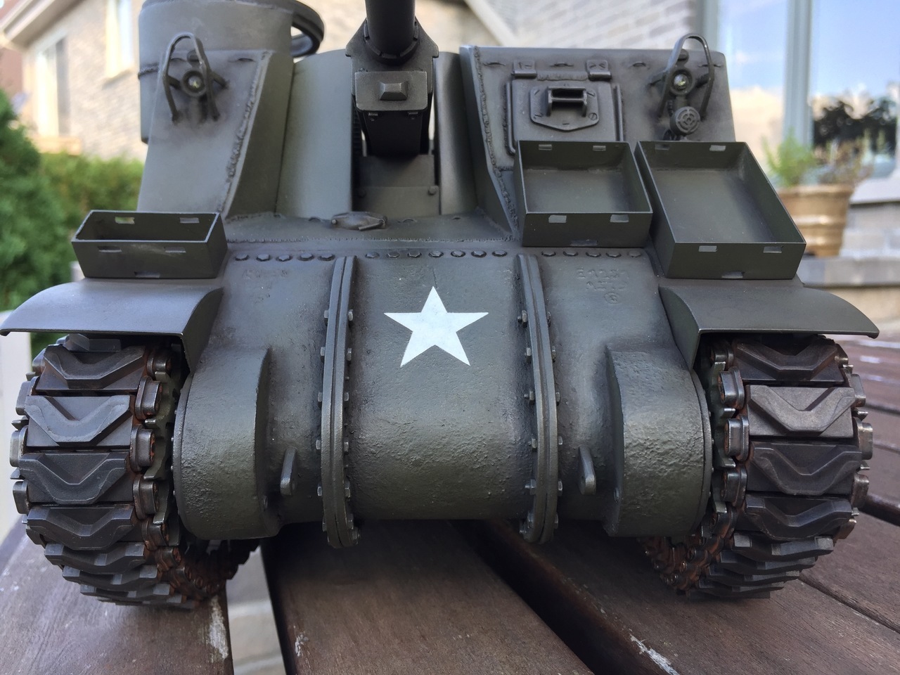

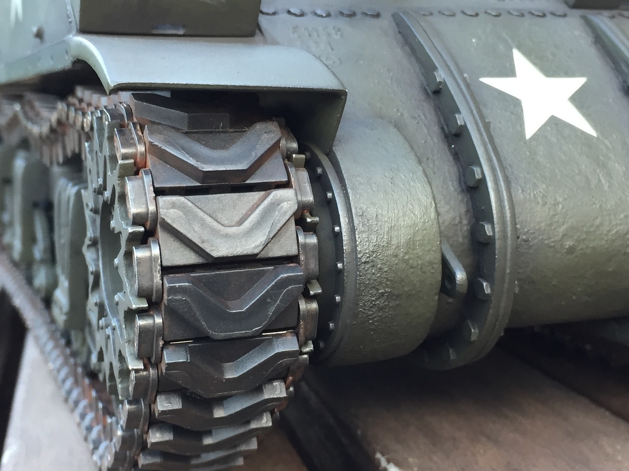

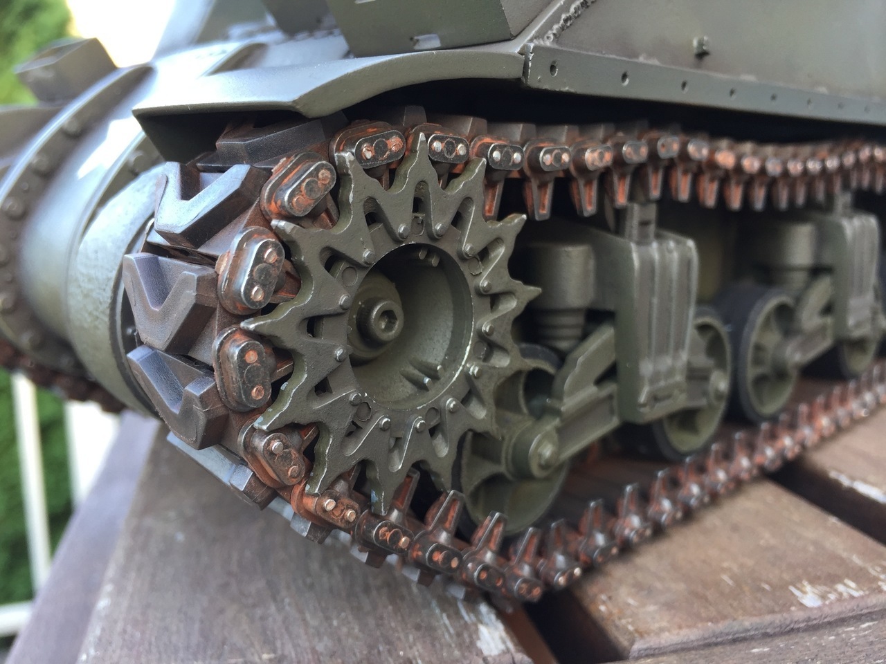

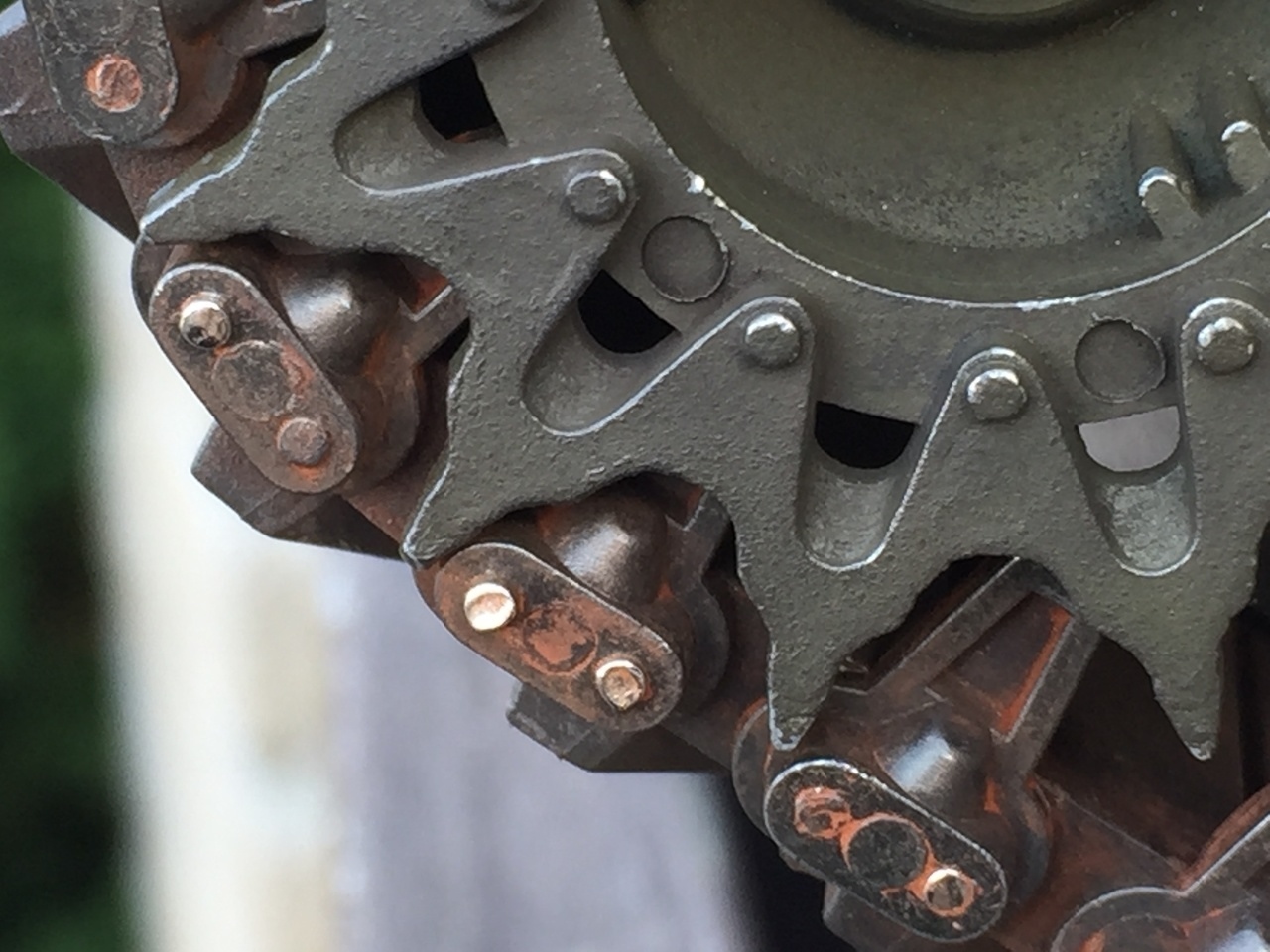

Here the Mato tracks are installed for engine trials. There were weathered a bit with Mig rust mixture on the metal connectors only and then dry brushed with Dark Steel pigments also on the connector. They are a bit shiny and new but that should wear off. These are solid and realistic tracks and hope they will run well with all the mods I did to the vehicle.

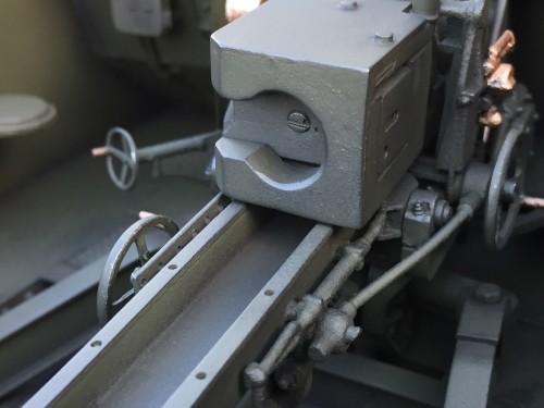

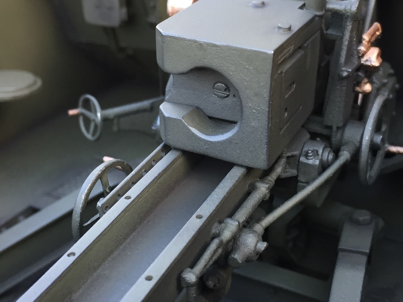

Metal hand wheels were installed on the gun, it's much better now I think.

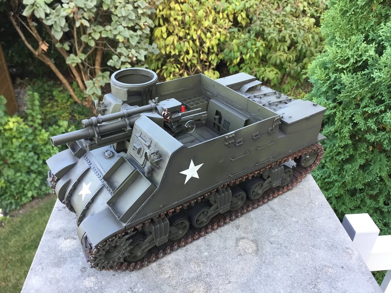

The M7 Priest as it stands today. On the outside, the front storage and tools still need to be installed, as well as the M2 Machine gun. The tracks are too loose and I am still waiting for the Mato idler adjusters to fix that. So I have not finished the back plate of the vehicle yet either. But it is getting close to the finish line.

Louis this has been one of my favorites for many reasons. The subject matter is very unique. Your personal touches are so nicely done. The paint looks excellent and those tracks have come to life.
These plastic tracks with the metal end caps are in my opinion as good as it gets. My set was shipped for about $30.00 US from Alibaba and they are just outstanding so Louis thank you for introducing them to me.
Well worth the needed mods to get them to run true like Mr Painless suggested
The dry brushing is a really nice touch that I now incorporate into my builds.
You know the build has been done to an exceedingly high standard when you can zoom in this close and wonder if it's the real thing!

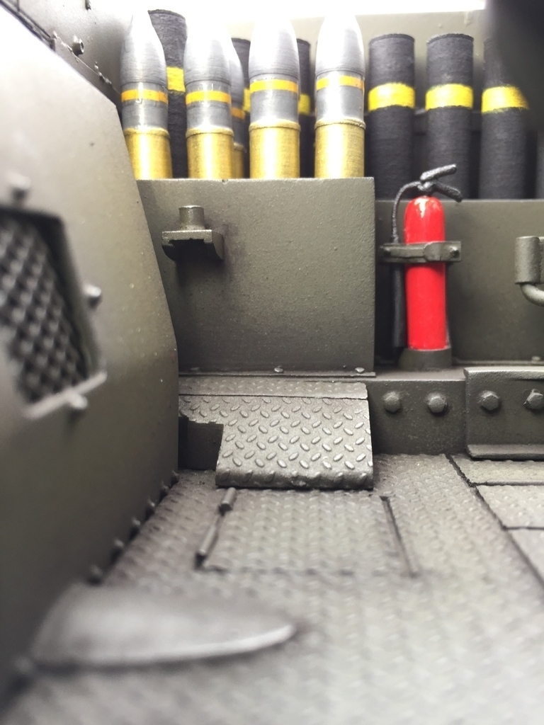

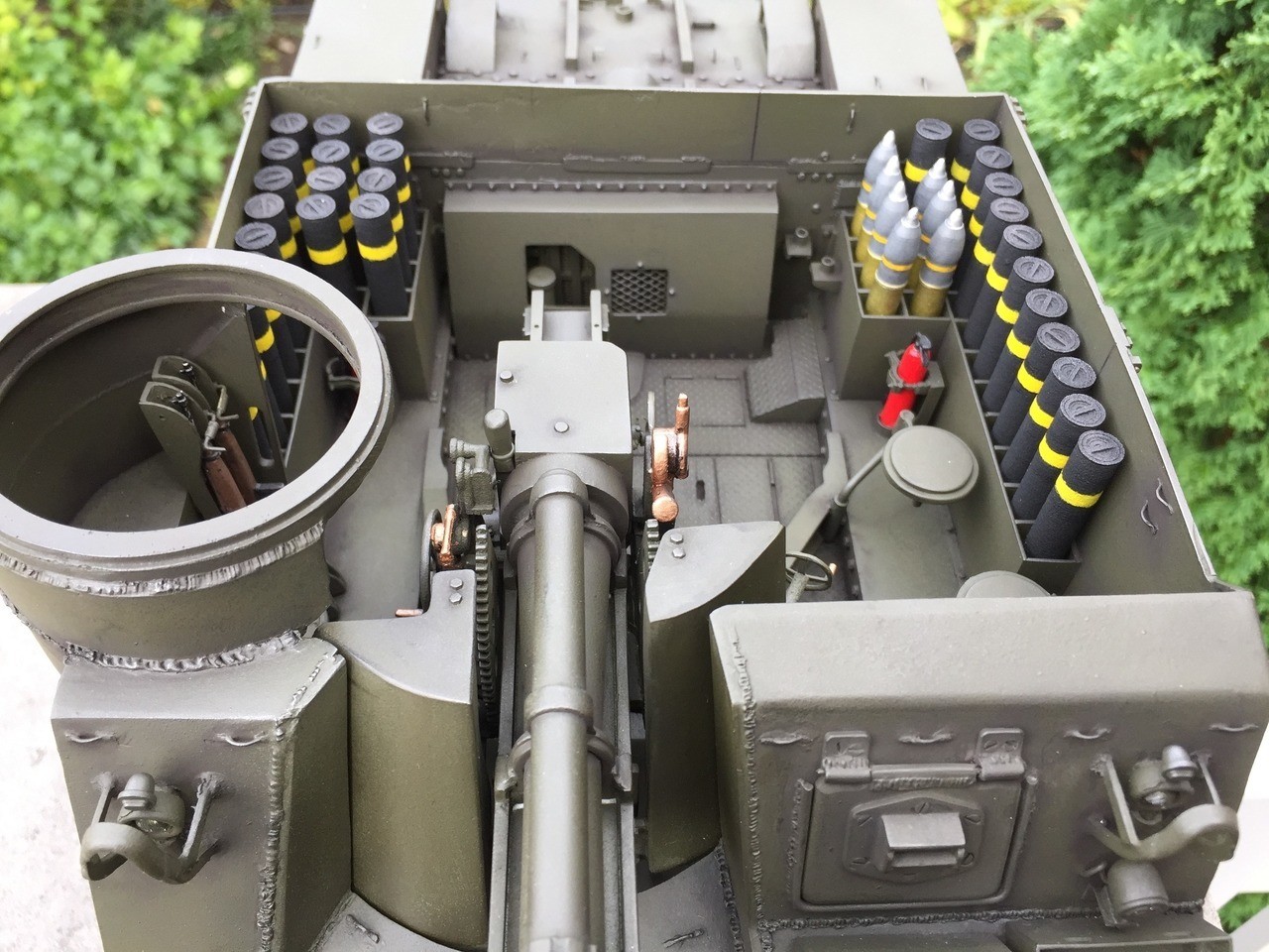

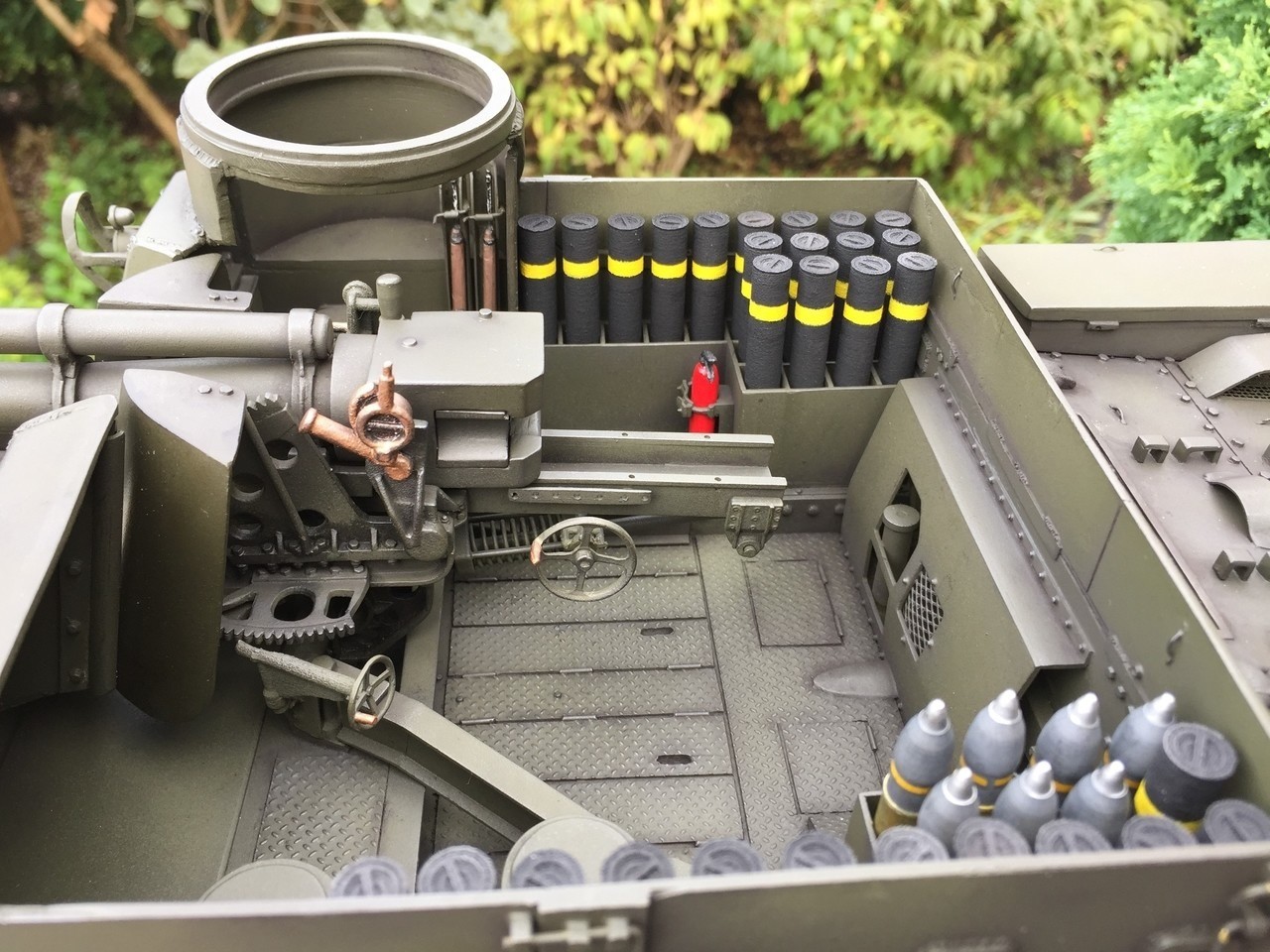

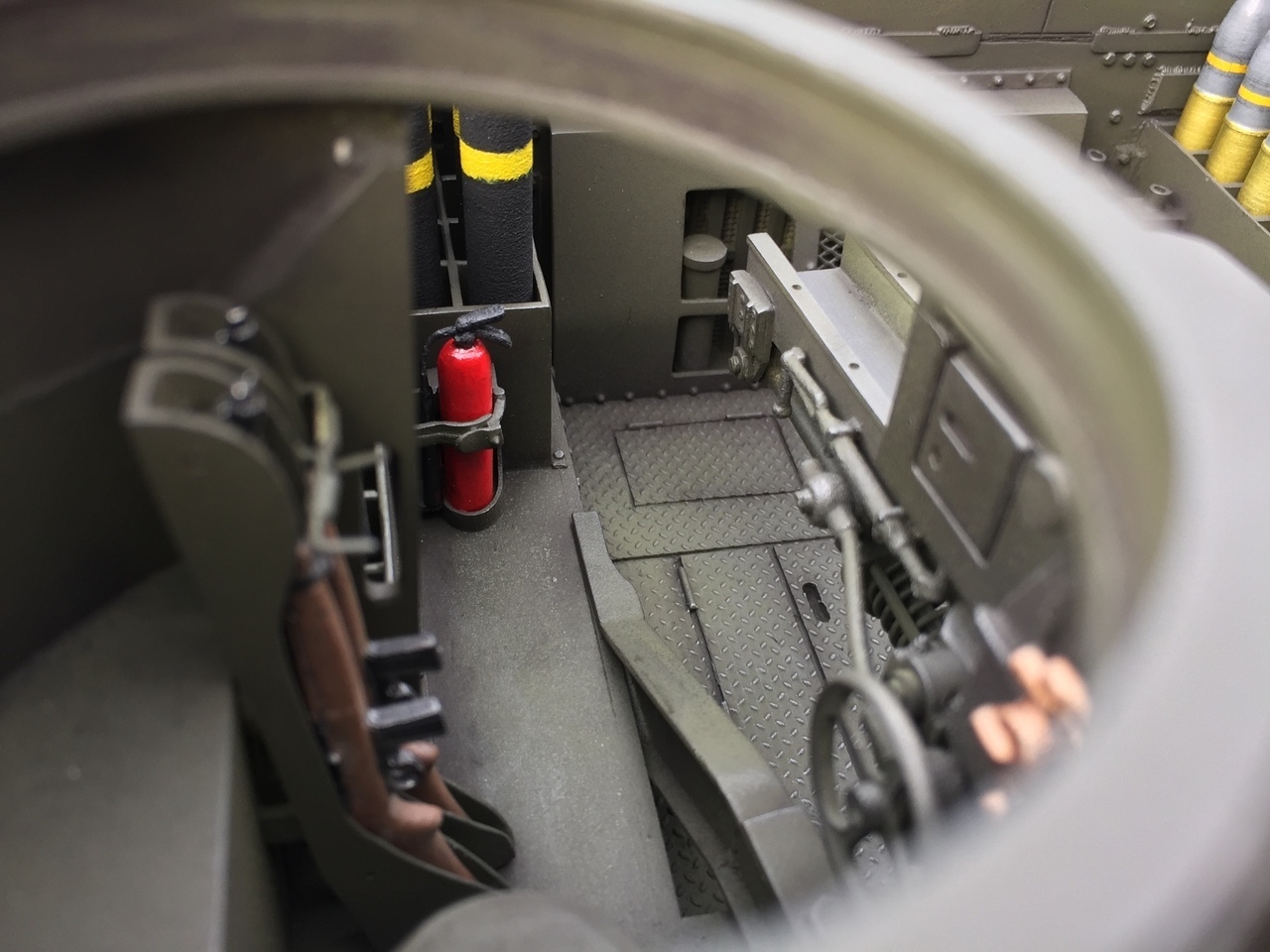

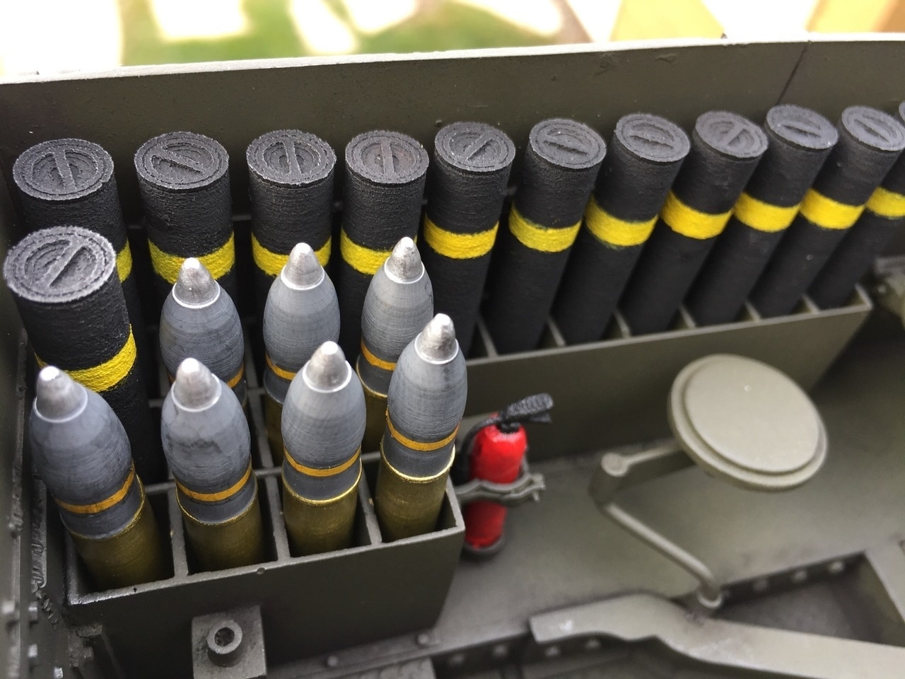

Today, I worked on the ammo and M1 carbines.
I gave the M7 the honour of a full load of ammo. This is the look I wanted, ammo mostly on containers with a few ready to fire rounds . War pictures show these empty black containers pilling up all around vehicles after a fire mission.
I did not sand the Shapeways containers because the real fibreglass anmo containers are also quite rough. However, I should have sanded them because it was very difficult to make the strait yellow lines on them. Decals would not adhere either. Still need to correct a few issues now that I see them on close up pictures. The lines seemed pretty strait with the naked eye, now I see corrections to make. It will take a few minutes.
Considering this is 1/16 scale, I am pleased with the results. The scratch building and extra details improve the look and accuracy.

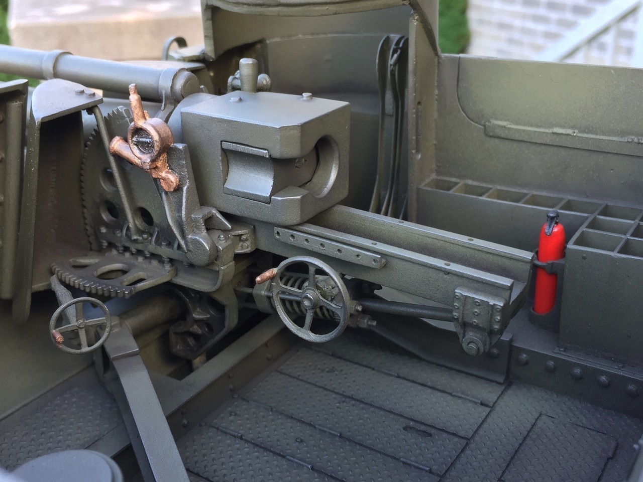

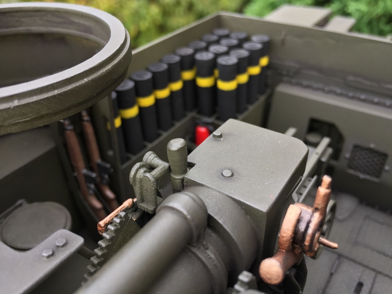

View of the top of the howitzer and sighting apparatus. I saw in pictures that originals are very complex and made in brass, difficult to reproduce accurately in this scale.

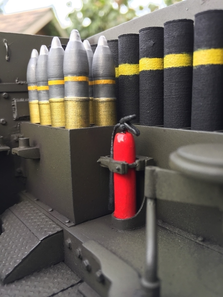

Here is a good close up view of the top of the Shapeways containers and the Vandra ammunitions coming with the kit. Sadly, I did not find any markings in 1/16 scale for US 105mm ammunition, it's all German or 1/35 stuff out there. I would appreciate any tips if someone know of a maker.

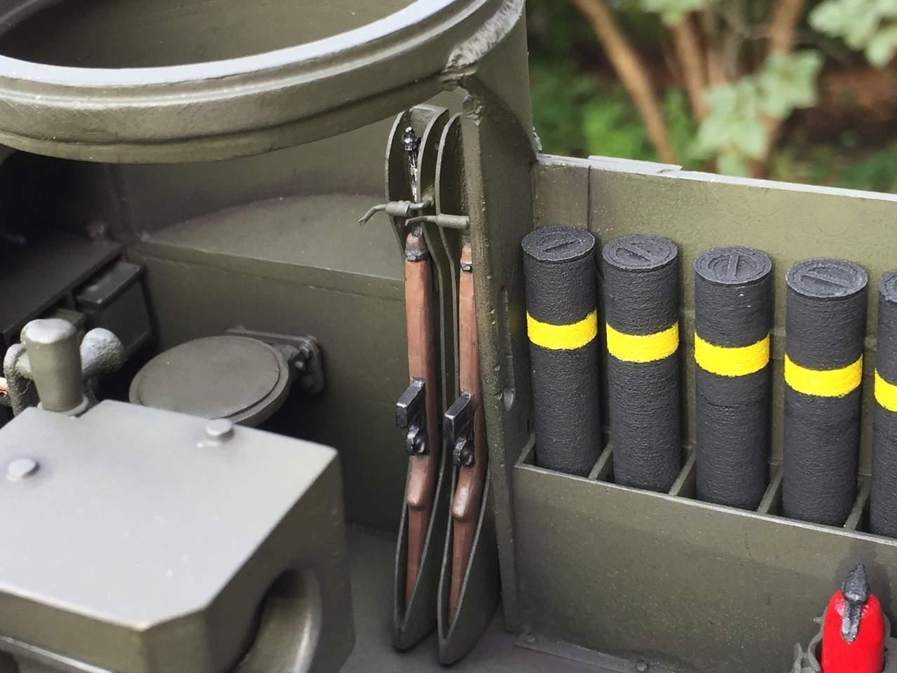

The M1 carbines have been given their first round at painting. I can see quite a few things to correct and improve on them with those close ups. These carbines are the kind of small details that add a lot of authenticity to the vehicle for a few dollars.
