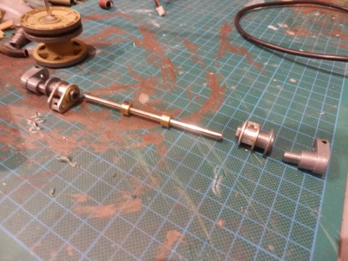

My new tensioner arms arrived from rctank.de
These turned out to be the ones with the 5mm mounting spindle not the 4mm ones.
Seems there have been failures of the smaller versions.

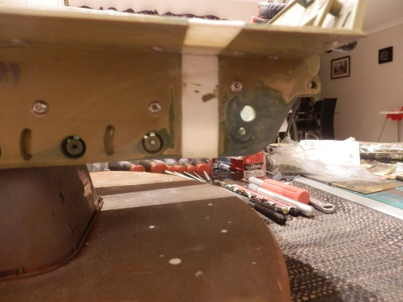

I have taken dimensions of the standard idler mounts so I can be certain the idlers are reinstated to the same spot.
Cut the old mounts off with the razor saw after drilling a descent pilot hole out first.
The new hole for the tensioner needs to be 10mm diameter.
There is going to be JUST enough room for the adjuster bolt to penetrate the floor right next to a stiffener bolt, which was a fluke, on the left side.
The right side I will need to re-drill the stiffener plate bolt hole & use it to locate the adjuster screw.
Short term pain-long term gain.
Appreciate the tensioner unit Mr Jackalope
Its going to work a treat.

Re: MATORRO JAGDTIGER CONVERSION
Did they send you all 4 parts for it to work? Please don't say you only got the arms that the idler goes in. I hope they didn't mess you up.
- Posts: 11546
Yip,all 4 as the bigger spindles on the arms will not fit the sockets that you sent me.
I will need to get new adjuster bolts though. Hex heads will last better than the flat blade/ Phillips that are standard.
