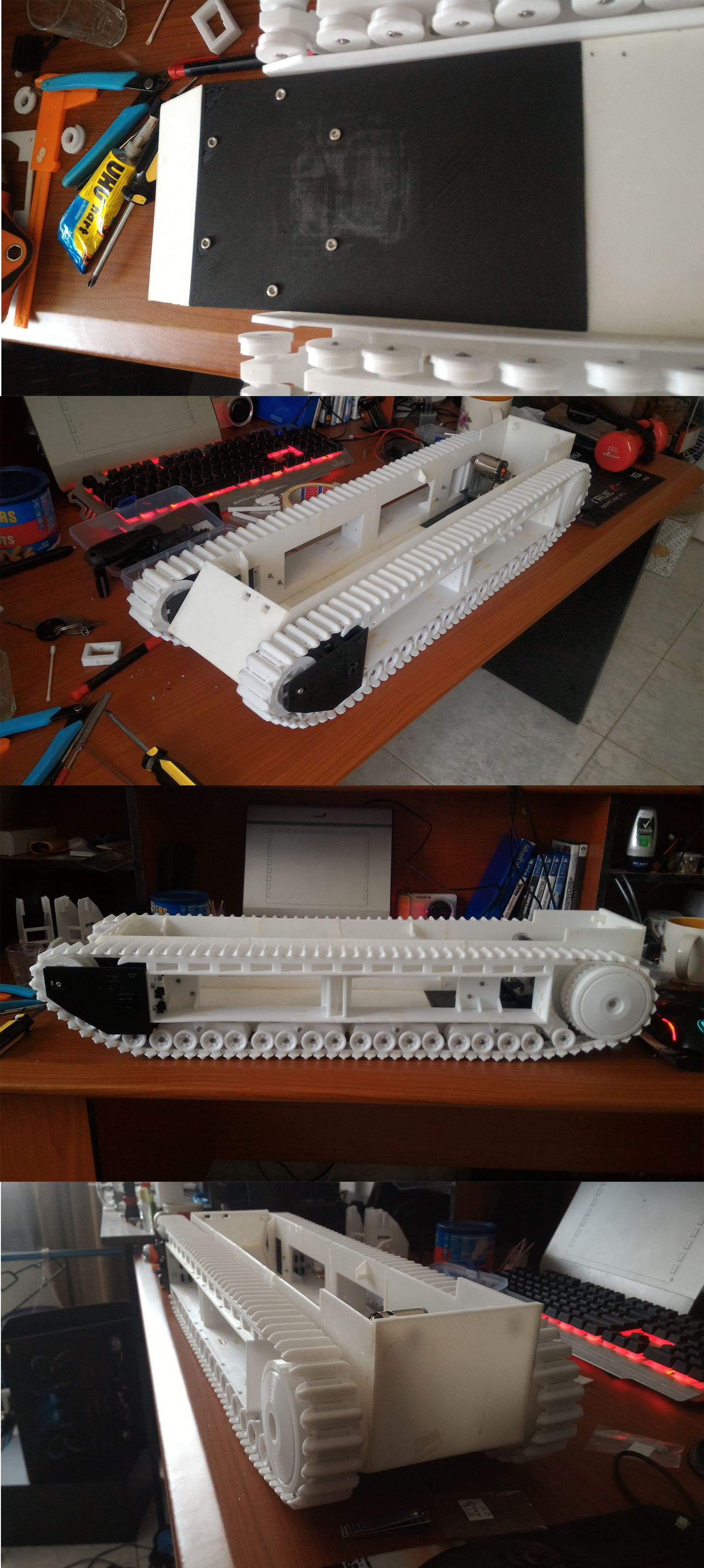

closer look of the GB platform fasterners flushed to the hull panel
both tracks installed!

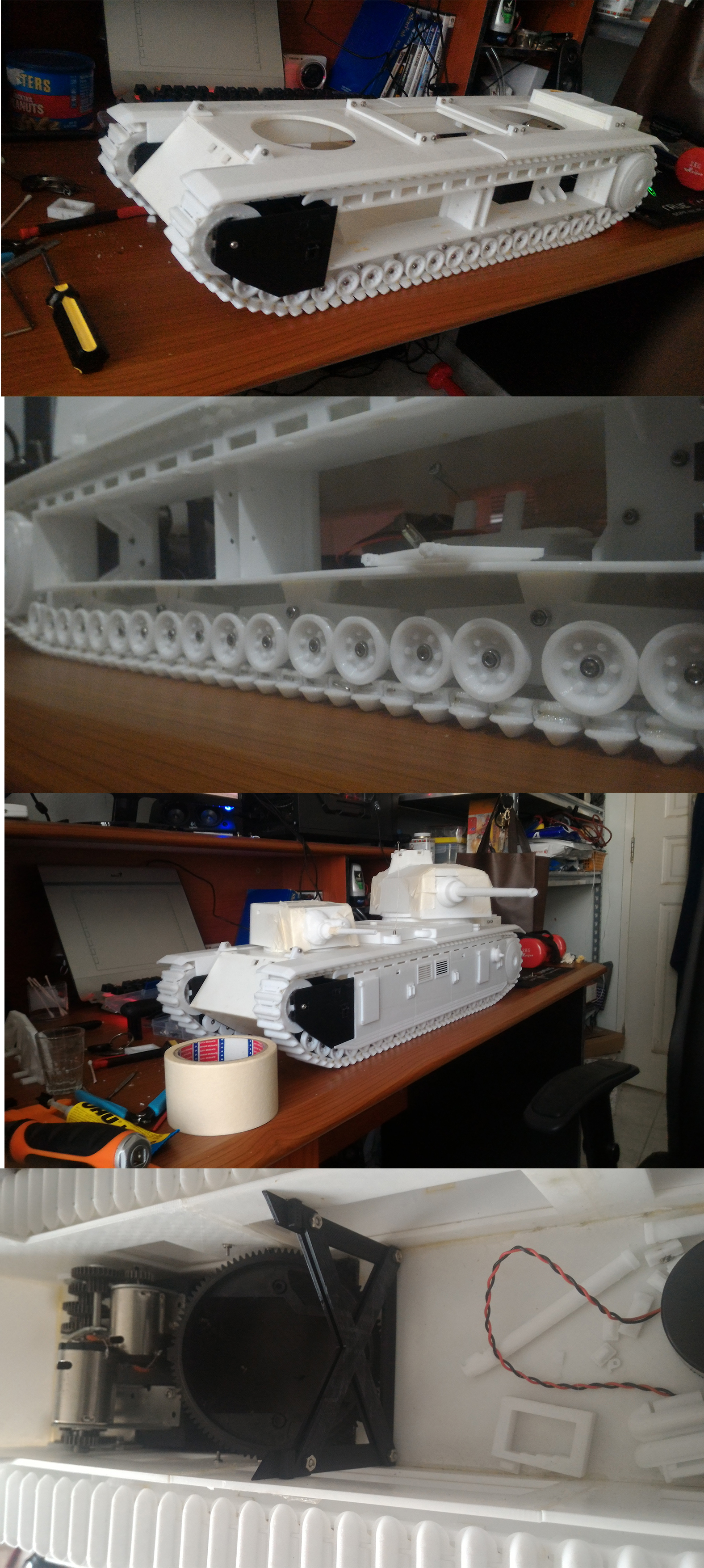

installed the roof bits
W H E E L E S
Now strike a pose with them turrets~!
improved structural hull framing to increase hull rigidity

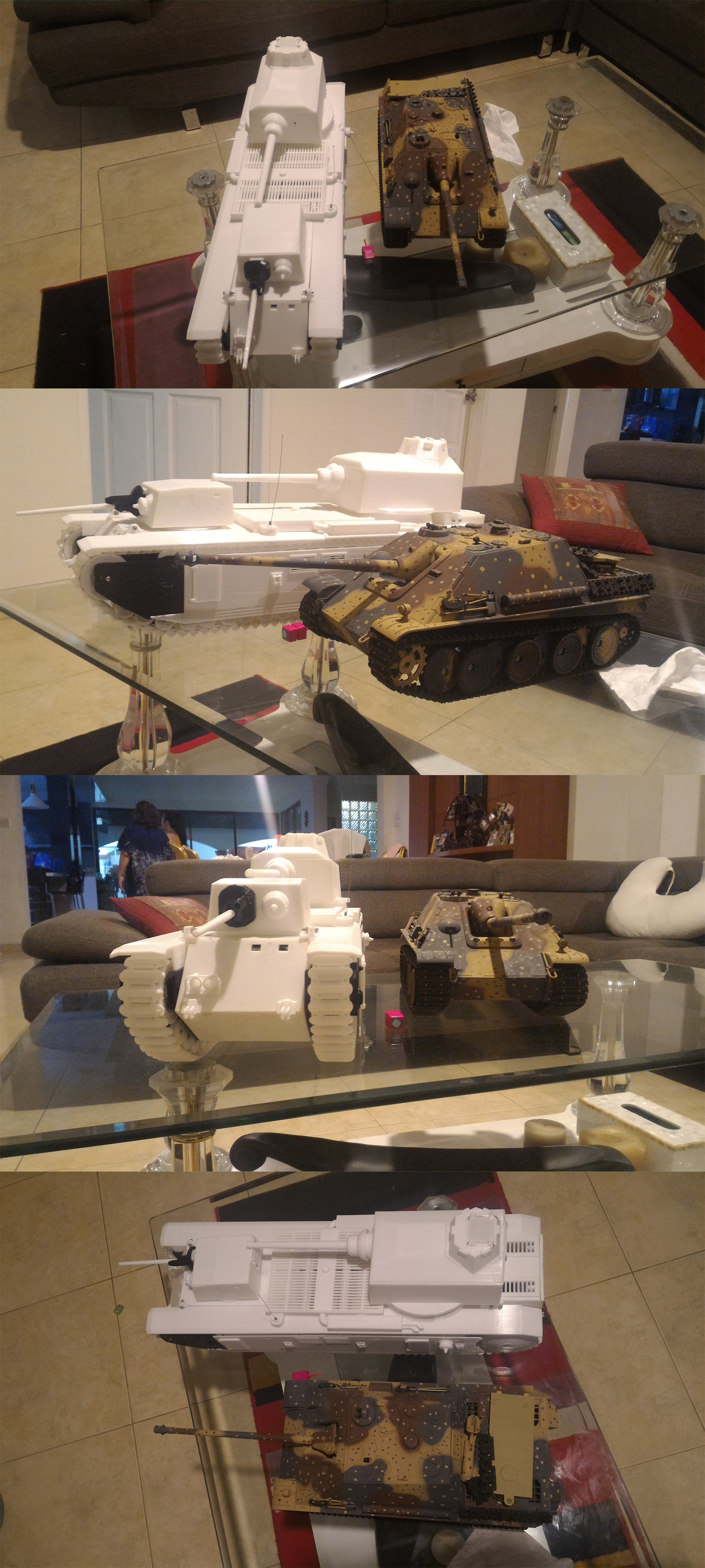

i feel satisfied with my current progression of the tank and i cant wait to get it up and running!
also size comparison next to a 10ML Tamiya paint bottle
Re: Gig's 1:16 FCM F1
Posted: Mon Aug 12, 2019 12:05 pm
by Giganaut
now for a better size comparison i placed it next to a Heng Long Jagdpanther of the same scale 1:16. yes i made this beastly french baguette barge 1:16 scale hahahahahahah
hoo boy... im gonna have a total fun time trying to steer this beast

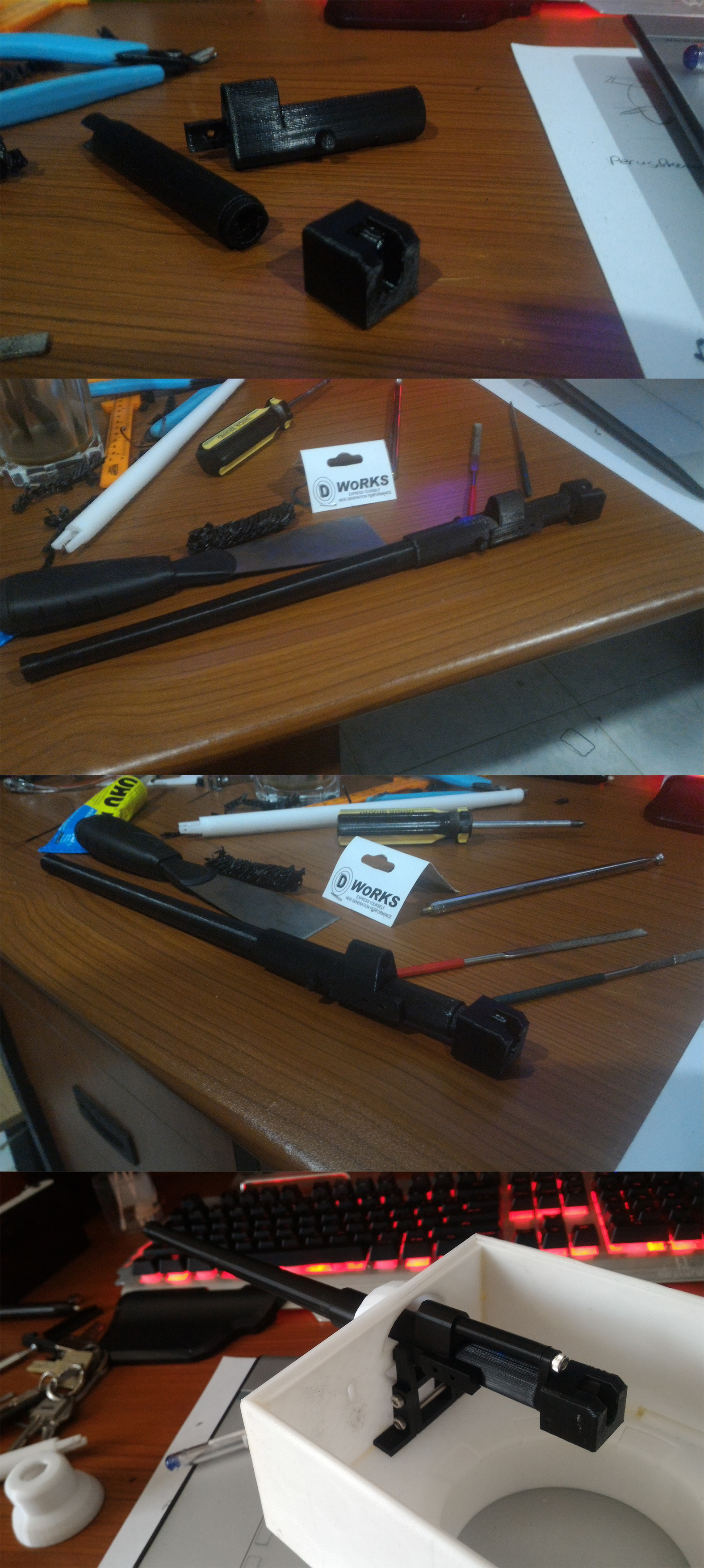

remade the gun barrel with a better version with the cradle modeled in the dummy recoil cylinder. servo mountings will be added later.

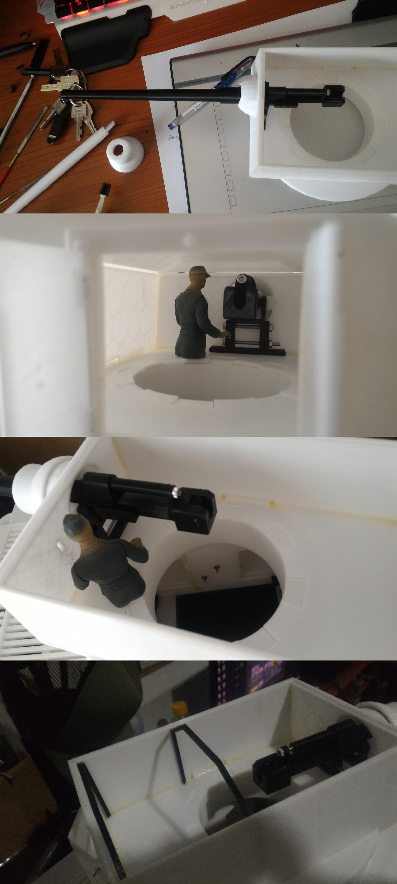

gun installed into the FCM's main turret for dry fitting, and added a dummy crewman for a size comparison of it for proportions. added turret roof framing so the turret roof doesnt slide off and fall inside.
