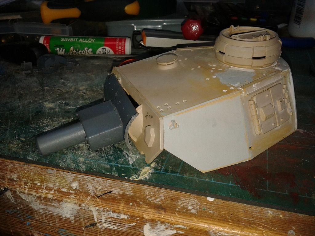

First mods on the turret were cutting off the vision ports and tidying up the turret sides, the signal port in the roof also had to go:

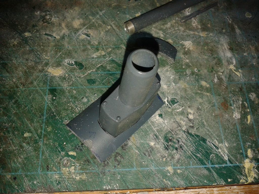

The mantlet was then cut up and stuck back together to make for a more realistic look:

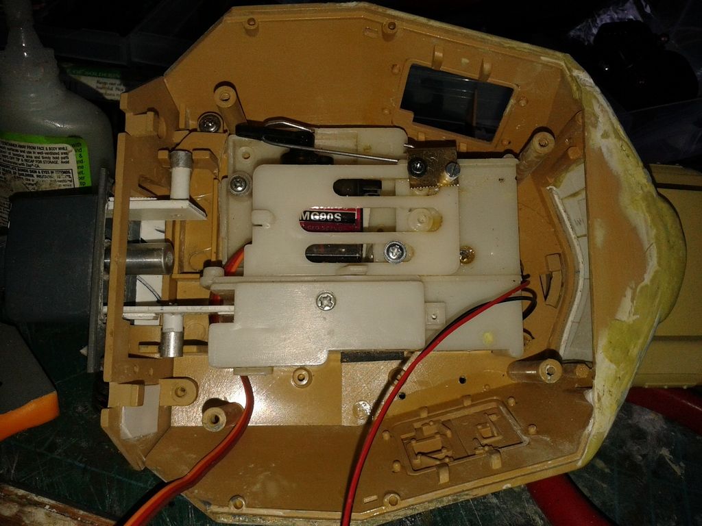

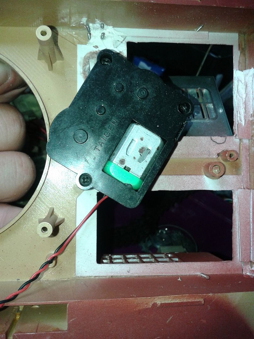

I intend to install either an IBU2 in the tank, so decided on servo recoil, I used a broken taigen recoil as a base, removing the recoil gears, motor and installing the servo and a homemade linkage (the control rod is a piece of piano wire). I resoldered the elevation motor onto a HL 3 pin plug.

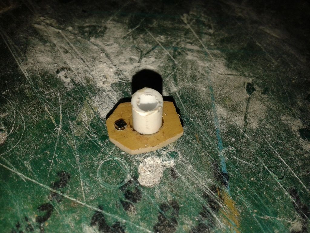

as you can see I had to make up a set of trunnions to fit with the asiatam unit, the front of the BB tray that forms the pivot in the HL was cut off and installed, I also installed a tube for an IR emitter, hidden behind a viewport in the front of the turret, the port cover is retained by a magnet and a piece of tube that fits inside the emitter tube:

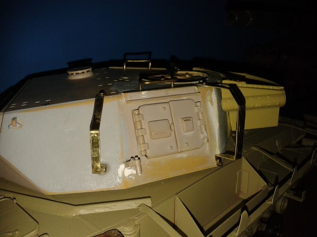

I have also attached the schurzen brackets:
After I took this pic I realised I had a front turret bracket in the middle which has since been corrected.

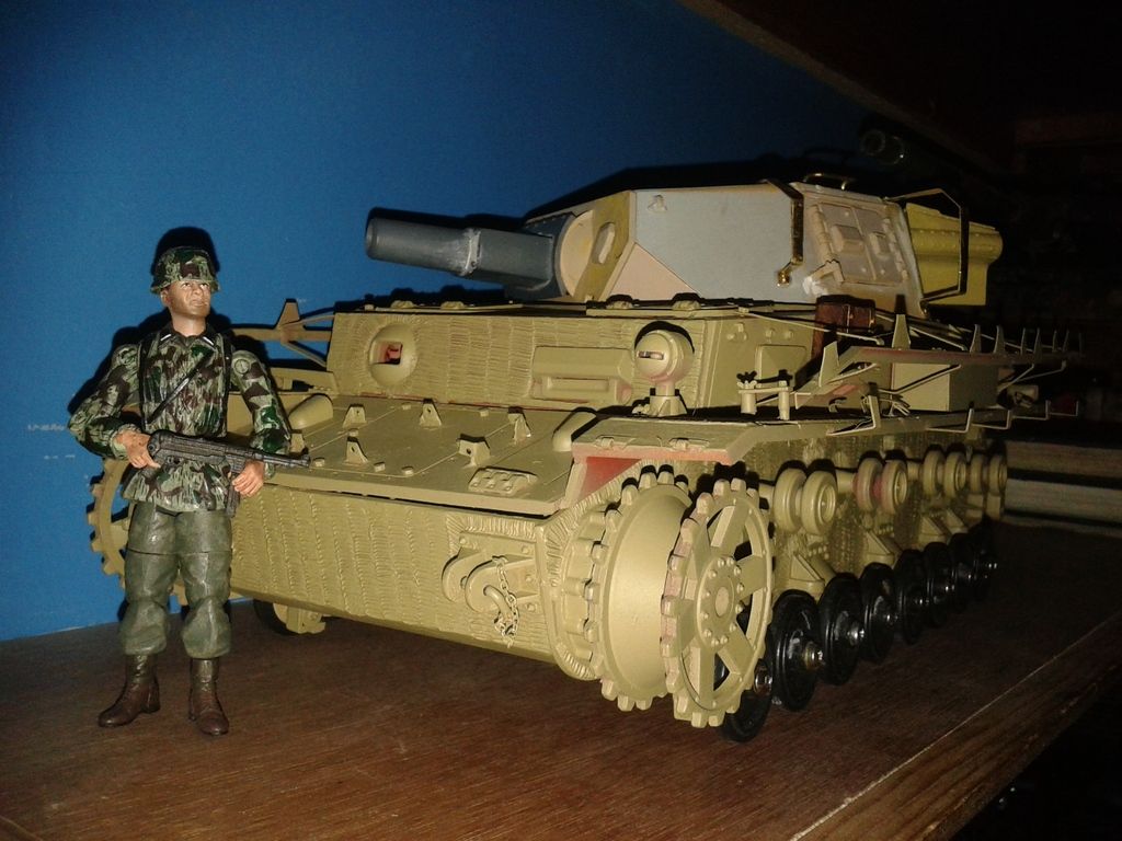

I bought some of those 1/18 soldiers, they fit quite well with the tanks:

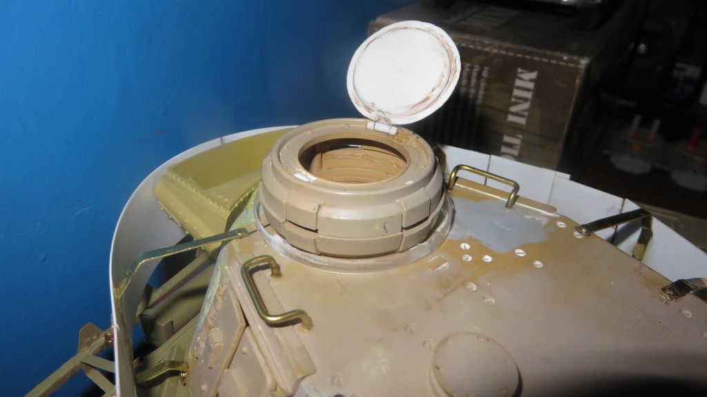

Got the schurzen done, have also added the extra armour ring around the Cupola and started on making a hatch (The H had a hatch not unlike the one on an early tiger, rather than the earlier split hatch)

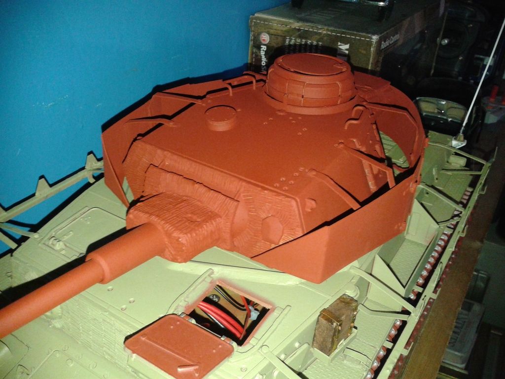

Turret was painted with Halfords red plastic primer

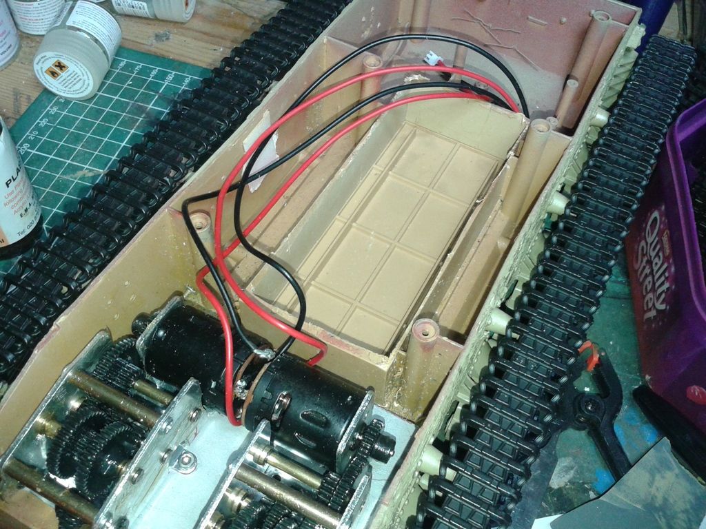

The rotation unit had to be fitted. I reused one of the pegs that got chopped off when I fitted the hatches. For the wiring I have gone with the new heng long setup of making all the connections using plugs instead of soldered joins for easy maintenance.
I also fitted a set of low profile 5:1s, I had to make a metal plate up in the end but they work OK. I also chopped the top out of the battery box so I can swap batteries without turning it over. The tracks were painted with wilko bbq paint:

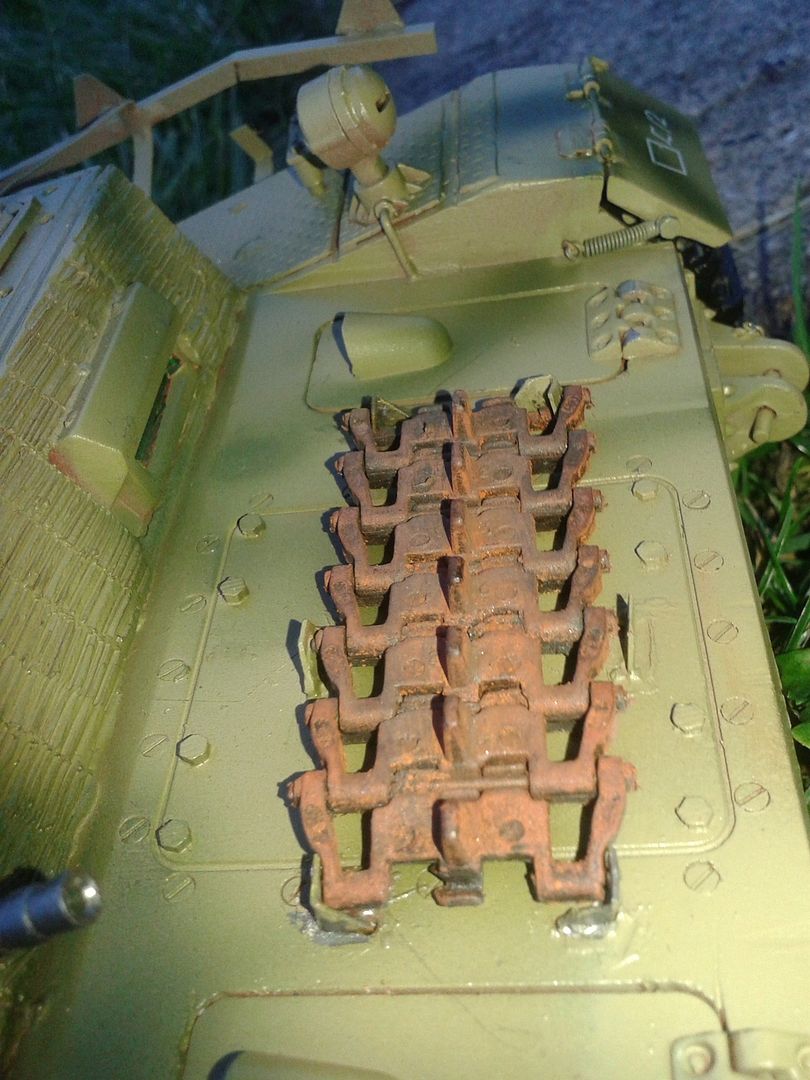

Experimented with some pigments on a piece of spare track: Image

Pray tell...I have a set of the brass 5:1s low profile gearboxes from Asiatam. Looks like you used the steel ones they have now (possibly with a new motor). It also looks like you were able to raise the sprockets a little. I'm trying to do the same thing but having a devil of a time doing it. The two big (side-by-side) gears keep hitting the top if I raise it more than a millimeter. Angling it doesn't seem to work because I can't get it to mount in the holes. Killing me... :crazy: :-<

Philipat I have the same problem as you, but the hull is also a little warped due to all my chopping earlier in the build, the ibu2 also takes a lot of room, maybe a clark would be a better fit in a smaller tank like these?

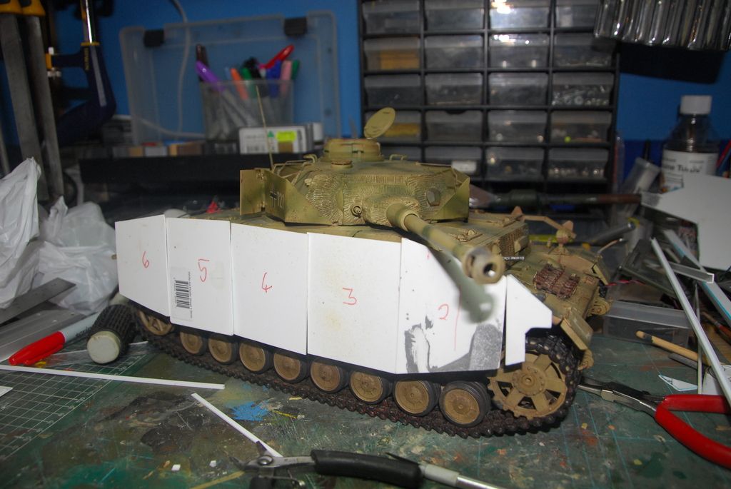

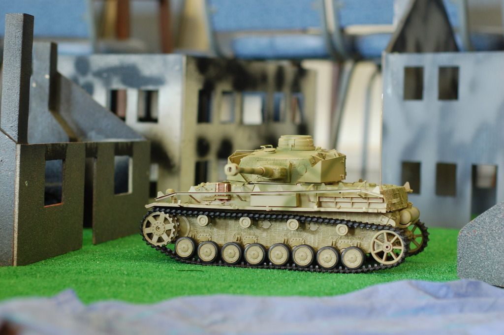

Anyhow, I have made up a set of schurzen out of plastic to hang on the sides, I suspect I will take these off for battling or outdoor running.

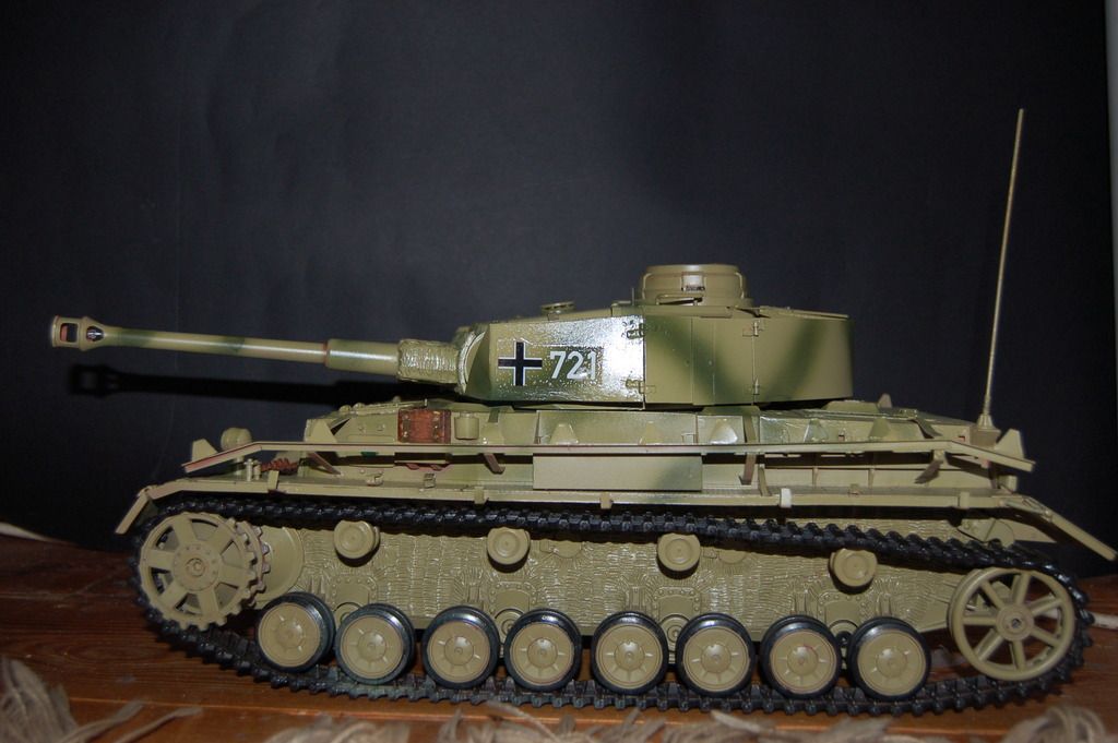

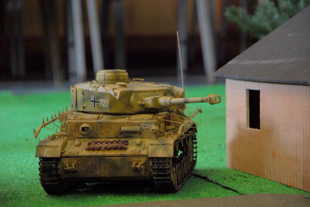

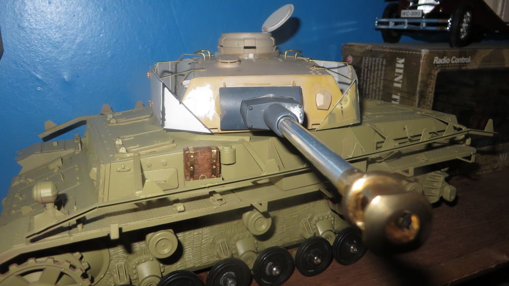

On the battlefield at Grantham Light Armoured Division:
You can see a little gap at the front, maybe i'll put in a small filler piece at the top of the front plate?
