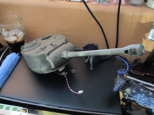

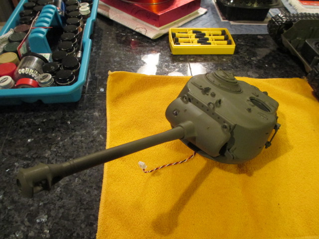

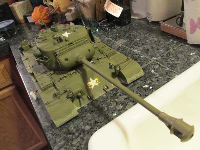

Good Afternoon,
Received a replacement turret yesterday from MideaTech in California. These are not guys that I would normally work with but Forgebear is still busy and MatoMart had the turret halves minus the airgun but not a complete turret. I had the option to buy a complete tank but once again, a ton of un-needed parts with no guarantee that the tank you receive will be the right model. This is something that I am painfully learning as I order replacement parts. Anyway, turret in hands and I discover that it is a 2.4 Ghz turret, the newest type from HL. This turret is already a newer version than the one that I purchased from Forgebear a couple of months ago. The wiring is simplified even more ( so much so that I thought that I had received a turret minus some of the wiring. ) Only a three pin plug is there and it plugs into the three pin connector on the 8 pin mini board as standard. I tested with the new turret and all functions worked normally using the HL 2.4 GHz set. That is where the 'easy' ended. The swap over of the air gun was simple except for the ammo feed tray. HL has a new and much more 'Tamiya'-like setup for the trunnion mounts for the air gun.. The ammo feed tray no longer has the upper mount for the right side of the air gun made onto it. Results = the new ammo feed tray in the new turret is useless to me. I removed the new switch and wiring and transferred them back to the old feed tray after I pinned and glued it back together. The mount works again but there is some slack there that I am not happy with. I will need to 'find' and order an older version of the HL Pershing ammo feed tray to permanently complete the repair. This weekend I will work on repairing more detail and start on paint touchups. Once the new periscope guards arrive from ETO Armor and are mounted, B-12 will be repaired. Pictures:

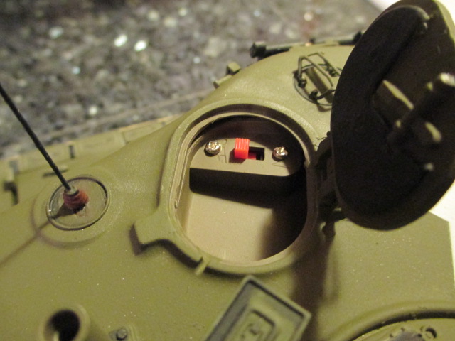

- New switch mounted in the repaired tray with Tamiya nuts and bolts
- New switch mounted in the repaired tray with Tamiya nuts and bolts.JPG (98.4 KiB) Viewed 2967 times

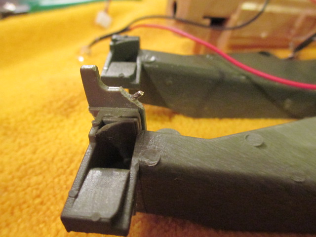

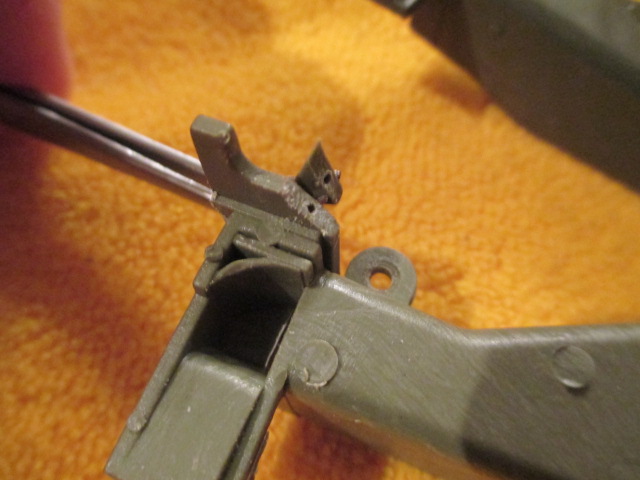

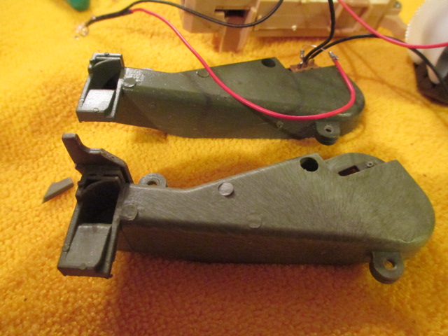

- Pinned. The repair worked but left some minor play in one side of the air gun mount. A new ammo feed tray will be needed for a permanent repair.
- Pinned. The repair worked but left some minor play in one side of the air gun mount. A new ammo feed tray will be needed for a permanent repair..JPG (92.76 KiB) Viewed 2967 times
- Broken trunnion mount tab drilled for a pin
- Broken trunnion mount tab drilled for a pin.JPG (92.23 KiB) Viewed 2967 times
Re: 1950 Marine Pershing M26 B-12 at Inchon Part A and B
Now make sure you wash your hands after feeding the boys...just to be sure there isn't any kibble scent on that barrel
