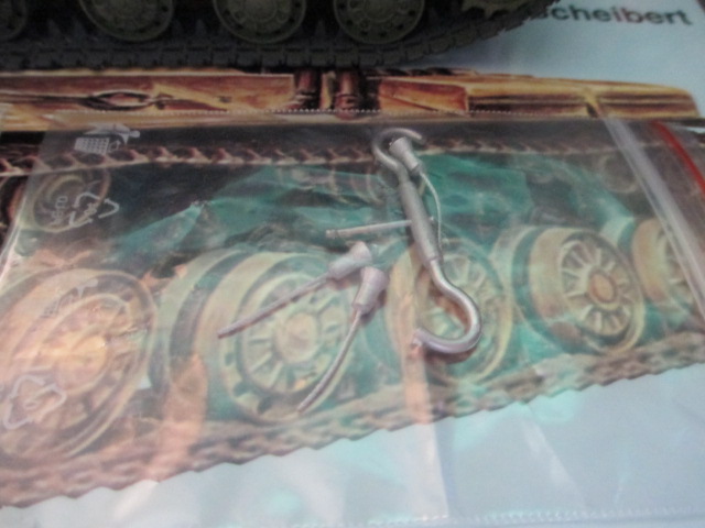

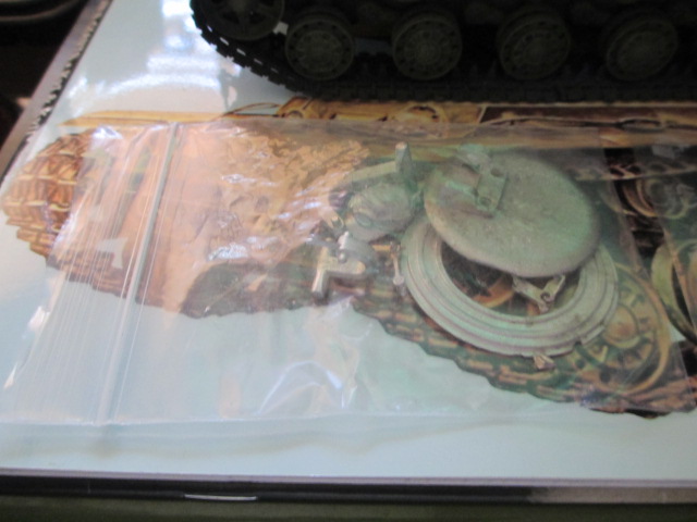

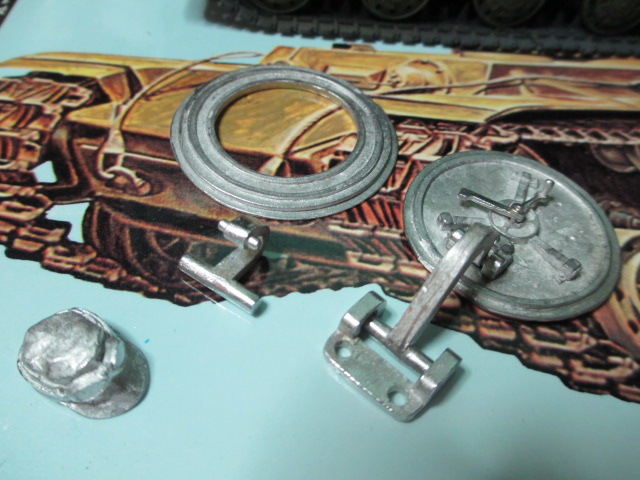

Alpha, thanks, I think that they turned out Ok. I have good hands days and bad hands days and that kinda dictates how much gets done and which step I turn to for reasonable progress. Tonight, I cleaned up the Driver's hatch parts from An-Bri-Rc-Modellbau. They needed a good bit of cleanup for fitment but turned out great. Can't be beat for the price and the detail is better than the Mato or Taigen sets. Pics:
Cleaned up parts included the external - internal Hatch Lock and a Driver's cap as well as an extra short hinge
3 Pistol Port Plugs and one Tow Cable Mount
3 Pistol Port Plugs and one Tow Cable Mount.JPG (93.68 KiB) Viewed 3666 times
Driver's Hatch parts
Driver's Hatch parts.JPG (89.94 KiB) Viewed 3666 times
Deutsch Post
Deutsch Post
Deutsch Post.JPG (95.26 KiB) Viewed 3666 times

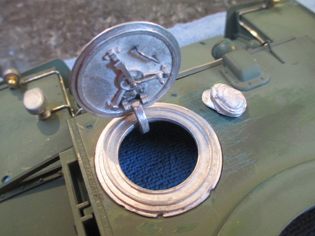

Alpha, There is a clean drill out on the underside for the Driver's hatch opening. I will need to melt and sand the opening from underneath to keep the dimensions correct. Above, I will use a Dremel and a router bit and carve away the rest of the plastic hatch and inset the existing hatch ring 1/16 to allow the metal one to sit flush. I will use a plastic disc, inset and glued into place, then to have a spot where a half-figure Driver can sit. ;o)

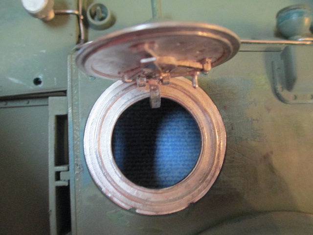

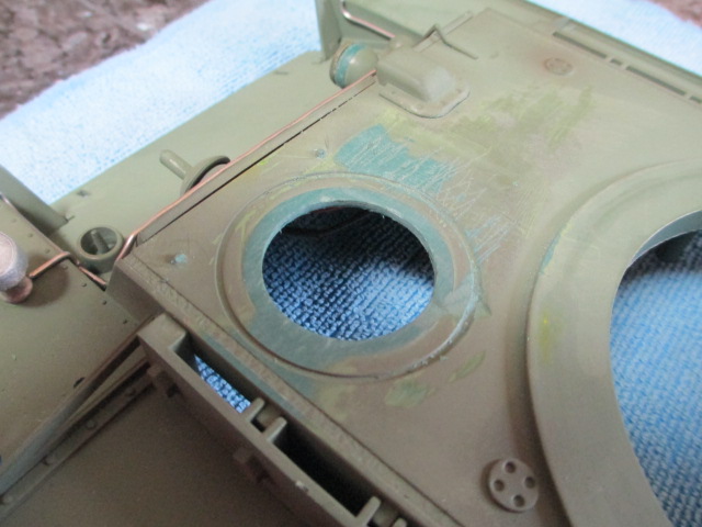

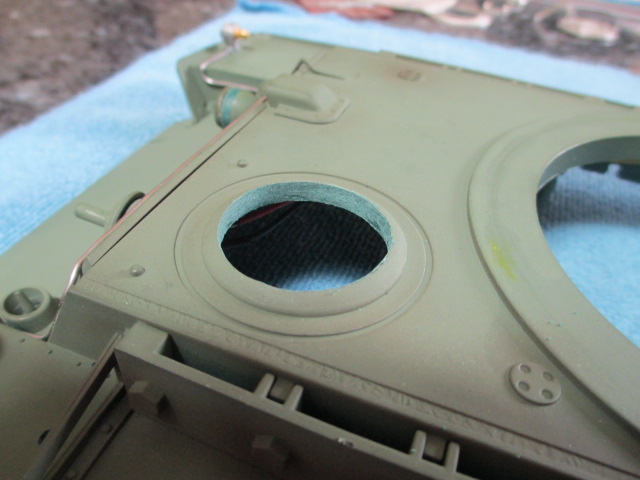

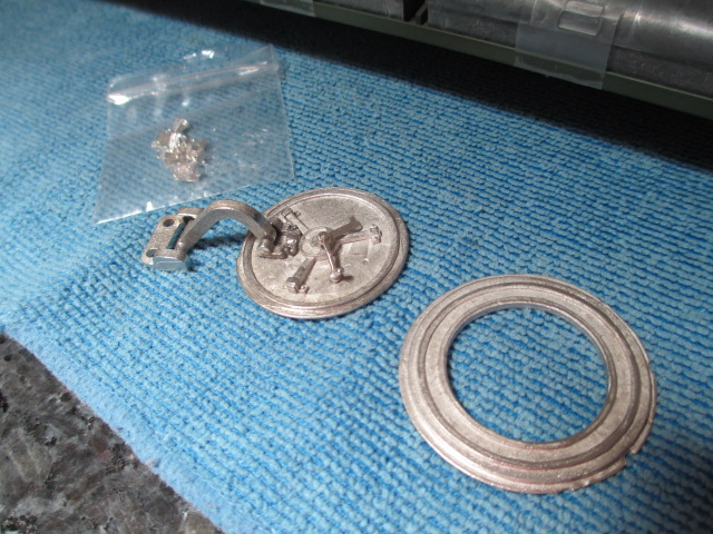

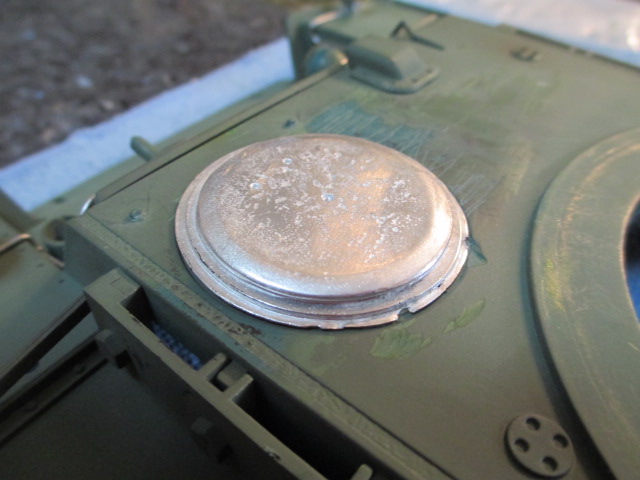

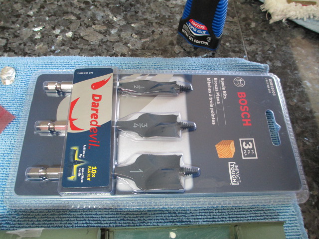

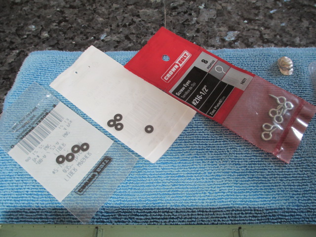

After a couple of days away to prep for and have some folks over for the 4th, I was able to get back to the KV-2 today. In the interim, some miniature eyelets had arrived care of Alpha for the lifting eyes on the rear deck. Giving them the once over, they seemed a little dainty but as it turned out, were perfect for the two spots where the turret overhang is located. They also functioned well for the eyelets on the rear engine hatch. I bought a set of hole saws for the hatch and using the already centered hole in the top of that, drilled it out using the 1"bit. A bit of dremel and flat file work removed the left over ring of plastic on top. I'm getting wordy so pictures can say the rest:
Hatch with interior grab handle added
Ring and hatch mounted with interior locking handle in place
Ring and hatch mounted with interior locking handle in place.JPG (96.29 KiB) Viewed 3638 times
Sanded smooth and the metal hatch and ring checked for fitment.
Sanded smooth and the metal hatch and ring checked for fitment..JPG (93.9 KiB) Viewed 3638 times
Remnant of the hatch roughly removed with a dremel and flat file.
Remnant of the hatch roughly removed with a dremel and flat file..JPG (97.36 KiB) Viewed 3638 times
Clearance underneath with the preformed shaft opened up.
Clearance underneath with the preformed shaft opened up..JPG (92.48 KiB) Viewed 3638 times
Driver's hatch drilled out with the 1 inch bit
Driver's hatch drilled out with the 1 inch bit..JPG (86.81 KiB) Viewed 3638 times

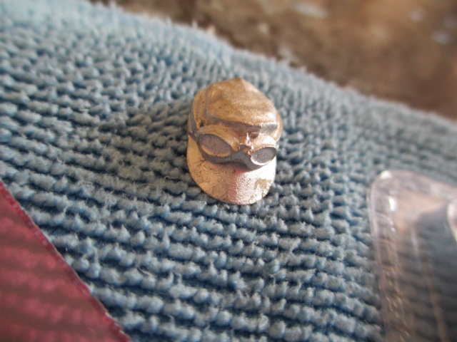

Again the hat and goggles
Eight .38 eye hooks and .25 fiber washers to make up the beefy lifting eyes on the KV-2's rear deck
A set of hole bits made for wood and plastic
Alpha's silver eyelets and the hatch and ring for today's work
