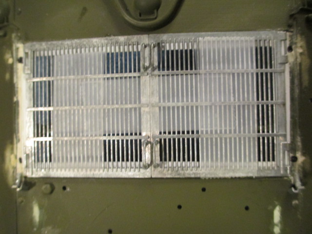

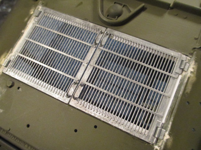

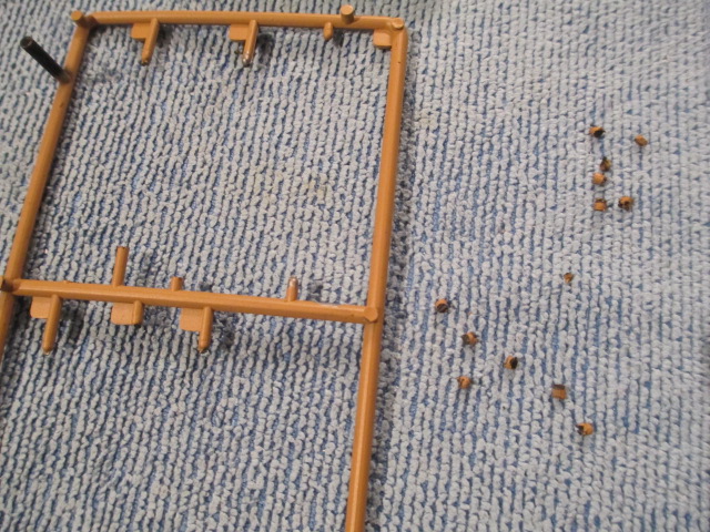

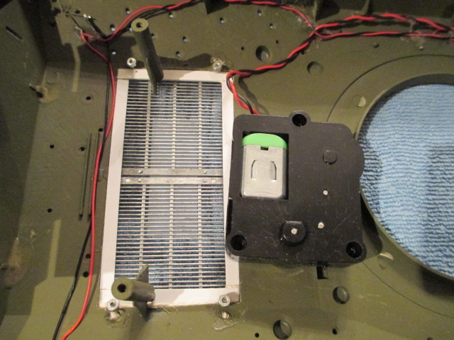

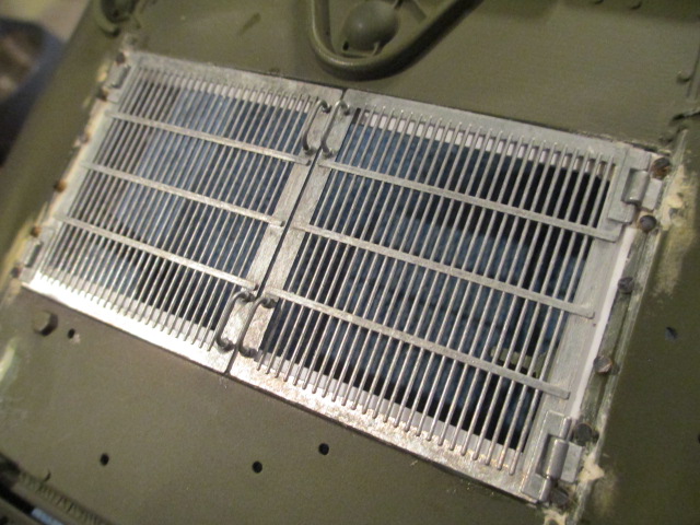

14th Day: Received one of the last shipments of parts, a nice pack of Schumo turret detail parts and a Tamiya lens for the spotlight and some scale stowage rope. Axel very nicely sent along some Christmas candy as well ;o) Tonight's work was a rehang of the rear deck engine bay doors including adding the bolts that frame them along the sides. Pictures:
An even dozen bolt heads installed
Sprue for cutting bolt heads out of
Drilling complete and hinges are remounted.  Much better results!
Holes marked for redrilling

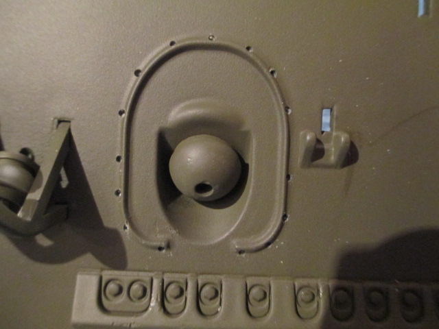

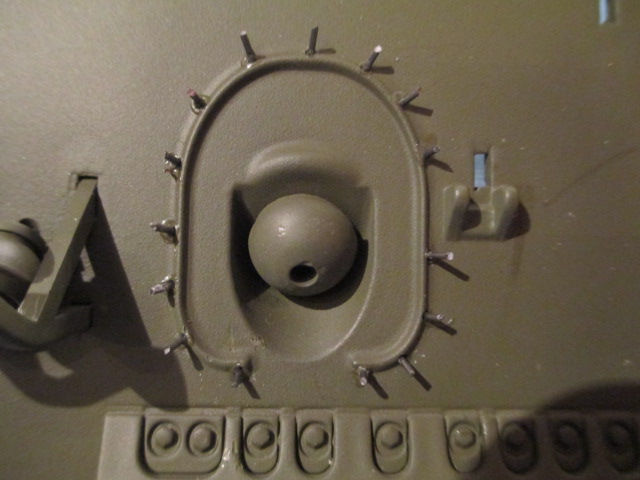

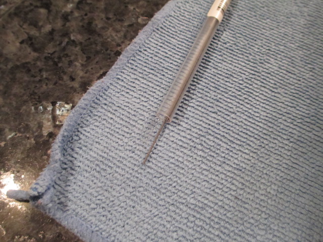

15th Day: I put the turret rotation gearbox back in place with two mounts. It seems solid and should work as intended. Then, I took a page from Phil's Sherman build and drilled the holes and installed the wire 'pegs' where a stowage cover for the hull MG would go. Pictures:
I used Phil's method of gluing a longer wire in place then clipping the wire once the glue had set
I used Phil's method of gluing a longer wire in place then clipping the wire once the glue had set.JPG (88.38 KiB) Viewed 2114 times
Antenna  wire was a perfect fit
Holes drilled in the MG ring using a #61 drill bit and yankee drill
Holes drilled in the MG ring using a #61 drill bit and yankee drill.JPG (86.46 KiB) Viewed 2114 times
Two point mount for the turret rotation gearbox   It can be easily seen why the third mount point was removed
