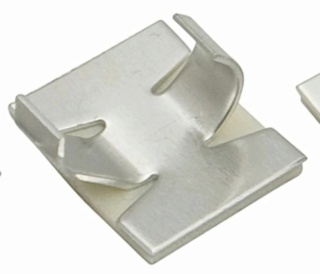

Routing for cleanliness of install, cable ties abound (I found some really nice 1.8mm wide x 60mm long micro zip-ties on Ebay..)
I also see a bunch of tape holding wires in place (Servo Recoil), and wonder if you have access to these?
12.5mm wide, 3M adhesive aluminum wire clip.

Posts: 6228
Re: M1A1HA, 3/10 Update, ElMod Turret Electrical Installatio
Jarlath,
Where can I get some of these? Although I don't do much changing out from stock electronics, I do like to "neatify" wiring to avoid potential snags.

Jarlath wrote:Ah Barry,
I see that you are a wiring neatness freak like myself...
Hi Jarlath, The tape is just temporary for testing, it will get properly secured.
