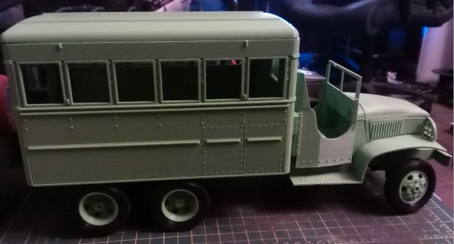

GMC shop truck.JPG (37.76 KiB) Viewed 2191 times
Got the axles and driveline assembled, I need to start thinking about the van's interior now.

That looks just great, Martin. I'll most definitely have to build one of those. Someday you might cease to amaze me, but I don't think it will be anytime soon. :haha:
