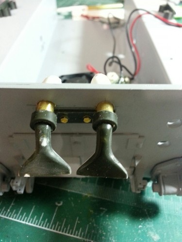

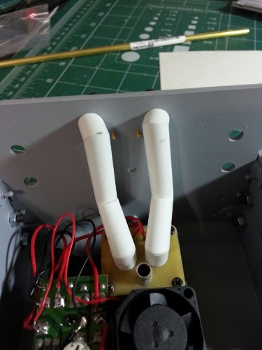

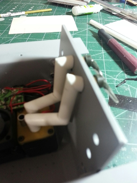

I had a bit of spare time today and finally got my smoker, manifolds and exhaust pipes made up. Here are the pictures. It clears the speaker assembly I made and is all is slip fit. If I need to do maintainence, It can be completely dissassembled. I used the Tamiya exhaust mount bracket and tapped the rear hull for 080 threads to hold the exhaust dumps to the hull. Here are the pictures.
-Dan

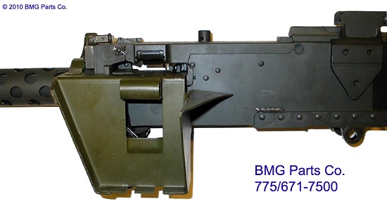

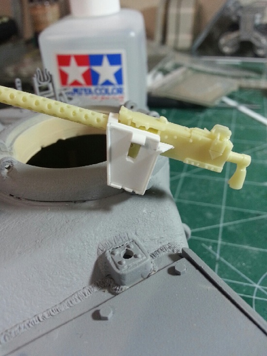

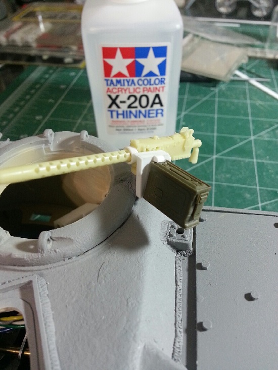

I have been recovering from heart surgery, so I haven't done much in the last couple weeks, however someone pointed out that Fireflys didn't use the M2 Browning .50. So I decided to make up an M1919 .30 Browning to make most of you happy, however Bovington and pictures tell a different story about the M2 .50.

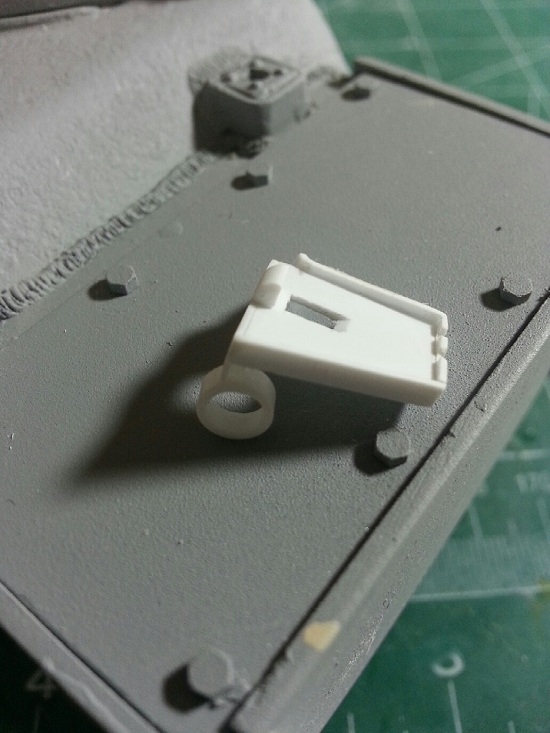

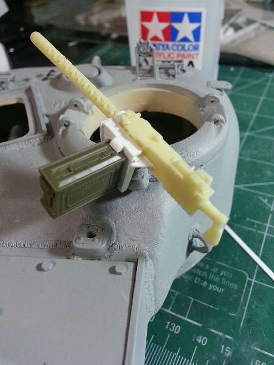

Here is the M1919 browning and the can mount I scratch built. The resin M1919 came with a tripod for ground usage, so I converted it to the armor style mount and built the ammo can bracket. Here is the project in the white. 8)
-Dan

M1919 Can mount original
M1919 ammo can mount.jpg (62.22 KiB) Viewed 4022 times

Eastern: The M1919 is a Verlindin kit, I used a small piece of .028 brass rod to mount it to the pintle so it could piviot. The other is .020 strip and sheet plastic and a small piece of quarter round. That simple.
-Dan

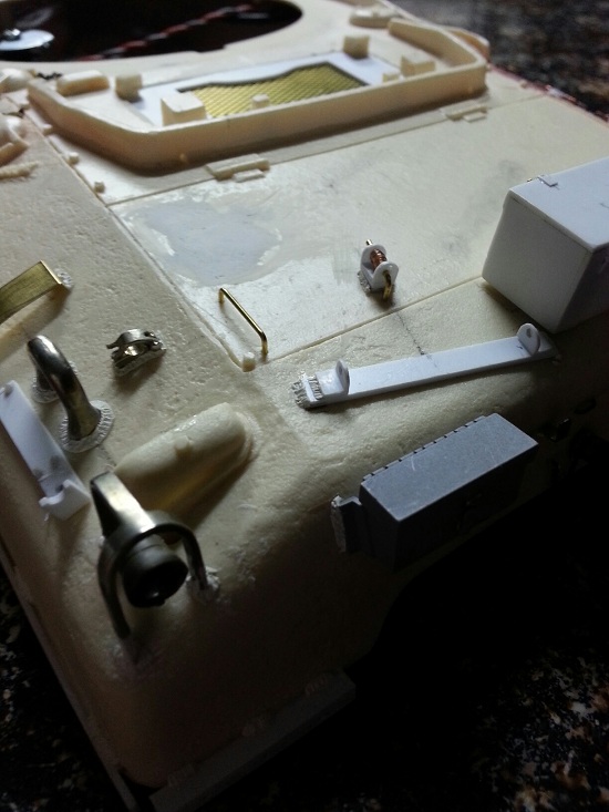

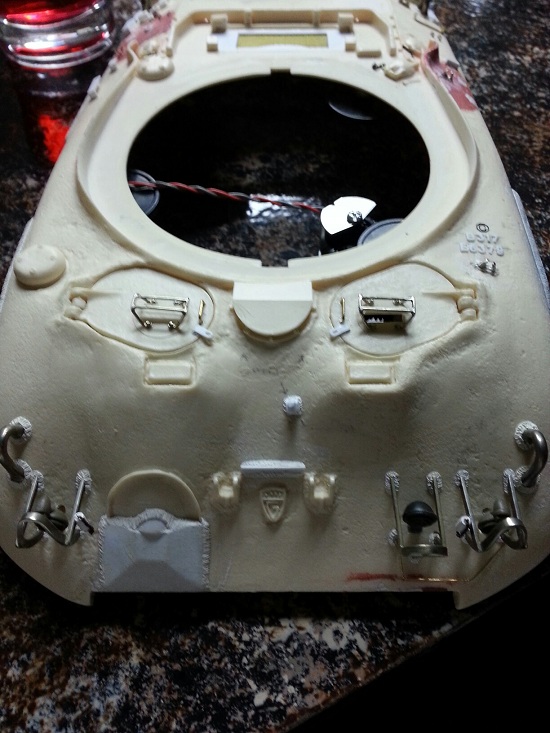

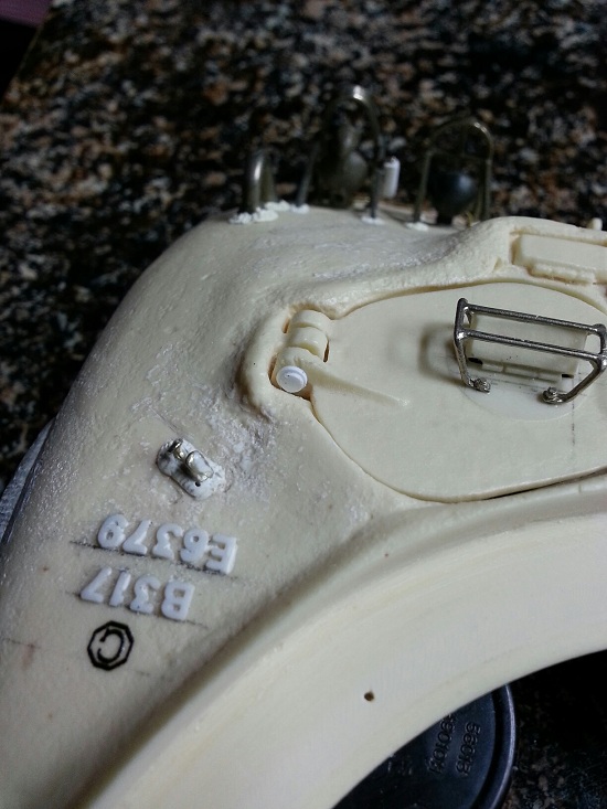

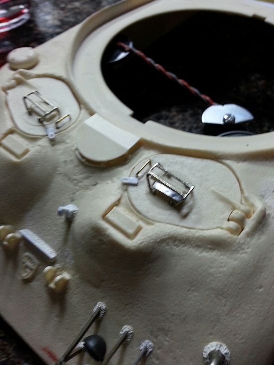

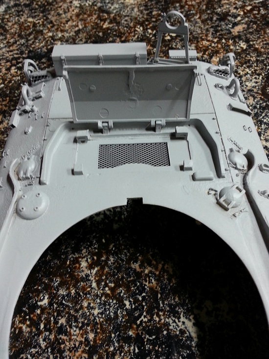

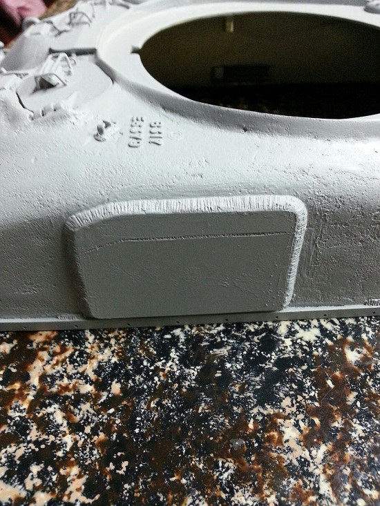

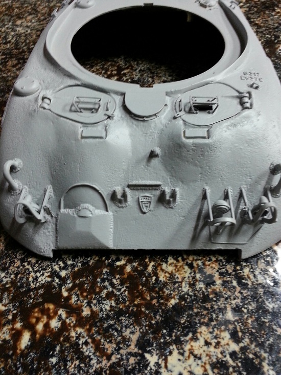

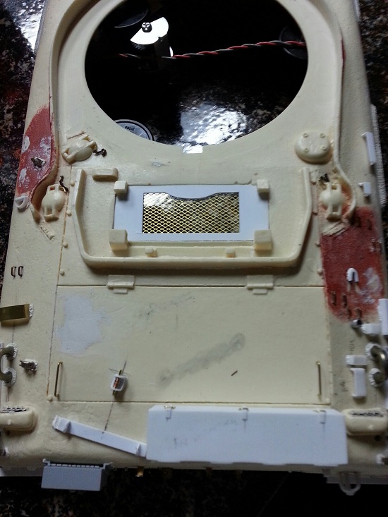

I finally completed the hull and all the small detail. Paint makes it hard to identify all the work done, so I took pictures in the buff and pictures in primer. I will post the 'nudes" first. The primered photos will follow. I really had a hard time getting the turret rotation worked out where it was reliable. I had to use brass tube on the centering wheel shafts in the resin turret and I bushed the wheels themselves. I made about 20 full rotations both directions and it ran well. You also have to relieve the the turret splash sheild as well. If you don't do it where it clears, you'll ruin your paint after it's complete. Anyway, here you are. :D
-Dan

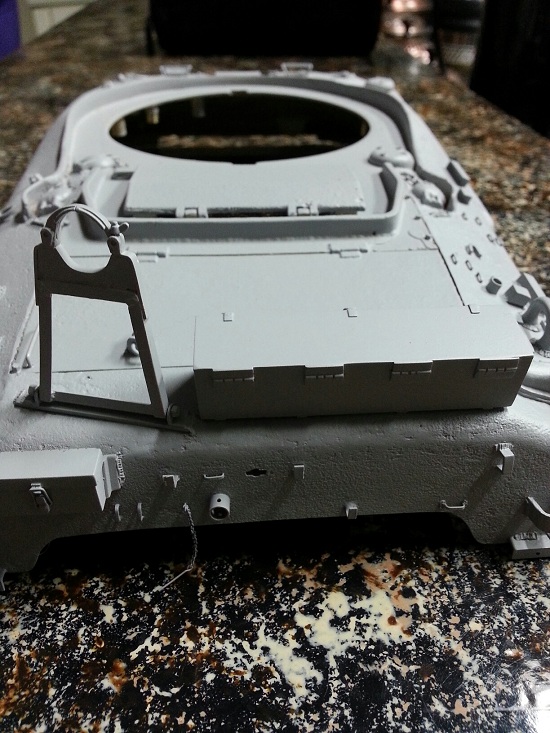

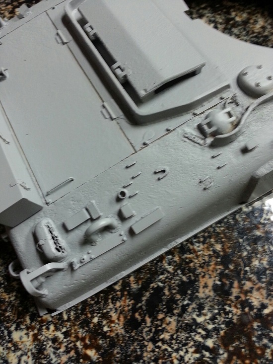

Here is the completed hull in primer. Everytime I thought I was done I'd find something I missed. :haha:
-Dan

Thank you for posting your most-recent pictures. I especially liked the pre-primered ones, as it makes it easy to see all the hard work you've put into the details. I think that my favorite detail is the welded plug for the hull machine gun. But then again, I like the gun crutch, and the cast-in numbers & symbols on the hull, too. Oh heck, it ALL looks great!
