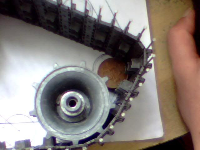

Is that a full set of 16? I think I'll need 32 to realise the dream so if you can let me have one set I could try to get hold of the other ones off ebay? I'm going to see if I can find someone to make me an extra 4 drive wheels as I think there's a lot to be said for your snowmobile track system

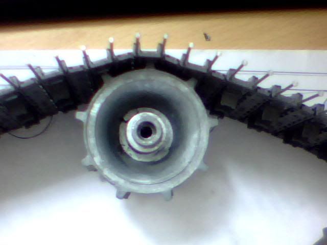

I just rigged it up with a few piles of coppers to mimic the front and rear rollers and it looks good (and means the track is long enough!) There wouldn't be too many teeth in contact with the track which is a little concerning though, maybe nine at a time? Is that going to be ok do we reckon?
Anyway here is what it looks like in the flesh.

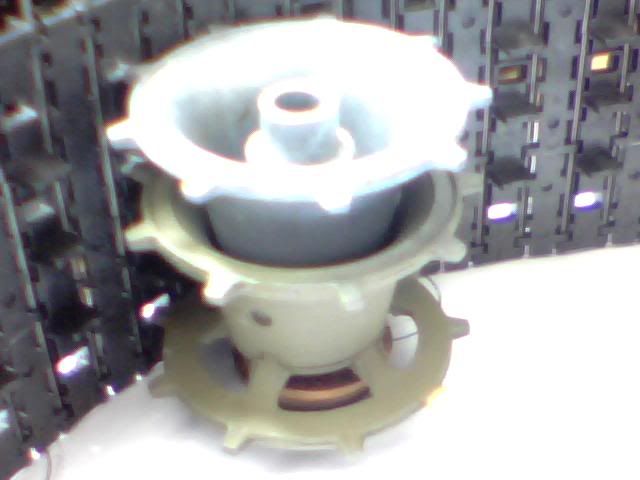

Here's how the drive wheel would sit at the top.

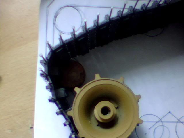

And here's my issue with where I want the track to run.
This last one is so I can try and find someone willing and able to make me 4 more similar pieces! Of course it'll never be seen so needs to be purely functional so I'll update if I progress with that...

- I see what you mean about the sprocket tooth engagement .
at the top of your sketch there are four return rollers , one or both , positions closest to the centre can be used to tension the track and hold it onto the sprocket at the same time ( one could be permantly fixed ) the other pressing onto the track from the top .

As for the triple sprocket at the top, I could conceivably use a double one and I actually managed to use a small piece of plastic tubing and 2 of the 8 spare sprocket faces (meaning I have enough to do this four times) to make a very adequate drive gear for use at the top. I placed the 2 pieces back to back and just placed a tube between them, cut it to the right length so that it was driving the two outer edges of the track with the centre unpowered.
As for tensioning, I'm not sure how it would work to push on the track from the outside as I've actually had this thought myself. The problem I forsee with it is the surface of the track itself. You can see from earlier images that it's peaks and troughs, like a ploughed field, so I wouldv'e thought trying to run a wheel over that would be rather difficult. I can imagine it having large fluctuations constantly and also creating some additional friction that we really don't want...
Thankfully I measured the wheels off my Tiger before I placed a bid on any and they are WAY too big! I need something that's more like 30mm but honestly I'm starting to think I could just make them myself... Don't forget I need to have these contraptions at the front and rear of the track to ensure it follows the path I want it to so they need adding to your very neat image above
Still no grill but I now know there was a holdup with postage so I'm hoping to see it when the posties go back to work on monday! As a parting thought, how about moving the drive wheel either forward or backwards so rather than forming the top of an isosceles triangle it forms the top of something closer to a right-angle triangle. This would see a lot more track in contact with it and also allow plenty of space for an internal tensioner if necessary.
