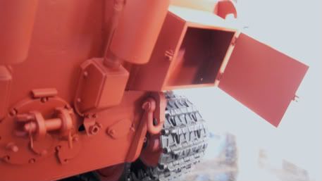

Hi all....small update, got the rear stowage bin from wecohe ....for the infra red
Best bit of soldering I have done in years....ahem...dont look to close! :D

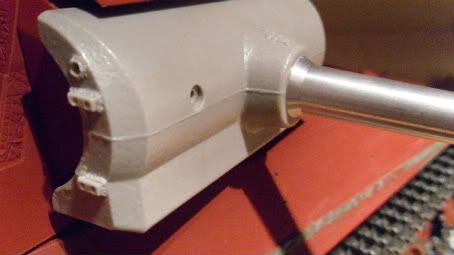

Just to say that i went and got the schumo barrel and late gun mantlet...yes I know they are for the tamiya...well, I made them fit!...photos tomorrow. Still a bit of fiddling to do, but it works.

Right, here we go....taken two days to sort these photos out...computer keeps telling me low on virtual memory, and its slow!...anyway
over all pic with temp fit
Here you can see whats left of the heng long barrel with a steel bit inserted into the schumo barrel
The two pieces together..have yet to Final fix
Here you can just make out the cut out on the top for the barrel in full incline...in the hole you can make out the small piece of heng long barrel
Another look at the temp fit
Nic

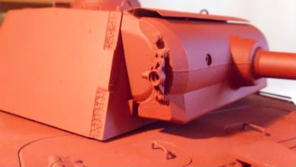

Hi again...here you can see how I fixed the mantlet to the heng long turret...first I cut off the two mantlet fixing screw holders as close to the heng long mantlet, screwed them back to the holder, wacked a load of two part glue over the ends and held the new mantlet against the fixing screws until the glue went off(5 mins quick set stuff)...left it for an hour and hey presto still using the heng long fixtures...what you can also just make out is the grinding done to remove the schumo screw holders...(these interfere with the heng long mantlet holder
Re fitted the bits from the heng long mantlet and job done....(plus mantlet stops)

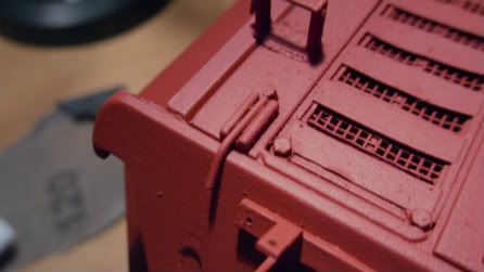

I added the fuel over fill?/air breather? thingy...on the right hand side, cut out the middle bit, used the obligatory paper clip for the pipe, and a small cut off plastic round thing section from the loaders plastic handle(I replaced all my handles with a metal set) :D ...does the job!
Tomorrow I hope to finish the schurtzen on this side to...I have been lazy, the other side has been done for months
