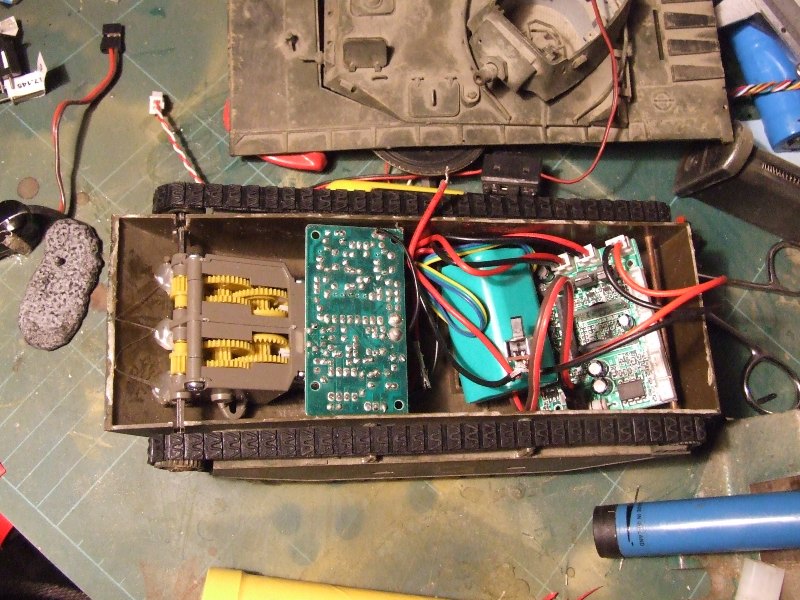

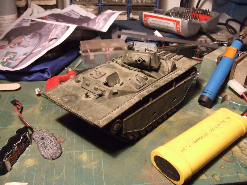

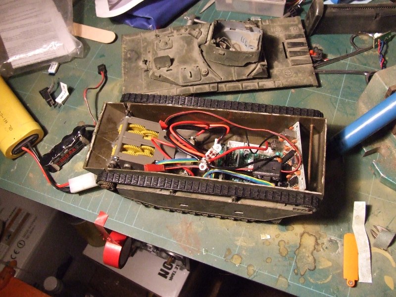

DIgging through my stuff and I found the source of my obsession with LVT's. An old Nitto kit I built when I was about 14 years old (only 30 years ago !!). Well I had this idea around that time of how wonderful it would be if 1/35th models could be radio controlled......few years on and the LVT (A)1 of this thread came about. Found a few spare bits and saw a video on youtube of a chap who made the Nitto kit RC so, well I had a pop...... this is the original 30 year old model with new tracks on it. Serving as a prototype for an unbuilt kit I have of the same. IT ONLY BLOODY WORKS and of course it floats
Tamiya Twin Gear box kit (very usefull bit of gear that) Heng Long RC gear, and a 4.8 NIMH, Rx battery which works pretty well.
what do you think !

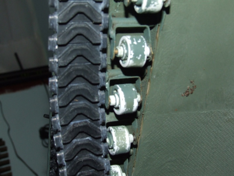

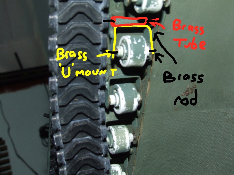

Andy I tried to get some piccies of the suspension but they are not to clear so Ive tried to colour code them.
Basically the Brass plates mounted on the hull have a series of L shaped brass strips soldered to them to form a "U" shape. Each wheel has a slightly narrower Brass "U" cradle to hold it. This cradle has a Brass tube soldered to the top of it. The whole Wheel/Tube arrangement is then anchored to the Hull mount with a Brass rod through the L shaped bracket, through the tube and into the Hull. It was beyond me to make a suitable sprung suspension like Herman's as he did such a great job of his. So having tried I simply fixed the whole assemble in place again with solder. It works but in retrospect I think the brass isnt thick enough gauge and isnt resiliant to rough terrain and some of it is now deforming. Im thinking about doing an LVT 4 Buffalo but will work out a better suspension before I do it. Hope this helps mate

Hi Nick thats excelent mate thanks I will probbaly go the same route as you.

Hello Nick! actually my suspension is not that much different from yours. I made the springs and soldered small spring holders on the U shaped wheel holders to keep them in place. Tracks have to be fairly tight, though they do work great in the water. In dirt/sand I have to be a bit more understanding when turning. On hard surfaces I can make it slide in a power turn!
