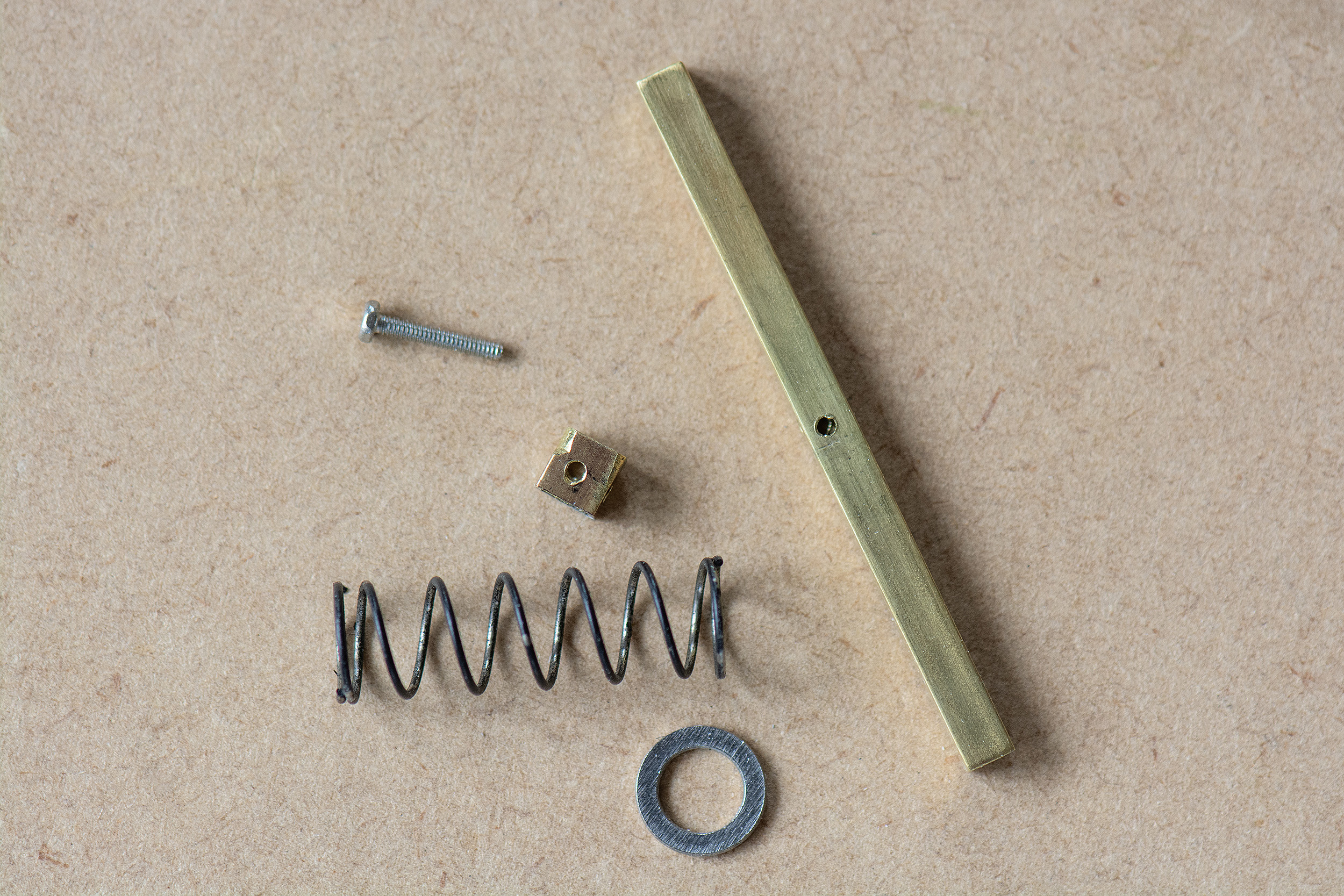

It is really simple, and you don't need any special tools to make it :D
Suspension disassembled.
DSC_1714 copy 2.jpg (1.47 MiB) Viewed 818 times

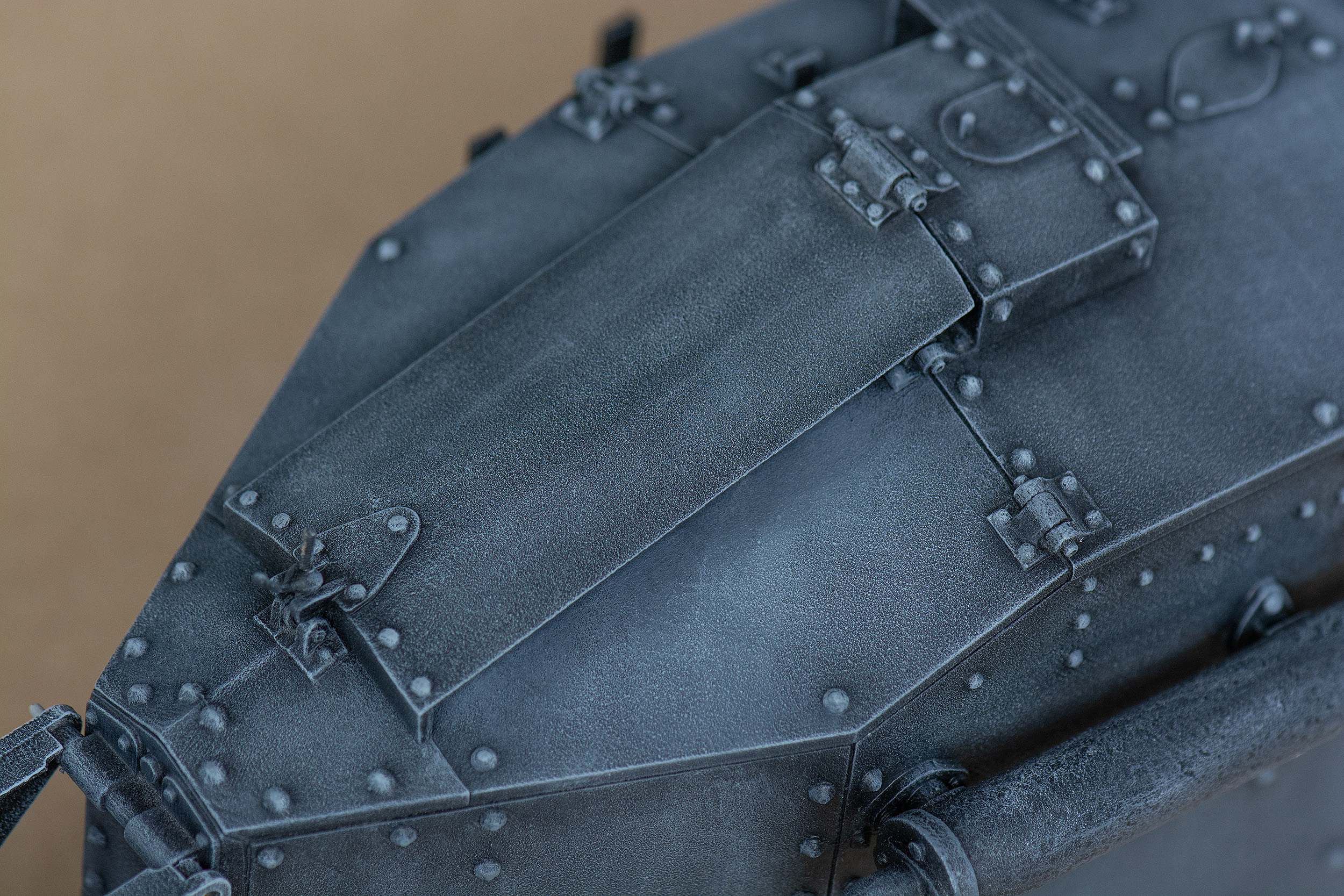

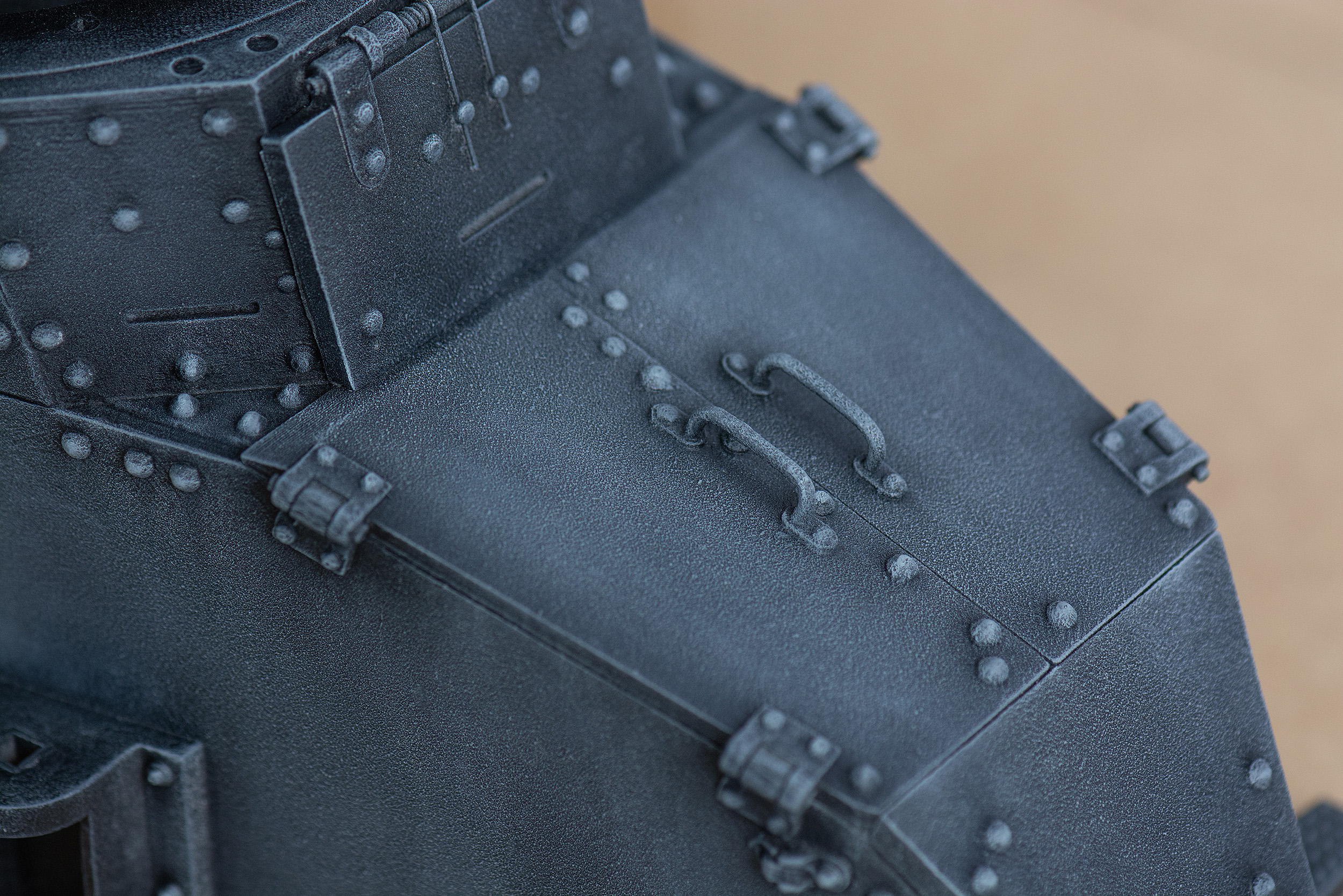

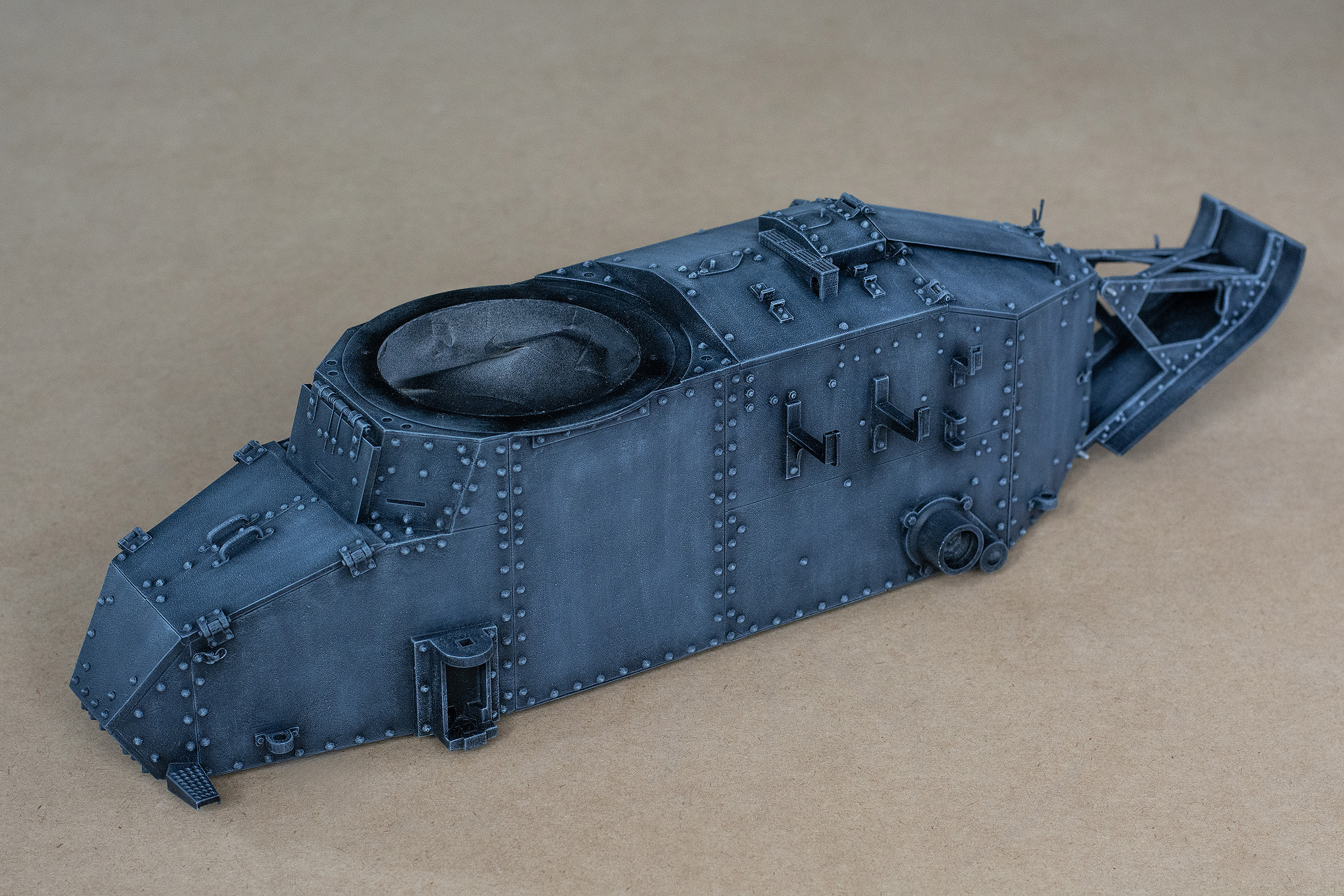

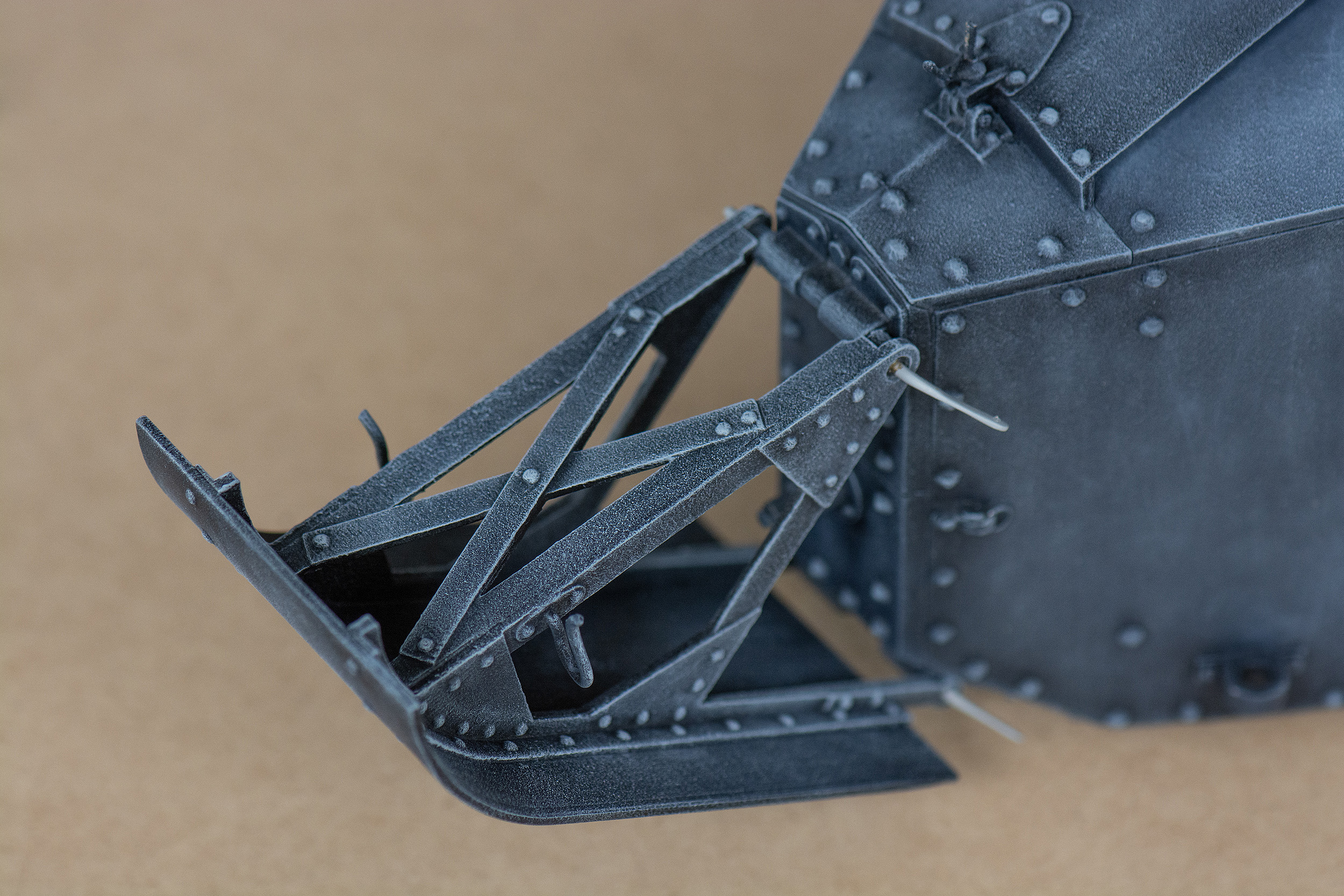

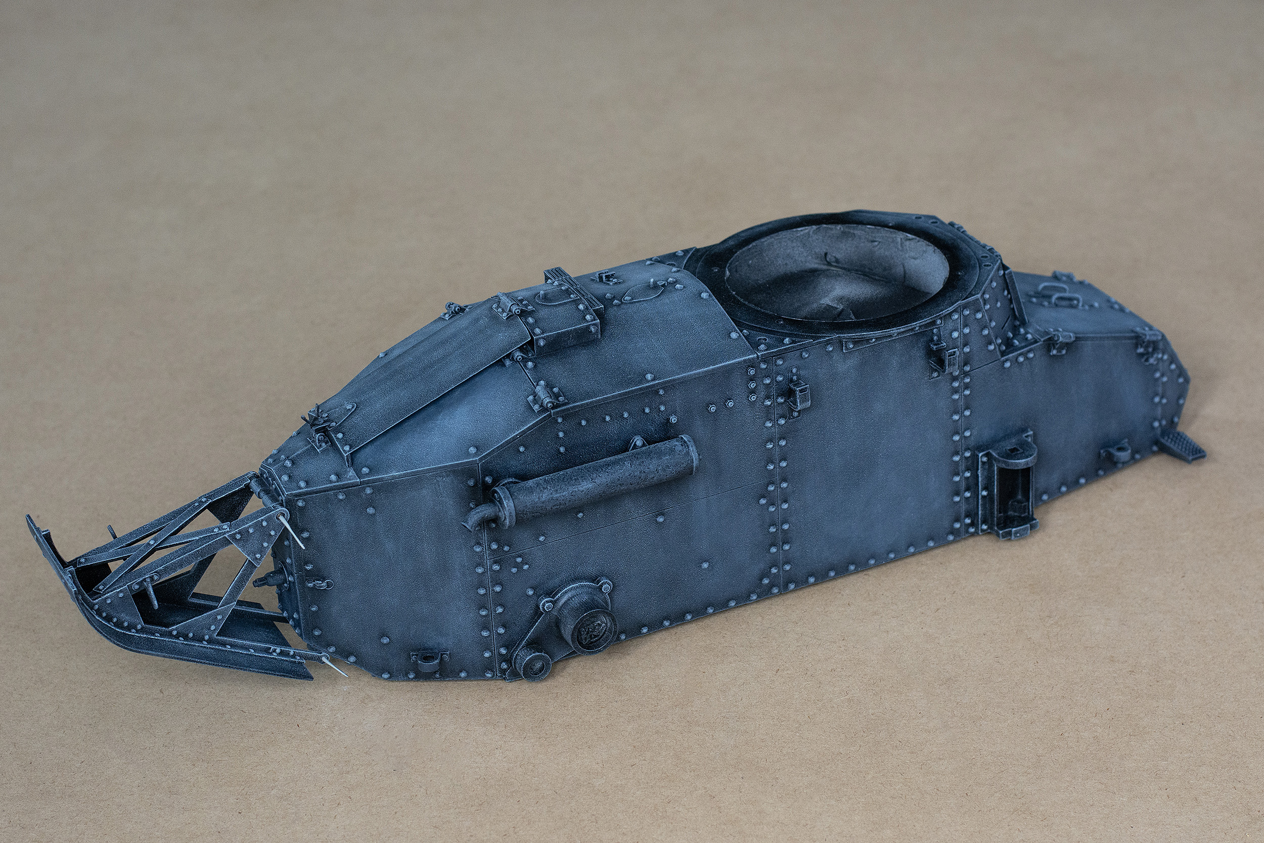

Some progress over last few days on the hull.
First, I finished adding all the small details I wanted.
Then, the model was primed with automotive primer-filler, a can of which I somehow stuffed up, and it stopped working.
So, I switched to Mr. Hobby's Mr Surfacer 500 primer and airbrushed it.
After the last round of sanding, the model was coated with black primer, and preshading was dry-brushed.
DSC_1718 copy 2.jpg (1.73 MiB) Viewed 815 times
DSC_1716 copy 2.jpg (1.7 MiB) Viewed 815 times
Art Hogus
Posts: 123
Joined: Sat Jul 15, 2017 7:25 am
Location: New Zealand
Re: Renault FT17 in 1/10 scale
Post by Art Hogus »

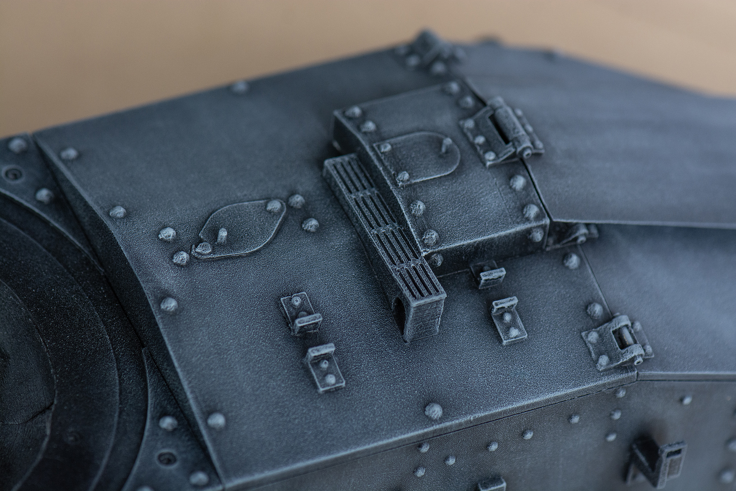

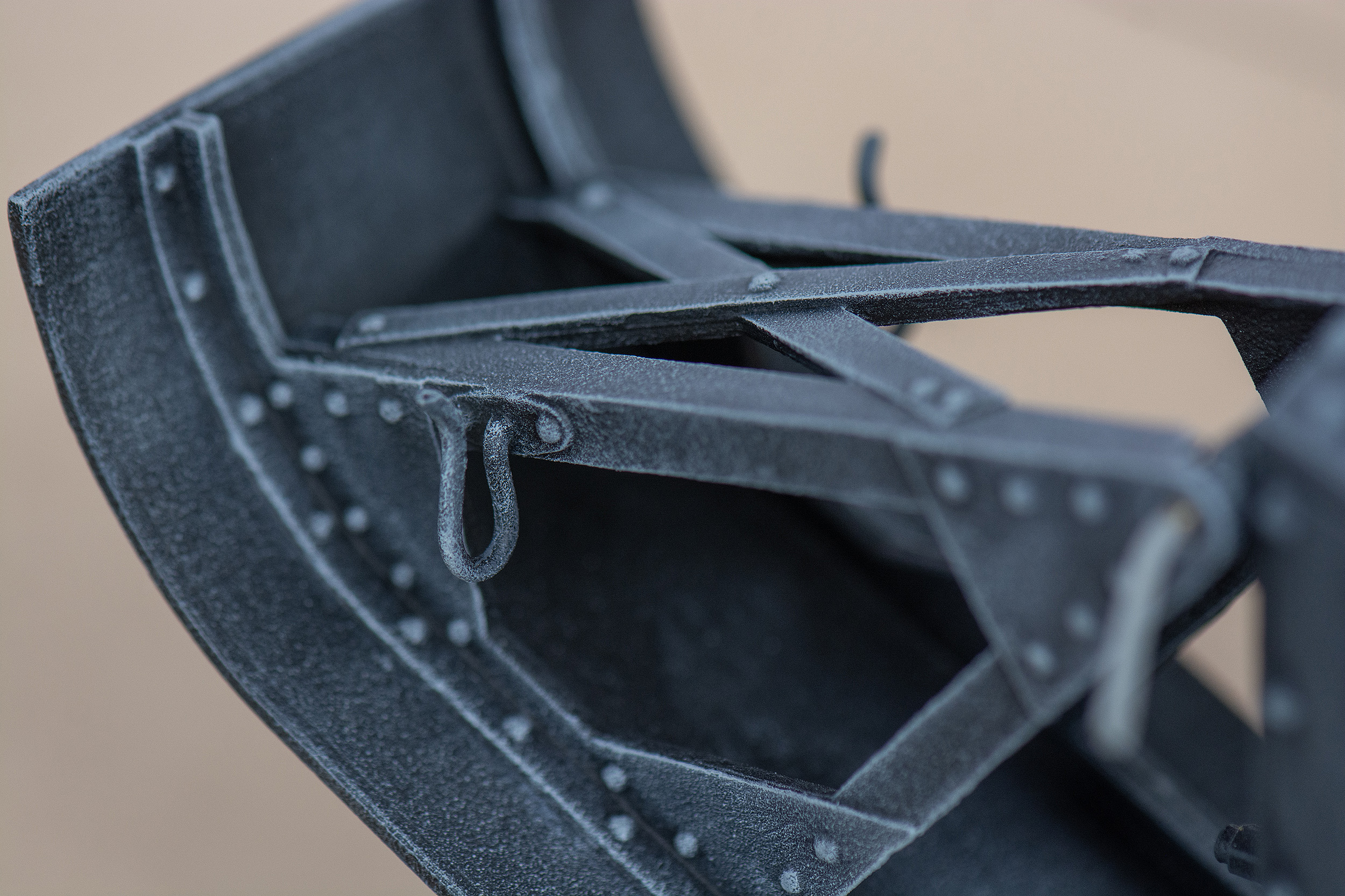

Dry-brushed preshading was the experiment, and I would say that on large models, it isn't worth the effort.
It doesn't work on multicolor camo and can be easily done as post-shading with an airbrush or drybrush.

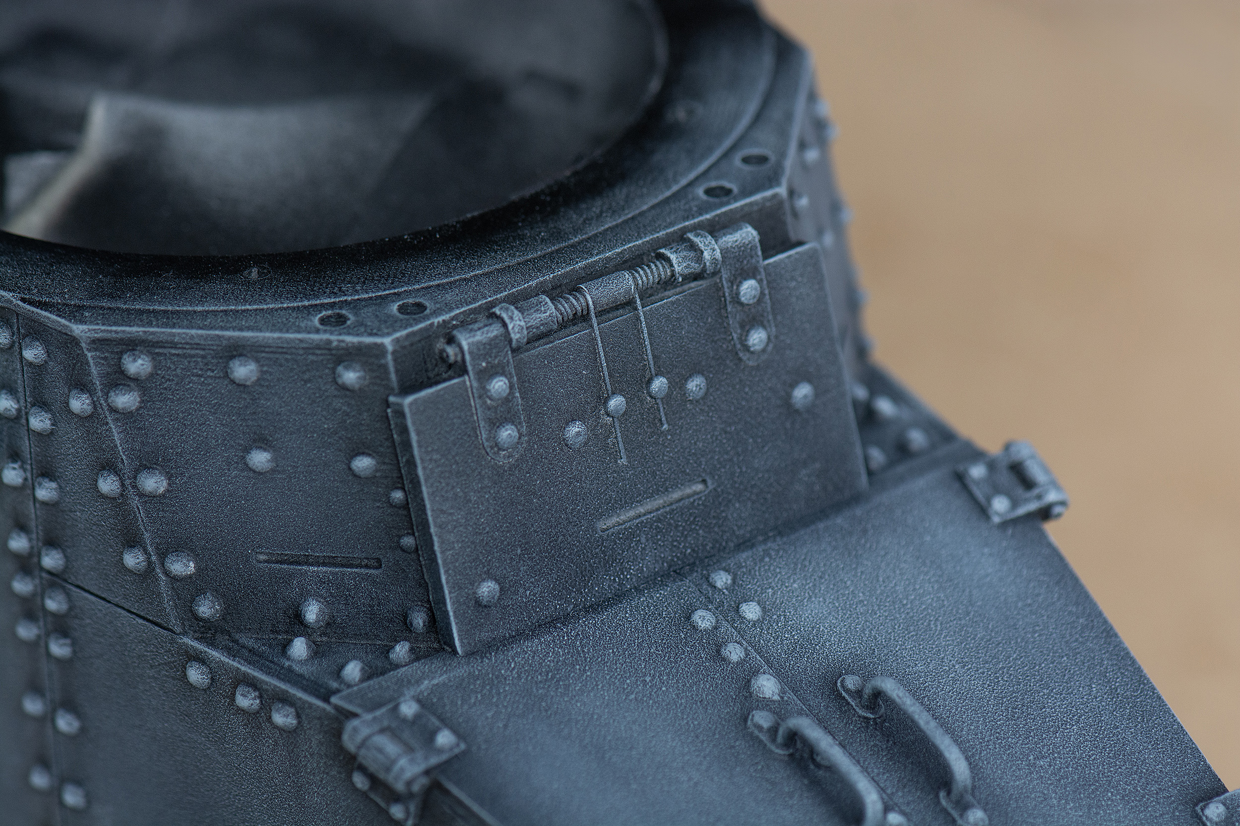

Some close-up details.
DSC_1702 copy 2.jpg (1.64 MiB) Viewed 814 times
DSC_1705 copy 2.jpg (1.58 MiB) Viewed 814 times
DSC_1706 copy 2.jpg (1.58 MiB) Viewed 814 times
DSC_1707 copy 2.jpg (1.83 MiB) Viewed 814 times
DSC_1708 copy 2.jpg (1.34 MiB) Viewed 814 times
DSC_1710 copy 2.jpg (1.19 MiB) Viewed 814 times

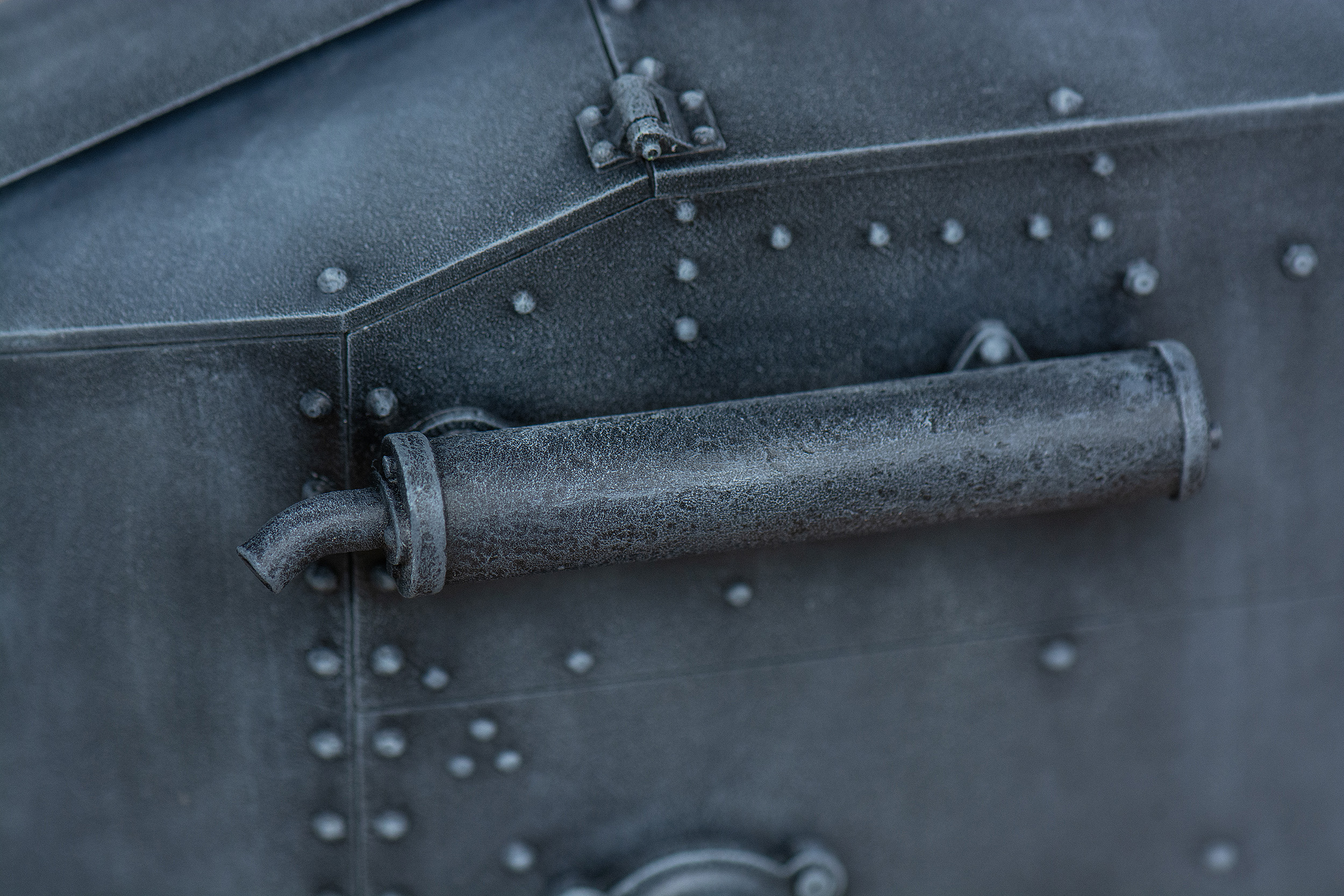

Herr Dr. Professor wrote: Thu Oct 23, 2025 4:14 pm "With a bit of ASB/PETG glue added, it is pretty good to create surface texture (with stabbing brush motion)." Thank you for the great tip!
Just an example of the texture I was trying to add to the exhaust pipe :) .
