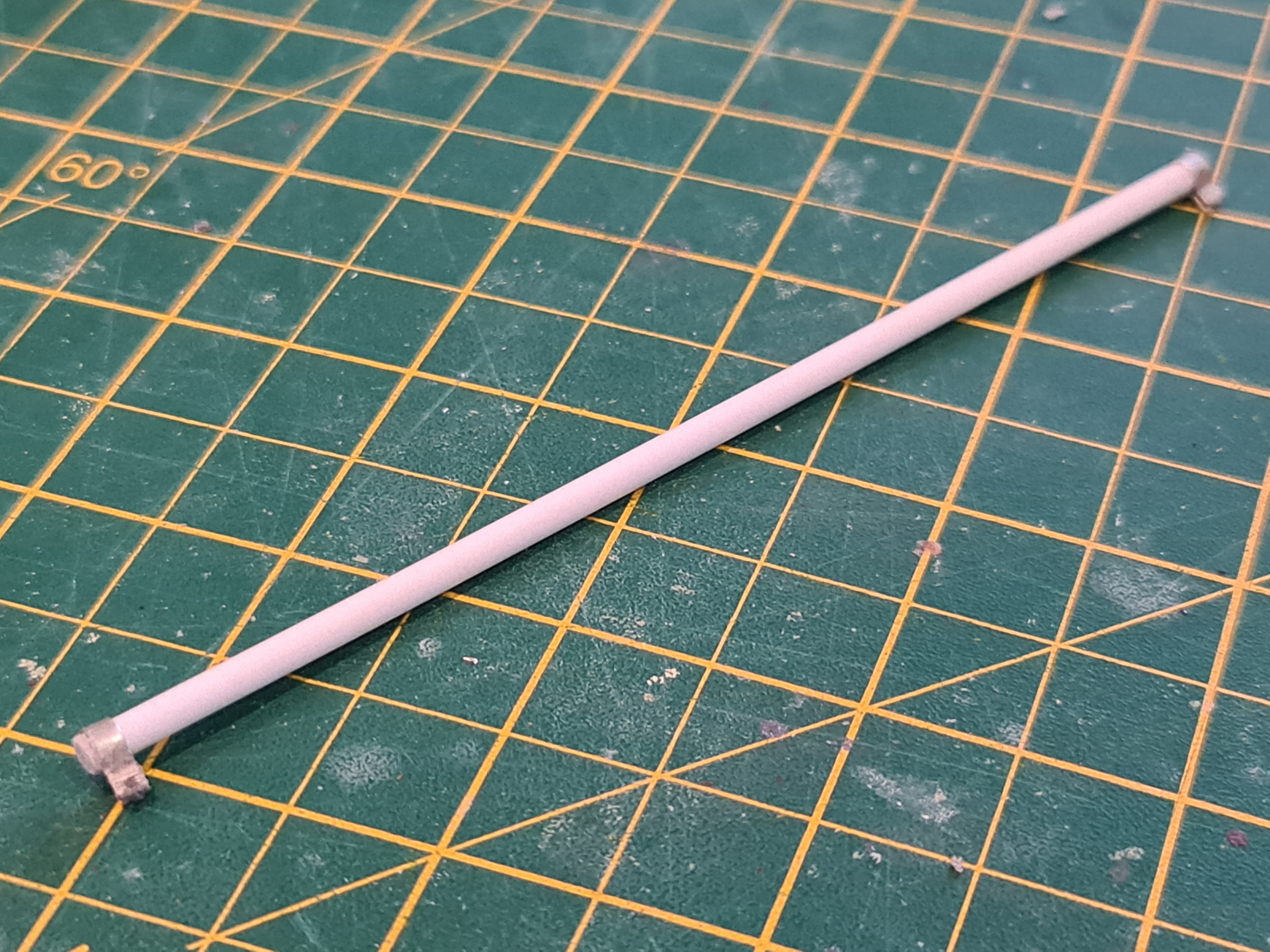

Managed to get a couple of hours in today despite feeling tired and listless due to a pub crawl yesterday. I've made a spare antenna tube out of a length of 1/8 plastic tube and spare photo-etched straps to mount it. I'm going to paint, camo and seal it off the tank to avoid overpainting the sealed model.

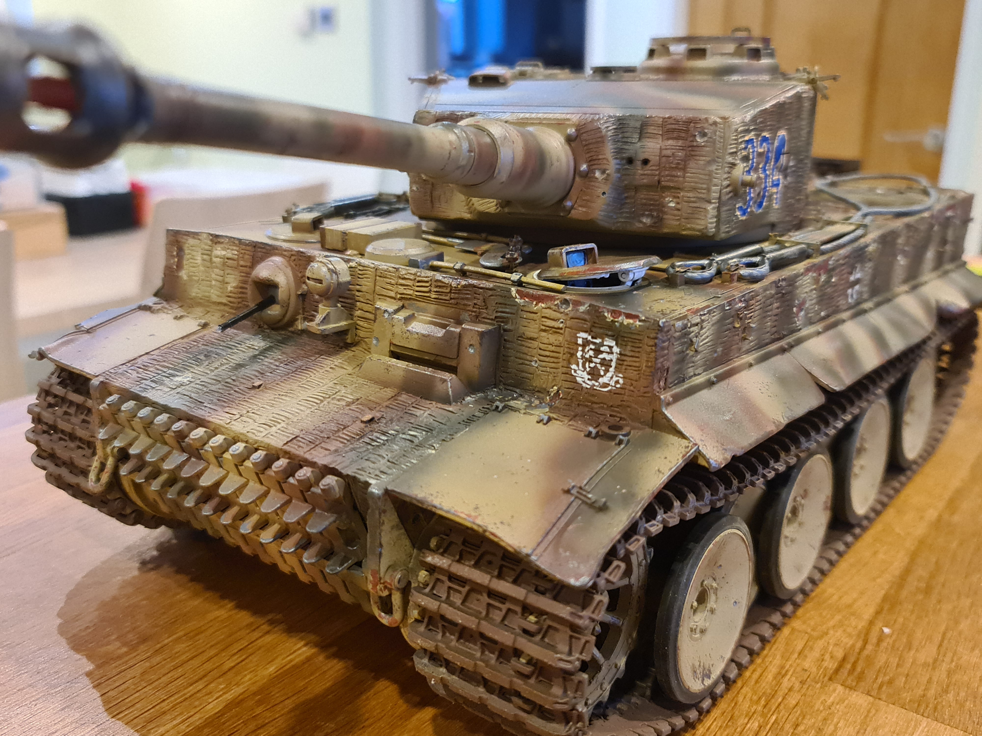

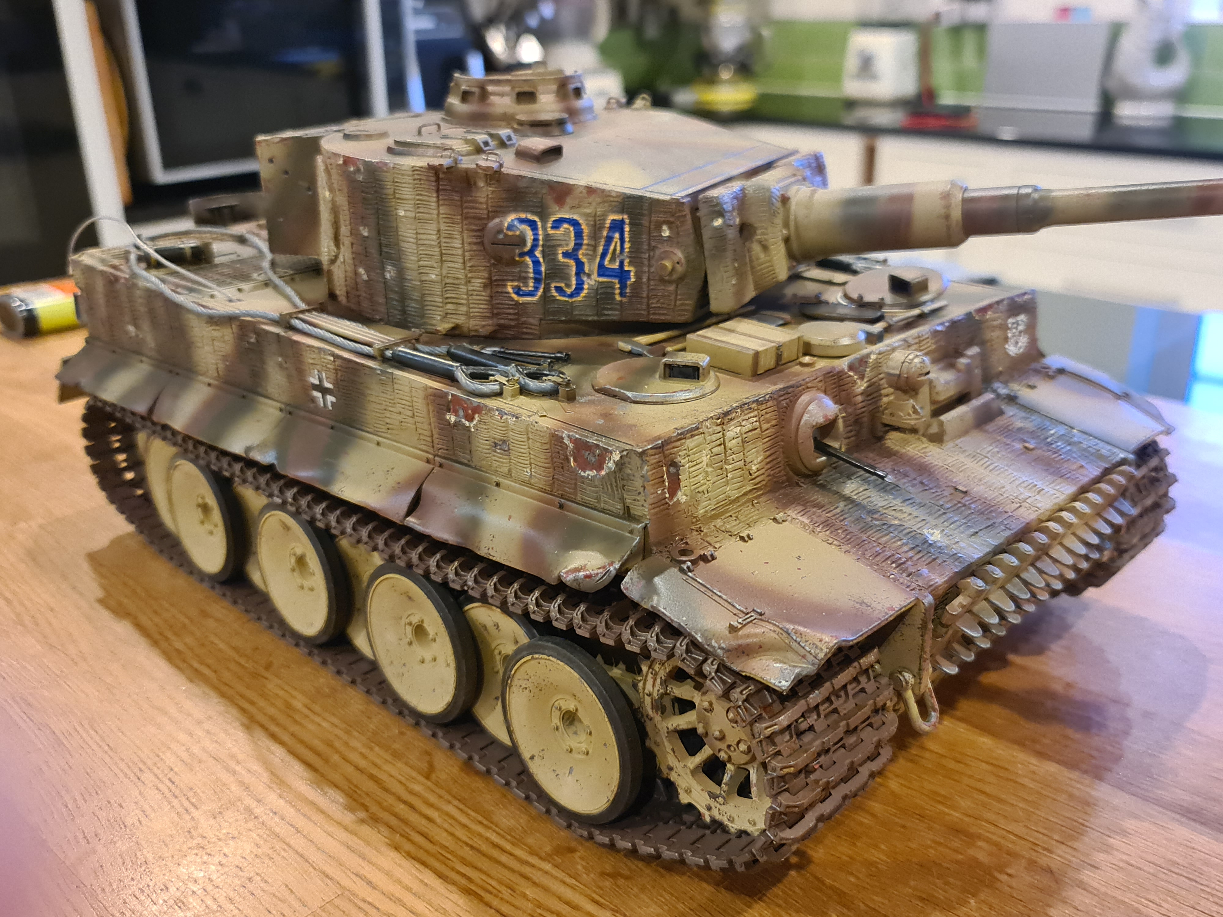

Batteries charged and I've now got most functions working properly, except the machine gun. I found the turret rotation was in the wrong channel, so I swapped it to the left as per the manual. I'm going to try reset the MF01 to see if I can get the M/G working.
I've also CA glued the turret rotation clutch gear, cleaned paint off contact parts and greased the gears. Bingo! We have turret rotation.
The spare antenna tube is painted and fitted, and the left side cable is primed and top coated with dark silver enamel. The end loops need painting and the whole thing weathering. I need some rust colours.
The stiffened deck has also been improved by adding magnets that stick to angled brackets inside.
I've got to figure out how to mount the antenna I bought from Germany. It has a rubber base that sits in the hole where the Tamiya antenna exits. Unfortunately the rubber bit is so short it wont stay on its own.. I want it removable for transport.

I know you have already thought of what I am about to say which is why my comments wont cause offence,
The Jack handle needs a clamp,
The starting handle needs locating on the base of the rear panel unless your Tiger 1 is a Mid and had the 2 piece starting handle which is fitted around the radio aerial,
Peddinghaus sell a decal sheet of Fire extinguisher Placards which lift the item,
I am so pleased that you addressed the spare aerial tube an item so often neglected BUT overall a brilliant interpretation of a Tiger 1,
IMPRESSED.
IMPRESSED.

The strap for the jack handle I can handle mocking up with left over PE. The bracket holders for the jack is whats got me stewing. I'm relatively basic when it comes to fabbing. I'm going to try some styrene but I definitely won't have wing nuts like that. I may just do a temporary mount and when I can find a substitute fix it the way Jimster did with his early Tiger project.jarndice wrote: ↑Tue Feb 06, 2024 7:02 pm I know you have already thought of what I am about to say which is why my comments wont cause offence,
IMPRESSED.![]()

Hi Jarndice, feedback always appreciated.
The jack handle has a clamp, I used spare p-e brass, it's quite hard to see now it's painted.
I've been ignoring the starter handle which being the 2 part mid one should mount on the deck. I have to figure out the materials to make one, then add it. That can be done later.
Mr Chef, the brackets for the jack with moulded wing nuts came from MK Modellbau. I used the original Tamiya clamps and glued on the end plate. It passed Jarndice's inspection!
I've also seen the decal sheet for the extinguisher but wasn't worth the postage for just 1 item. Iirc Forgebear sells them.
Due to an unfortunate collision while resetting the r/c my barrel elevation mechanism has a broken arm. In the instructions it's J1 black nylon arm that links the gearbox to the traverse arm. I've ordered a spare from Forgebear but Dave's away for 2 weeks so I have to live with a droopy gun
