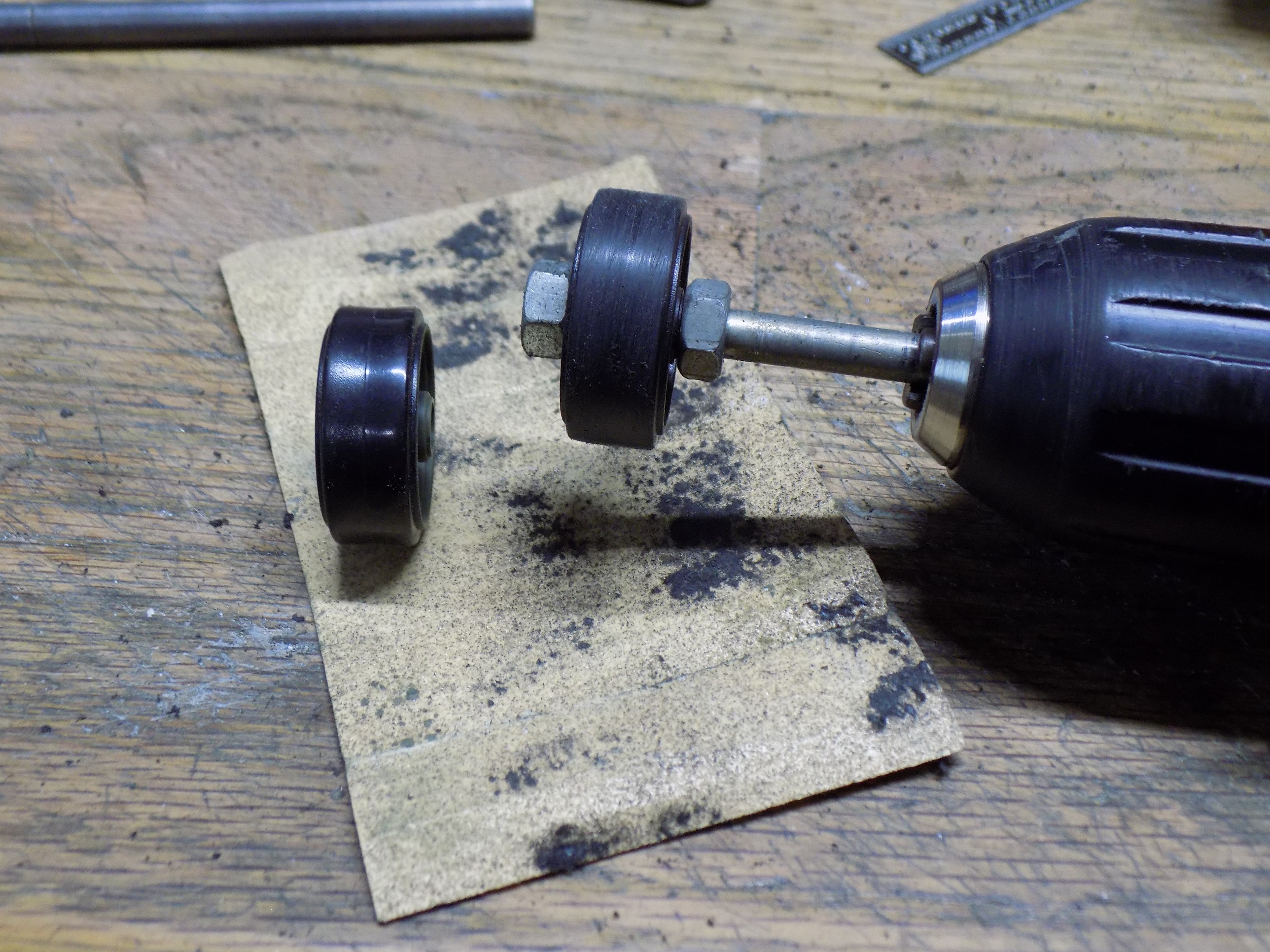

This is what I have done to each of my HL M4A3 road wheels (about 112 times) to give them a look of rubber as opposed to shiny plastic. Shaft is a 1/4" and is a perfect fit (6.35mm). The gook on the sand paper is from this tire only!

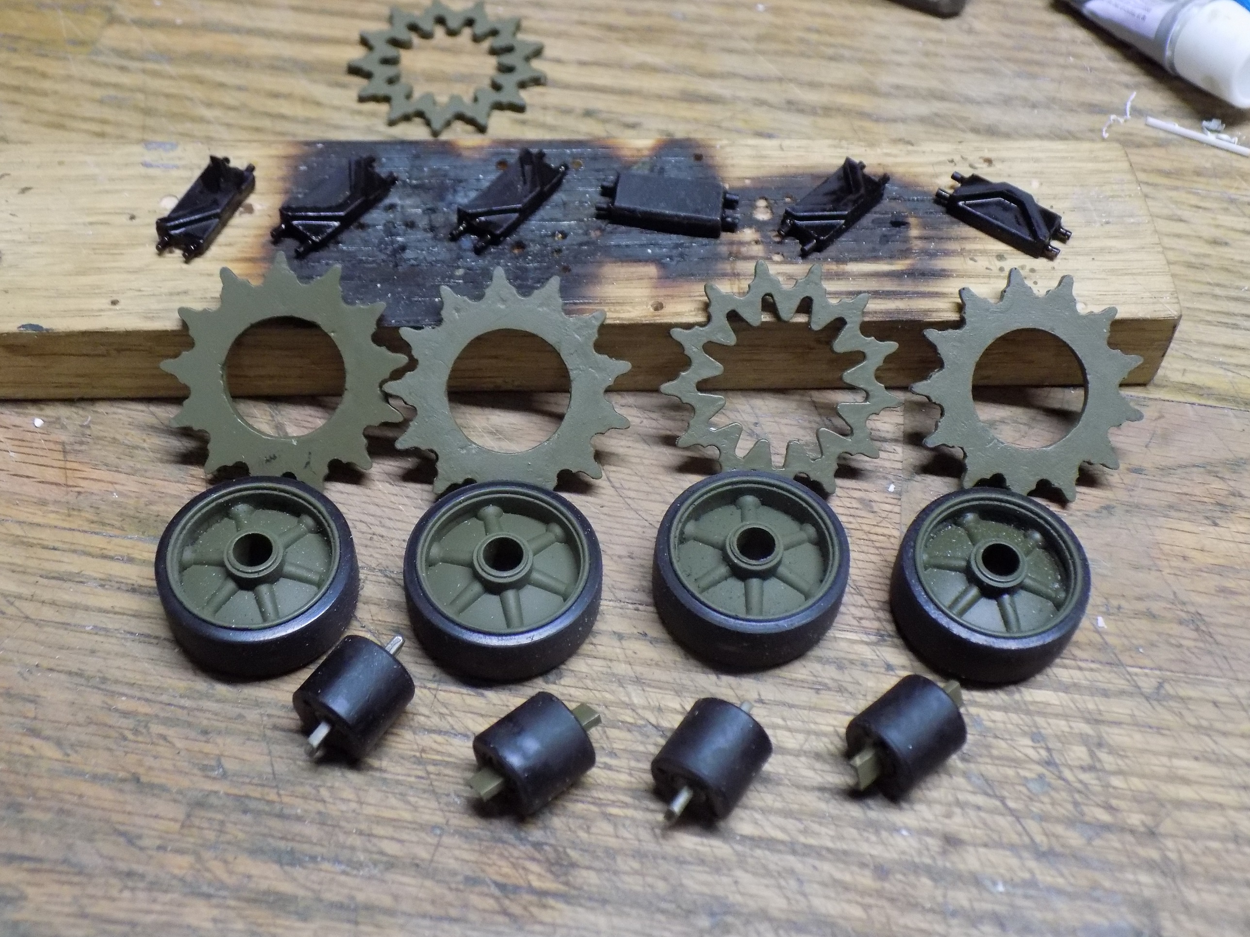

Here is the spare parts that will go on top. Still plenty of other tools, pulleys, stop blocks, stand off bars and yet more.

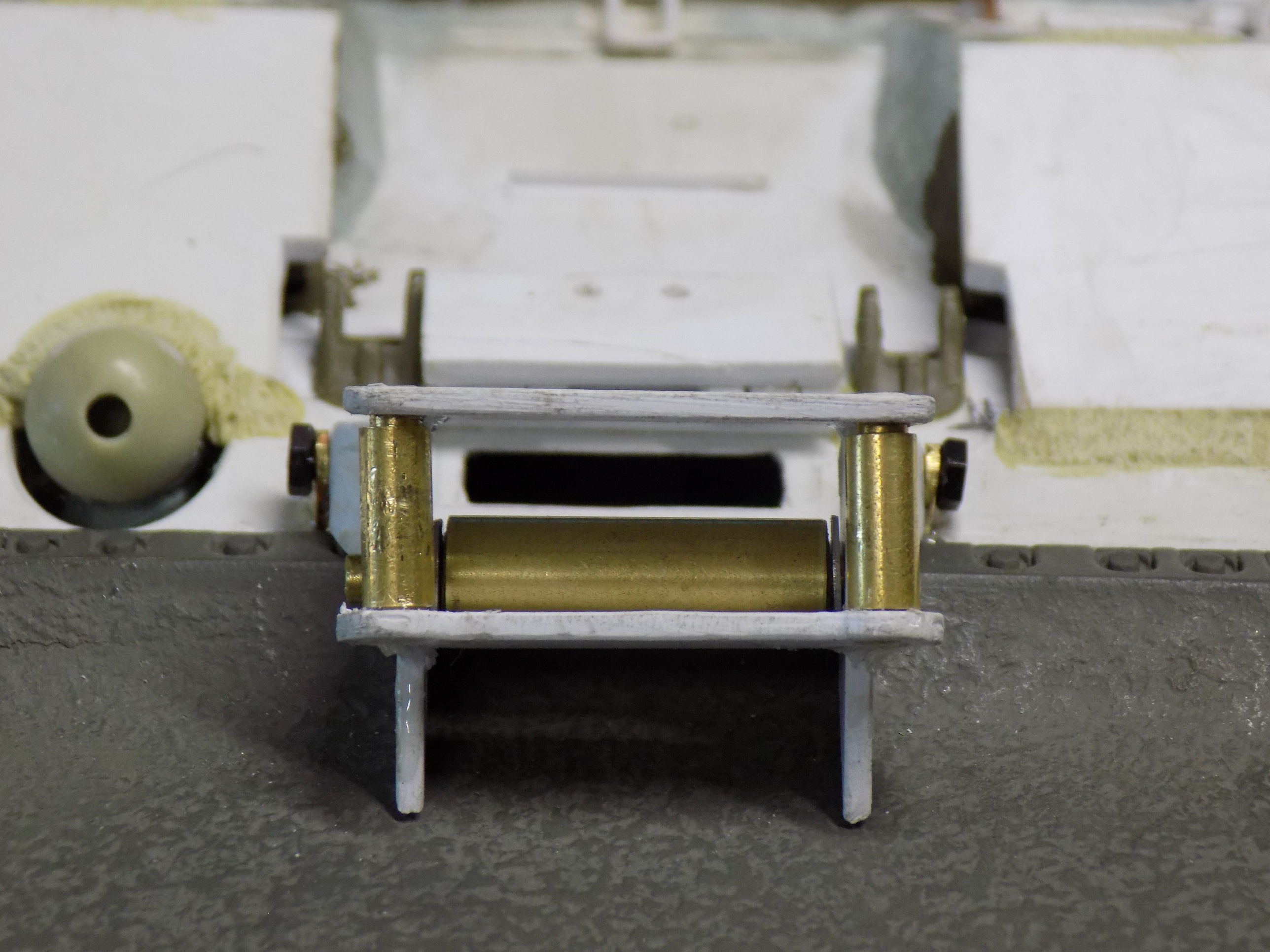

Working on the front pintle mount (the rear mount will be similar) and starting the roller fairlead.

Excellent work.
Great share for the wheels/tires/drill. I'll steal that idea.

Nice trick for the HL plastic wheels !

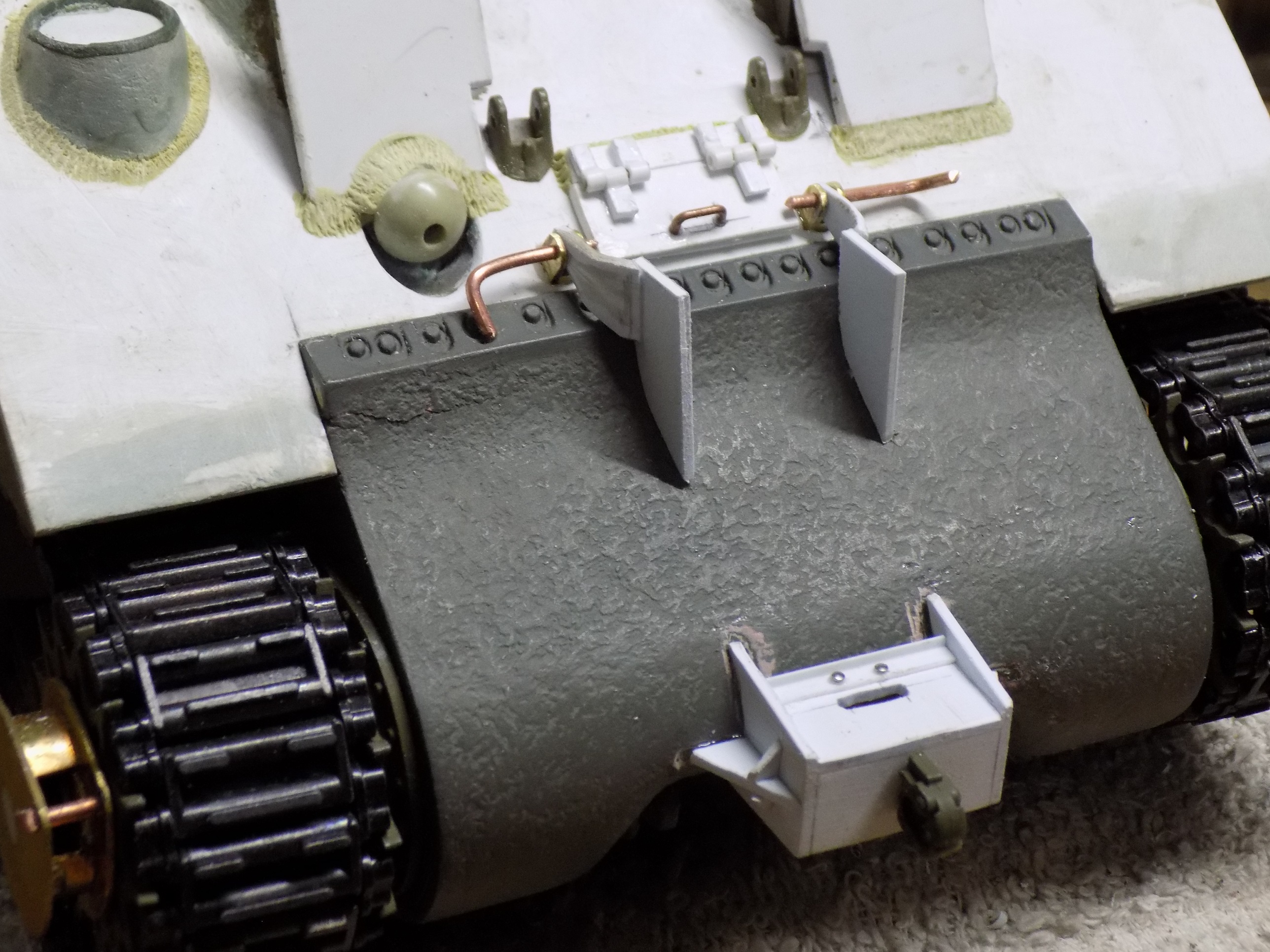

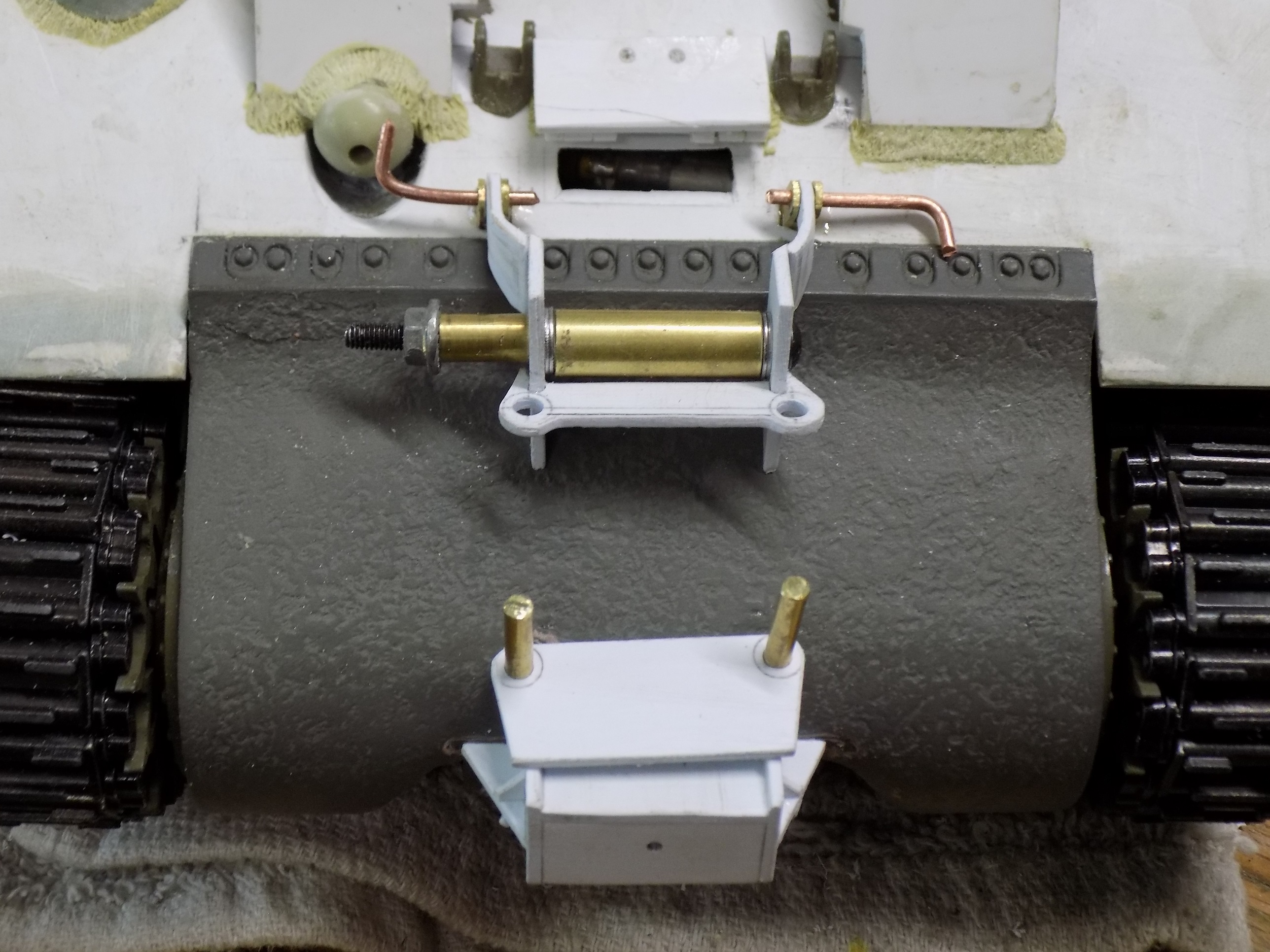

Started the winch fairlead with a roller.
M32 102.JPG (1.32 MiB) Viewed 76 times

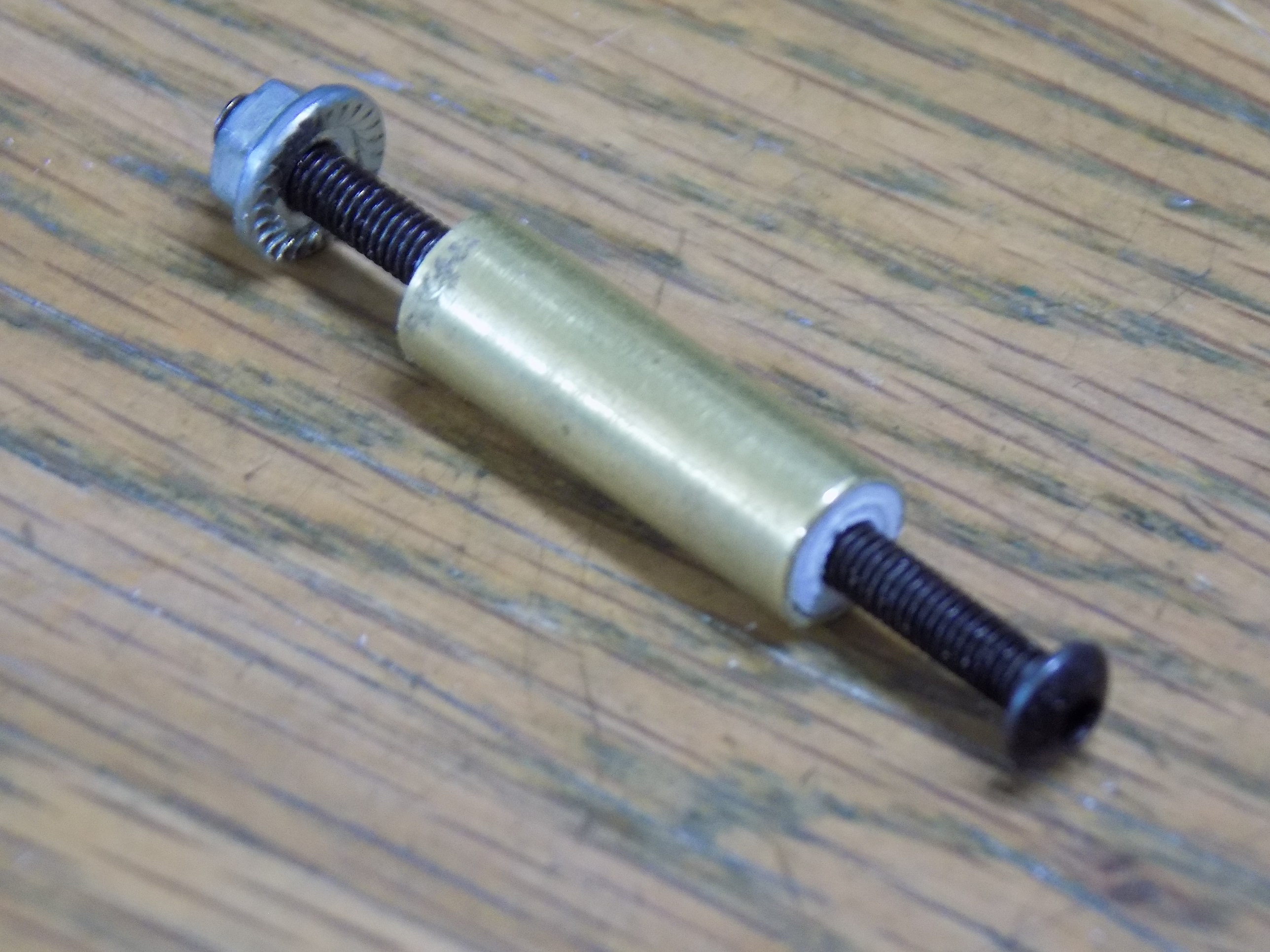

Herr Doc I can assure you the bolt is only temporary in building roller fairlead.
M32 103.JPG (1.08 MiB) Viewed 76 times

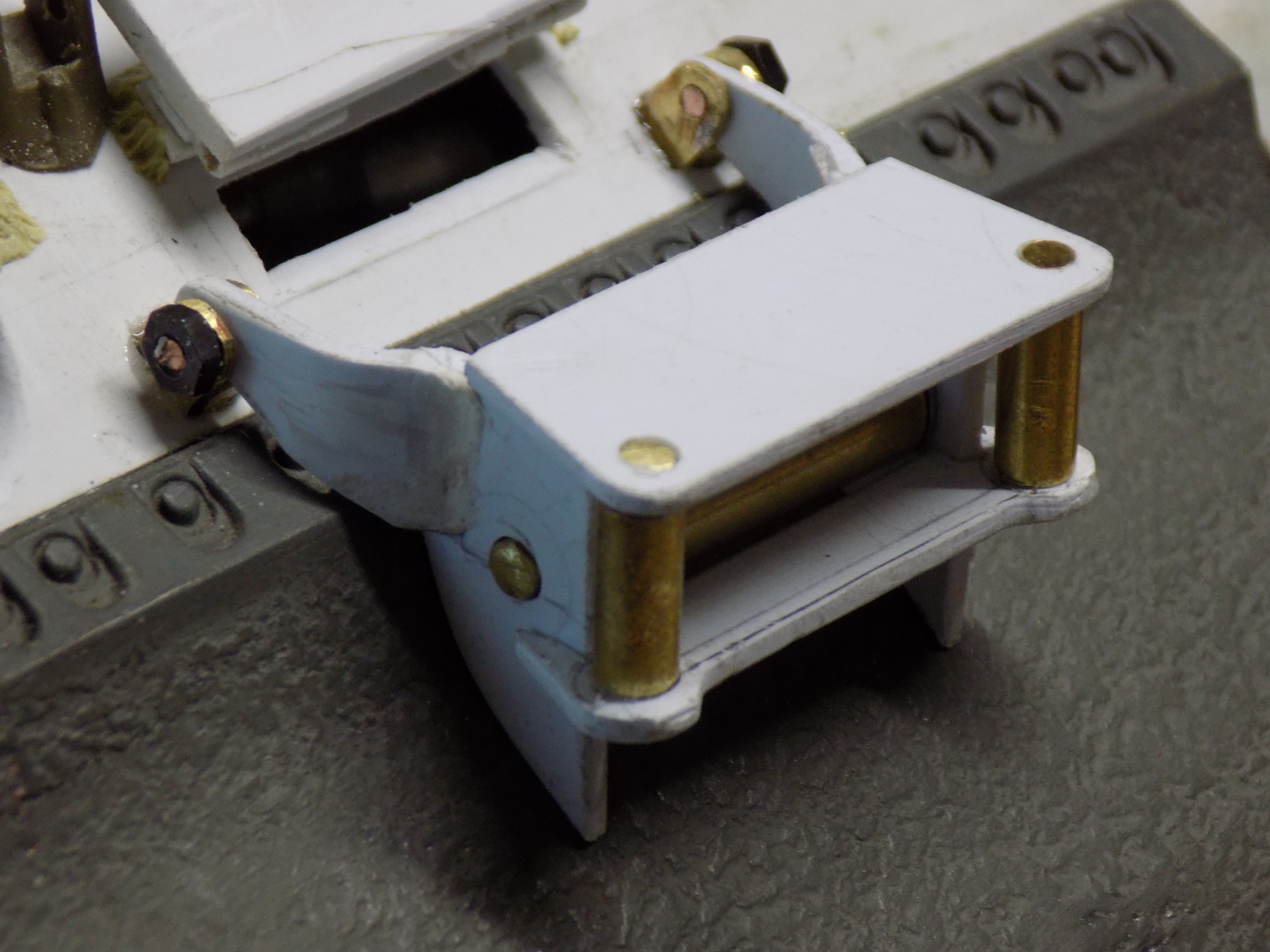

Not that is is necessary but all rollers do rotate.
M32 104.JPG (1 MiB) Viewed 76 times
