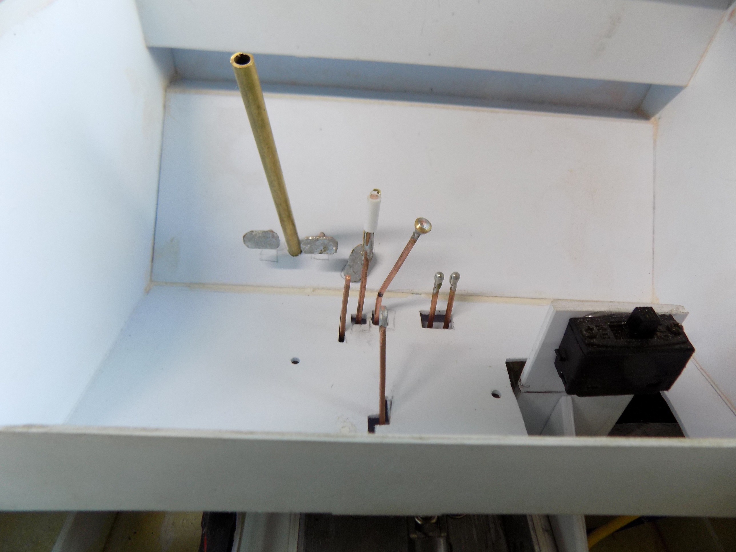

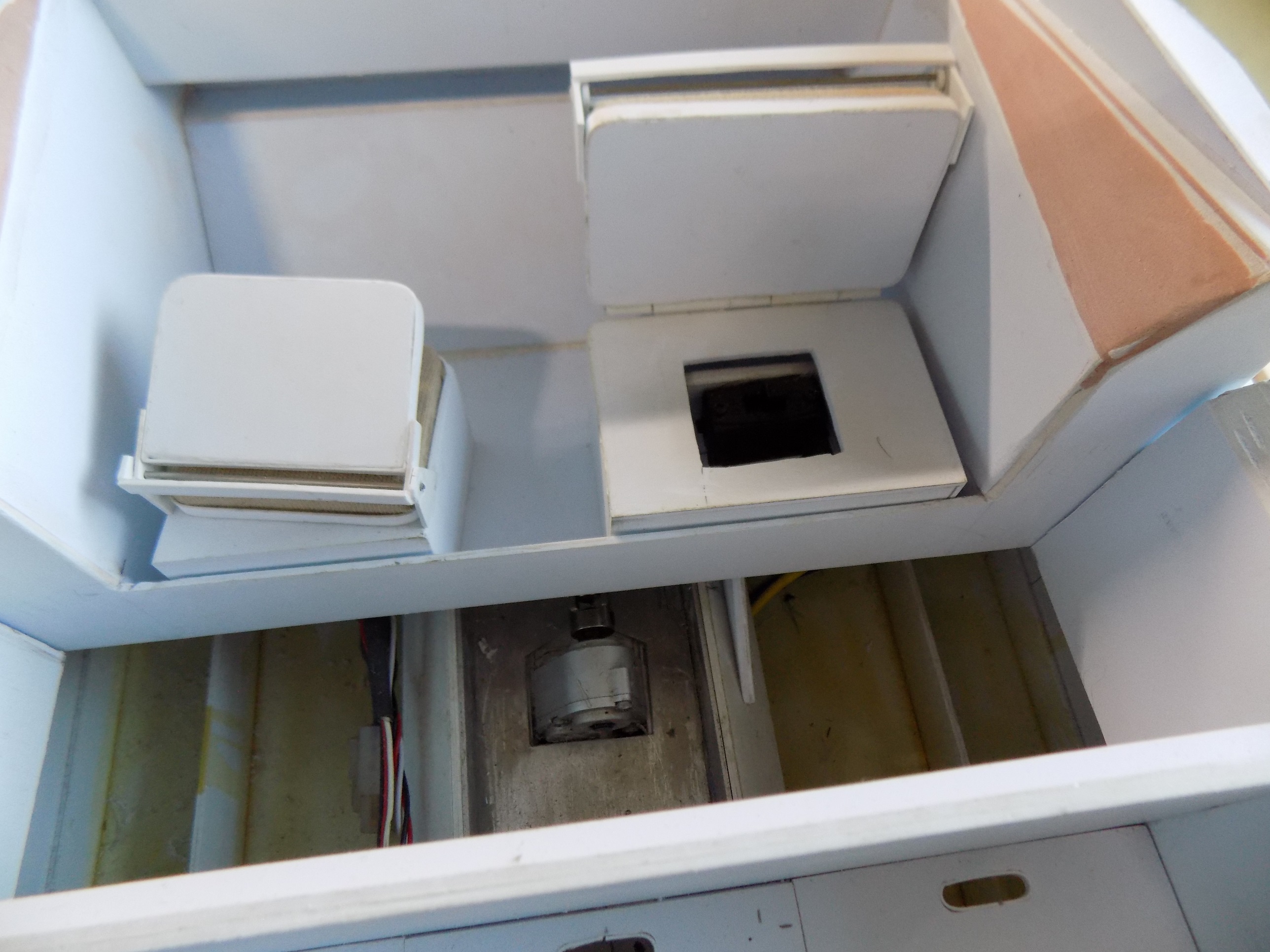

Here is my first attempt to upholster anything. The dark thing in the second picture is the on/off switch. It stays with the hull when the cab is lifted out.

I thought this might be a first on RCTW. A quick search for "Upholstering" found this old discussion: viewtopic.php?p=140016&hilit=upholster#p1400160 . I believe, however, that your upholstering, Ecam, is much more professional. :thumbup:
However, shouldn't that hole beneath the seat be sort of round or oval? :P

That's the one below the driver's seat!

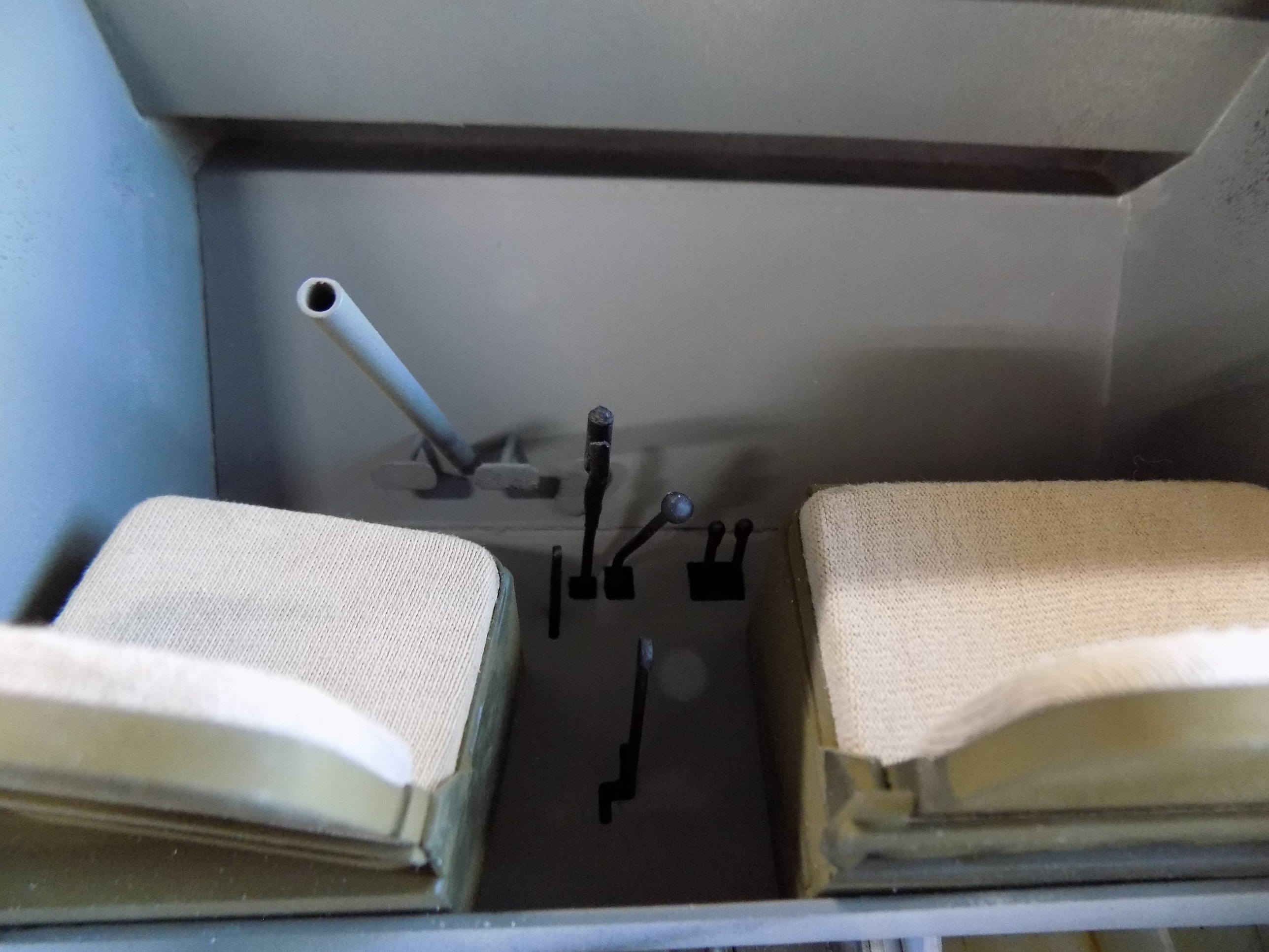

More cab work. Still need to touch up the E-brake handle a bit. Bix inspired me with his oxy/acet. torch. Lever at the rear between the seats is the prop control. Left to right; winch control, E-brake, trans and the twin levers are the transfer case high/neutral/low and front axle in or out. The steering column is just set in place for now until the dash, wheel and driver are worked out.

Those are satisfying control levers! They remind me of the fun of driving a vehicle with multiple control levers, instead of these wimpy little buttons and touch screens--aak!
This is a fun build to watch, but it does make me wish for your level of skill. Bravo!
From the photos, one can see all the text to identify lever positions and all the gauges. There is far less in my FAMO, but I keep wishing there were some set of decals that could at least fake the gauges. Do you have any ideas?
"That's the one below the driver's seat!" Egad! The whole DUKW would have to stop for one crew member to use it. :haha:

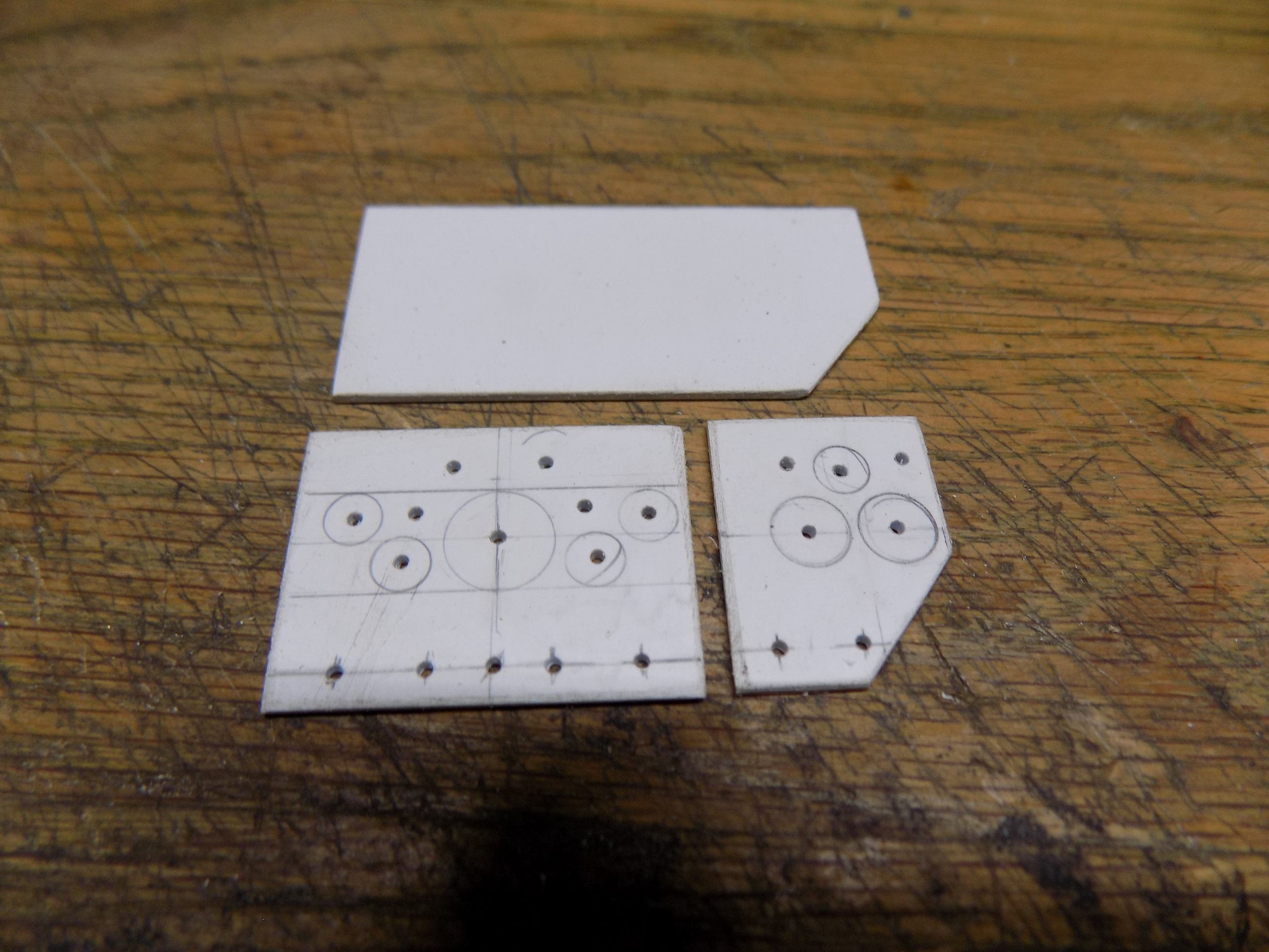

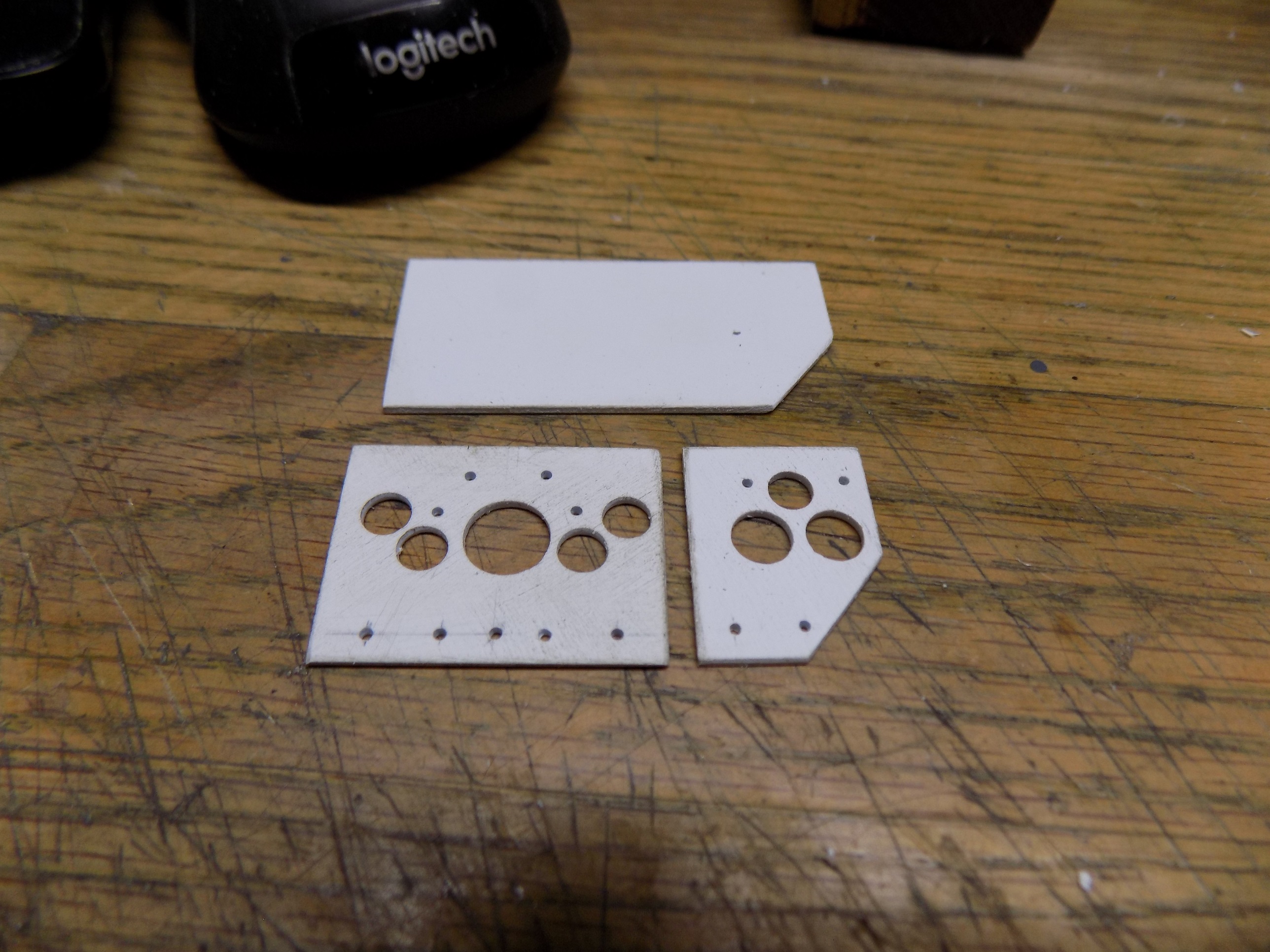

Instrument panel start (enough for today).
And Herr Doc, these are the instrument decals I have on hand. I tried sending a PM (twice) but they don't seem to be getting through. The smallest set measures .185 for the large gauges and .070 for the smaller (I'm guessing this was a 1/25th kit). The next ones measure .279 & .242 large, 5 ea @ .147 smaller. The last set is from an 1/8th hotrod kit, measuring .415 large and 5 @.244 and 3 @ .313. PM me an address and I'll mail off which ever you choose.
