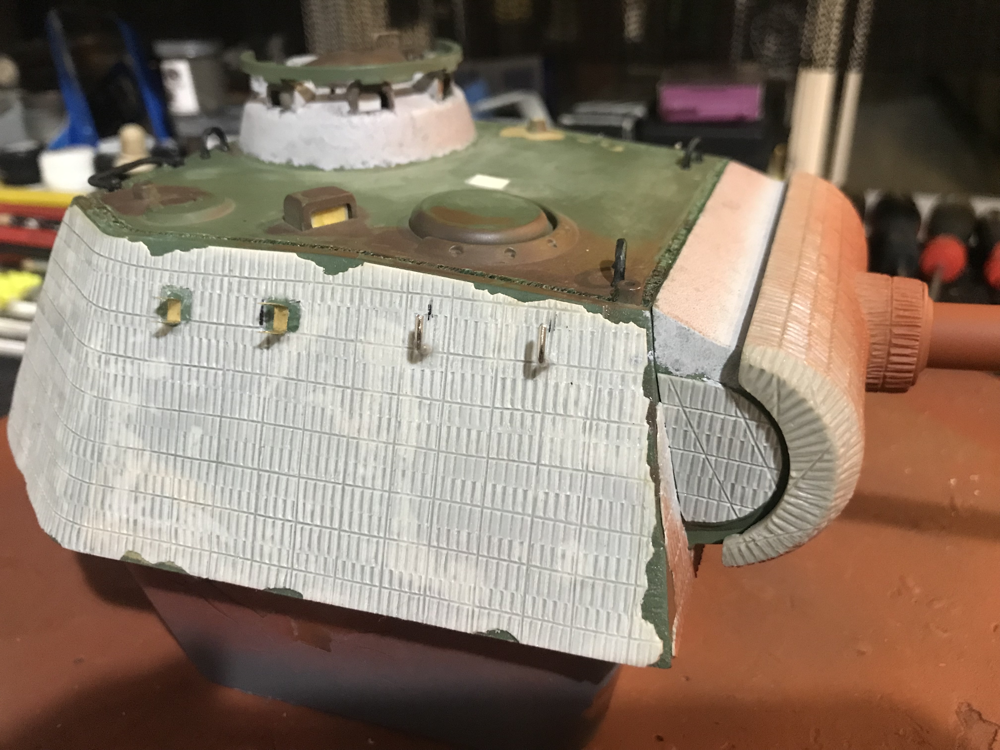

Minor progress

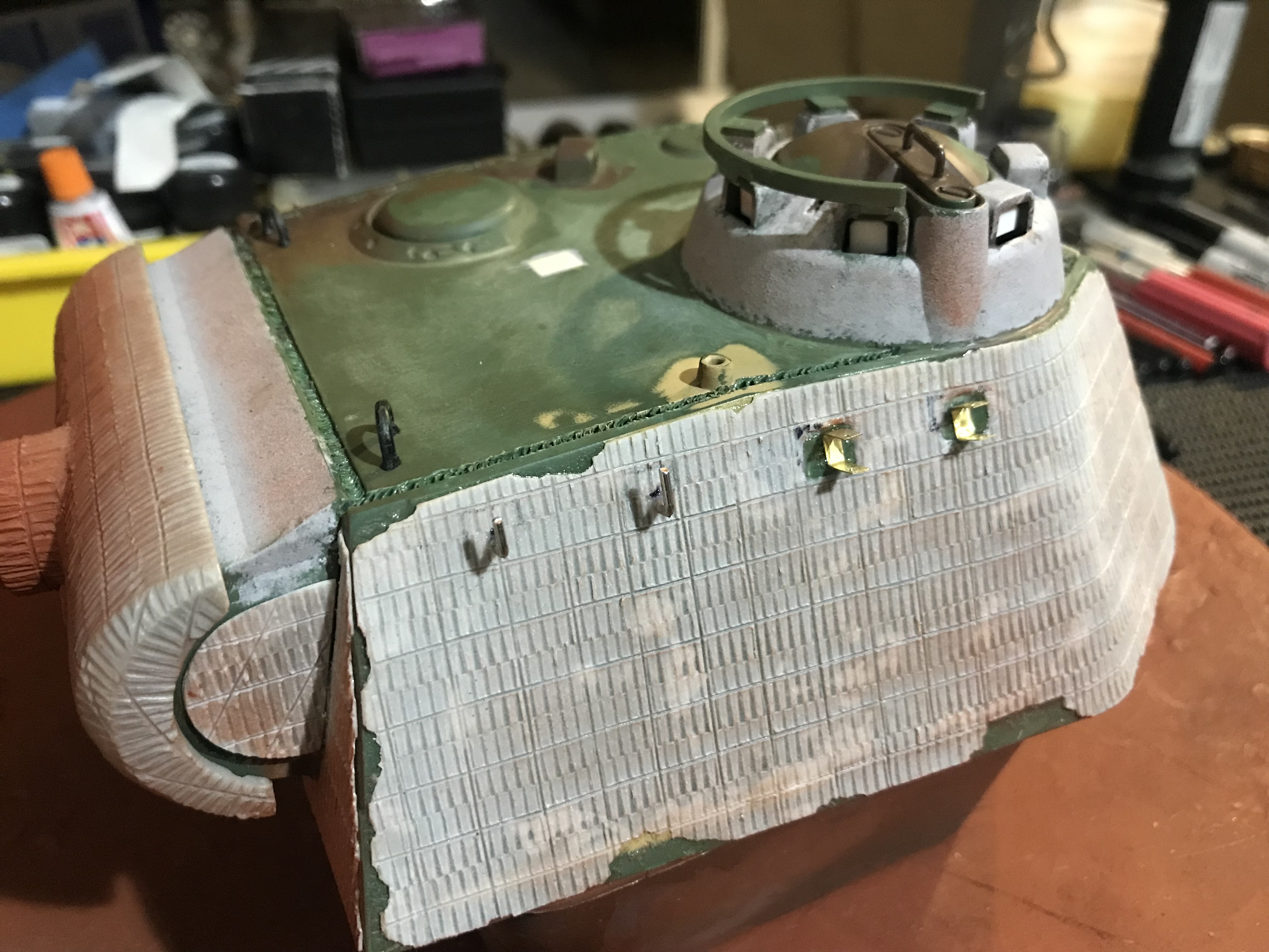

Got the turret mounted spare track hangers on.
Same method as the hull ones but slight angled to suit the slope of the armour.
The period pictures and current pictures show a pair of C shaped hangers on the rear of the sides with simple welded hooks on both front sections.
The hooks I used cut bits of paper clip material, superglued into drilled holes.
The detail of weld around them will be lost in the scale so no point trying to be smart :think:

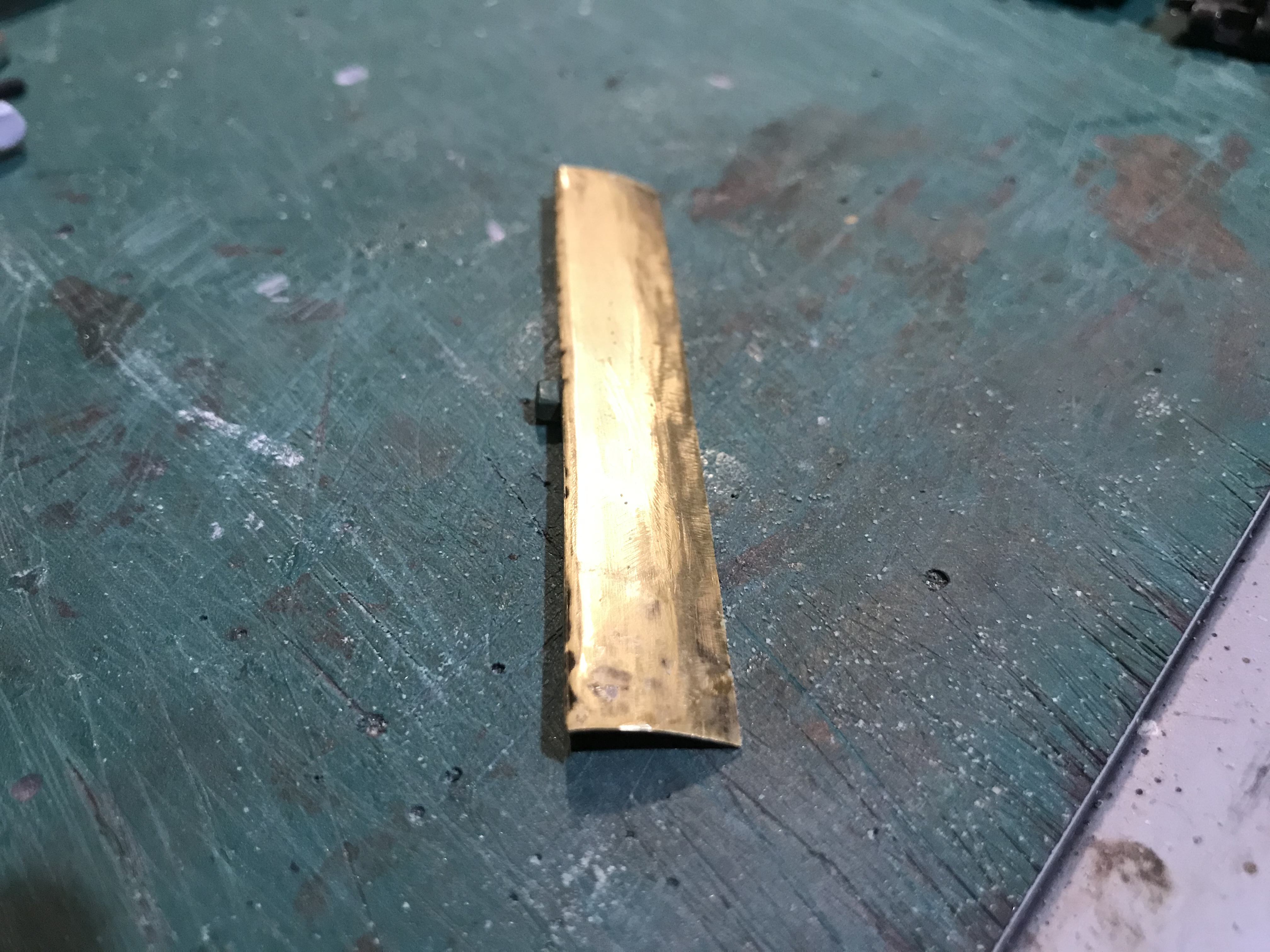

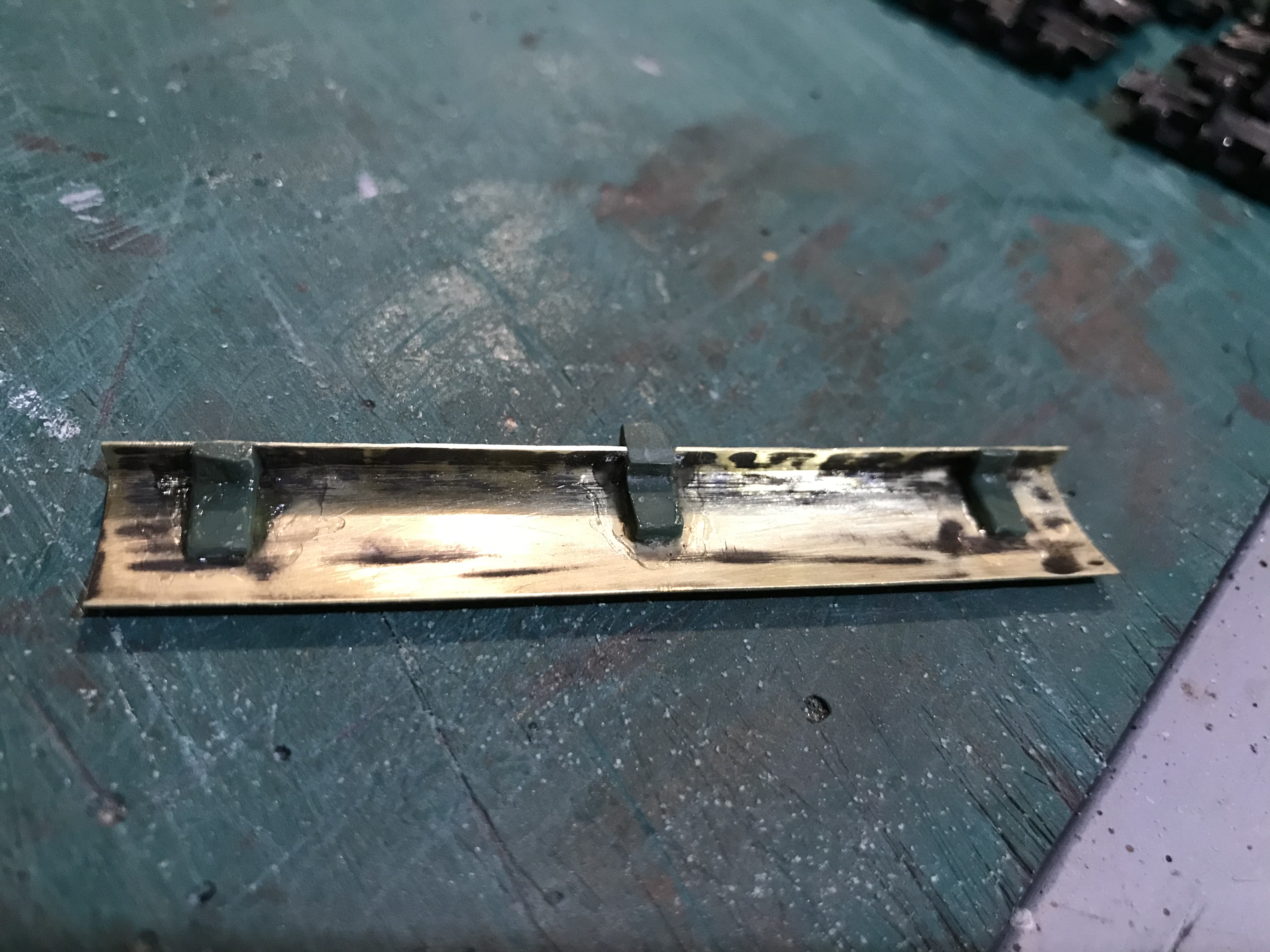

111 had an ersatz debris guard over the mantlet which sat further forward of the usual mounting points,
I made this from brass and used cannibalised slices of the HL plastic one to assist with securing it to the mantlet mount.
Well that’s the plan anyway!
I did pick up that in my haste I missed the loaders hatch handle is not the same orientation as a late G so that will have to go & be replaced by a made one.
Tomorrow is the rear hull plate including the jerry can baskets and exhaust covers.

Hey Herman - I just noticed how wonderfully straight the zimmerit is! Well done.
Posts: 11723
Re: PANTHER 111, 116TH WINDHUND Dv, HOUFFALIZE 1944
Estnische wrote:Hey Herman - I just noticed how wonderfully straight the zimmerit is! Well done.
Thanks mate, although its good quality stuff, its made for Tamiya Panthers, not H/L ones, so does take a bit of fitting to get into the right spots.
Maybe one day they will click that Tamiya Panthers are as rare as the real ones & make the product to suit Taigen/HL ones.!! :/

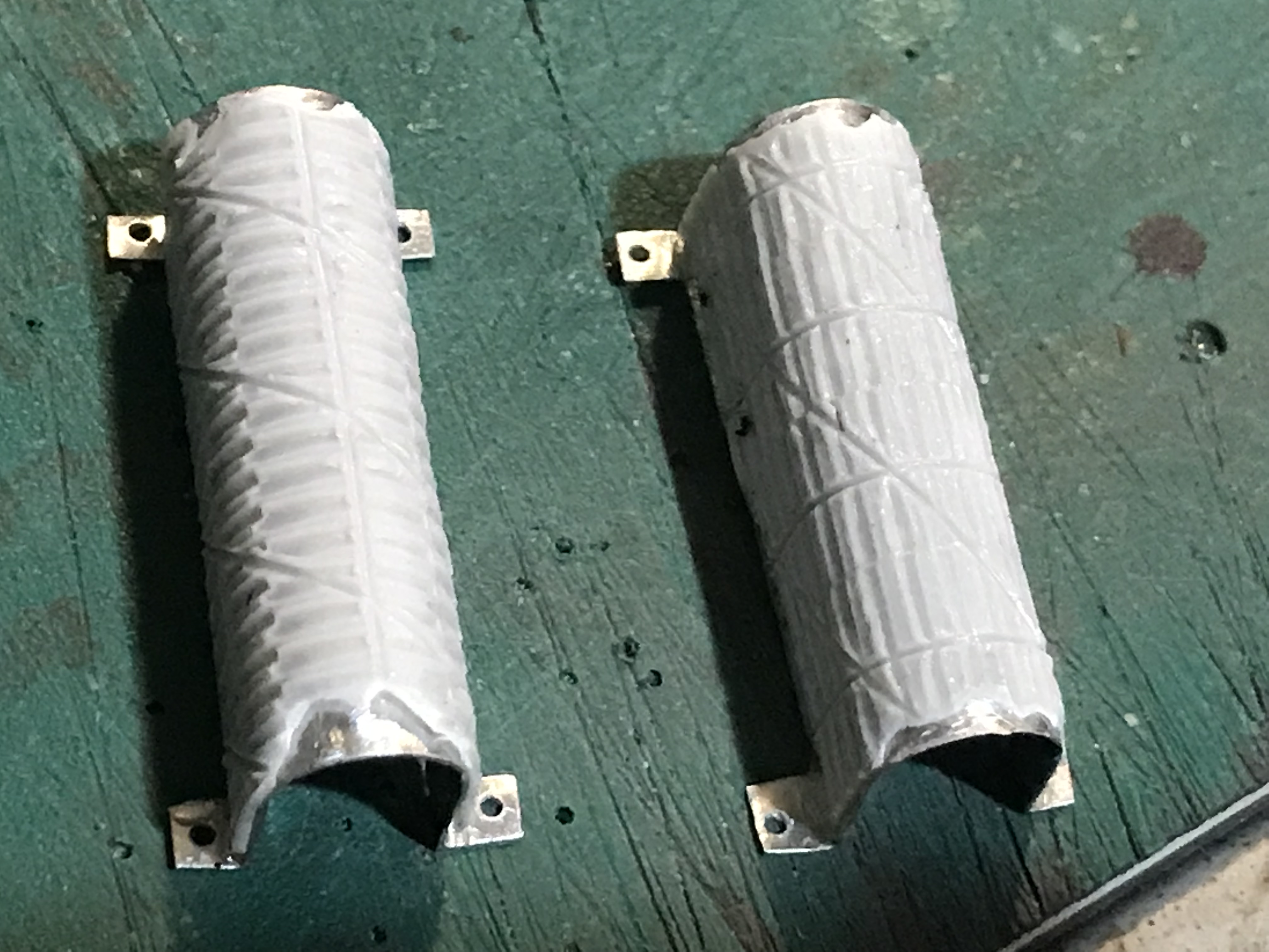

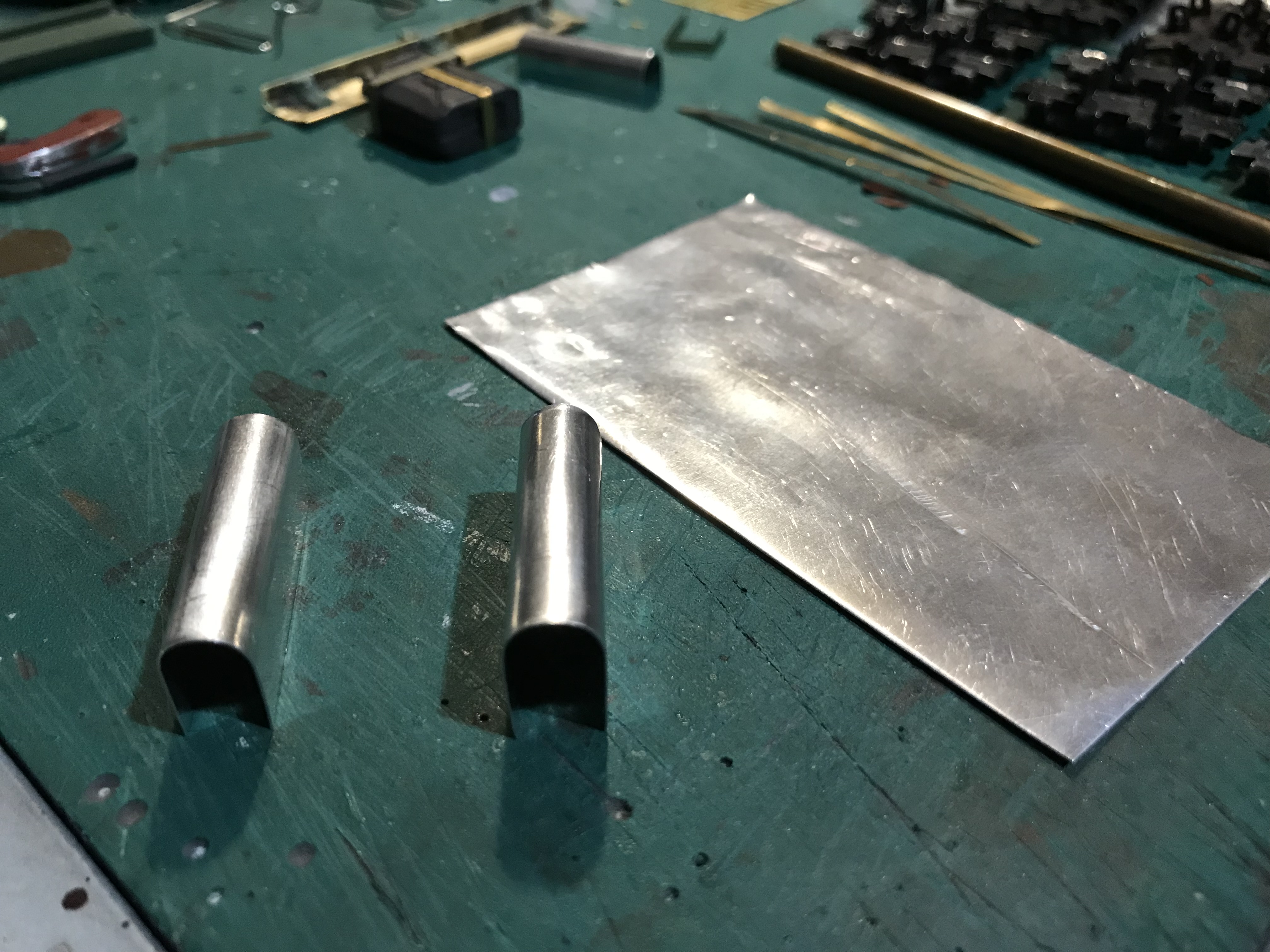

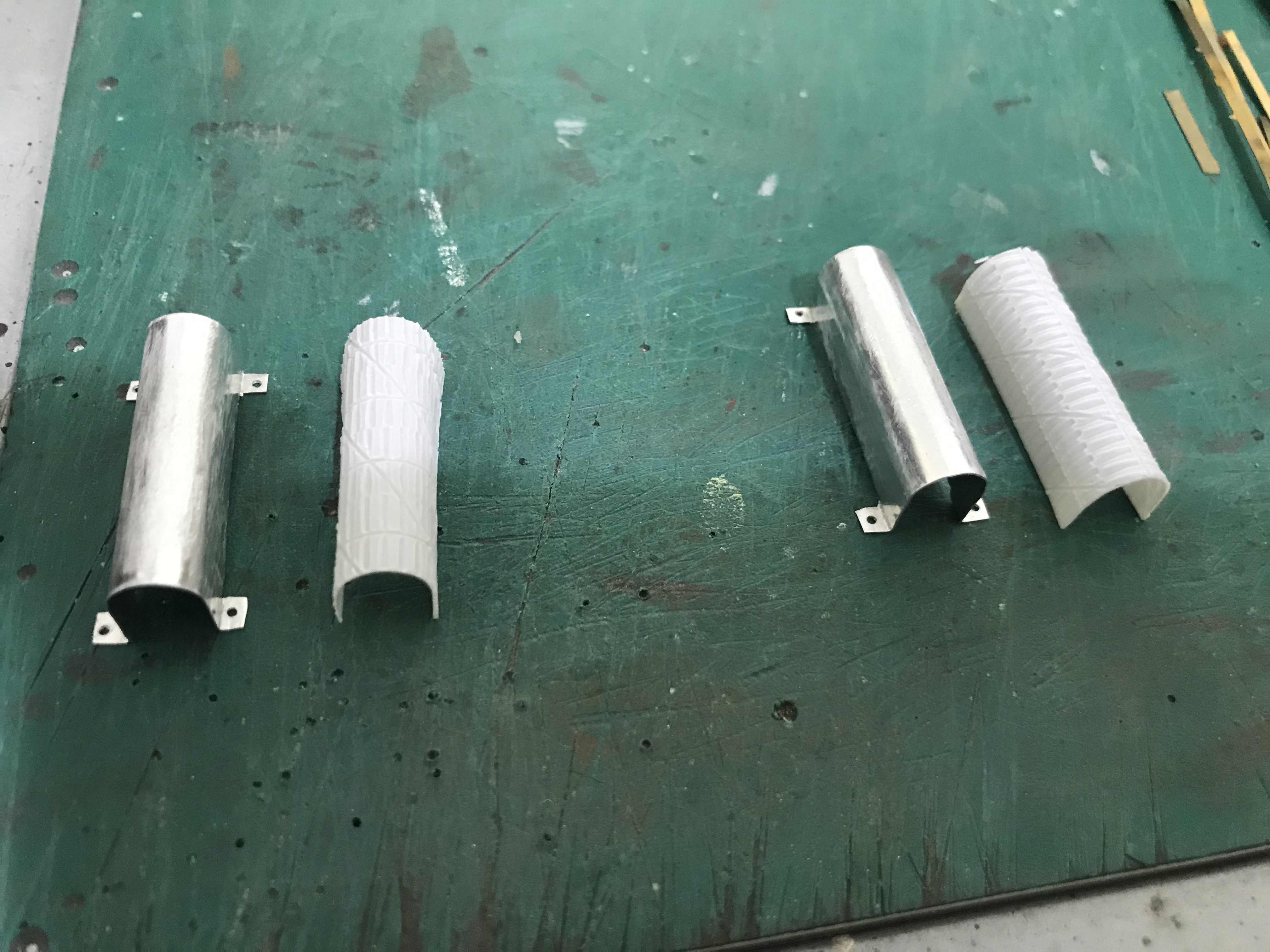

As this is an early-ish G it needs sheet metal guards around the top of the exhaust pipes.
An added detail is that DB also coated the guards with Zimmerit!
I made the guards from Aluminium( that’s said Aloominum to you left hand drivers) formed around a craft knife & trimmed with scissors and a file.
The zimmerit was left out of the Atak set that was supposed to go on the front mudguards, which I only have one remaining of as seen in the post war pictures.
Was enough to do both exhaust guards.

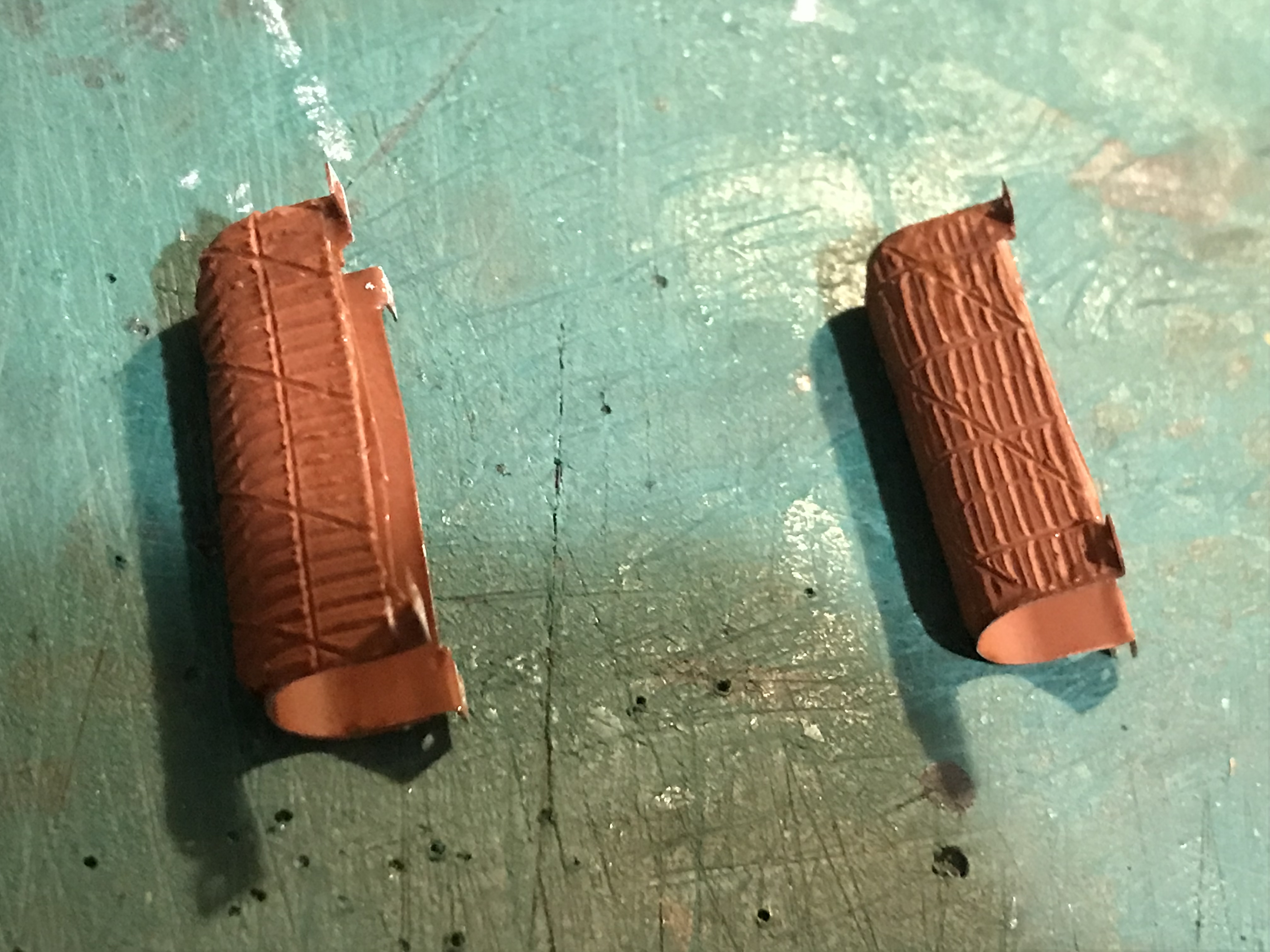

Dipping the zimmerit patch in boiling water then quickly placing over the alloy forms retained the curved shape well.
A wipe of epoxy to secure it and it’s done.
I learned after a previous set to drill the holes before trimming the tags, so this time was a lot easier.

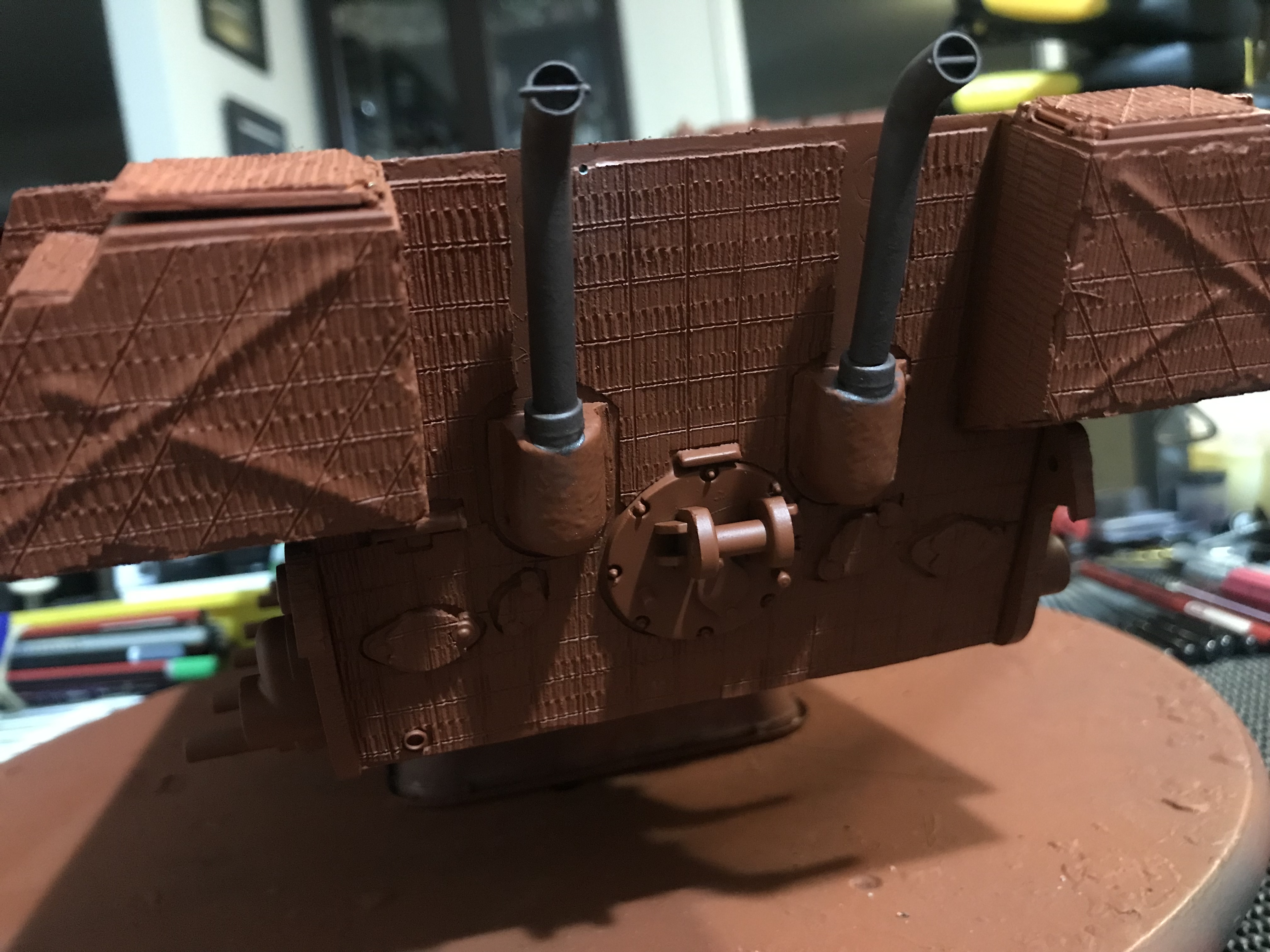

Shot a quick burst of primer inside both then brush painted the exhaust pipes to get them close enough looking as once the guards are placed, painting is almost impossible.
I will mask the pipes when the base & camo goes on .
