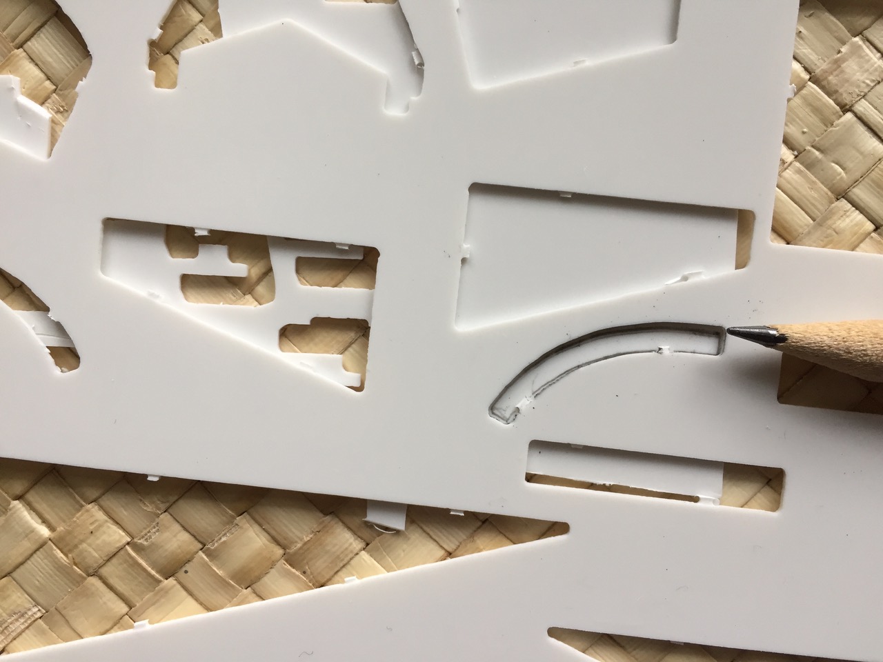

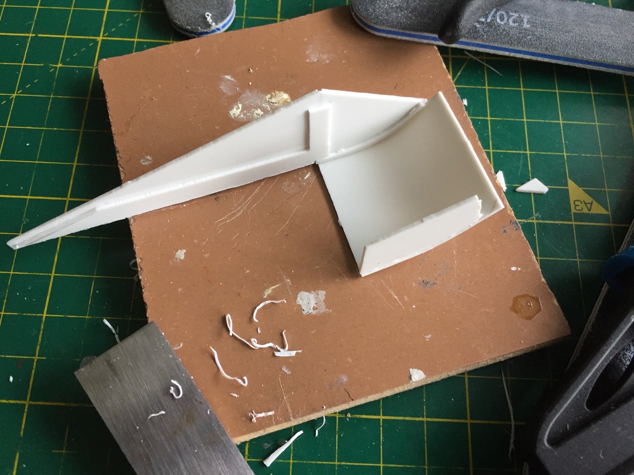

Assembling the front mudguards involves bending a plate, and can be pretty tricky. The outermost joint between plate and triangular side has a curved fillet to act as a former, and to reinforce the joint. The inner panel doesn't have a fillet supplied- so, I made one. The shape was already there in the discarded sprue/ styrene plate. :|
Former and fillet for front mudguard
Now, both the inner and outer wings have a curved former to help shape the curved part.
Mudguard curved reinforcing fillets.

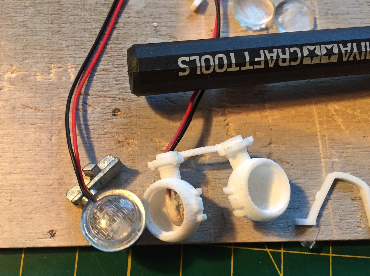

These bits are what I have available for the job:
The headlights are from HL's Crusader model (an extra); but the same headlamps were fitted to the Churchill, Cromwell, and Comet as well. The donor lamps (for the wired LEDs) are from the Taigen T34. I bought several from Forgebear, intending to use them for the auxiliary lamps often fitted to the turrets of the Cromwell and Comet.
The Comet kit includes styrene lamp protectors, as seen below, but I preferred to buy the Crusader metal versions. They take a bit of shaping, and the crosspieces have to be cut out, but they're ideal for bolting- instead of cementing- in place :thumbup:
This was part of the bulb transplant from T34 to Comet

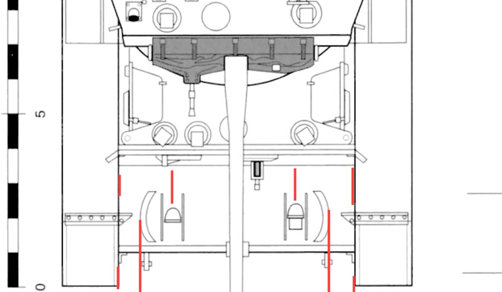

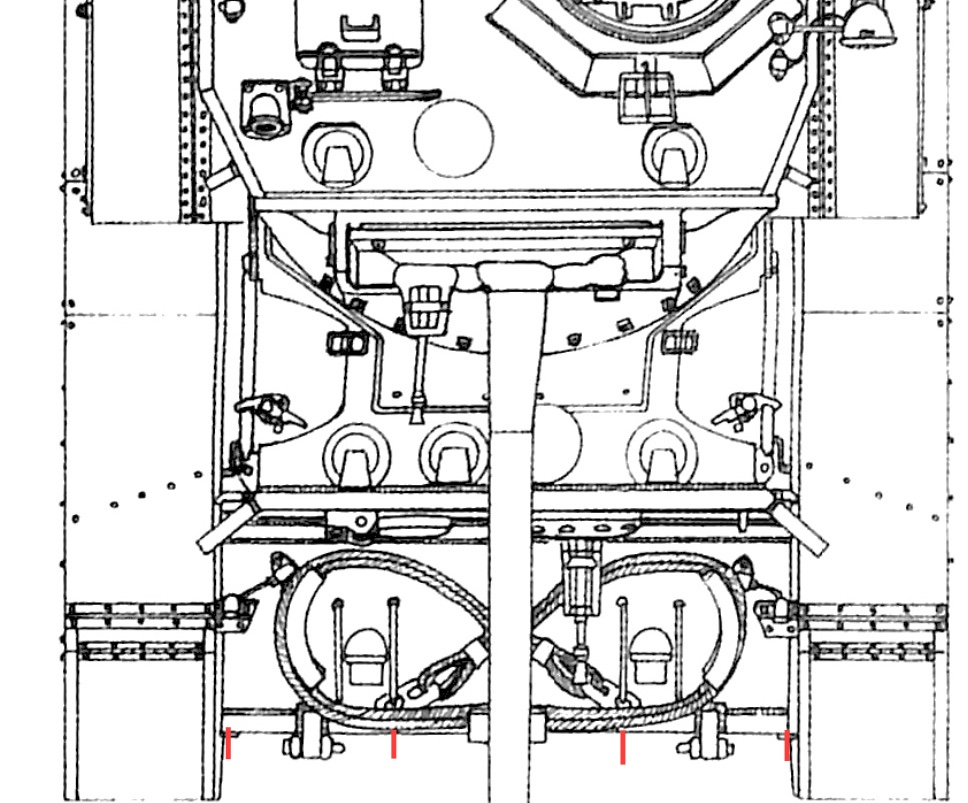

On these two blueprints (necessary when ye have nae other sources :problem: ) the lights and protectors are symmetrical, as are the curved retainers that hold the two ropes.
Blueprint A- Comet front lamps
Blueprint B- front lamp assembly
Blueprint-Comet A34-version B-symmetry.jpeg (94.89 KiB) Viewed 3449 times

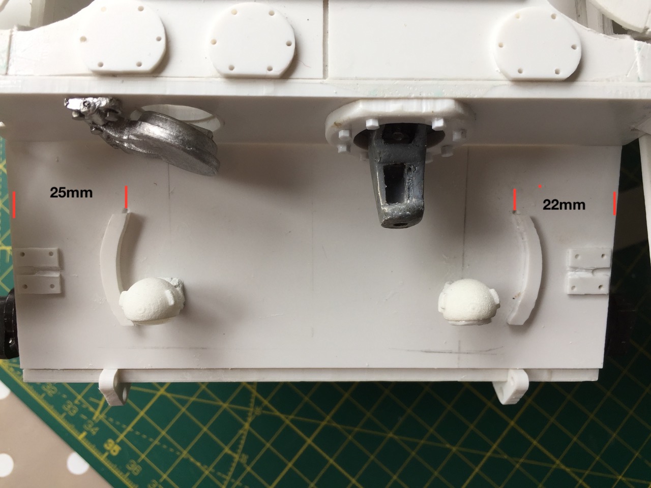

Sooo...I began drilling holes for the lamps on the glacis plate, having used a ruler to ensure the holes were the same distance from the edge. After I'd drilled the holes, and begun to fit the lights- I noticed something amiss. There was an odd lack of symmetry. Then, I twigged that the curved two rope holders are not symmetrical on the model. They're out. In fact, by a shade one is 22mm from the edge, and the other slightly over 25mm. :think:
Glacis component asymmetry
Hmm..that got the inner detail (semi) obsessive wondering what was going on. Did CL know something about the design that had eluded me, or could he have made a mistake? 8O

Great work and a keen eye for noticing the non symmetrical tow rope holders.

No matter what the actual answer to this conundrum might be, I still have to carry on with the fitment. However, I don't want to keep drilling holes, and so I resolved to have the lamps and their protectors appearing symmetrical, whilst there's not much I can do about the two holders. They're fitted in precut grooves.
Well, here's what the lamps look like with defenders in place. The LH lamp has 'glass fitted, whereas the RH one will have a hood or shroud fitted, as per the setup on the Polish Comet. I'll have to make that myself.

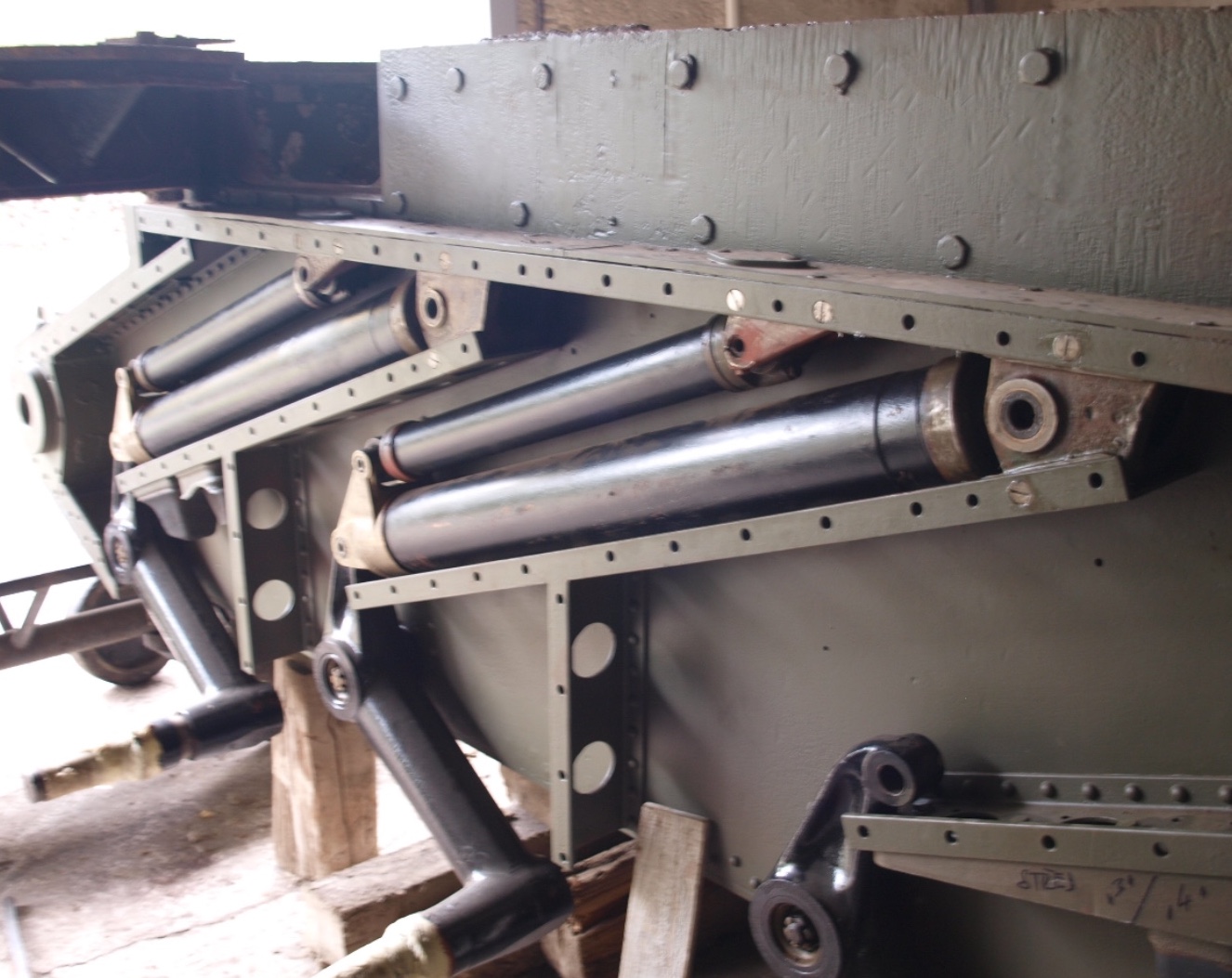

For anyone wondering what the Cromwell and Comet suspension looks like with the skirts pulled up, so to speak, these pics of a stripped down Comet should prove interesting:
Czech Comet suspension bared

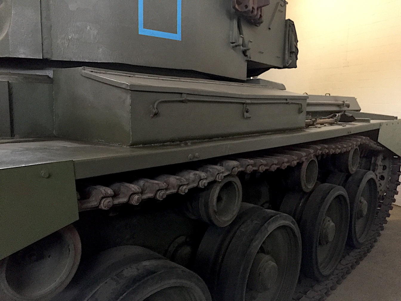

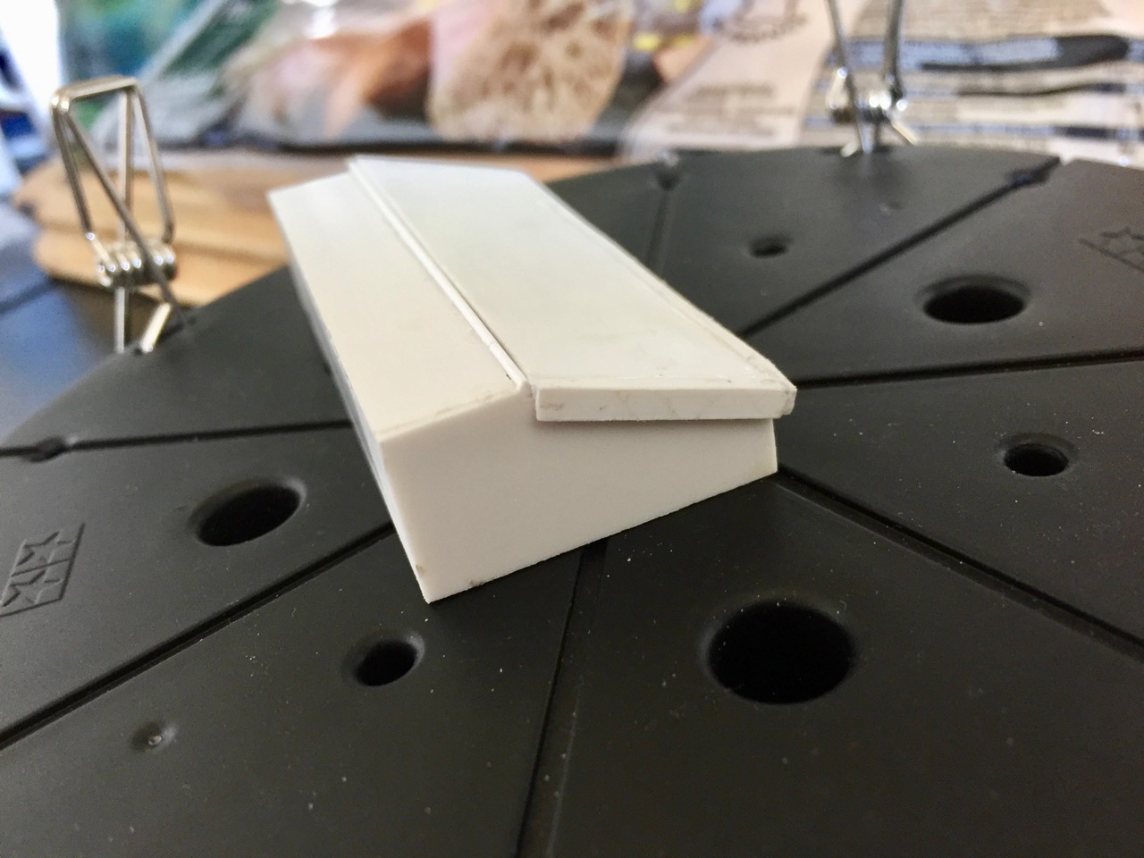

Before I get back to the knotty drive train issues, I thought I might mention the difference between the Cromwell styled storage boxes supplied with the kit, and the actual appearance of Comet units.
The Comet units have plain surfaces (without the embossed stiffening ribs), and the lids have lipped edges so:
Click to ENLARGE these pics, by the way. :thumbup:
They're not pasted in from Imgur.
Comet L.H. storage bin

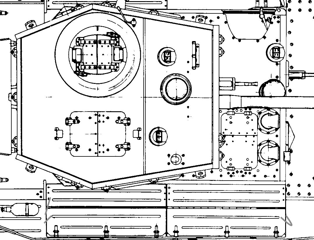

Here's shot of the bins on a Cromwell blueprint. The raised ribs are apparent of the top of the unit and the lid, The lid itself is flat, and has no lipped edges. This is what you will get with the Comet kit,, and it's wrong, I'm afraid. Still, all that needs to be done is to fit the panels with grooves for the ribs facing inward, so that the plain surface is the visible one.
Cromwell overhead blueprint shot of storage bins

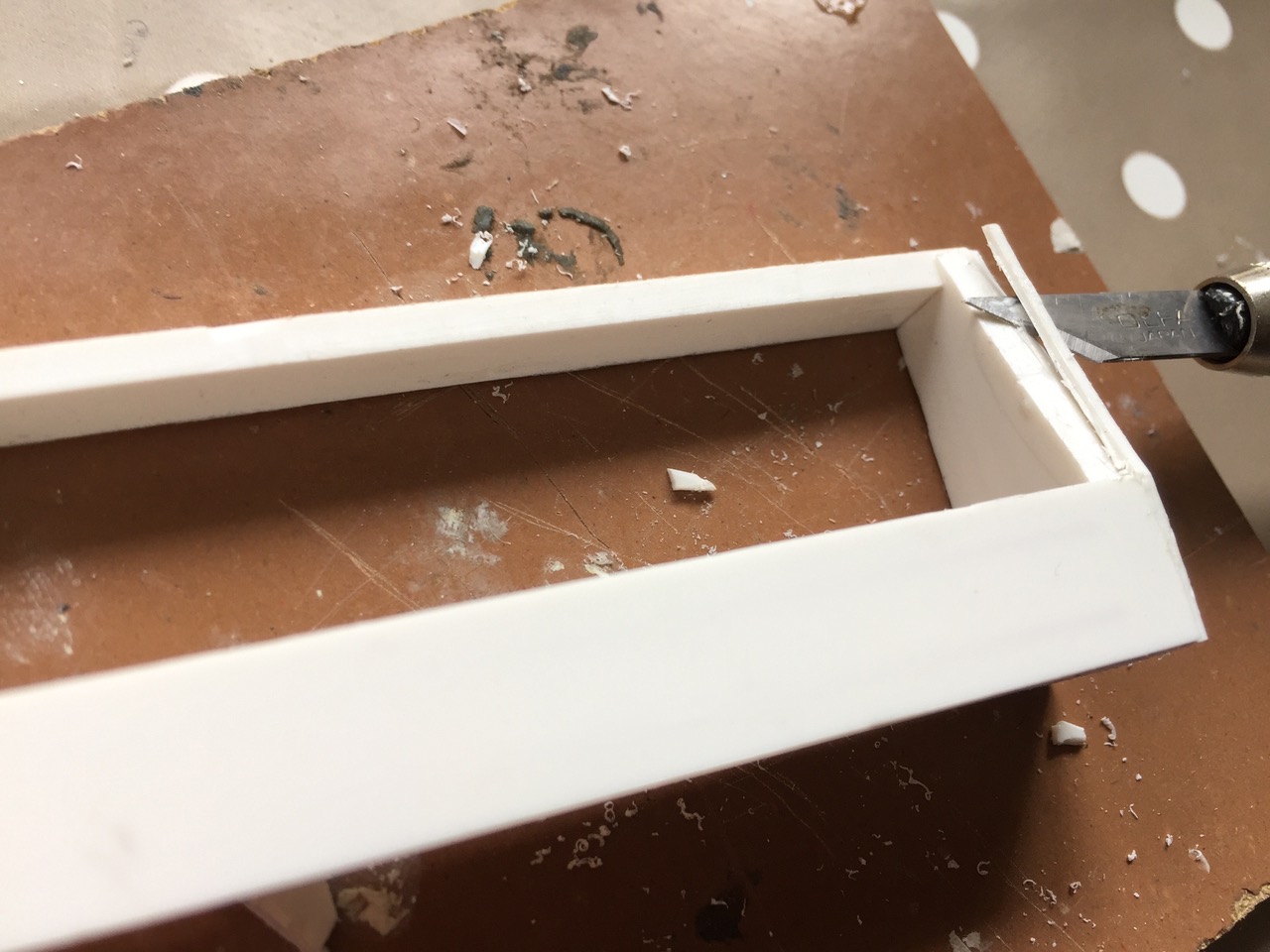

First, I had to remove the raised edge of the bin's sides. On the Cromwell, the lif sits flush inside this raised edge. On the Comet, the lid extends right to the side's edge, and then hangs over it in the form of a short lipped edge. I seem to be making the terminology up as I go along; but I hope you're getting the drift. :lolno: Finding the actual engineering terms used by the designers, is a major task in its own right. :think:
Comet storage box mod pic A
I actually had to replace the supplied styrene lid, as it was too short to reach the edges of the box. Then, I used some split 2x2mm angles styrene to create the edges. I might trim a bit off yet, for scale purposes.
I also added a 1mm styrene tube (bar) to simulate the type of hinge used on the box, that runs the length of it.
Comet build-Storage box lid modification.
Still more to do to get the right look, but it's 90% there, I think.
