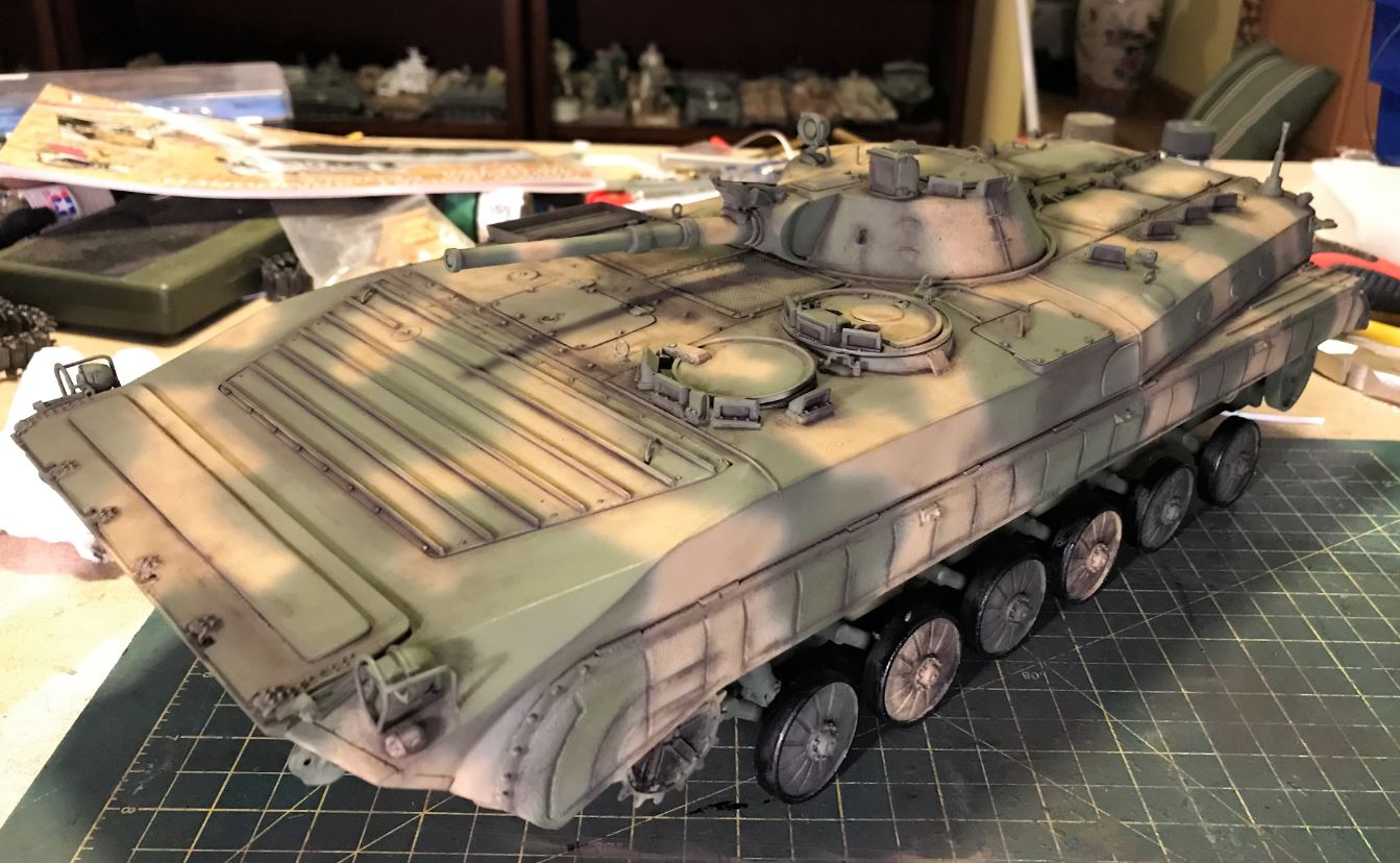

This is an extended report on the painting of the BMP-1.
The BMP-1 is applied two Tamiya enamel coats as primer to seal the plasticard and putty, with sanding after the first coat to remove any scratch and glue residue that become apparent.
BMP-1 IFV 1/16 scale RC

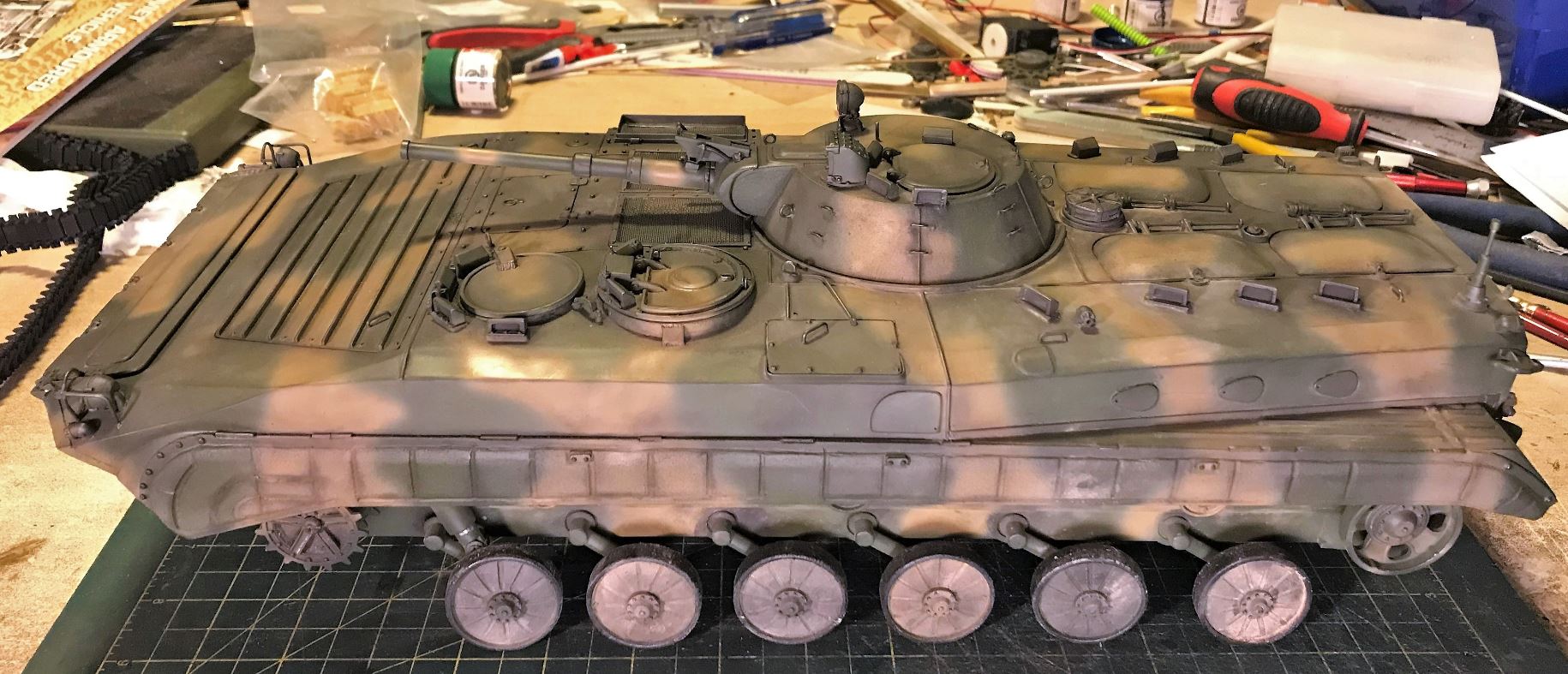

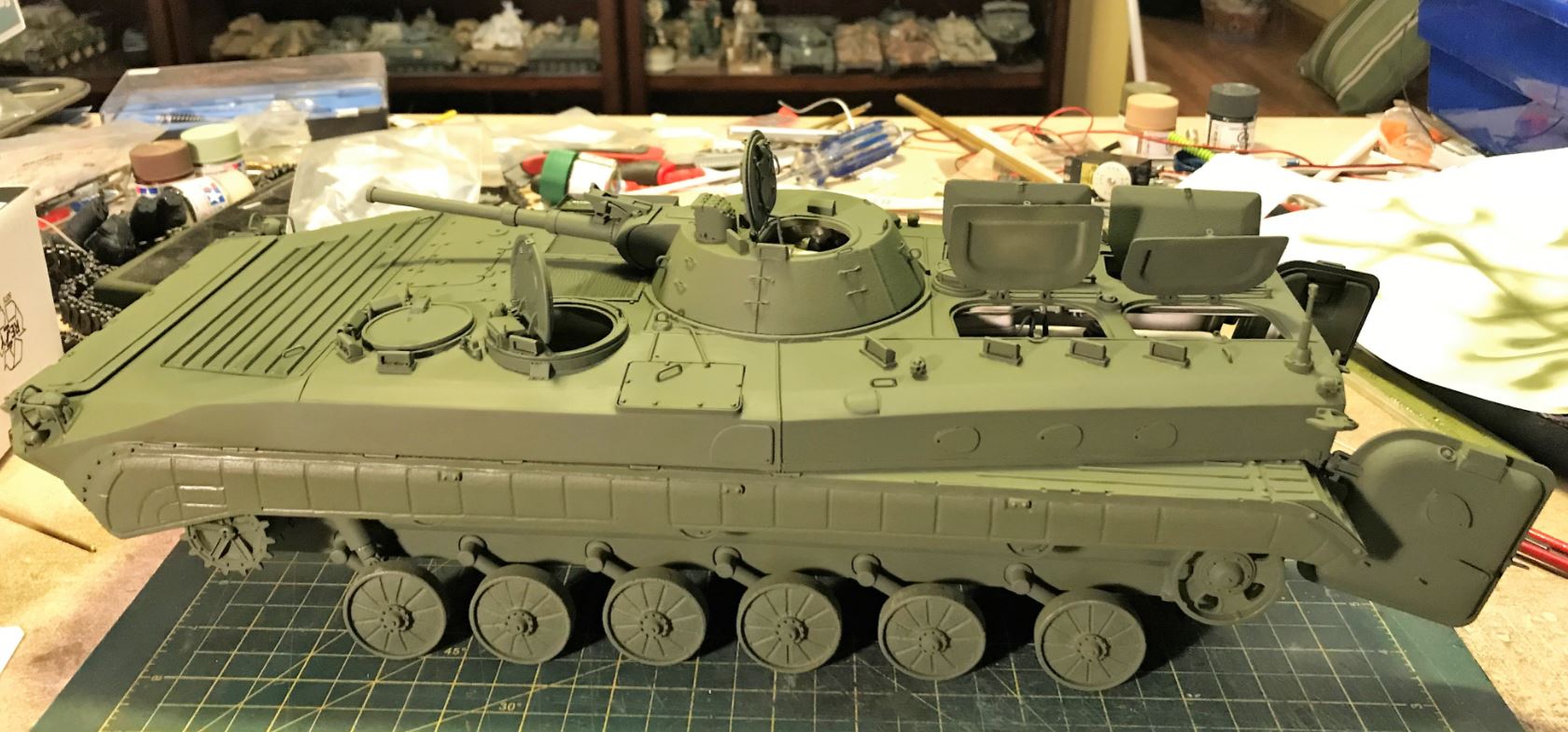

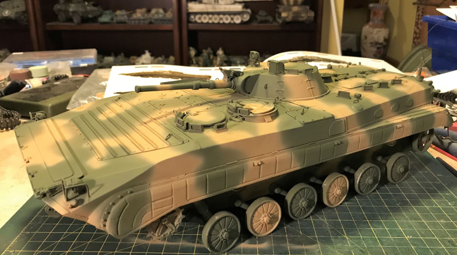

The model is then applied a coat of Tamiya Olive Green acrylic.

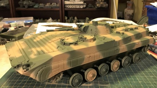

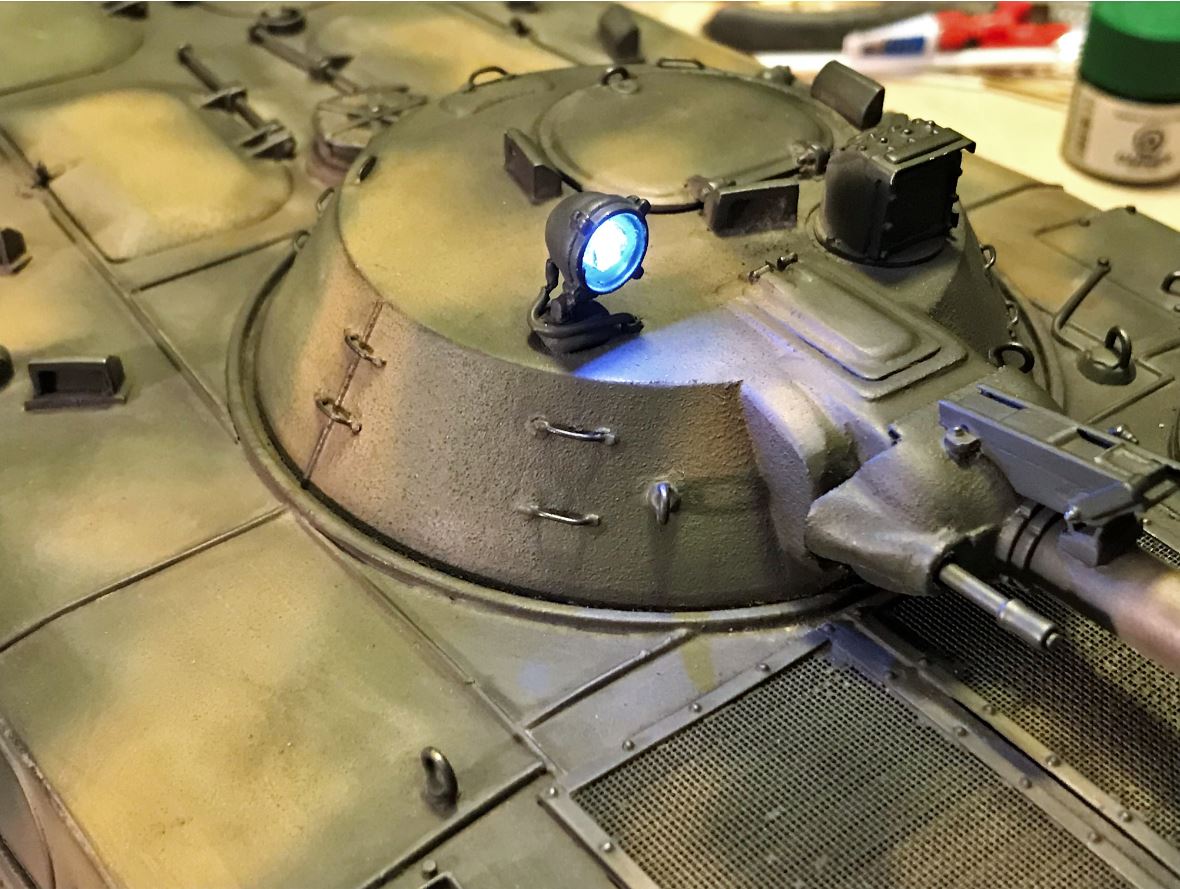

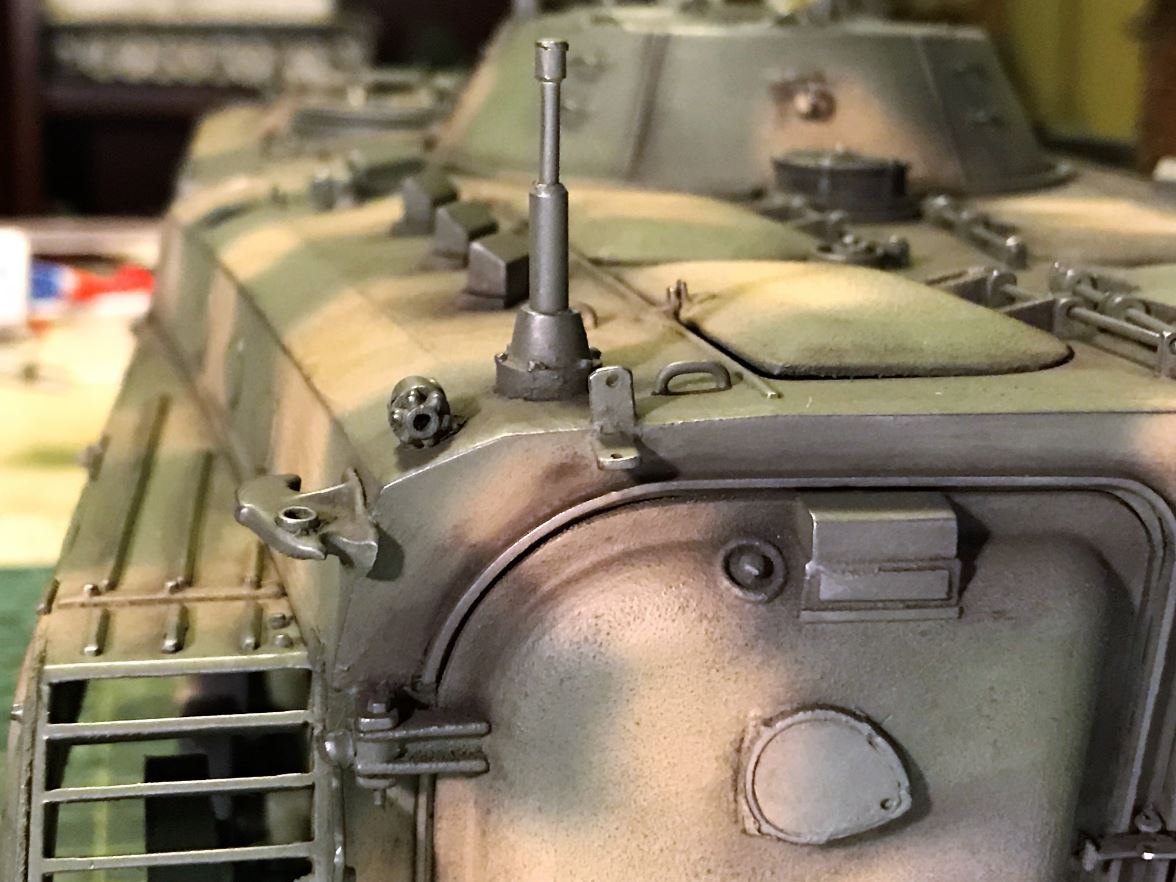

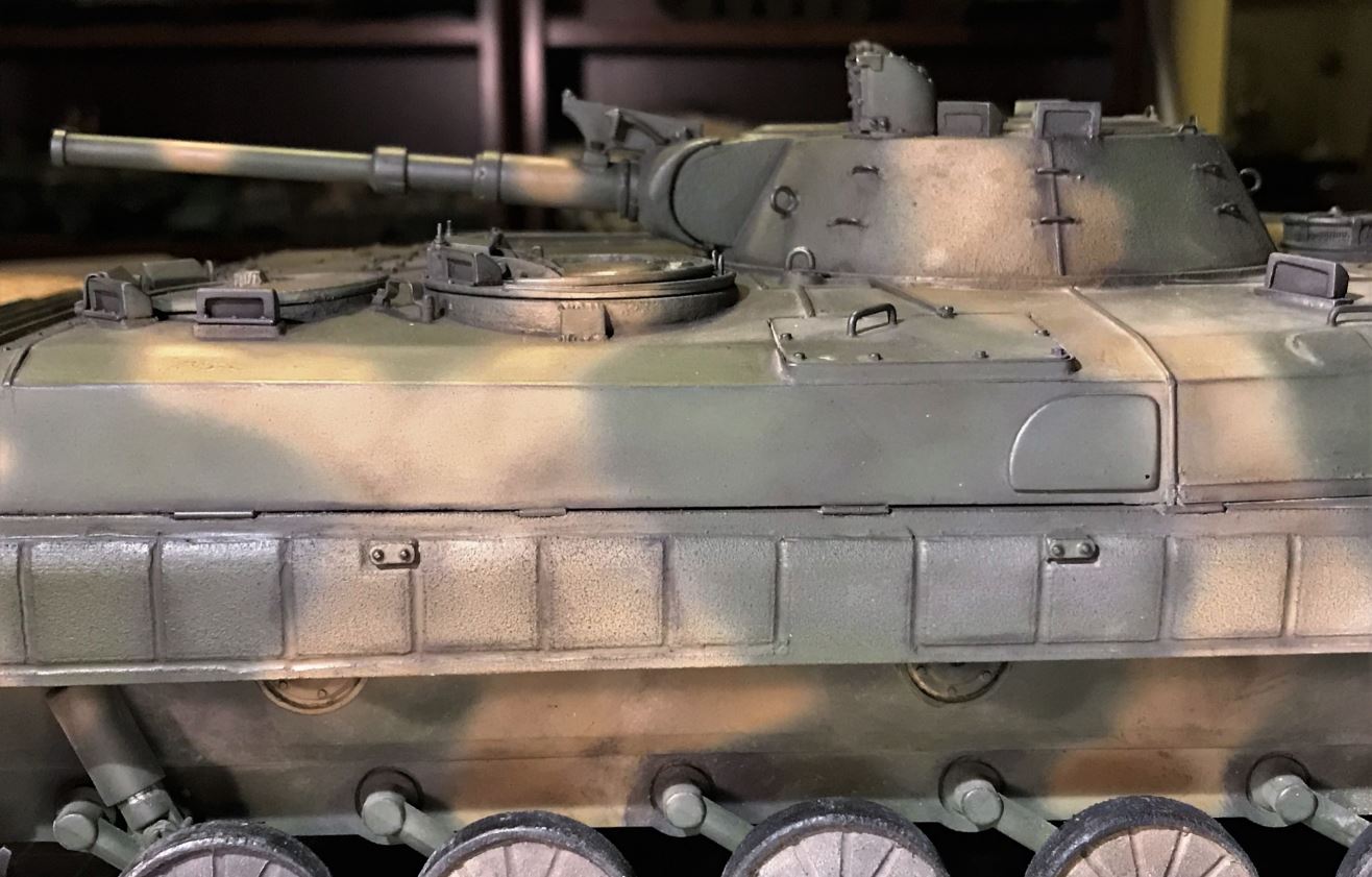

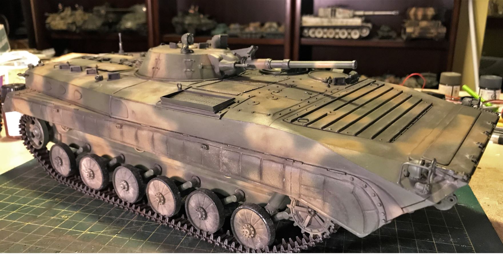

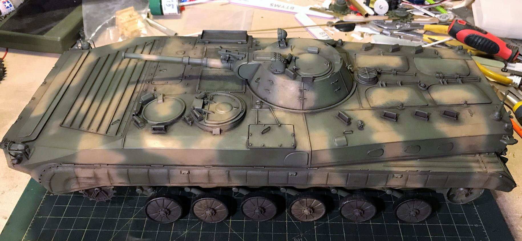

The camo is applied with a mixture of Tamiya Desert sand and Khaki acrylics,

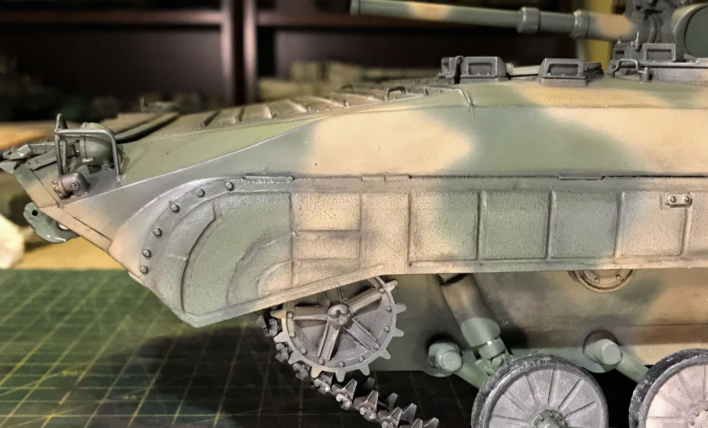

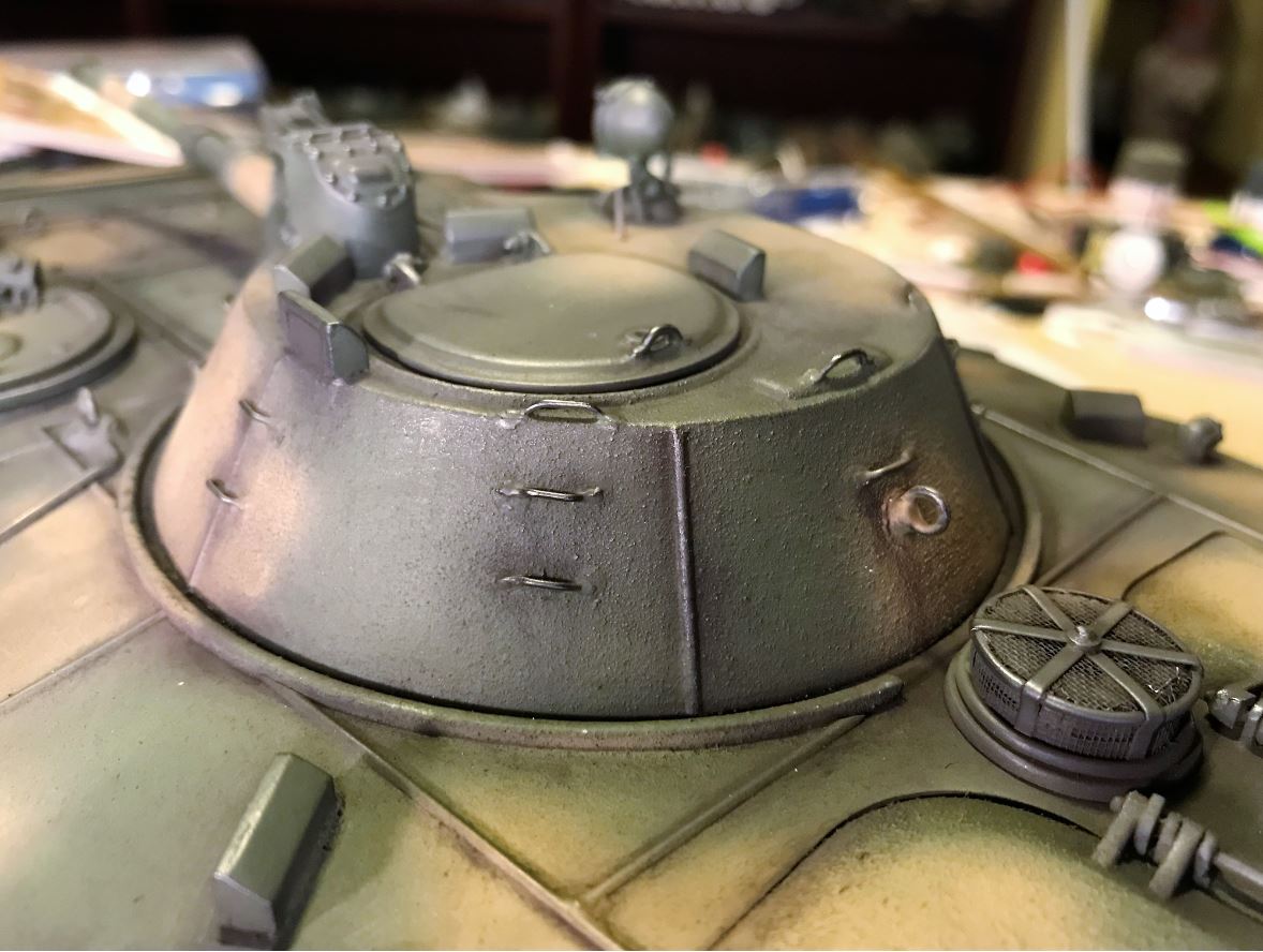

Black pigments are inserted into all the low corners.

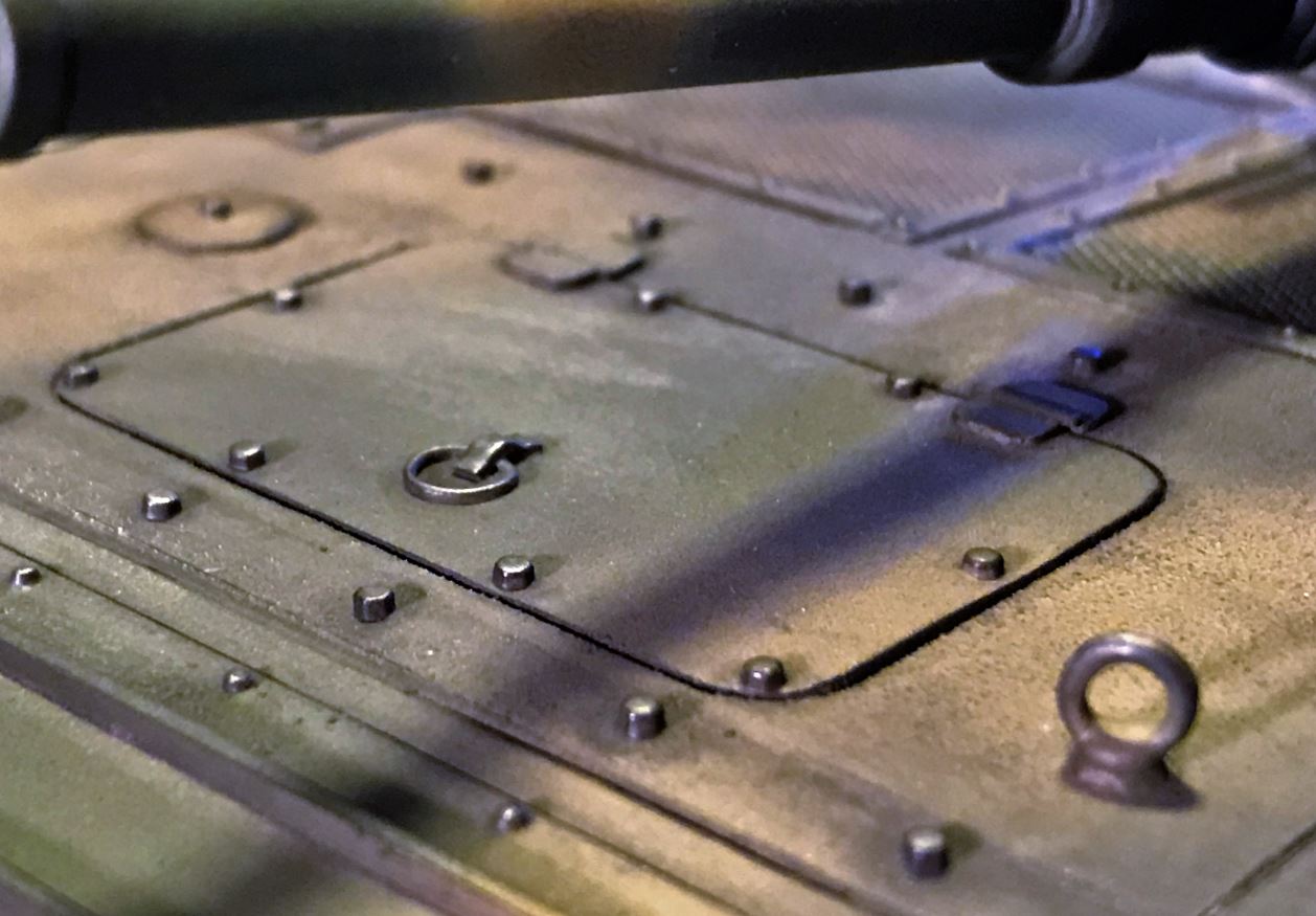

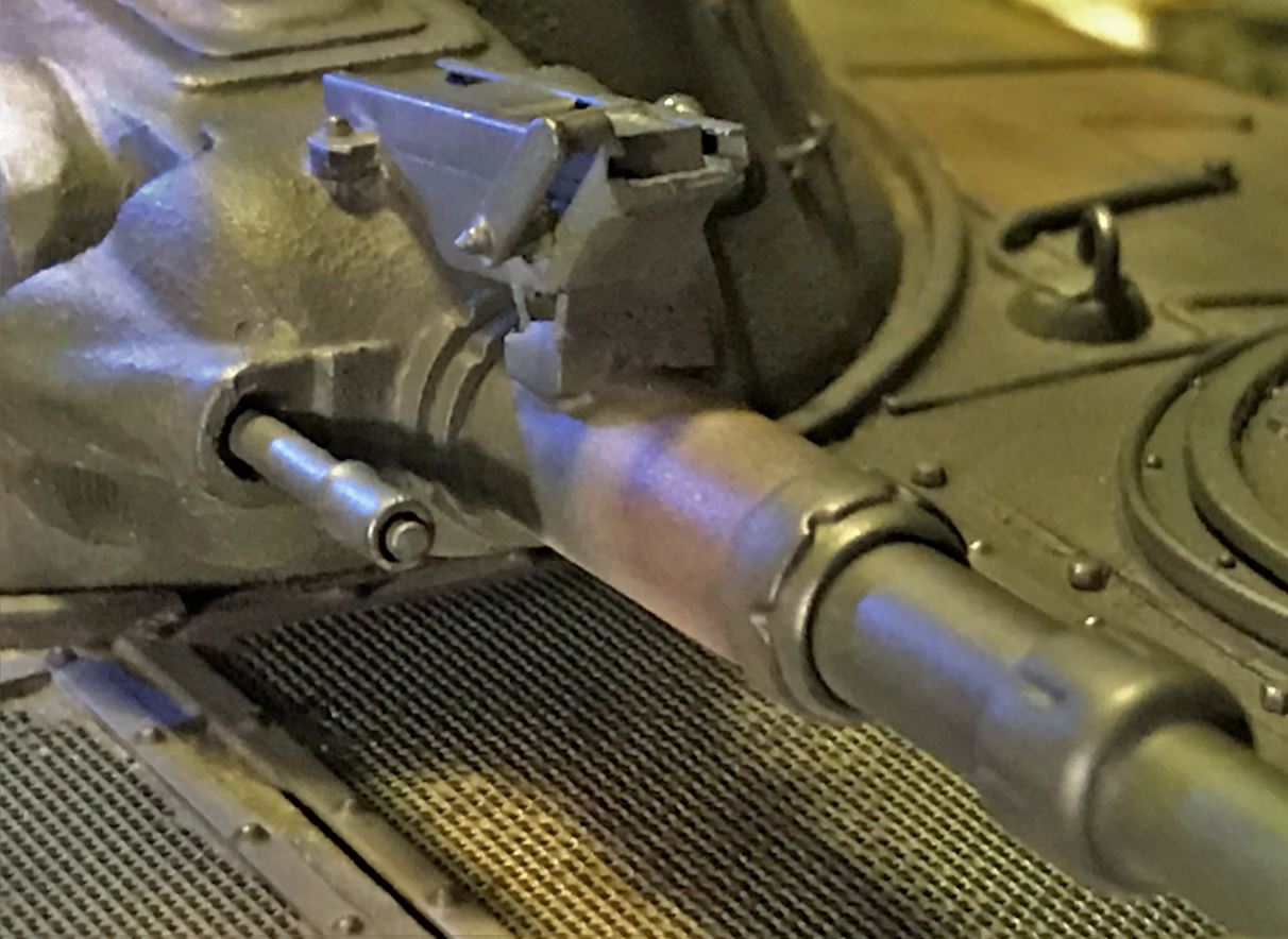

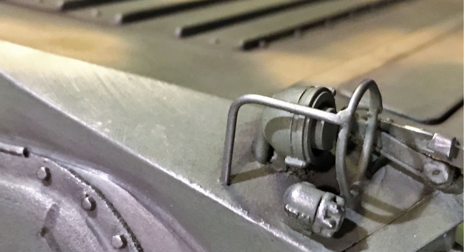

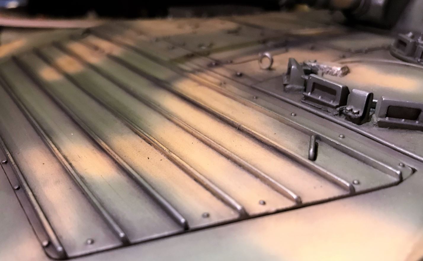

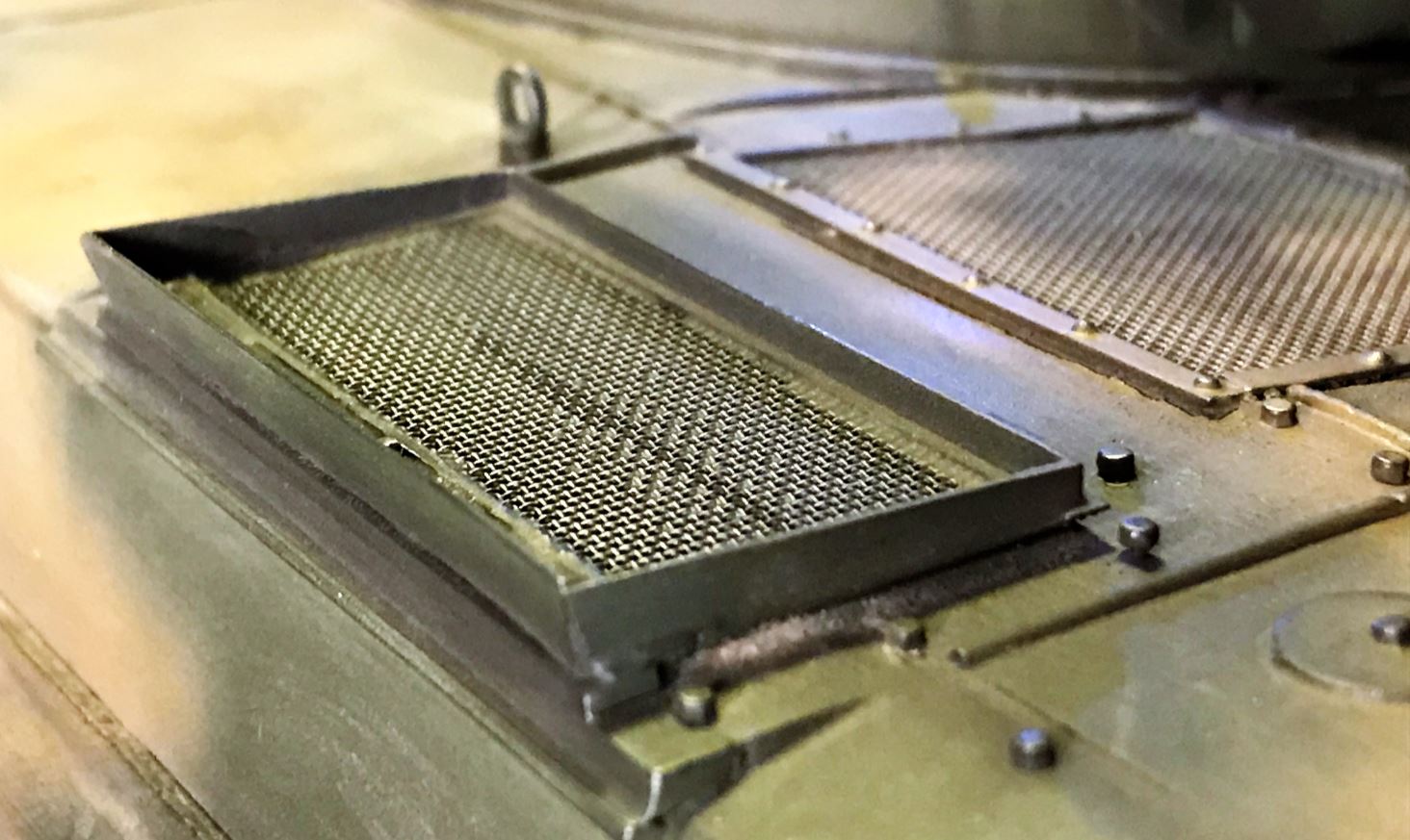

Dark Steel pigments are dry brushed to all raised corners. A coat of Pigment FIxer is then applied directly on the model to seal the pigments in place, and it also gives a satin look and feel that I like.

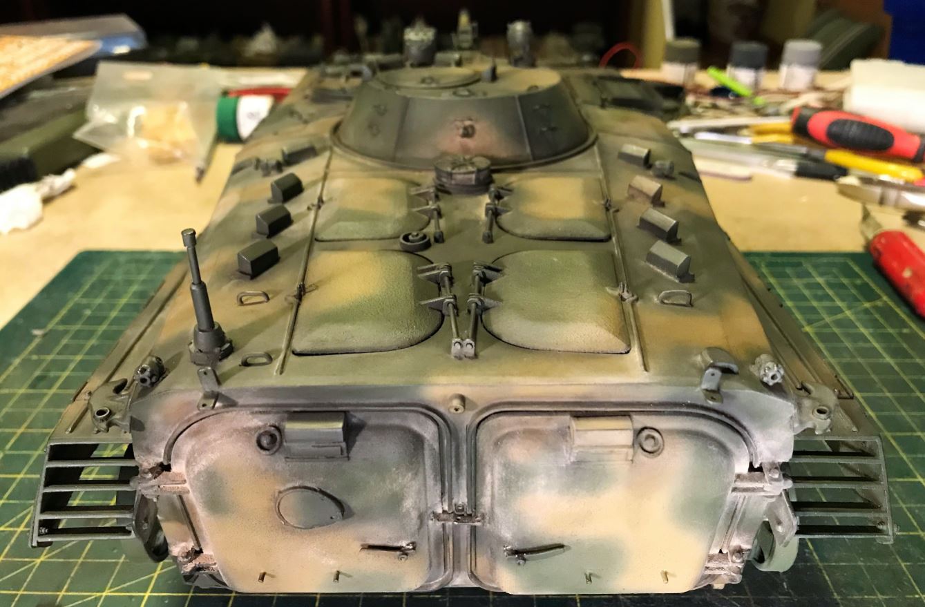

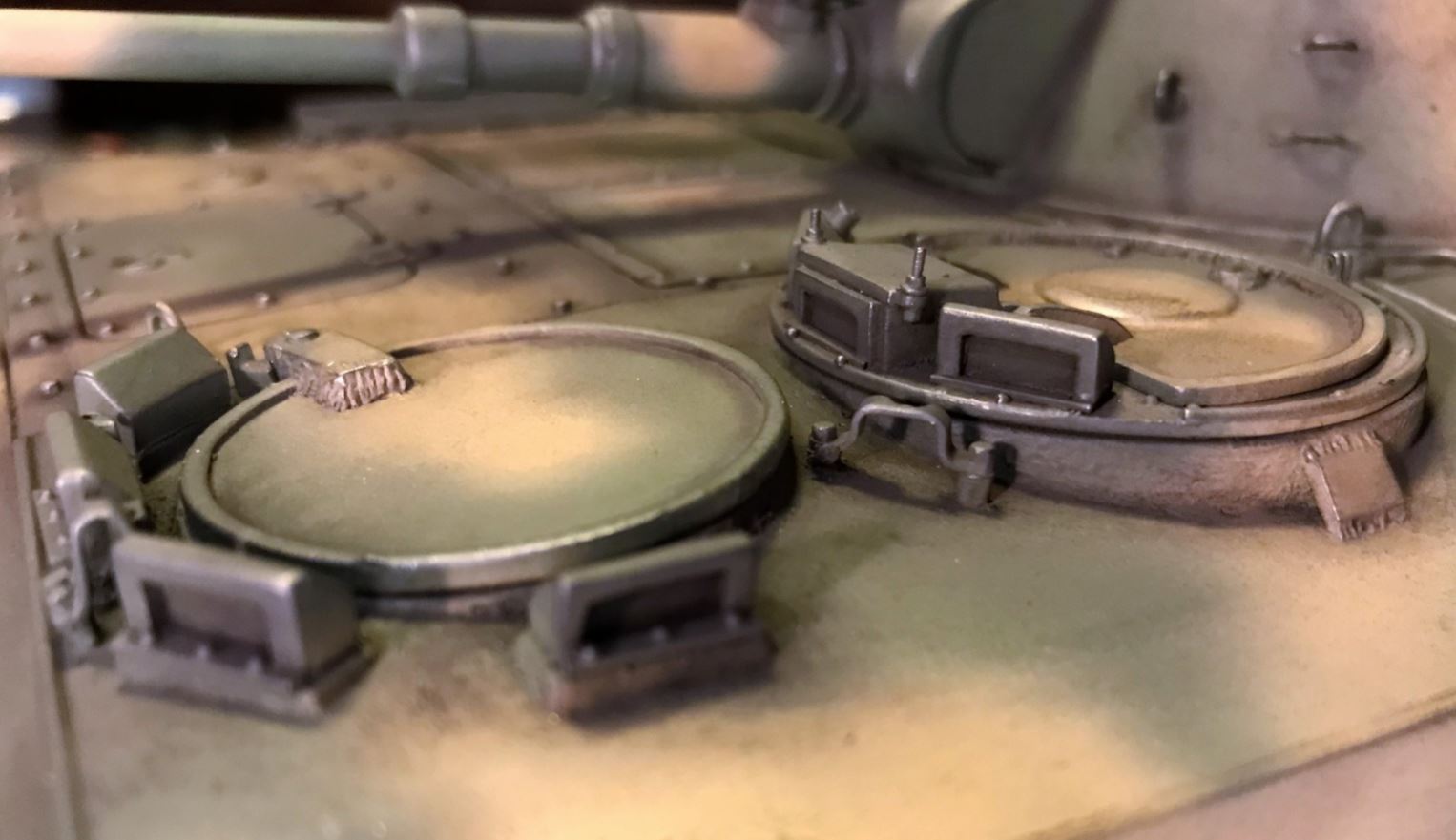

European Earth pigments are applied freely to the model. This will create a dust like finish to lighten the black pigments and represent a tank in action.

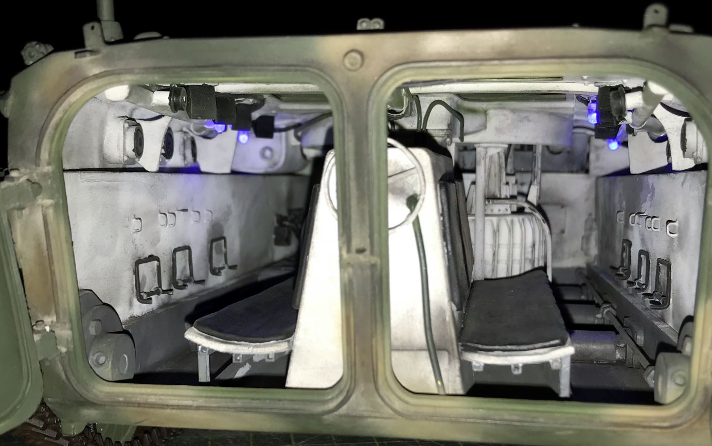

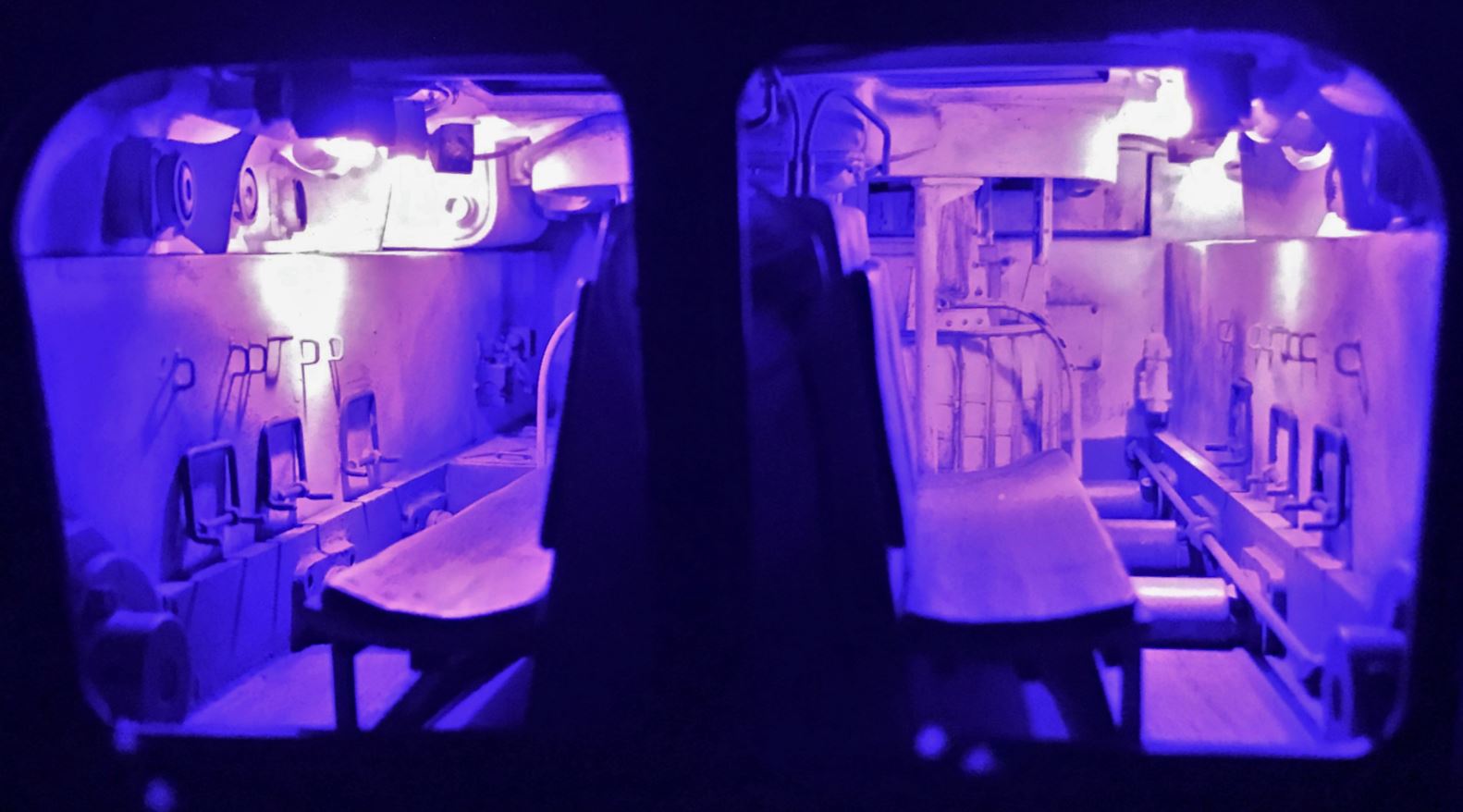

The interior has been finished in Tamiya flat white for the walls and roof, grey for the floor, and weathering with black pigments. I have seen many pictures of the turret basket in a colorful orange red. But I didn't know if this was for training purposes or also in the field. In the end, I decided against putting such color on my tank as I didn't think it looked good anyway.

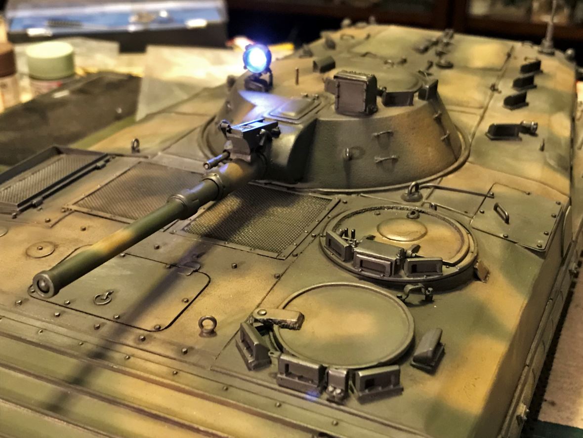

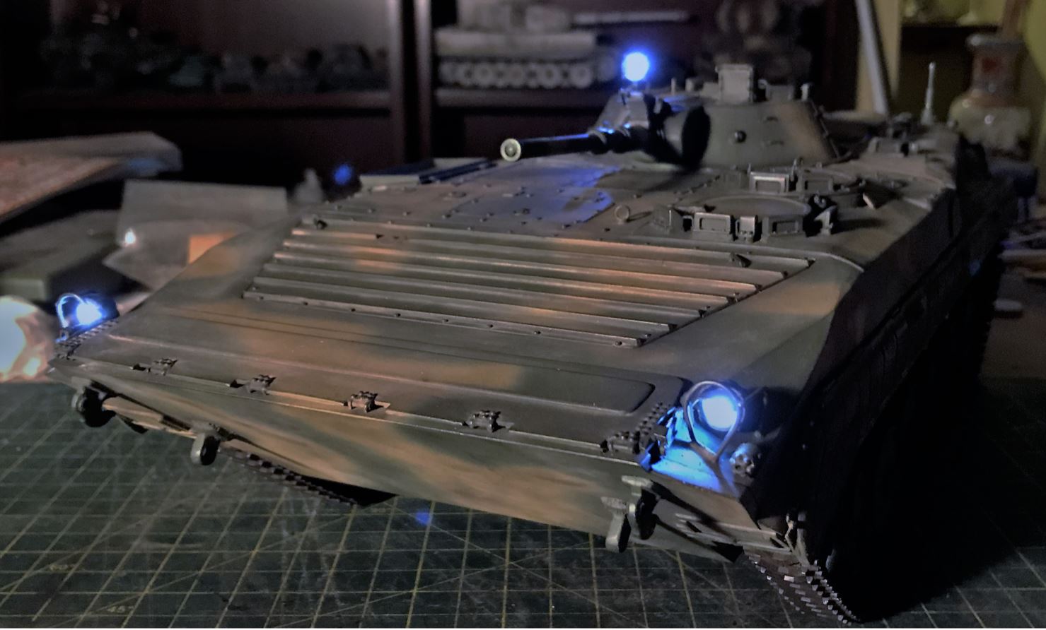

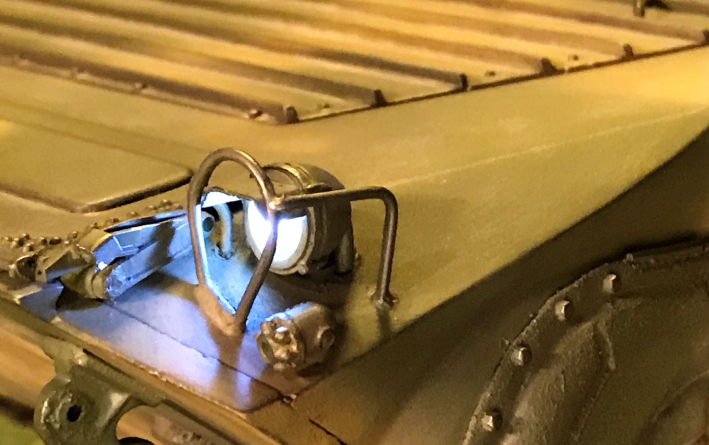

Turning on the lights.

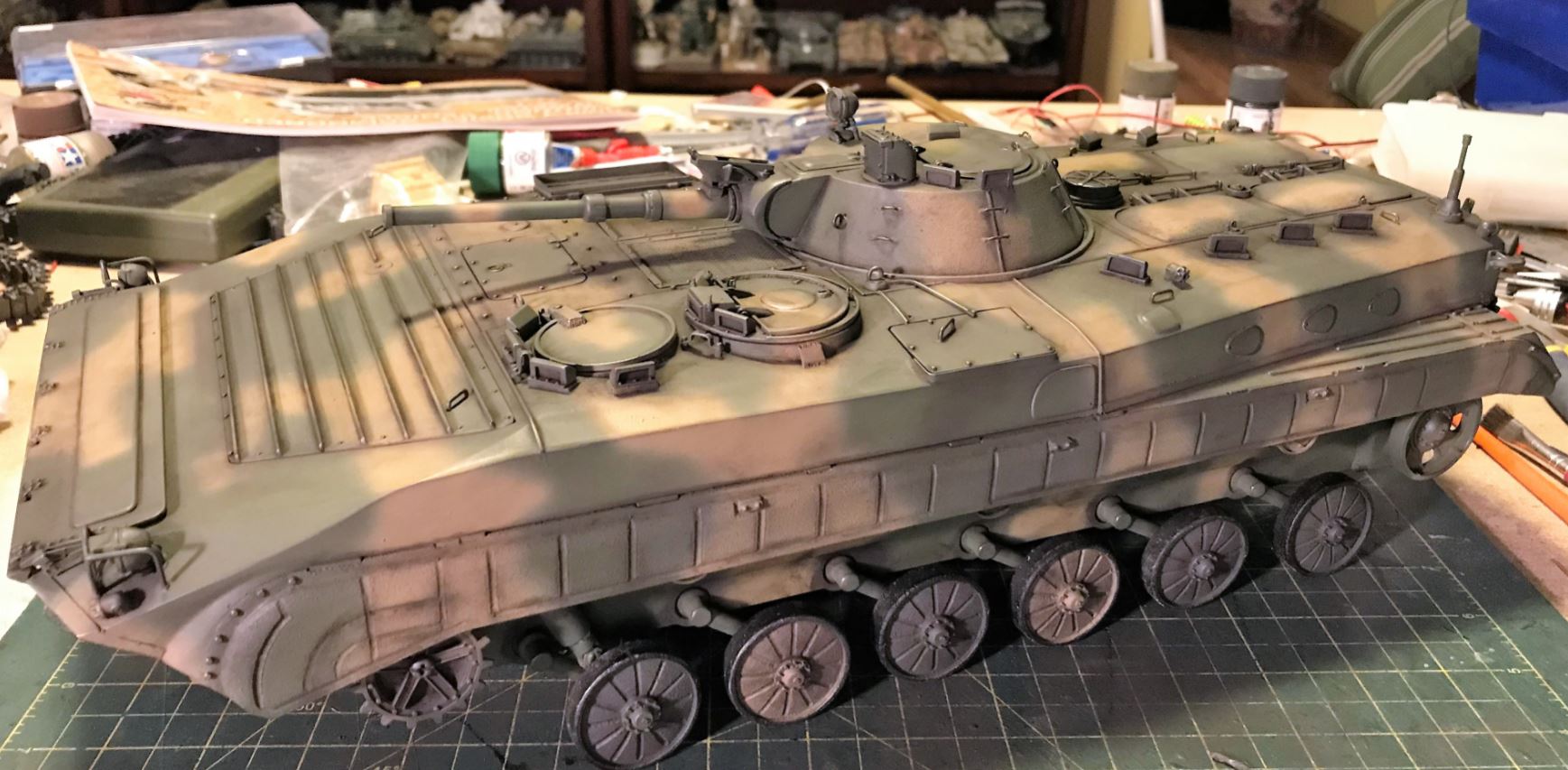

BMP-1 walk around

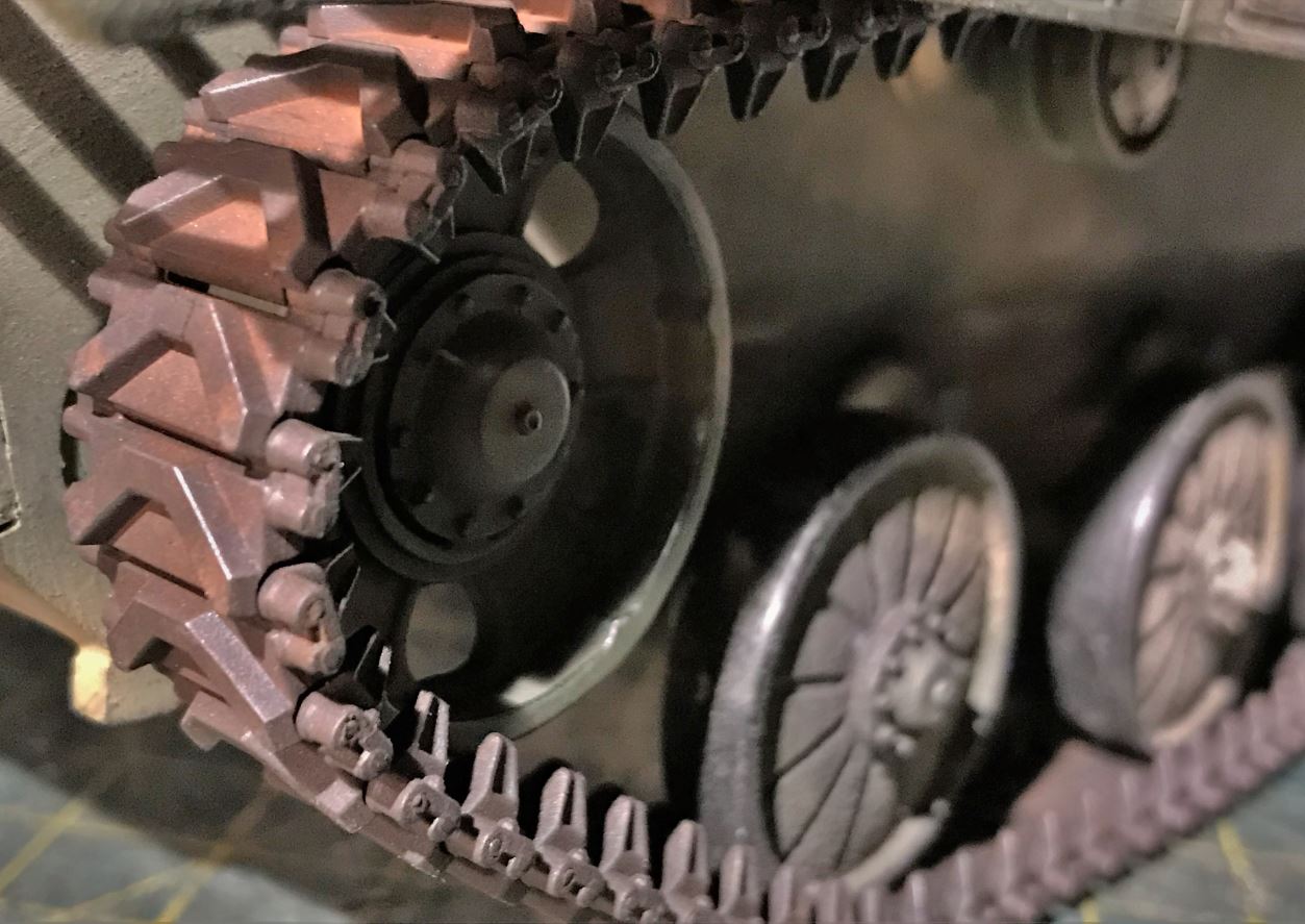

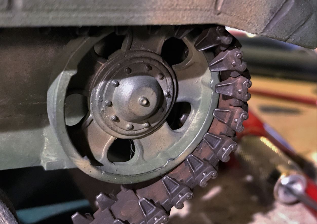

The 1/24 scale Sherman VS hard track are looking good. Although the chevron pattern is not authentic, there are few alternatives at this time. I am guessing that the upcoming Classy Hobby M5 Stuart in 1/16 scale could be an option for tracks and sprockets.
Tracks were painted flat black and given Track Rust pigments, then dry brushed with Dark Steel pigments
