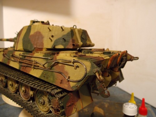

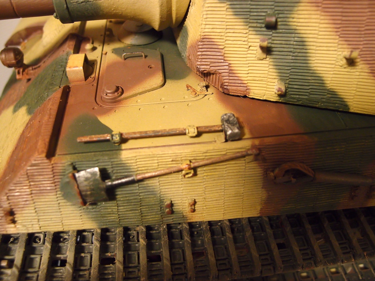

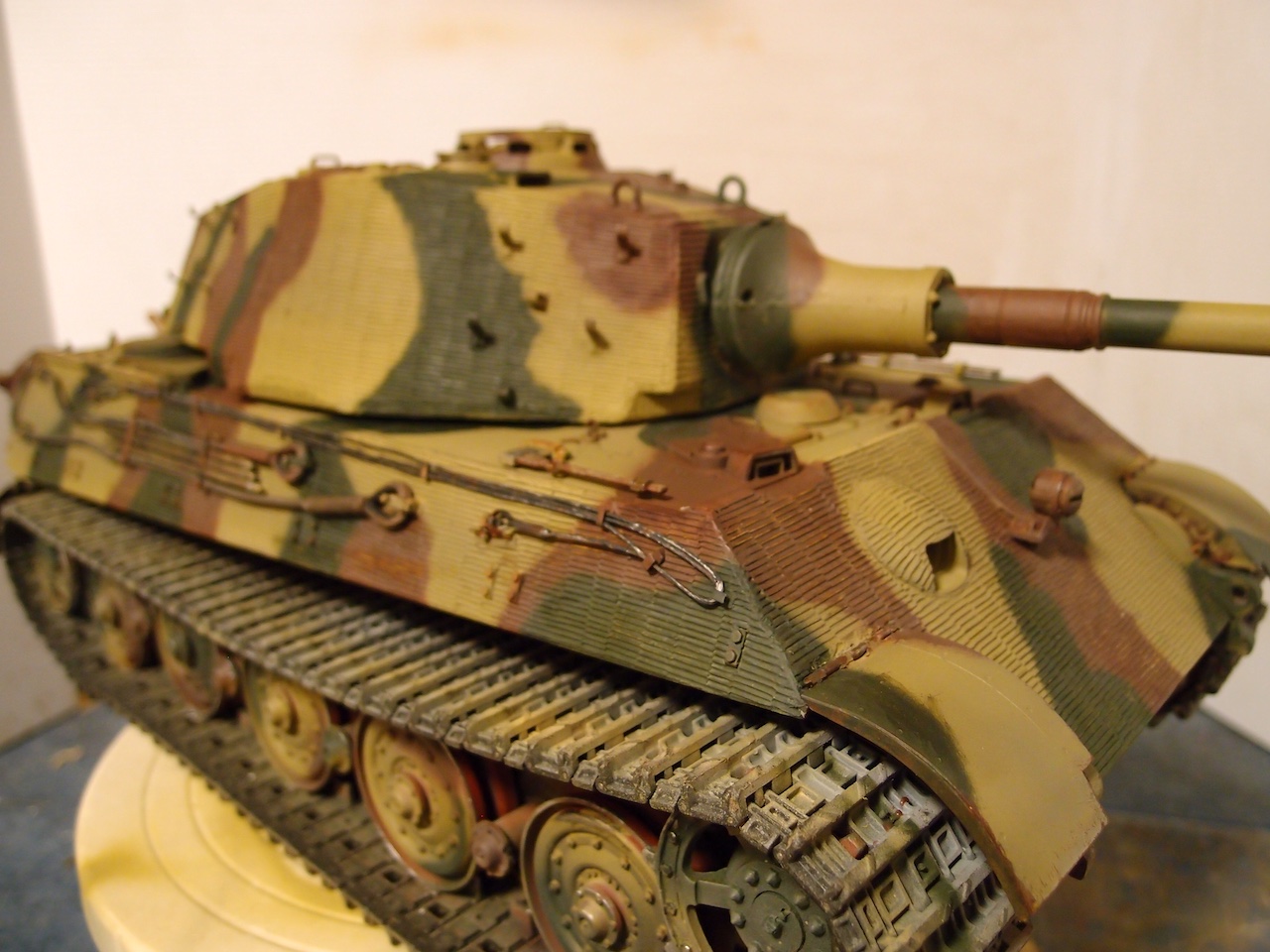

Tools and tow cables on , still looks sort of clean . Anther couple of dustings and black in all the nooks and crannies
Tools need a dusting
Next up the dreaded butterfly nuts
Posts: 11974
Re: 1st generation rc king tiger
Nice work. Your all over it

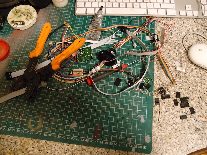

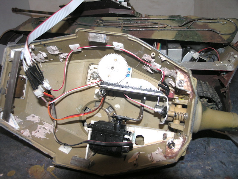

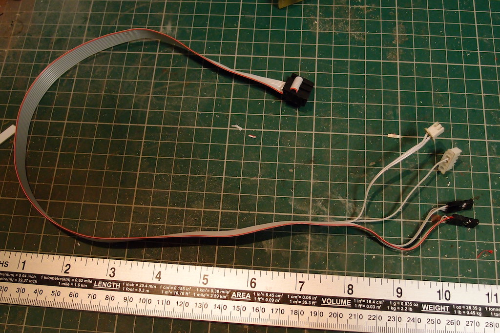

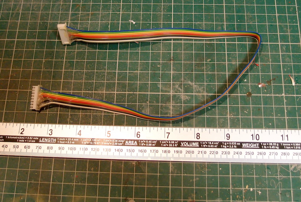

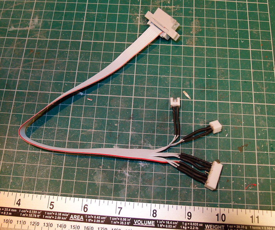

Thanks Herman and Soeren . Run out of paint so its time to fix some bust cables . Bought some computer cable with 10 way connectors , hope the ribbon cable is better than some of the junk thin wire stuff. Will do a proper rewire, just 3 plugs to pull if i want to take everything apart
Going to split the tank into 3 sections, lower hull to upper hull , lower hull to turret base as the turret ring is a 4 part assembly and turret base to upper turret .

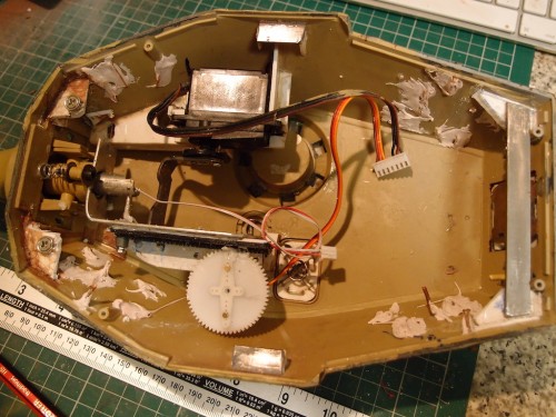

Lower hull tidied up no loose cables now
Both servos on a 7 pin connector

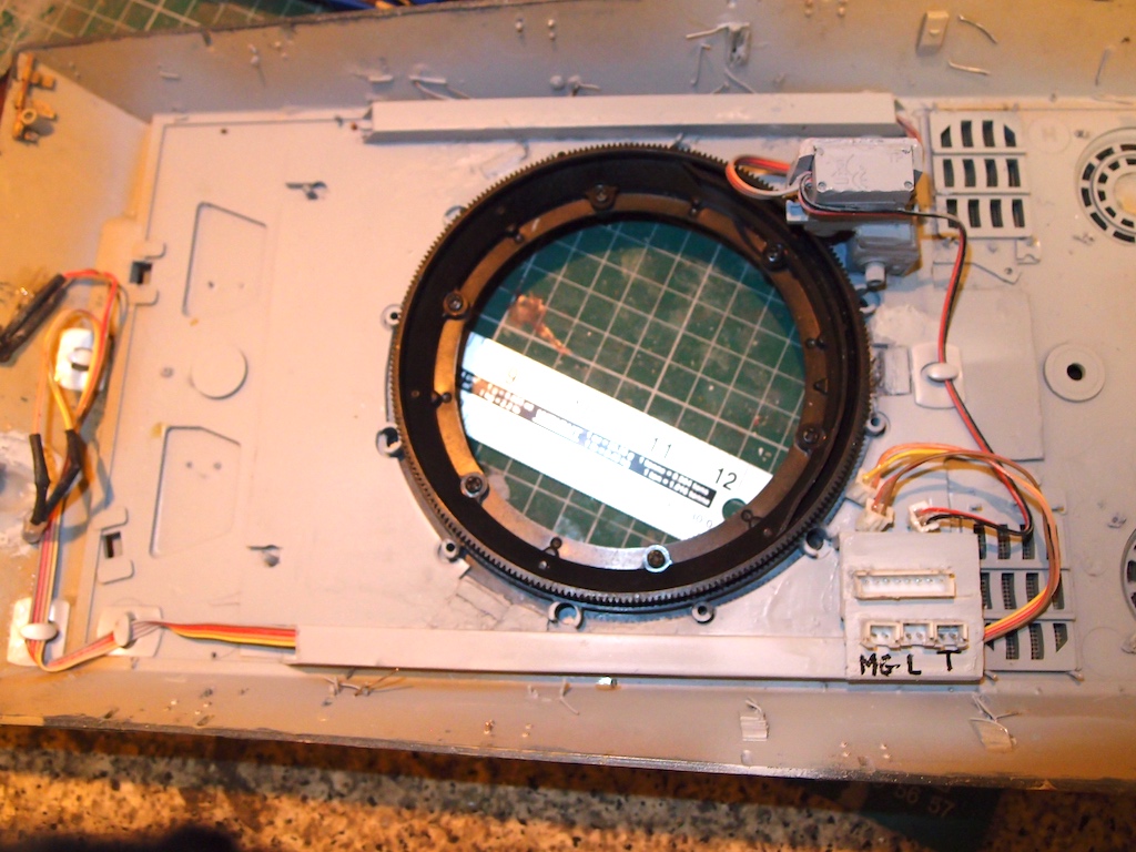

Socket for turret base to mg ,flash and servos
One plug for mg ,flash and servos.

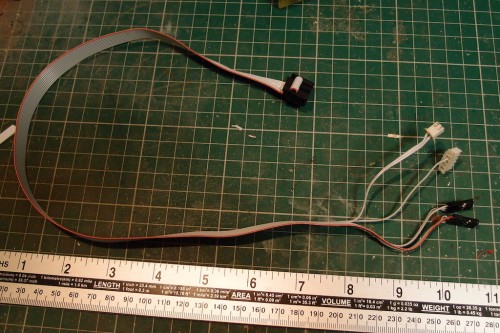

Need to buy more coloured ribbon cable, nice and long now
Making up long cables , why do they make them short.

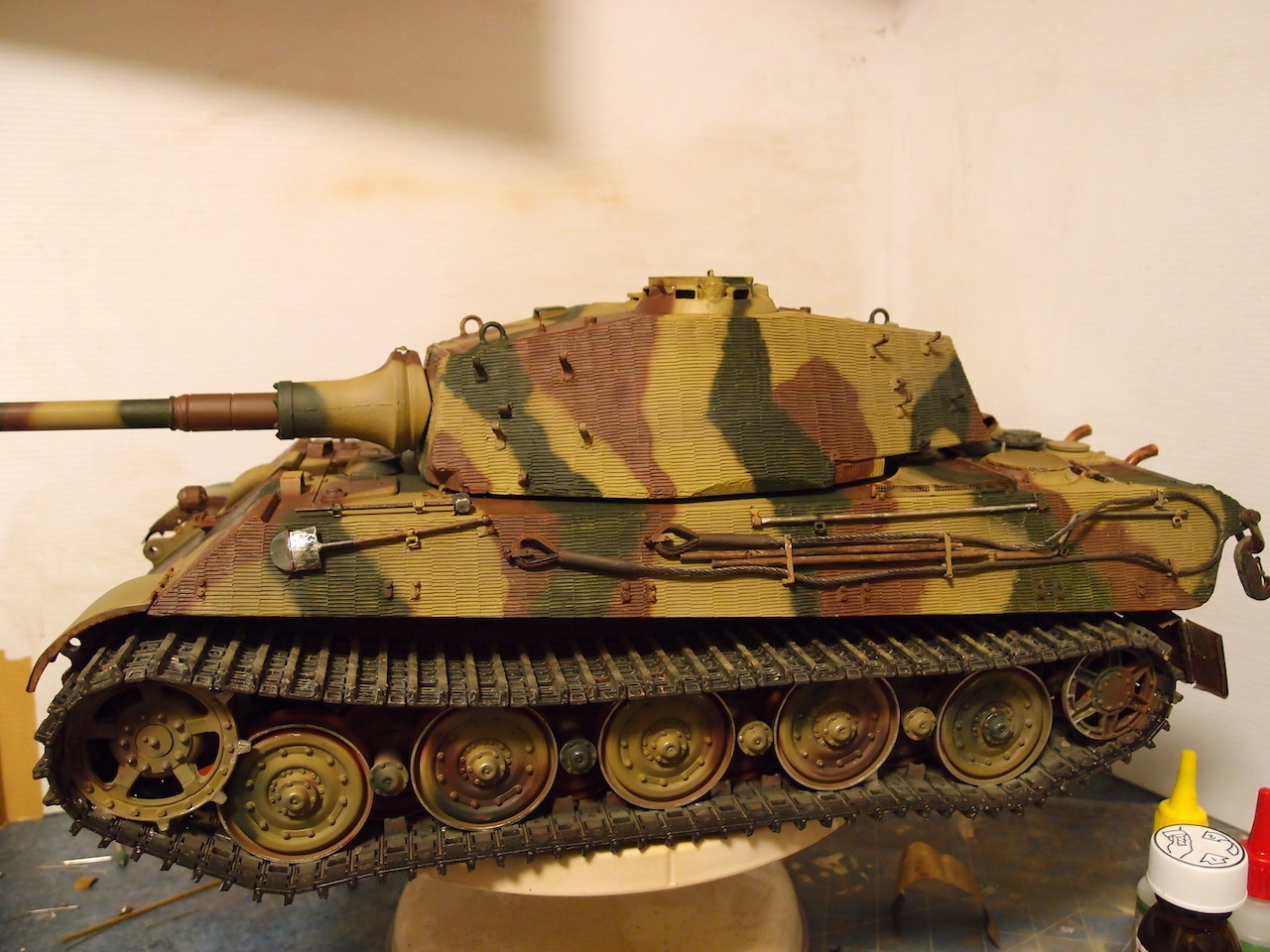

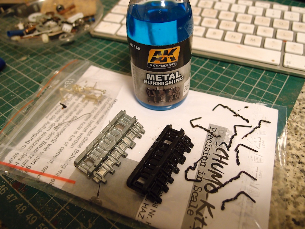

Trying out AK burnishing fluid on some brass and KT impact track links . Result
Silver Impact track links turned black and some Panther track pins .Tracks are still drying.

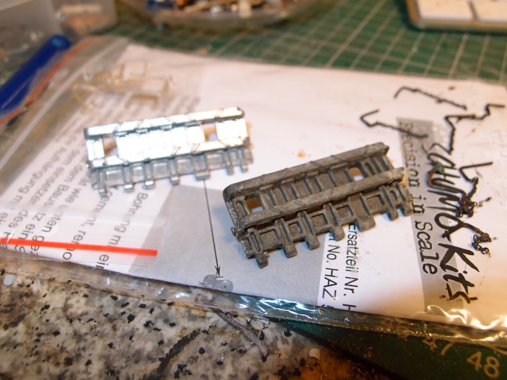

Thanks Eastern Front
Have tried AK on them , they are good to go now .A few hours and turns from black to a dirty grey with a hint of green colour. Will do your tip in reverse as the burnishing fluid won't work over paint , a few dabs of red oxide next.
Once its dry looks ok , red oxide dabs next.

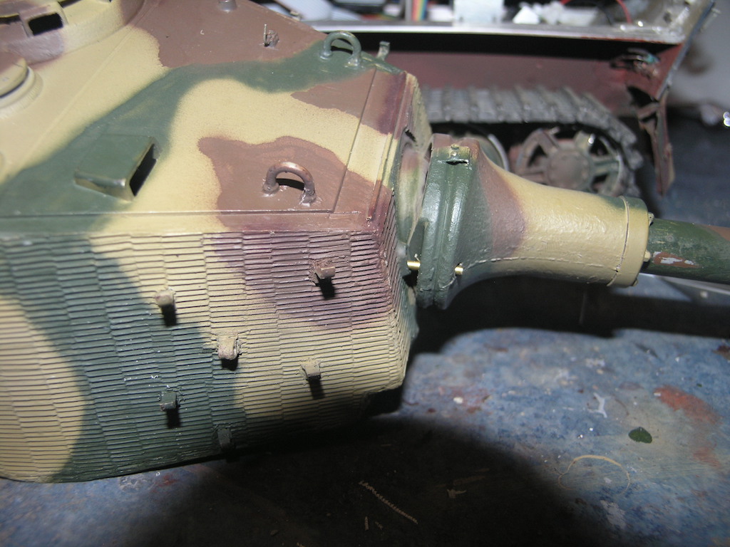

Fixing a couple of bits , Mg for turret a brass tube ,red led and a fibre optic in the tube. Don't like the barrel moving about , fitted 2 springs to stop movement
Mg
Mg
2 springs to balance gun
