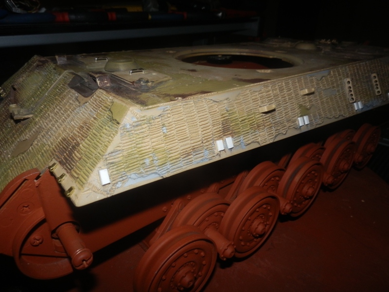

Cheers lads, it’s coming together finally.

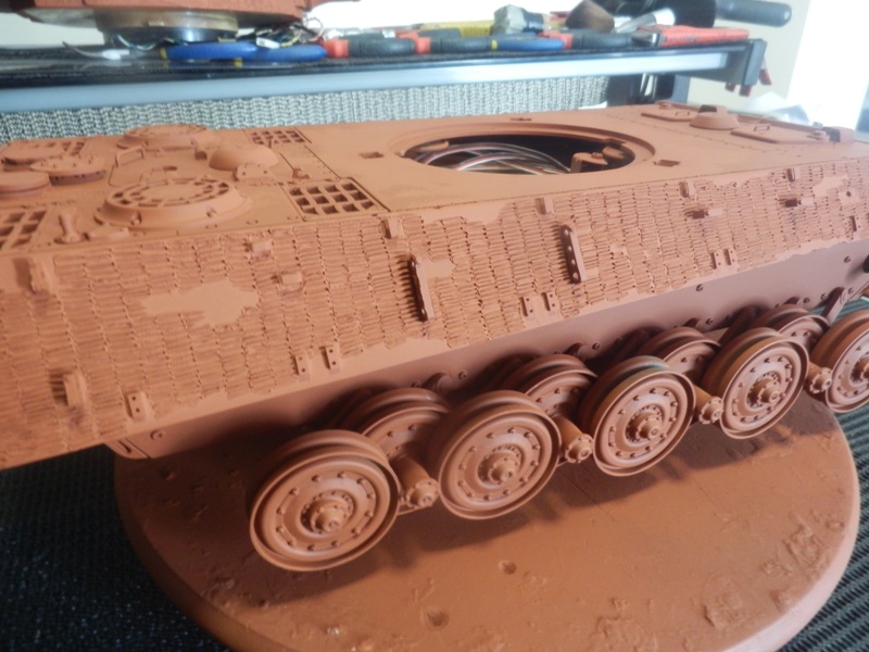

All accounts are that the KT series had zimmerit applied in the factory.
Tigers and other marques had some machines applied infield at rear area workshops.
Camo in the early KTs was applied over the factory base coat by both rear area teams and crews at the front , but late ones were all factory finished of course without zimmerit.

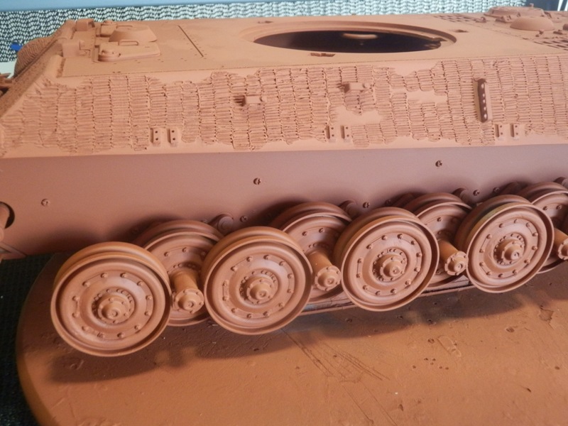

As for mine, a dings on the hull but none on the turret is plausible and likely for newer machines.

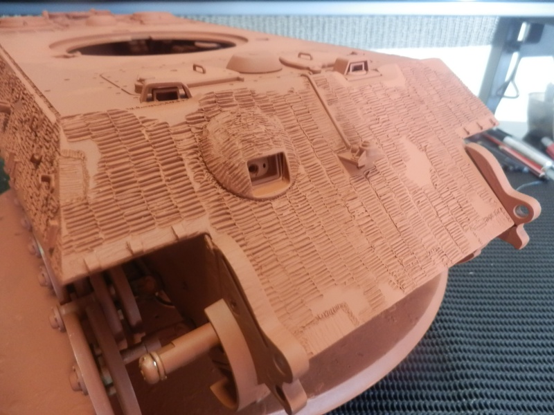

By applying the hot screwdriver to the surface and creating a raised texture, it’s easy to create the missing areas by tilting the top over on an edge then progressively increasing the contact until the patch is formed into full width zim lines .
I can tell you the hull MG ball was a challenge!
The middle bit is a bit rough but it’s ok over all.

Re: KING TIGER 211,506 S.PZ.ABT,GERONSWEILER,DEC '44
Well, I got a bit of that wrong then, but in my defence, I wasn't just thinking of king tigers. Would there be any likelihood that they applied zimmerit in the field in the early days of zimmerit to Tiger 1's that were already painted and marked?
Well, however you create your zimmerit on such thin plastic showing those obvious patches like it has been knocked off is truly impressive Herman :thumbup: :clap:
Posts: 11502
Absolutely there would be.
Early Tiger 1's did not have the coating, so it makes a very likely scenario that surviving early Tigers would have had the (at that time) new protection applied in the field by again-at the time- well supported and protected & supplied rear support groups, possibly over existing paint.
Cant see them grit-blasting the outside can you ?
The stuff however was very nasty and stuck like baby poo to your new car upholstery !!
It was also hardened by application of blow torches to the surface of it as it cured, leading to the myth that it was a source of ignition when hit by incoming rounds.

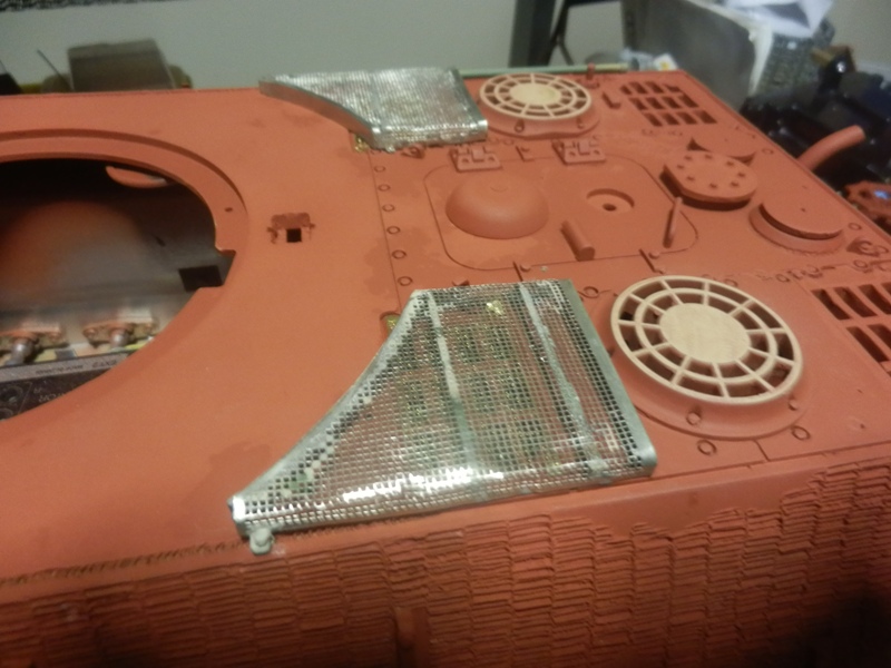

Drilled out the bolt holes on the mounting blocks.
Secured the C-hook clamps on the rear plate, secured the front mudguard mounts and then.........PrrrrIiiiimer :thumbup:
Now I can see all the icky-yukky blemishes left by the decorative accessories.
Deck vent mesh next, then electronics & base coat.

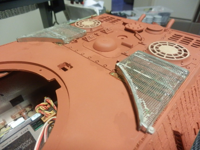

Remember these screens Mr Hugill ?? :eh:
Squashed flat in the bag of stuff they were .
Resurrected to fight on.
Lots of scraping and use of a stainless wire brush to remove as much old paint & glue as possible.
Not perfect, but thats in character with the rest of it.
Im using a set of Taigen vent screens which work, and the salvaged grenade screens just to give a better representation of a King Tiger of its series.
Ive got to fit the new receiver into the Tamiya electronics shortly and then its time for base coat & camo.
