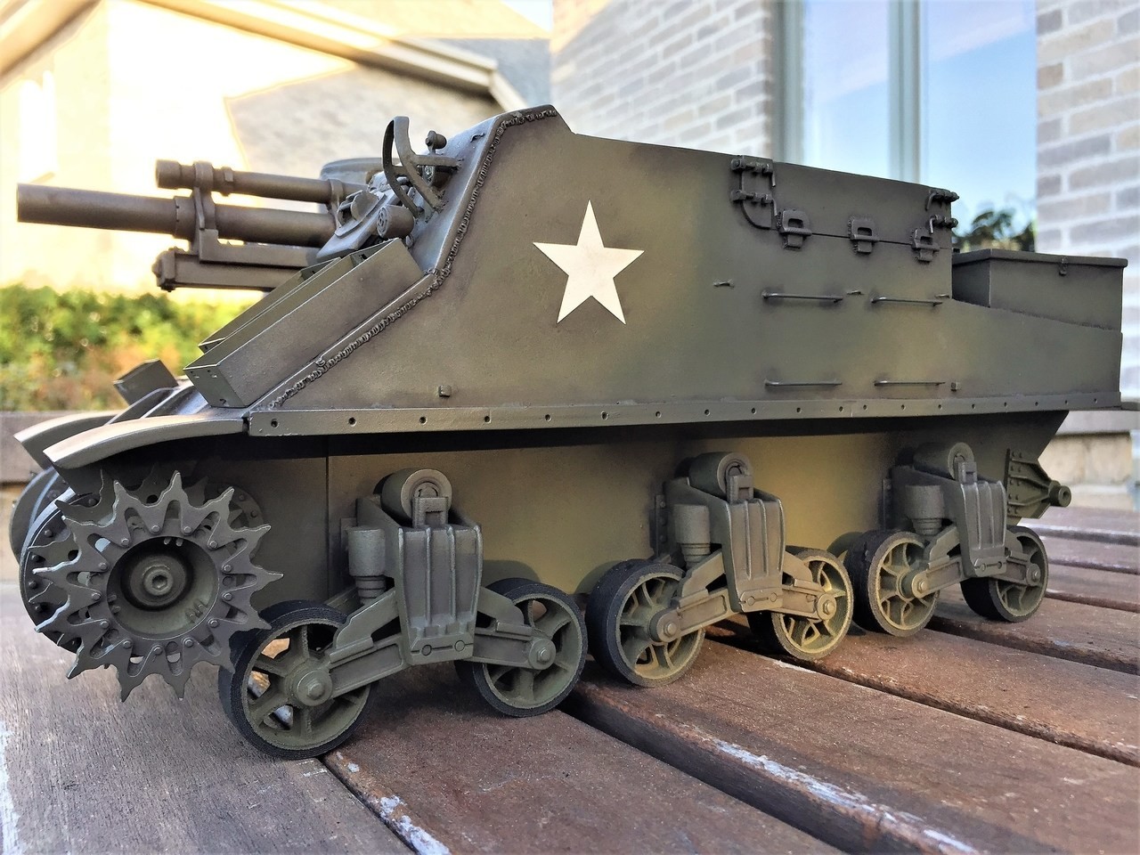

Louis I am so impressed with this model. Your hard work is really paying off. It looks fantastic The paint is outstanding
Super job

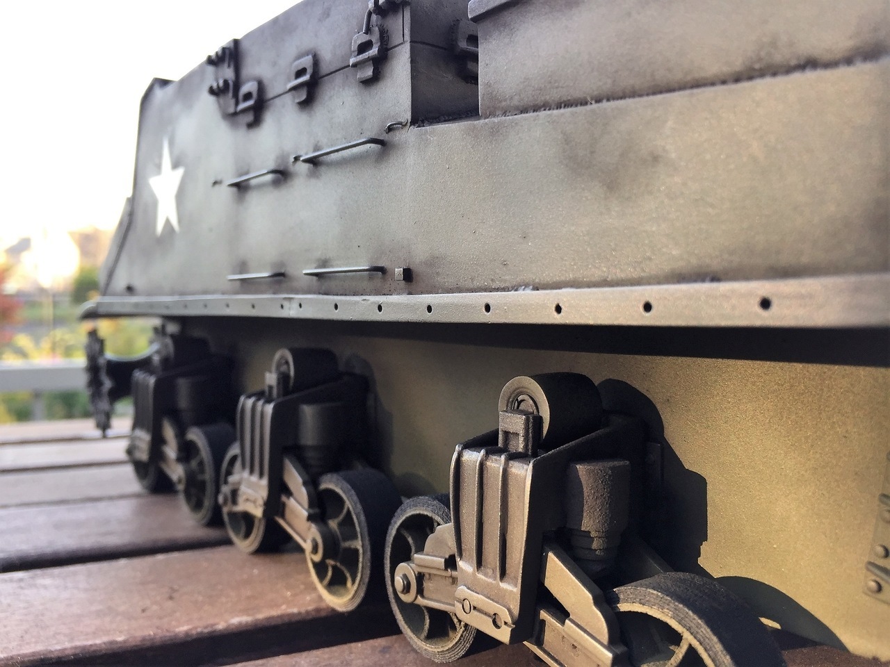

Here are a couple of close up pictures of the finished Shapeways M3 "look alike" early suspension. Lots of efforts, modifications, sanding and polishing were required for the integration and for my personal taste but I am very satisfied with the end results.
M3 Shapeways suspension
Regards, Louis

Such a realistic looking machine. I see you have used your amazing subtle weathering techniques again and have brought this model to life.
The suspension looks excellent Louis
You are also quite a photographer
Re: Vandra M7 Priest SP Howitzer conversion build
Thanks Carl,
After polishing this thing for 2 months now, I do not dare put any dirt on it, or risk a weathering fiasco. I'm keeping it safe. I have ruined enough kits in the past to know my limits in that area. Let's say it just landed in Normandy...

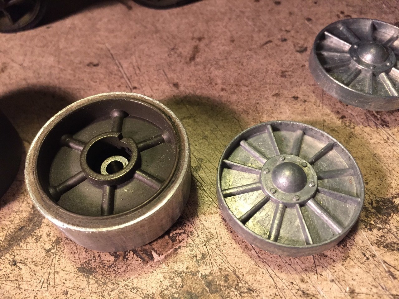

I see the Mato sprockets fitted. Are you using the stock idler mounts or the upgraded tensioner adjuster system? I say this because after fitting the Mato tracks on the Lee I find I need the adjustment to make the tacks fit as needed. Well done

Hi Carl, I have not received the Mato tensioner adjuster yet from Asia, it will be installed once I get it. The Mato tracks are loose but become too tight if I remove one link. The tracks are wider than the Heng Long so I hope this will not cause issues with the narrower road wheels. Otherwise, it will be Heng Long tracks to run, and Mato for display...

I run 'Maxene' with Mato tracks, sprockets and a modded HL\Mato idler set. I had issues using the HL road wheels and idlers with the wider Mato tracks until I used Mikes Idler fix. You using the Mato idlers will achieve the same effect as the 'fix' and allow you smooth operation of all the running gear. I am soundly impressed by your build on this kit. It is a benchmark for any future resin kits that I build ( an M10 is on the list for next Spring )

PainlessWolf wrote:You using the Mato idlers will achieve the same effect as the 'fix' and allow you smooth operation of all the running gear
Thank you Painless for your experience, I agree and with that in mind and while still waiting for the idler tensioner, I decided to replicate something I saw somewhere using the Mato idlers. As I do not like their non authentic center section, I created a new cap from the Heng long idler and fitter it to the Mato wheel. Although it is not the poked model I initially wanted, I saw reference picture with poked road wheels and non poked idlers. In any cases, it is realistic that road wheel get replaced and types get mixed. Now, I hope I won't get any bad surprises with that Mato adjustable tensioner... In any cases, there is always a solution.

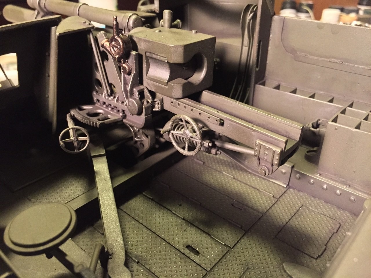

The gun is installed and details are being added. However, I did not like the look of the Shapeways hand wheels (right) and I started to replace them by metal hand wheels ordered from ebay seller Dioramaparts, see the one on the left. I think metal hand wheel look better and more authentic. I will replace the other two by metal ones of similar size. I find that 3D printing is not the solution for everything. Doing these small upgrades are for fun... upgrading the upgrade kit of a conversion kit...
M7 Priest with Shapeways details
Regards, Louis
