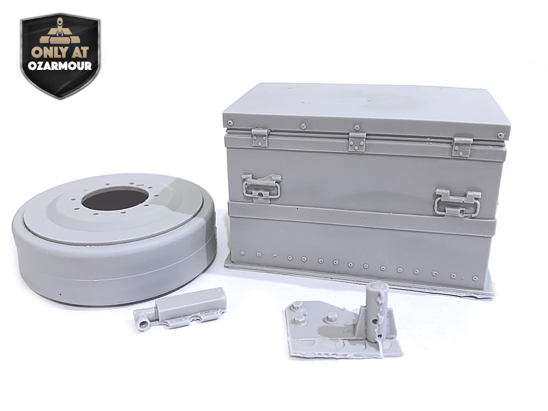

Ended up buying a new 7.0 BB mechanism from OZarmour (super quick postage got it in 3 days!) plus some resin fittings (20l water jerry can, OZ fridge for rear bustle rack, umbrella stand, power box and spare roadwheel), plus some plugs for the lights.
Fitted the BB unit last night to test it and after some button pushing it works!!
Now I need fit the new solid front idler axle slightly further fwd to get correct track tension....thinking of making an adjustable set of internal brackets to alter track tension.
Here is a pic of the resin goodies... none of anything else cause my phone camera has karked it....

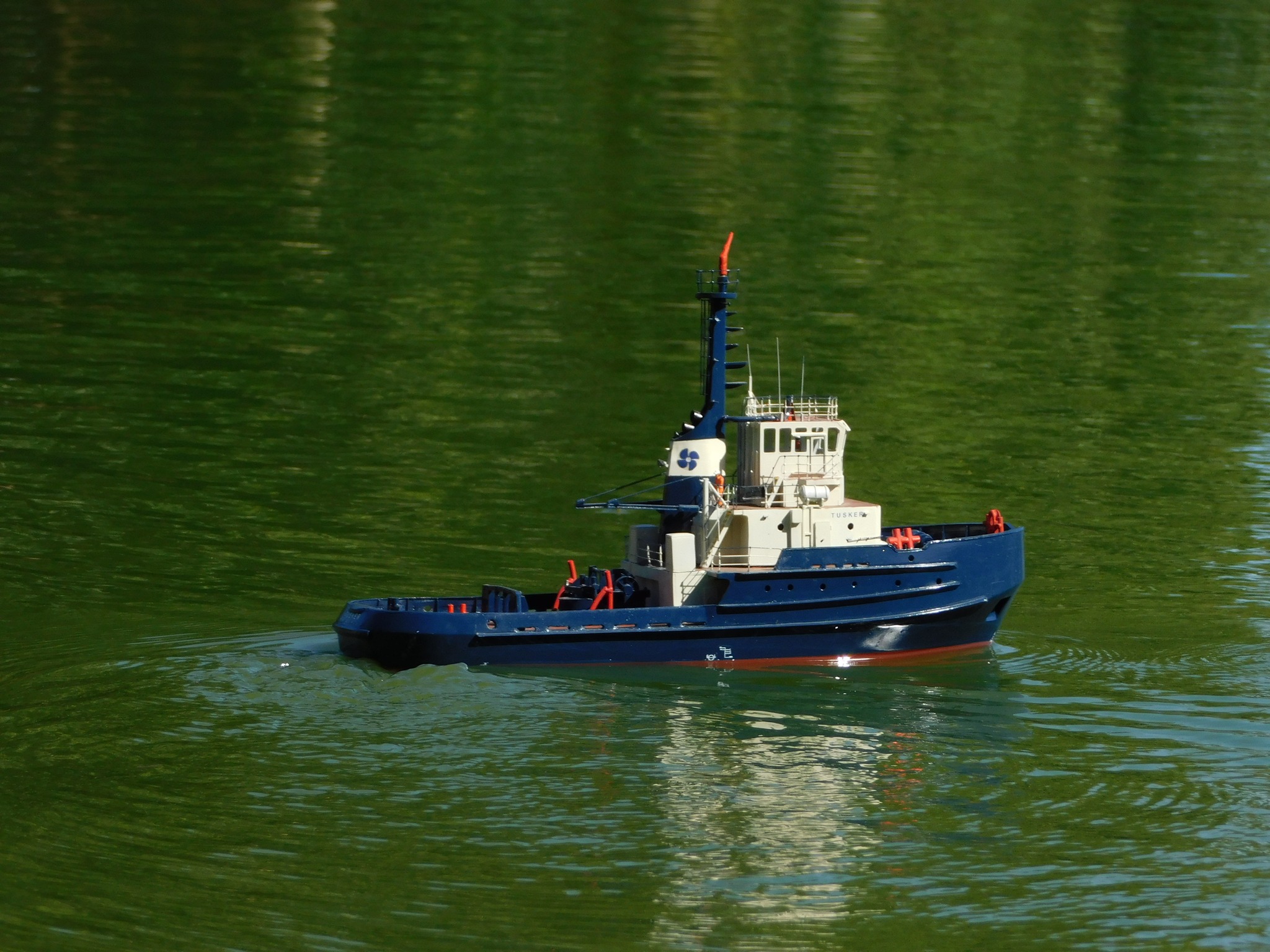

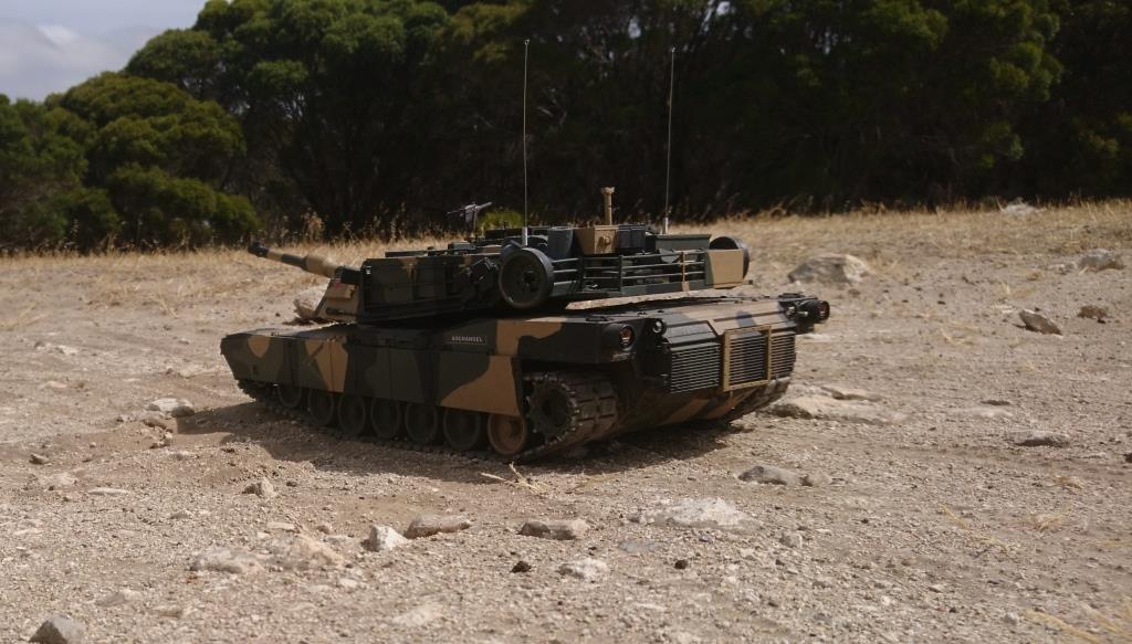

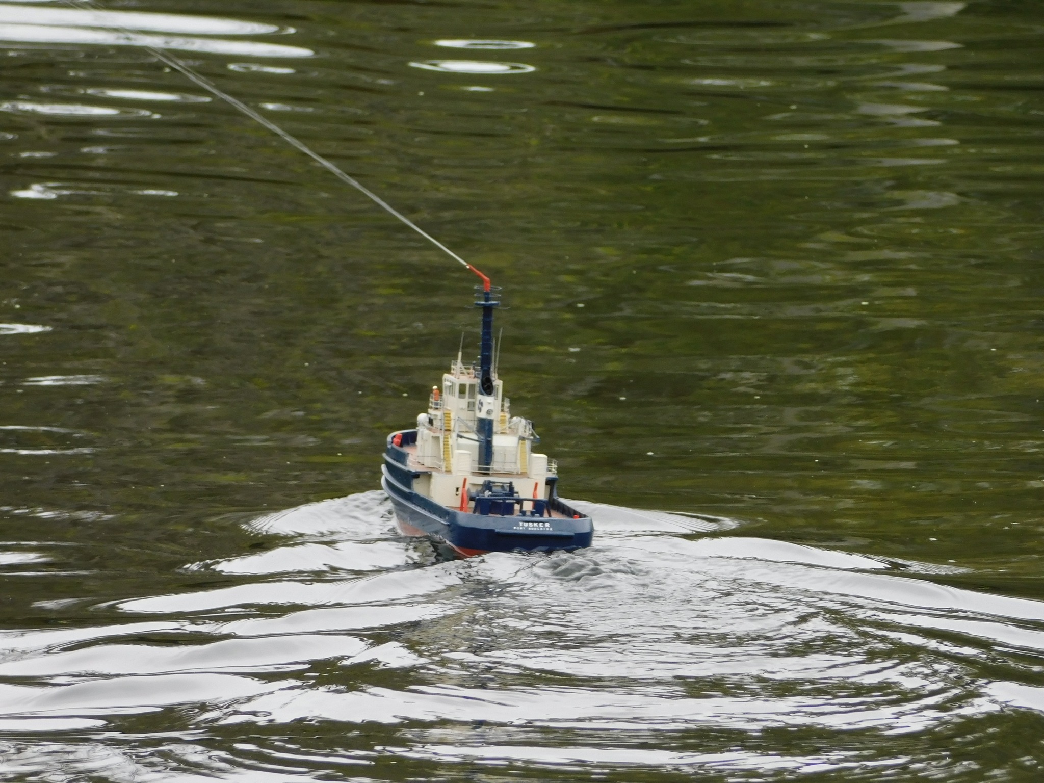

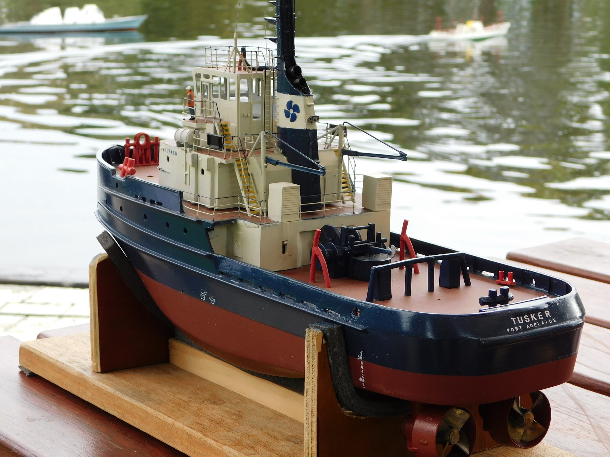

Its been nice to get back to working on models again I have to do a big rewire on my 1/72 USS Long Beach as some of the 12 year old main power wiring is stuffed (well to be fair the wires are ok but the plugs are pretty nuked from the high Amp loads at full speed (about 11.8A @12v (more A's with newer batteries!). On one of the leads from the fuse box to Port motor the plug's insulation has melted...!! It runs 4x 12v 10Ah SLAs with 2 batteries per motor in parallel...My Rc harbor tug is nearly complete too with working Azi pod drive its one of my smallest 1/72 ship models (44cm long)...with the most expensive drive system!!
some gratuitous rc boat pics...
