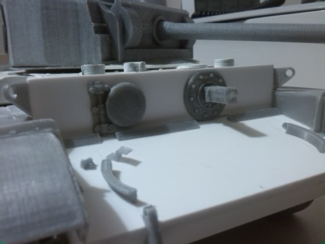

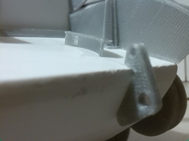

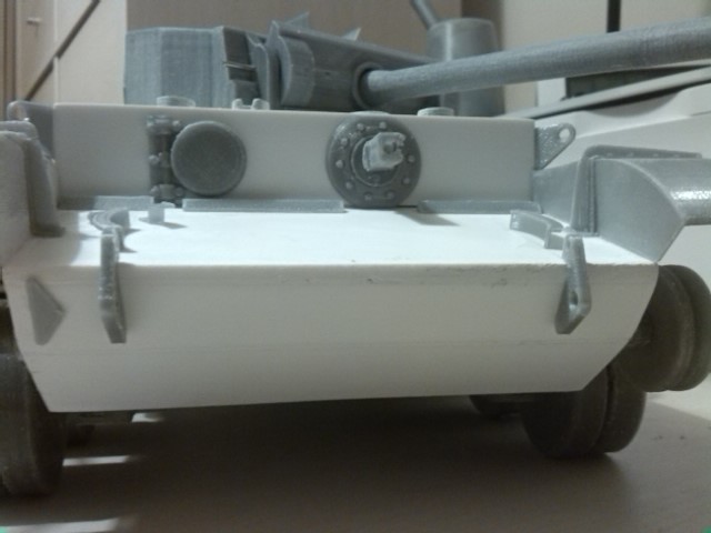

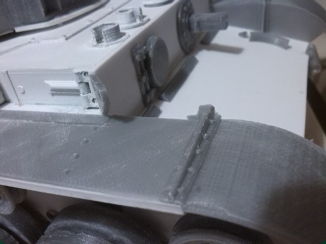

Been doing all the fiddly bits, Thats 95% of the front done, can do some work on the turret next. I tried printing track links, which was ok, I can do that, but drilling out the pin holes and cleaning them up requires more patience than I have.... :yawn:
A pic of a real one is included so that you can see what I am aiming for.

W.W., it's really coming along. I'm amazed by the bolt head details being printed along with the main pieces. Following along.

I only cottoned on to doing that with this build, mainly because I have now got both printers set up to perfection. The new one prints really fast so I just design a set of parts, load them in, and print them all in one go. Hardly any cleaning up or sanding to do, just glue them on.
I had a go at track links, I could, and might, try and do a whole set, but its the pin holes that are a pain, and the only way to do them properly is with each link in two or three parts, and that means a tedious assembly process to do a whole tank set. The ones in the pic have been designed to clip together without metal pins. but they wouldn't be any good for RC.
