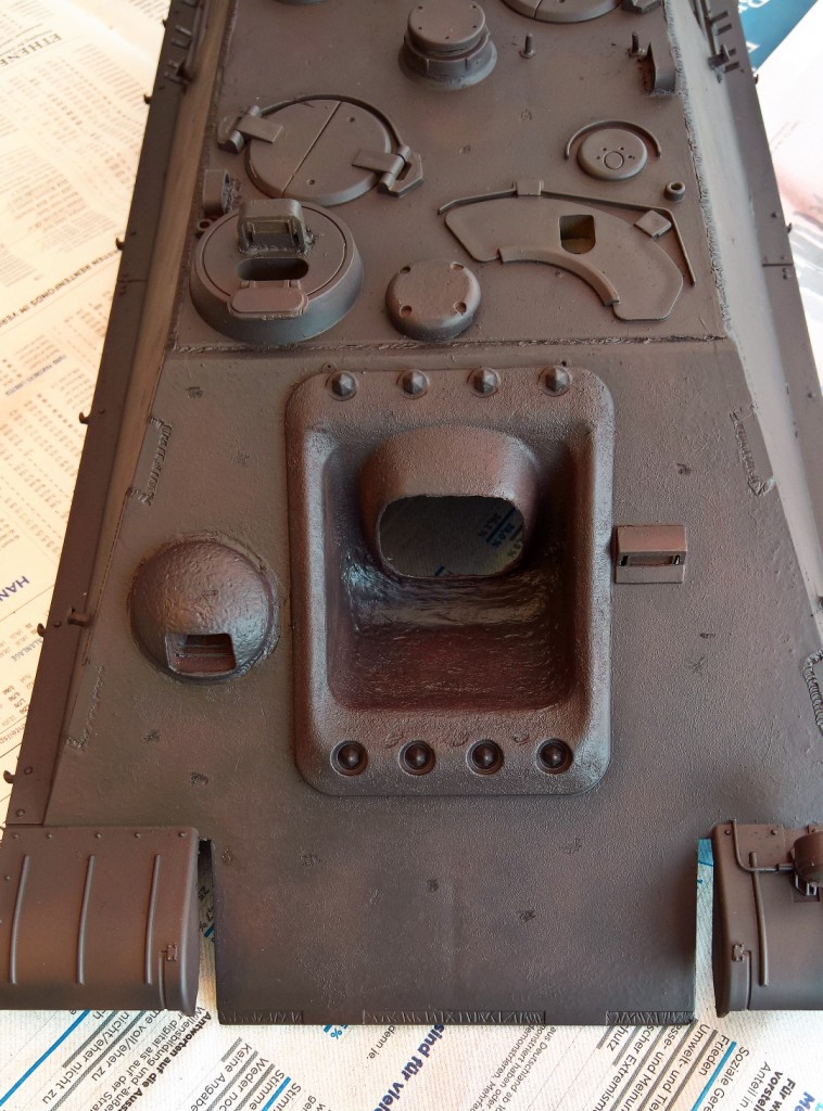

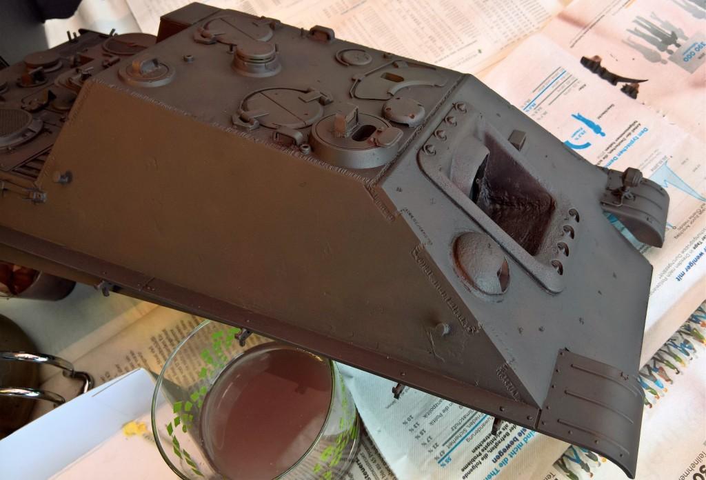

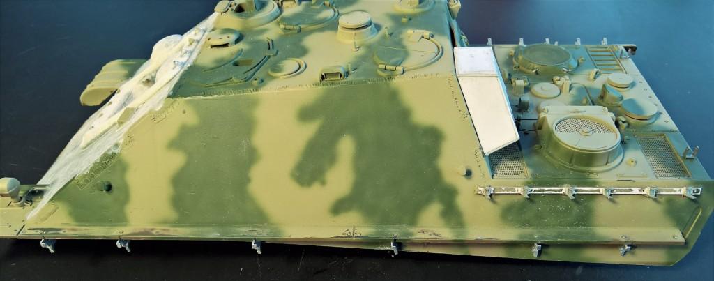

So I started over again with the paintjob after adding further details and some surface structure.
I wanted to have a real dark base coat, very thin, hopefully being able to "bubble" again tomorrow. So i Mixed Vallejo German Dark Black Brown with some hull red and 50% Thinner+Flow Improver. The coat was so thin it took me half an hour of airbrushing to get a coverage that I liked.
Next step will be Dark Yellow (RAL 7028) mixed with Ivory (RAL1001) to get that very late Dark Yellow tone. The Camo will be Redbrown RAL8012 and Resedagrün RAL6011. Then Iwill decide for the tonal Change by filters. Because I would intend to be in February, I might try some Grey-brown filter... We will see

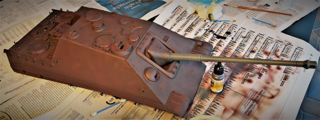

Gun test fit after gray primer.

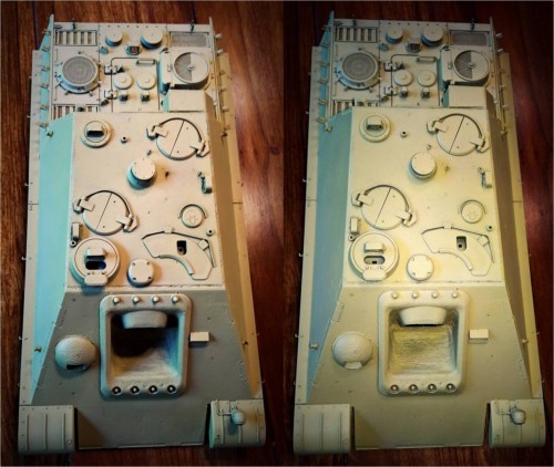

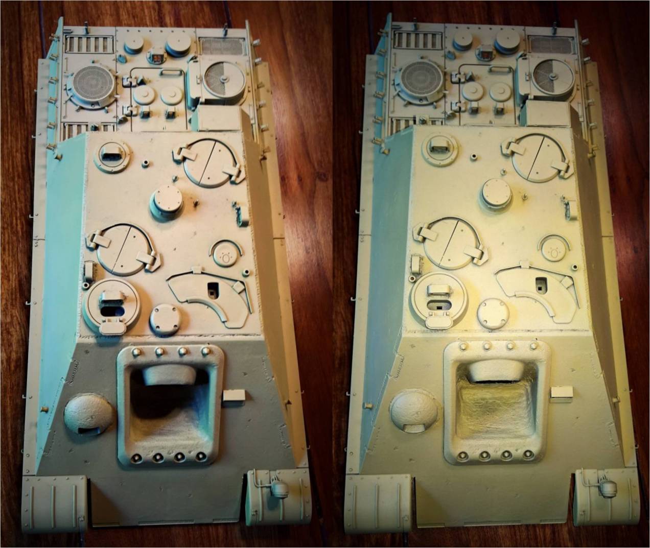

Basecoat of dark yellow added. Again with 30-40% Thinner, very thin layers. Details not destroyed.
The dark redbrown basecoat of yesterday gives a fantastic subtle shading and isnt as stark as a black basecoat. Here is a side by side, once with Flash and without. Too much sun outside to take proper outside Pictures today 8)

Thats reeeeeal nice Mr Soren.
good call on the dark undercoat, sure does make a noticeable impact on the base yellow thats for sure.

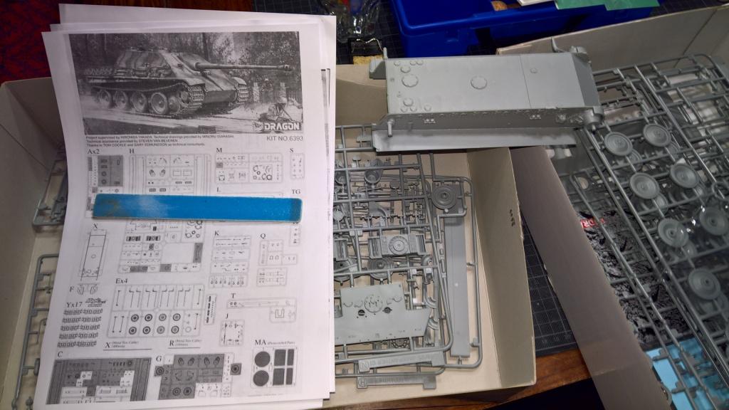

As of now, I had to start an Interim kit. B| Great Thing about that kit. I can nearly do this with the exact Setup like the big Boy, despite the tool Placement. Well I could do that as well, but that would require some modification.

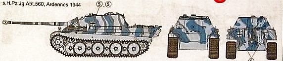

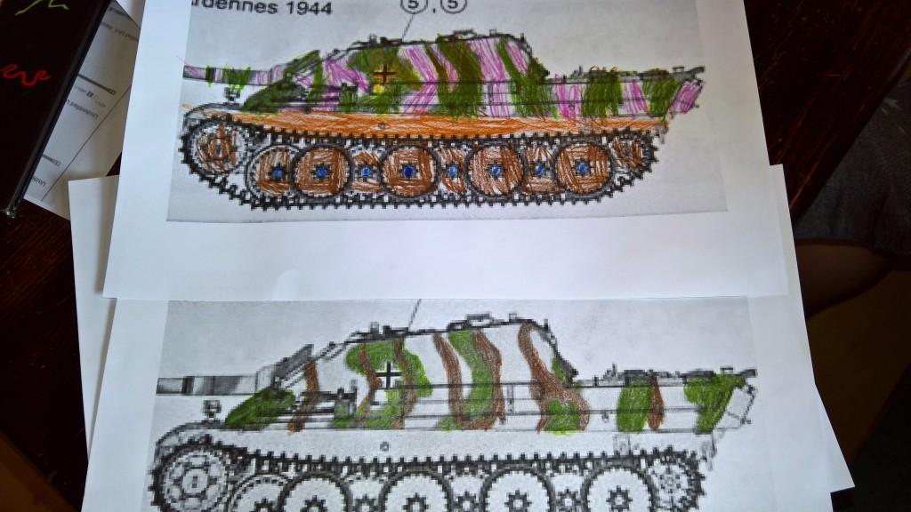

I found this very interesting pattern. What do you think, better sharp edges or sprayed?

My daughter and I tried a quick coloration of the pattern. Im not sure yet which Im gonna try :crazy: :D
