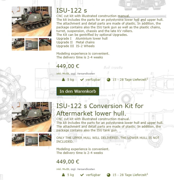

The ISU-122 was produced in two different modifications. 1- with A-19 cannon. 2. With a gun D-25. P.s. Design work on the conversion kit ISU-152/122/122K has long been completed. There will be a presentation in December

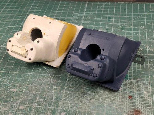

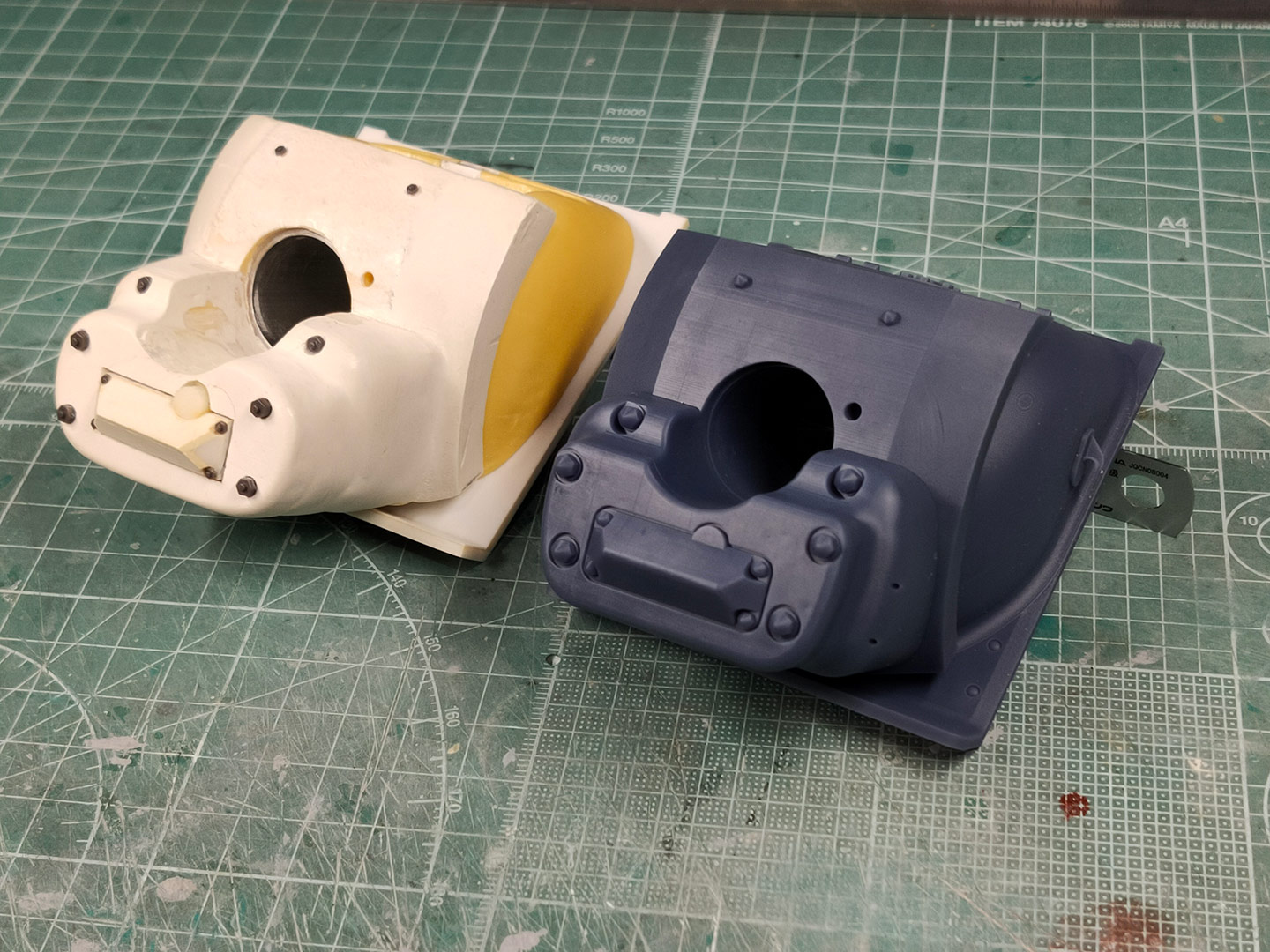

It took longer to get here than I was hoping, I've been busy at work and getting the solid CAD drawing into a printable state was more involved than I'd planned. I've managed some test prints over the last two weeks though, and it's finally getting somewhere!
A comparison to my sculpted Milliput attempt from four and a half years ago. Where's the time gone? The printed one's much more dimensionally accurate and is only a fraction of the weight, so it'll put much less strain on the elevation servo mechanism.

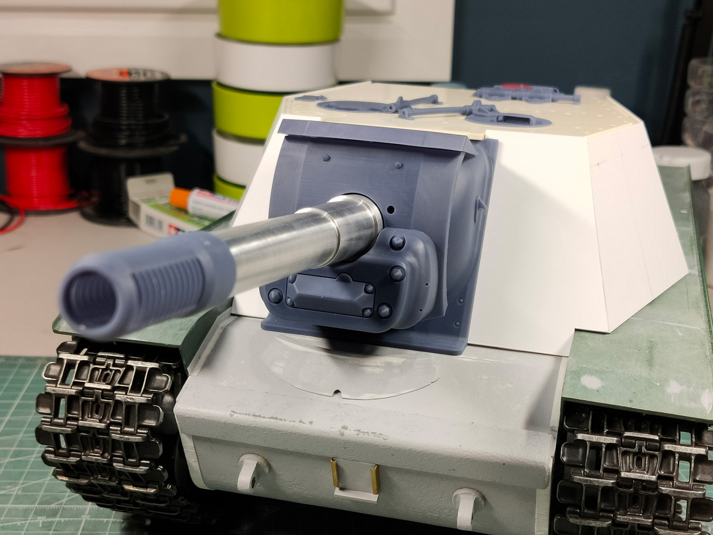

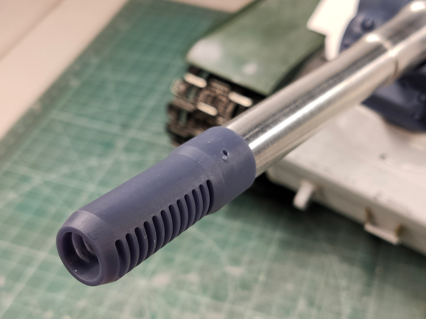

Looks the business when it's all assembled! I also designed and printed a replacement muzzle brake, the aluminium one I had was slightly off-centre and it always bugged me. I've also added detail for the mounting bolts, the resolution's good enough that the slotted head of the screw is visible.
A much better looking profile now:
I've run into a problem, though. Now that I'm using more accurate references and have nearly got rid of the parts I had to compromise with, I've realised that the gun is mounted about 5 millimetres too far towards the vehicle's centreline. I'm worried that if I continue, the driver's visor (and its cover), the headlight, the horn and the pistol port will all be too crowded. I think I have three options:
  • - do nothing about it and improvise/adapt/overcome later,
    - hack apart the styrene casement and move everything to the vehicle's right,
    - design and print an entirely new replacement casement.
I'd appreciate your thoughts and ideas, gents! What should I do next?
Posts: 11959
Re: Ludwig/Taigen SU-152 (early production)
Glad you are back & doing things for you !
I reckon print a new casemate.
- it will prove you can
- it will leave you with a bunch of bits you can sell for someone to make a 152 out of
- the accuracy you crave can be achieved without going a long way back to go forward.

Raminator wrote: I've run into a problem, though. Now that I'm using more accurate references and have nearly got rid of the parts I had to compromise with, I've realised that the gun is mounted about 5 millimetres too far towards the vehicle's centreline. I'm worried that if I continue, the driver's visor (and its cover), the headlight, the horn and the pistol port will all be too crowded. I think I have three options:
If I read your post, you want to make a new replacement casement ;)
by the way, it is an awesome and very impressive vehicle when you are standing in front of it :O

After taking a closer look at the styrene casemate, moving the mantlet isn't an option. The mounting points are made of several layers of styrene sheet laminated with plastic cement, so nothing will move without a significant application of violence. I will attempt to print a new one, so this'll be the third casemate and second hull I've used. And I wonder why I never finish anything! :/

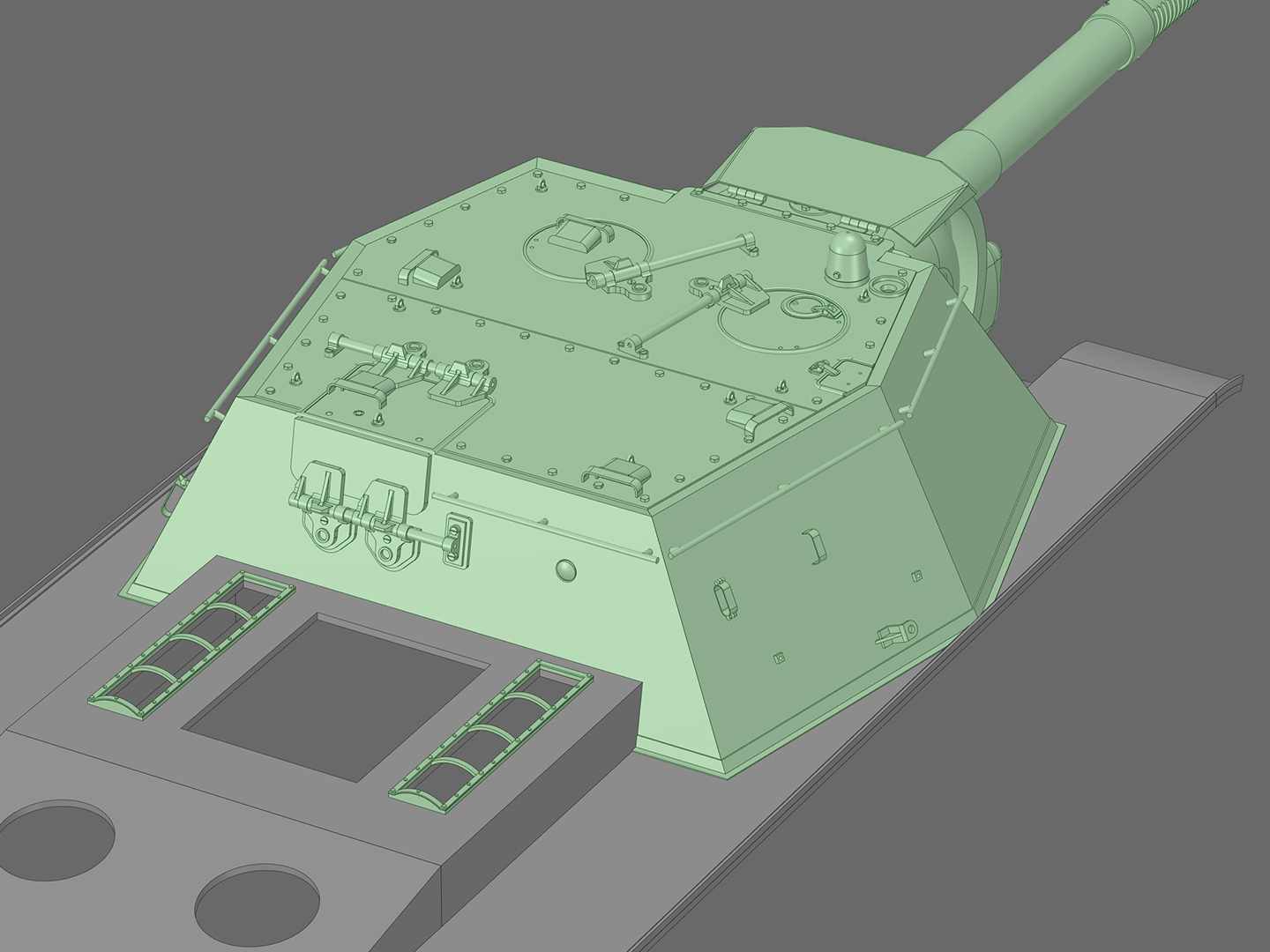

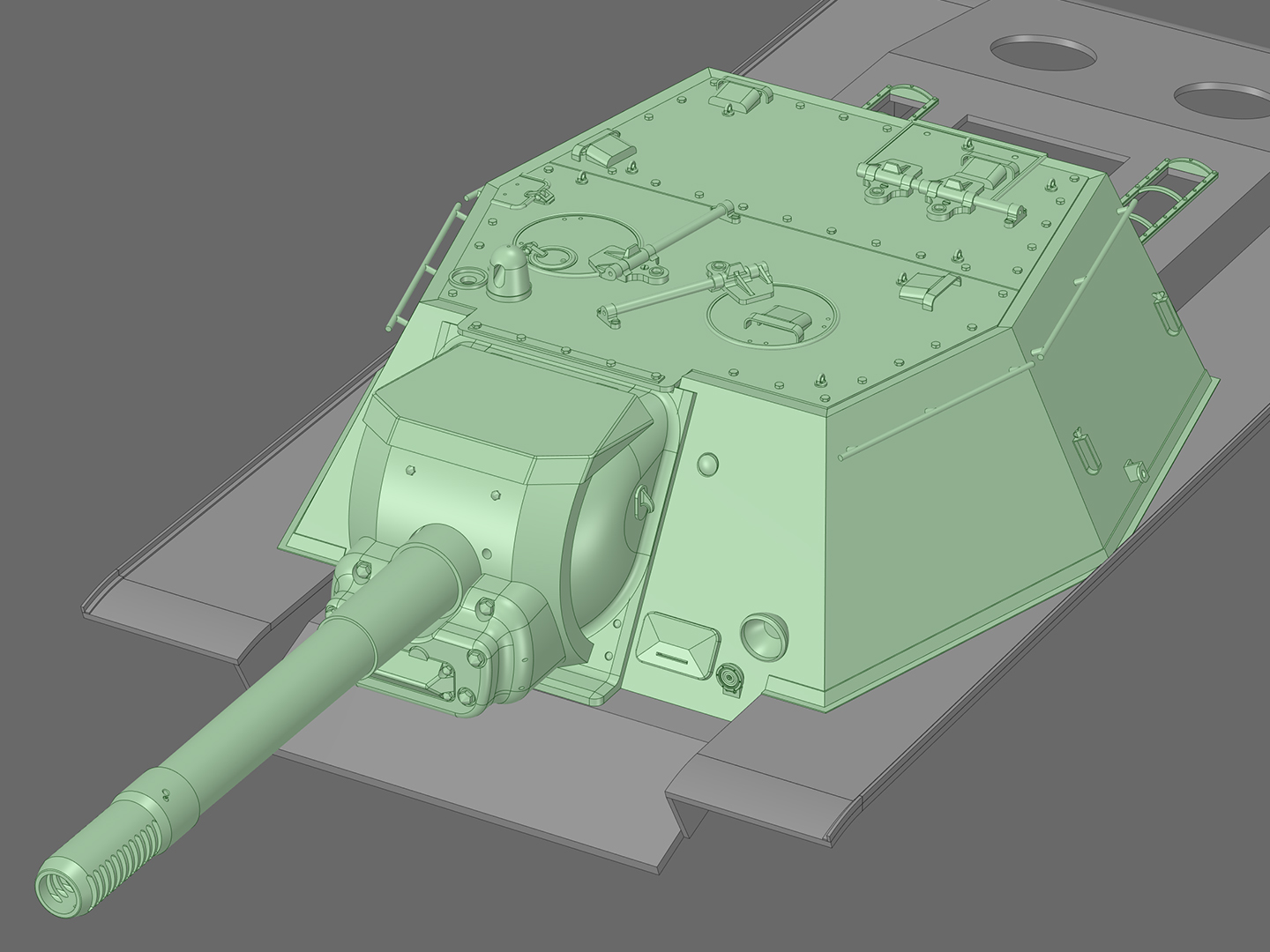

I've been drawing up a new casemate during the evenings this week, and I think I'm making some pretty good progress. I've been using photos of the surviving vehicles in Kubinka and Lubusz, alongside a handful of blueprints.
Still some more details to work on, and I'll need to spend some time cutting it all up to make it printable. Things like the bolt heads, desantniki handrails and tool clamps will be done in brass instead of printed, I've just included them in the drawings to make sure everything fits. Should start making some progress soon!
