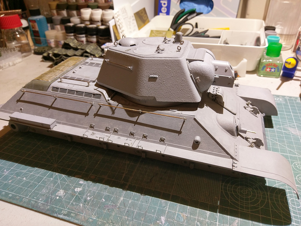

No Autobarns nearby, so I got an equivalent etching primer from SuperCheap Auto instead. I tested it on some painted scrap and found that the rattle can laid the spray down too thick, and crazed in eggshell patterns over the top of the paint. I figured it needs to be thinned down and applied with an airbrush on top of bare plastic.
I did what I thought was best, but I was wrong.
I've spent the weekend trying to repair the damage and replace the bits I could scratchbuild, but the tank isn't going to have an antenna (the antenna mount got lost down the sink, and I can't mount a scratchbuilt one to the existing brackets because they'd just fall off). I can't attach the external fuel tanks; one of the fuel tank supports got broken and the other got flushed down the sink. The headlight snapped from its bracket and the resulting fracture is too fine to hold glue, the wires are basically the only thing holding the light up.
At least it looks like the weather's going to hold out until Thursday or so, so it looks like I've got my work cut out for me. I decanted the primer from the rattle can with no issues, and it's had 24 hours for the propellant to boil off. Has anyone else tried airbrushing decanted product from an aerosol before? Am I about to make another huge mistake?

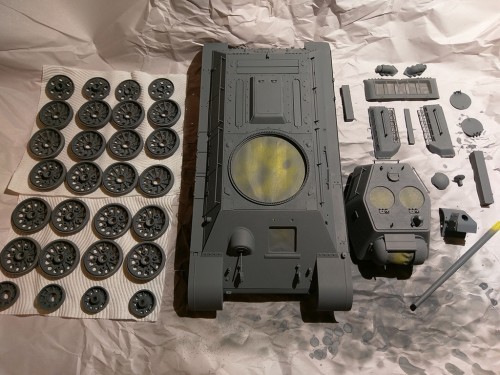

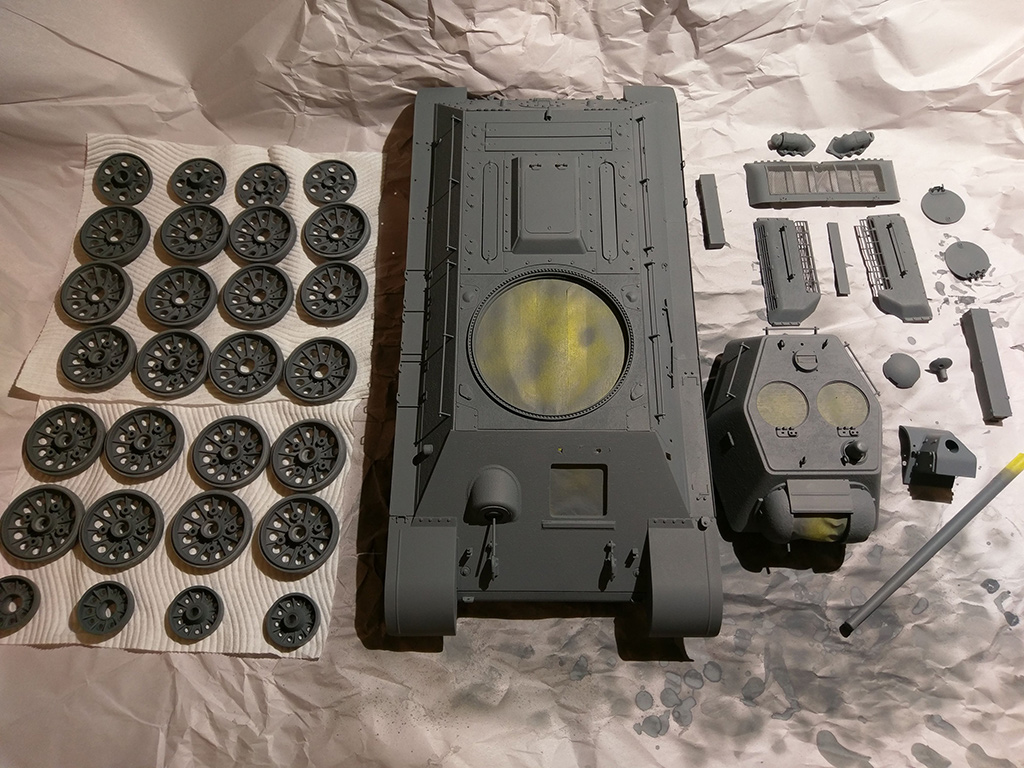

I appreciate the concern and commiseration, gents. Sadly none of the parts were recoverable, I undid the S-bend under the sink as soon as I realised what had happened but those little plastic bits float far too easily. There are going to be some very confused fish out there.
All is not lost though, I've been making slow but steady progress painting throughout the week. The instructions on the can recommended two light coats for extra strength, so I figured that if I water down the primer 50/50 with lacquer thinner, then four light coats should do the trick. It's a nice smooth, even finish with none of the cracking and crazing I saw when I sprayed directly from the can. Looks like the paint stripping was an unnecessary disaster, but at least I know for next time!
The grey has shown up a few bits that need some filling or fixing, so once those are sorted I'll give the primer a couple days to cure and breathe per Brett's advice. Then it'll be time for 4BO and a clear coat before being sent straight to the shelf. I'm going to hold off on the weathering for now and get back to the SU-152 instead.
