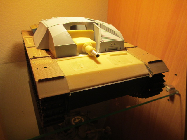

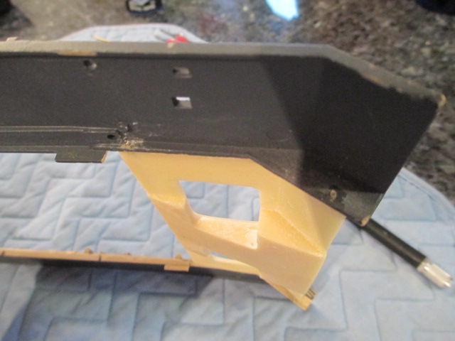

Nothing in the Post today. Plenty to do tho' Tonight saw the resin glacis firmly set in the deck with the aid of steel pins glued into holes drilled with the Yankee drill. After that, I created a spacer out of strip styrene to fill a small gap between the casemate and glacis. Seeing that completed and mounted, I looked at the hatches for the glacis and am considering whether or not I want to cut them, get working hinges and do the detail on the underside. The only use I see for them would be access to lube the gear boxes. Something to think over. If anyone has seen metal hatches for this application, shout it out, please. Something heavy with a little detail would go a long way towards dropping the marker onto the 'working' hatches side. I finished the night with some easy fun. I used a Dremel and carefully opened up the tow cable mounts. Using the Yankee drill again, I opened up the binocular sights on the casemate and drilled a hole for a knob on the Smoke Grenade armored box on the rear deck. Using a tiny Tamiya screw, I'll file it and make a knob for that cover. Pics:
A couple of steps forward.
A couple of steps forward..JPG (89.39 KiB) Viewed 4106 times
Using the Dremel and a bit for plastic, I opened up the mounts for the tow cables.
Using the Dremel and a bit for plastic, I opened up the mounts for the tow cables..JPG (90.76 KiB) Viewed 4106 times
Once it is filed smooth, this screw will make a great knob for the cover there.
Once it is filed smooth, this screw will make a great knob for the cover there..JPG (84.68 KiB) Viewed 4106 times
Spacer in place and casemate tightly fitted.  No slop.
Pinned and glued twice on each side.
Pinned and glued twice on each side..JPG (86.81 KiB) Viewed 4106 times

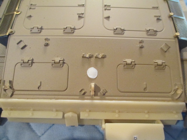

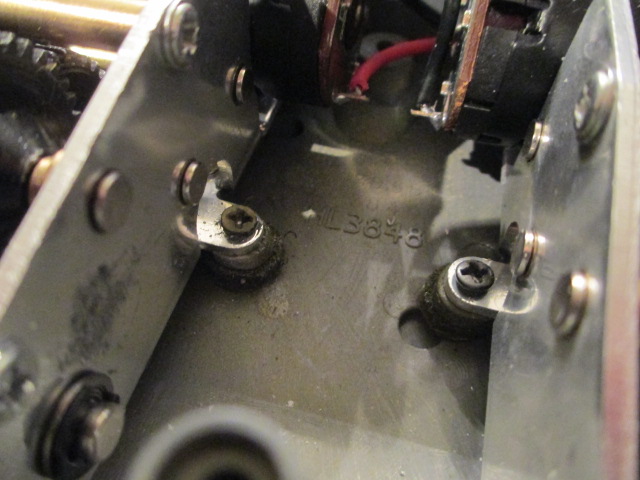

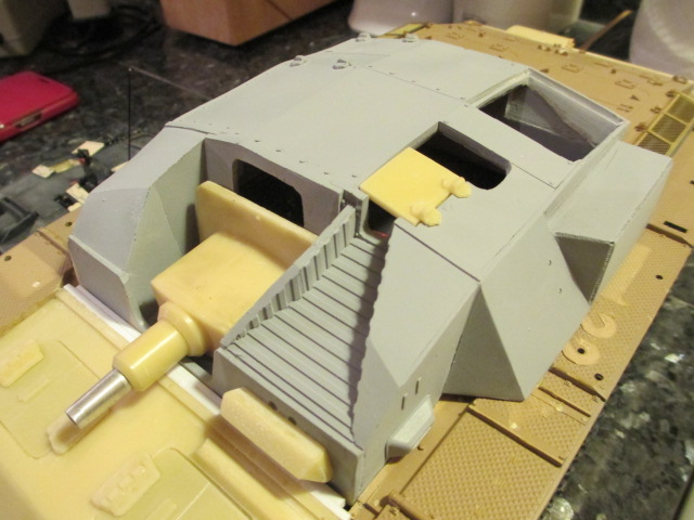

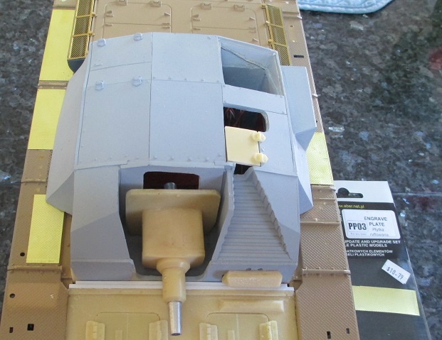

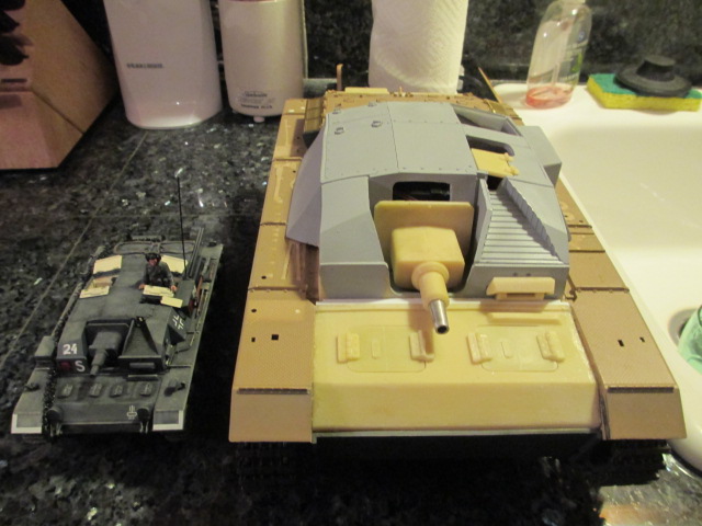

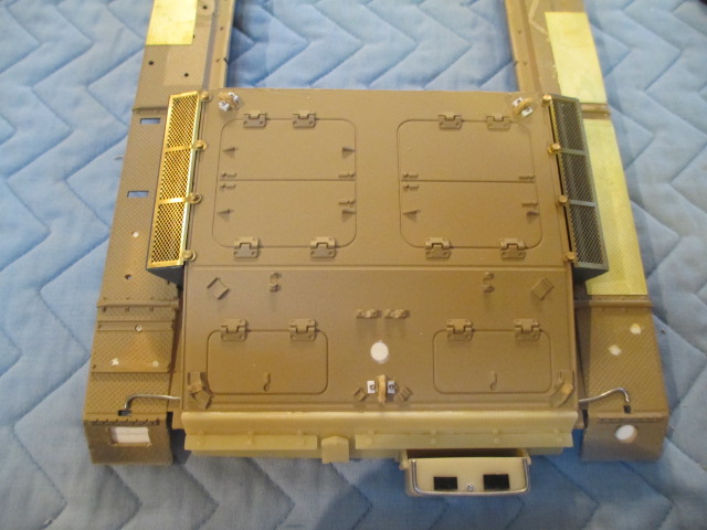

While waiting for the treadplate to arrive in the Post, I wanted to start cleaning up the casemate a little with a couple of small dressing files. I cemented the hatches and hinges over the gearboxes into place on the glacis and added the view block and visor on the casemate after some cleanup. A little more work and one of the small hatches is in place up on top. I also added a little bushing support and a screw on each gearbox in the hull. They are so small and narrow that since there was an attachment point free, I should make use of it. Still pondering working hinges for the Commander's hatch and the gunner's scope hatch. I have feelers out so we'll see. Pics:
Soft bushing and a screw for each gearbox
Visual aid
Visual aid
Casemate details and a hatch added along with openings dressed out with files.
Hinges attached
Hinges attached
Hinges attached.JPG (82.89 KiB) Viewed 4099 times

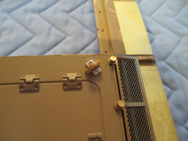

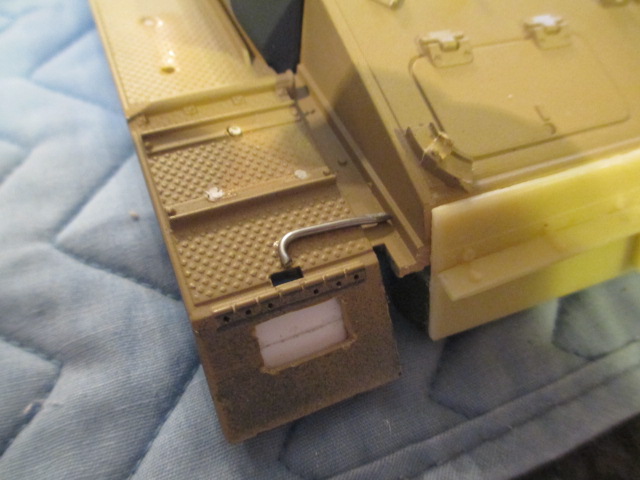

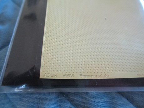

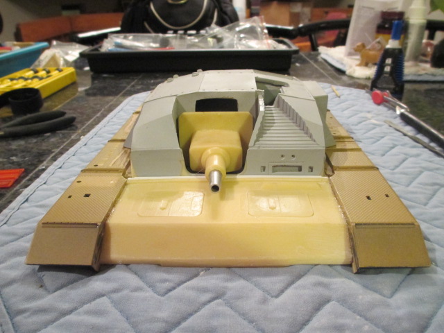

Aber brass Treadplate arrived from Artistic and I have to say: "Best 10.00 and change spent in some time." The plate is an exact match for the HL StuG and PZ III plastic textured fenders. A little sanding and filing and the patches for the removed tools dropped right in. ;o) Pics:
rear view, took time to shave off the excess putty as well...
rear view, took time to shave off the excess putty as well....JPG (75.53 KiB) Viewed 4085 times
Patched and looking much better
An exact match
An exact match
An exact match.JPG (54.75 KiB) Viewed 4085 times
Aber brass treadplate from Artistic Hobbies here in the States
Aber brass treadplate from Artistic Hobbies here in the States.JPG (14.93 KiB) Viewed 4085 times

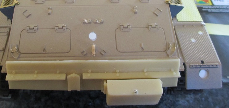

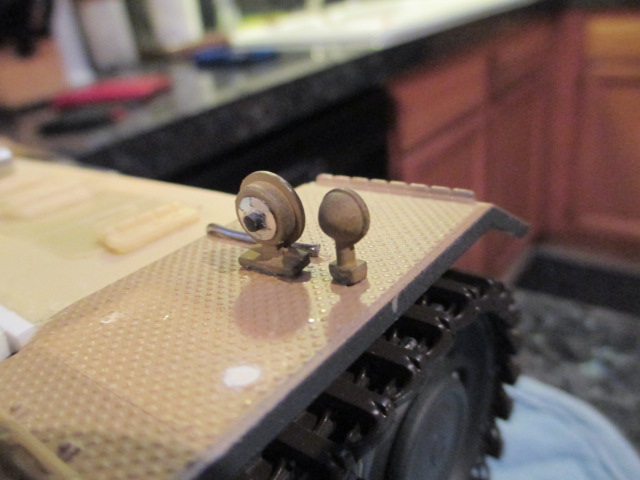

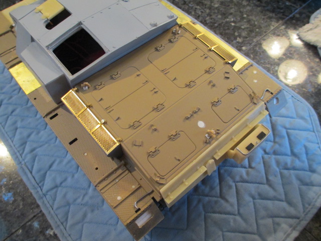

Nothing in the Post today. Was\am tired and somewhat achy. It was a long Monday workday. ;o) So I spent a pleasant hour doing rear deck detail. That went a long ways towards mood improvement. Pics:
Mounted back on the lower hull
Rear deck detail
Rear deck detail
Styrene blocks drilled for bolts made out of Tamiya screws
Styrene blocks drilled for bolts made out of Tamiya screws.JPG (91.14 KiB) Viewed 4070 times

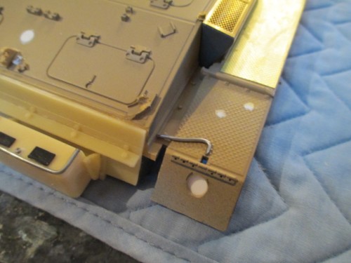

Rear Tail light wiring
Rear Convoy light wiring
rear Convoy light wiring.JPG (95.08 KiB) Viewed 4070 times
Added a lid rim and detail to the smoke grenade box
Added a lid rim and detail to the smoke grenade box.JPG (85.29 KiB) Viewed 4070 times

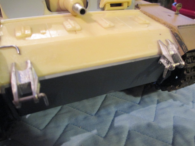

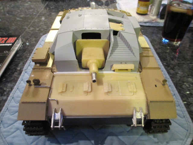

Nothing in the Post today so I did a little work at the rear of the Engine deck then turned my attention up front. Pics:
A lot of small progress made tonight.
Located and mounted the front tow shackles.  They also make a nice fastener for the front of the deck.
Located and mounted the front tow shackles. They also make a nice fastener for the front of the deck..JPG (90.14 KiB) Viewed 4051 times

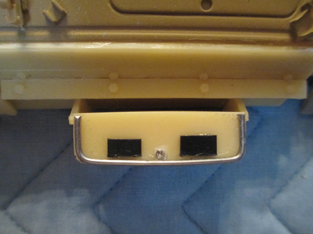

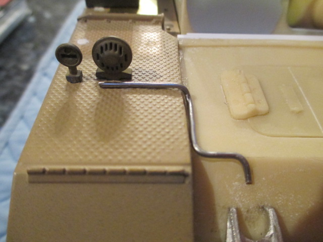

A little extra detail work to jazz up the HL style siren in the back...
A little extra detail work to jazz up the HL style siren in the back....JPG (92.22 KiB) Viewed 4051 times
Basic light and siren and wiring from the front...
Basic light and siren and wiring from the front....JPG (90.3 KiB) Viewed 4051 times

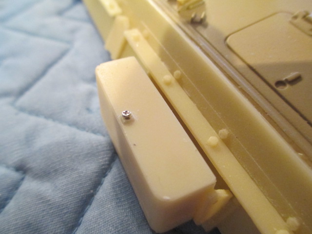

I mounted the jack block then made a bottom for the tool box.  Brass tool box mounts will have to wait until a little later
I mounted the jack block then made a bottom for the tool box. Brass tool box mounts will have to wait until a little later.JPG (82.06 KiB) Viewed 4051 times

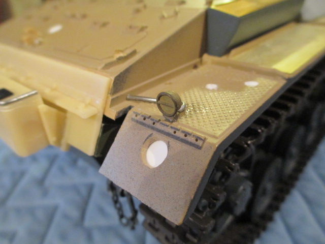

A little filing and instant tail lamp!
A little filing and instant tail lamp!.JPG (90.19 KiB) Viewed 4051 times

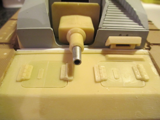

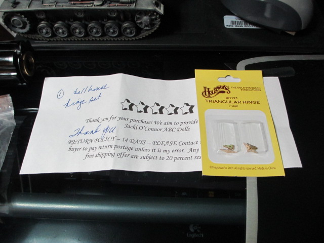

Gym night tonight so no time ( or energy ) to work on the StuG but I did get a set of brass hinges in. I decided to make a post for Herman's sake because he gets such a kick out of 'Doll House' stuff being used on our tanks. ;o) Pics:
These are just the tiniest bit small but will still work for a resin hatch.
These are just the tiniest bit small but will still work for a resin hatch..JPG (94.29 KiB) Viewed 4038 times
Herman's Finest Doll House Hinges
Herman's Finest Doll House Hinges.JPG (96.61 KiB) Viewed 4038 times
