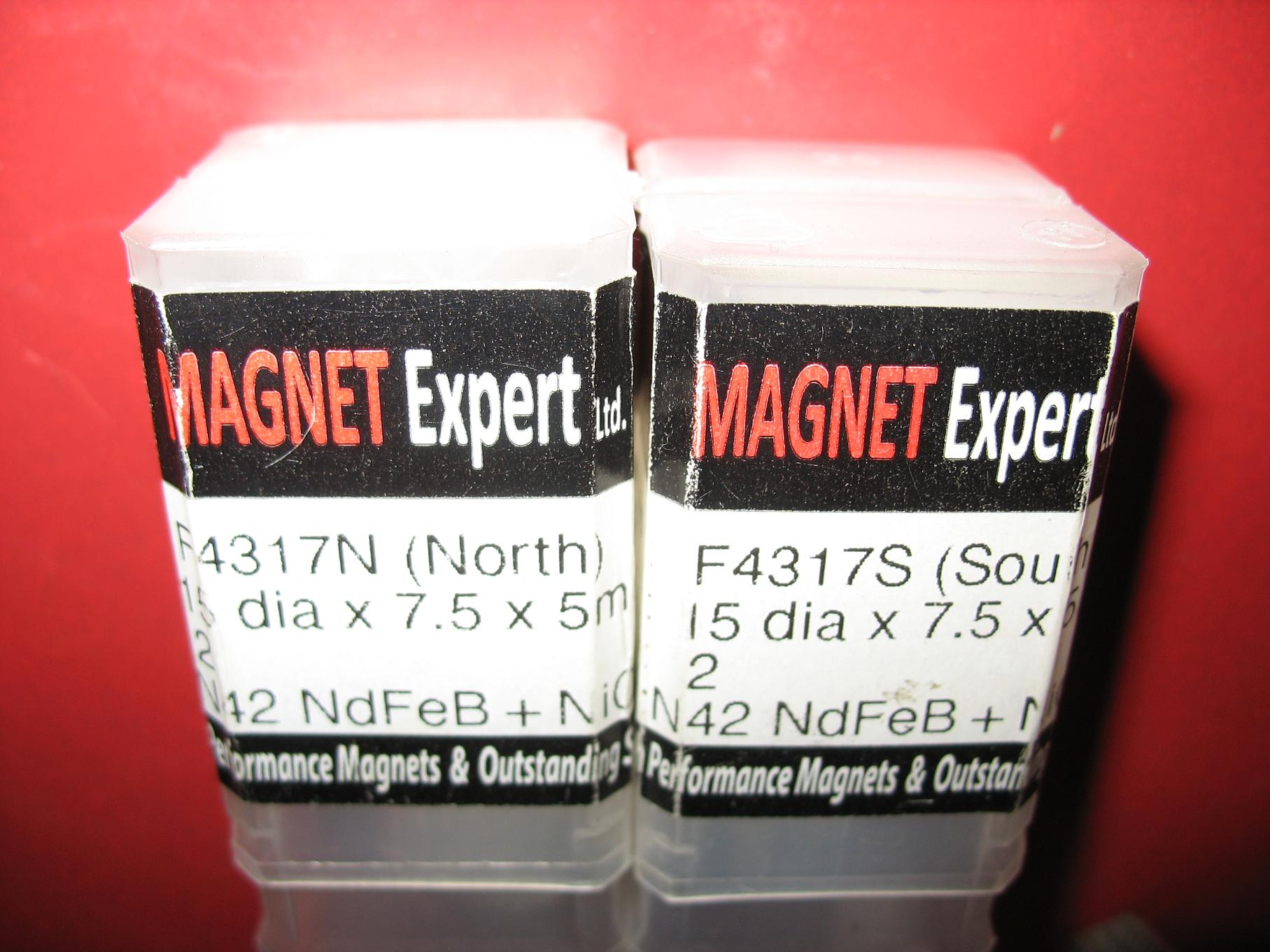

Hi dgsselkirk I am glad that I could offer some advice.....
@ Hi MichaelC,
I thought that I might get asked that....and have been searching for the packages that they came in..... I got mine from Magnet Expert ...
www. first4magnets.com also trading in UK as http://www.magnetexpert.co.uk/
You can also find them on Ebay, they are not as cheap as ordinary type super strong magnets, but the convenience more than makes up for it. I just use a steel washer and a screw opposite a single magnet and screw down into the opposite screw post. North or South do not matter in this case...but...You need to do a bit of careful measuring on the magnet and the washer BEFORE you cut the screw post down...and it is better to cut it a bit Long and to have to file it down than it is to try and replace plastic if you cut too much out....Trust me on THIS one.....I know :{ and I measured about 5 times and still cut out too much !
Alb.
Re: Old Modeler, new R/C KT build
Posted: Mon Apr 15, 2013 2:35 pm
by MichaelC
Thanks Dietrich. I just check the site and I think they are still too big for my liking. Just peeking at the box you have here, it looks like yours are 15mm in diameter which is way bigger than the post still. Does screwing a washer on top of the magnet reduces the pull ?
I have managed to between epoxy and super glue keep most of them down. The reason I want the small ones (6.5mm x 3.2mm) is that they sit right into the existing screw mount on one end. I guess it would be too small for a counter-sink magnet for that size and even if they exists the screw would be too small to mount onto anything anyway.
I share your pain with the cutting........I started cutting too much and have to use epoxy to make up the difference, but after couple of them, what I do now is cut it long, and then sand them down one by one until I get a good fit (I just leave the top and bottom magents on so I know how it will fit. Once I have a solid fit and contact then I glue them down and then heat skrink tube them so it looks neat and tidy). After 5 or 6 of them my last couple actually has been pretty good. As long as it is not an all metal tank, I can lift most of them by the upper hull and the bottom won't come off which is good enough for me !
