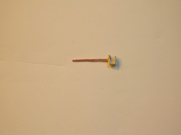

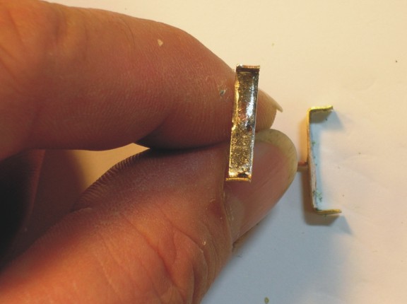

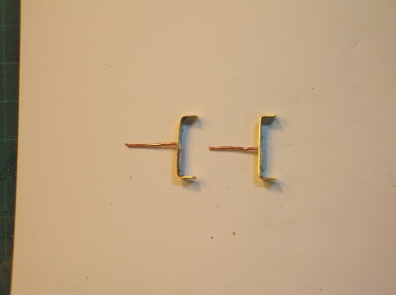

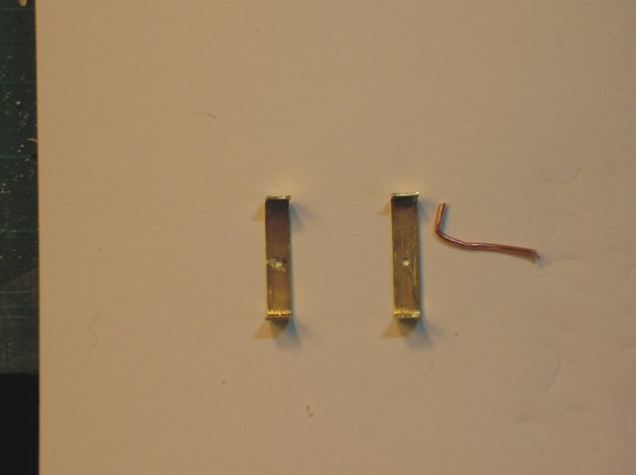

I decided after doing the nice copper large tow cables I couldn't bring myself to use the small cable supplied so I used picture wire. I first traced the pattern out onto a piece of paper and marked the holder bracket positions. I also went back for another look at Bovington. I was going to use the ends of the plastic one but I noticed the Bovington really didn't have ends like that. So I looked at a bunch more pictures and it was tough because of course they are usually long gone in most pics but the few I saw had a more open loop and didn't have those whatchmacallits inside the loop. So I did mine with a more simple loop. I went to all the trouble of cutting and drilling out the plastic parts were the brackets should be but then decided if I was going to all this trouble I should just touch it with solder to hold it together and figure out some brackets that look more realistic!
So I did that and got all the cables together and started on paint. More on that later. So while I was waiting for the primer to dry on the cables I started looking at the plastic brackets I had mounted and comparing them to the real thing. Mine were too thick and a bit too long and I really was growing more and more unhappy with them so of course tear them off!
So now what? I knew I was going to use brass sheet to make new brackets but I also want this tank to fight eventually so how to make something that won't pop off on the first hit. So what I decided to do was a little drilling and soldering. Made the bracket and drilled a hole in the center. Then placed it in position on the tank and drilled through the hull. Next I took a small strand of copper wire and crushed a little bit of the end flat and bent it 90 degrees and soldered it through the bracket. I sanded it down a bit and as you can see in pic 239 the solder bleeds through to the back as well and it makes this pretty strong. So when I mount them simply insert the copper post thru the hull and expoxy on the back side and also at the same time put a little crazy glue on the back of the bracket to help stick it to the hull. And of course will add welds later...

Now to make the bracket closures. Pretty easy, take a strip the same thickness and do a 90 degree bend but make it a little shorter end then the bracket itself. Solder this on add a little butterfly twist of brass strip to simulate the wingnut on the real thing and done. I will leave it open until it is mounted and the tow ropes and cleaning rods are in and then bend it closed and a touch of crazy glue and it should work fine.

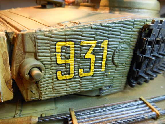

Here you go Dean, thanks to your lacquer tips. My brush happen to have some brownish colour on it so by the time I applied it to the decal it weathers it at the same time, and desolved part of it to simulate paint chip !dgsselkirk wrote:Hi JV,
Yes, as I said gloss clear under and with the thin decals I use very little issue with air and the laquer thinner does exactly as you describe, it lightly disolves the decal into the surface and then matt clear on top....
Elite Armour decal with Tamiya lacquer thinner on Asiatam rubber zim. I already ordered some more decal for my KT since this work out so nicely.
