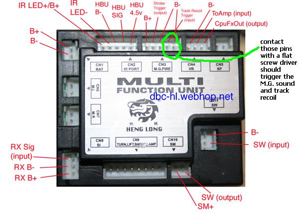

If this new board is almost a copy of the RX-18 ; you could try that to check if the sound and track recoil work ...

strmnd54 wrote:If this new board is almost a copy of the RX-18 ; you could try that to check if the sound and track recoil work ...
hi thanks for the info. have tried this contacting the pin. and yes it set the recoil of and sound. so the board is ok. but all the plugs are in on turret. and it worked ok on the old board.not sure what wrong now ? is it the hand set ? or the workings on the turret ? . :S

right set up the rx-18 board. the gun sound and track recoil works. so i am putting this down to the handset .just waiting on some more people getting there hands on one of the new dital units to see if they are having the same troubles as me with the handset .or it maybe just me ? ???
