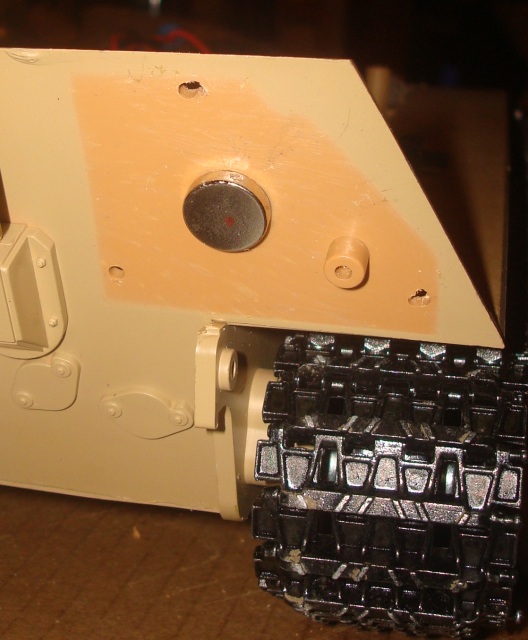

Did a bit of work to the tank tonight. Finally some spare time! Saw elsewhere on this forum the idea of using Rare Earth Magnets instead of screws to hold the upper and lower hulls in place. Picked some up and installed them, what a great idea, they work to hold the hulls secure, yet allow easy access to the inside.
Wanted to move the switches from under the tank. I've seen some builds where people have taken the top off the rear stowage boxes, attached hinges and then installed the switches. Well...my skills are not up to that challenge, so I opted for another route. Removed the stowage box from one side of the tank (carefully) and used those handy magnets again. One on the hull, the other inside the stowage box and voila, one removable stowage box. Then cut out a hole for the power switch and installed. Worked out quite well, plus didn't have to mess around with anything people can see on the exterior of the tank.
Just have to rinse and repeat on the other side for the volume and smoker switches.
Magnet attached to the hull with some superglue
Magnet inside the stowage box
Power switch nearly installed

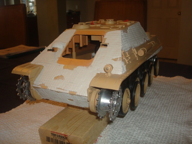

Started playing around with zimmerit. Couldn't get a pattern that I could say I really liked, with the supplies I had on-hand. So did some research and decided to move away from the pattern I was doing and instead zim this jagd up with the square pattern.
First I applied a layer of Apoxie Sculpt, and smoothed it out to get a more consistent thickness.
Applied Apoxie
Applied Apoxie
applied apoxie.jpg (61.42 KiB) Viewed 3332 times
Using the backside of an Exacto knife blade I made the squares.
Square pattern
Square pattern
square pattern.jpg (59.31 KiB) Viewed 3332 times
Then let it set for a couple of minutes and began chipping away at the zim to simulate some wear and tear.
Some damage
Some damage
chipped away.jpg (67.5 KiB) Viewed 3332 times
Hull together
Hull together
with hull together.jpg (58.66 KiB) Viewed 3332 times
I must say I'm happier with this look and how it turned out. Think I've definitely found the way I'm doing the zim on this tank.

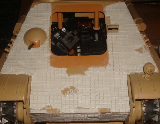

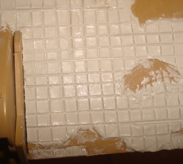

Decided to bite the bullet and tackle zimmeriting (I know, not a word) the front of the tank. Took my time, just over an hour. Happy with the result. Again, hand applied, then smoothed the Apoxie Scuplt, then got to work with adding the detail and some worn away areas. I like the result, is it perfect? Nope. But that's OK.
First image is the work I just completed on the front of the tank.
A close-up of the square zimmerit pattern.
Finally with the top and bottom hulls (bottom was done earlier today) together, they look not too bad. Does look kinda stark, but I'm sure it'll look much better once I get around to painting it.
top and bottom hulls together.jpg (71.63 KiB) Viewed 3315 times
Probably will try to tackle one of the sides tomorrow, time permitting of course.
Not only is this fun, but a little therapeutic!

Had some time while the kiddies were napping, retreated back to the basement. The zimmerit-fest continues.
Tackled one of the sides including the 'skirt' just above the wheels, and the ball mg.
And here's the tank so far with the front, and one side completed. I really like how it's turning out.
so far.jpg (94.64 KiB) Viewed 3289 times
In my earlier post I neglected to attach the photo of the on-off switch installed under the rear stowage bin.
Cheers!
