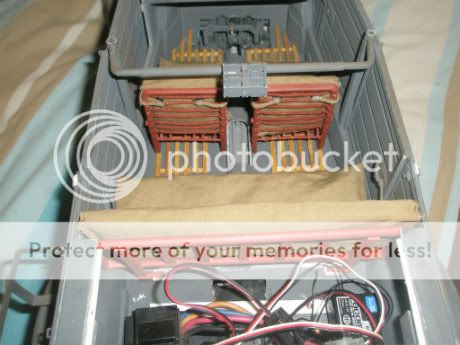

Here are the back seats . I'm not convinced the back folds down but I have made my one so it does , although the hinge method is a little different to the original. All the pictures of reproduction back seat frames that I have seen have had no springs just struts . Probably to stop stuff in the ammo compartment pushing into the seat back ? . The bench is fixed down but I made it removable and more springs that's 42 now ! I altered the fixing points for the bench seat so that it could be removable and not fixed to the top half.

Here are the seats with the top body removed.
And with the rear cushion on
